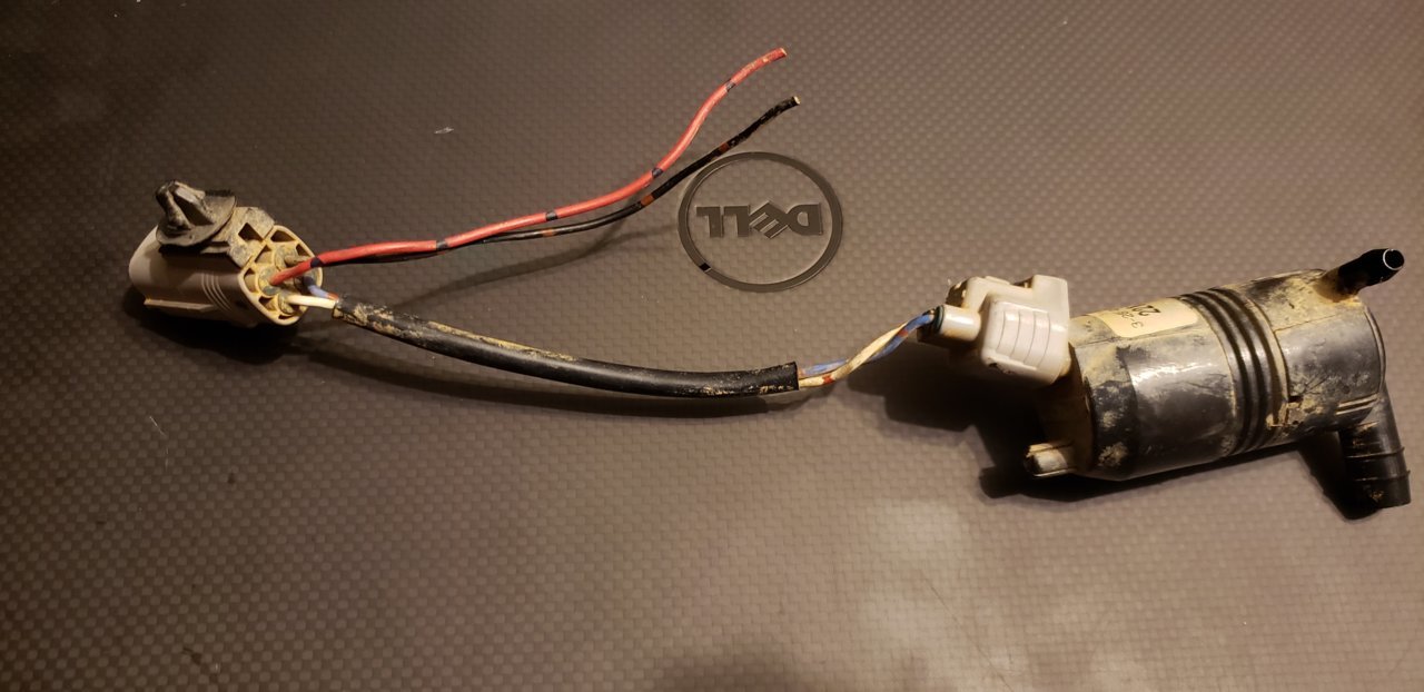

    I'm finally getting around to doing something about my windshield washer reservoir, it's been years since I pulled it out. I apparently cut two wires at the connector to the motor. The wiring diagram doesn't show anything anyone know what they're for? Motor works without them, it's just annoying me.

    Could be for the dummy light sensor for low fluid.

    my 04 has a sensor for low washer fluid, never seen it come on though. But if you have the light for it, it's probably for that.

    I'll bet you're right, totally forgot about that.

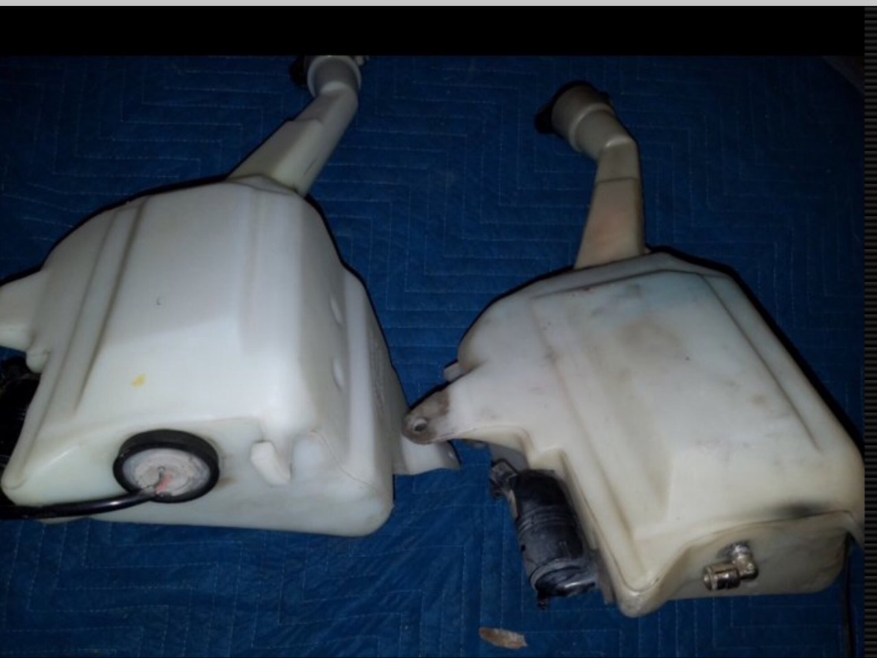

    Just look at the bottom of the tank to see if u have the sensor

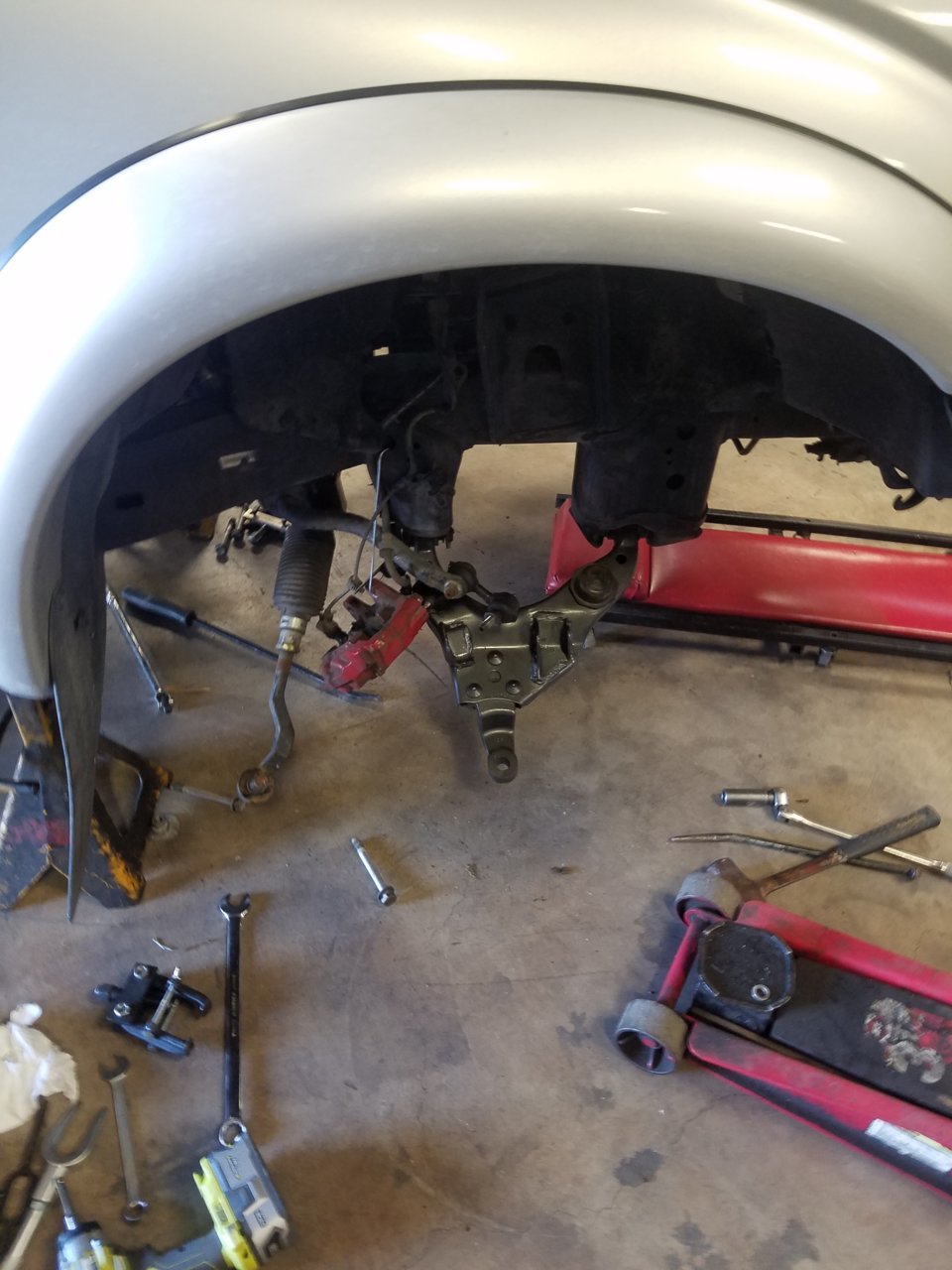

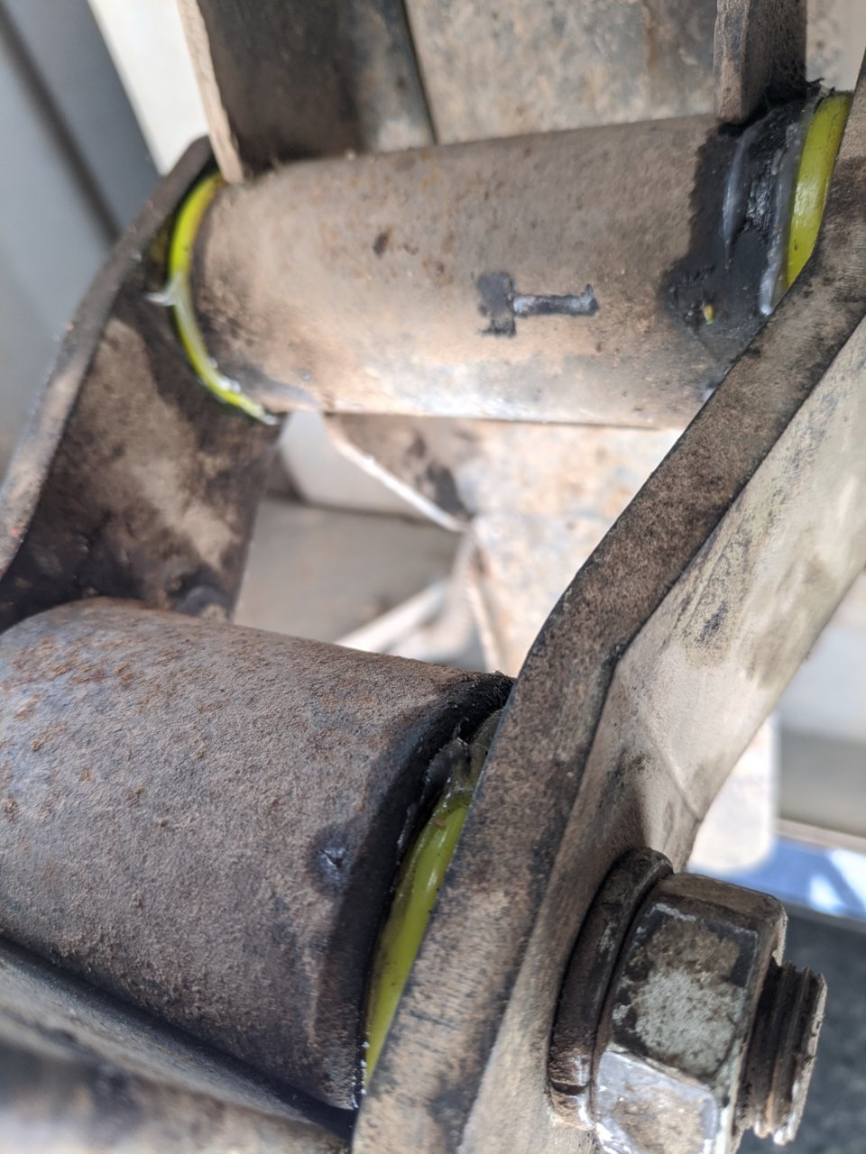

    Rebuilt front suspension. Added SPC light UCA's. Greasable poly LCA bushings. Tundra front brake lines with correct hard lines.
    DIY alingment and tires and wheels.

    My tank is long gone.

    @mechanicjon what setting on the SPCs? I’ve been thinking about adding a set

    Most people run them on the normal D setting, I've had mine on that one since they were installed almost 3 years ago. Haven't heard of many people that run them differently

    I have them on C which is one back from center position. Gives it more Ă· caster.

    My truck has always been low on caster numbers.

    The one on the left with the float sensor was a 35.00 junk yard purchase
