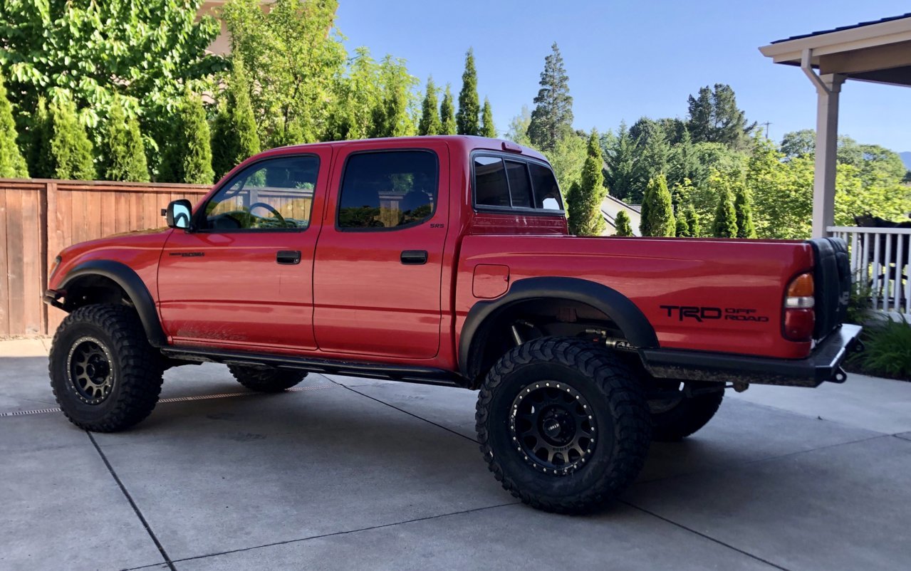

    New tire day. Decided to give some KM3's a try.

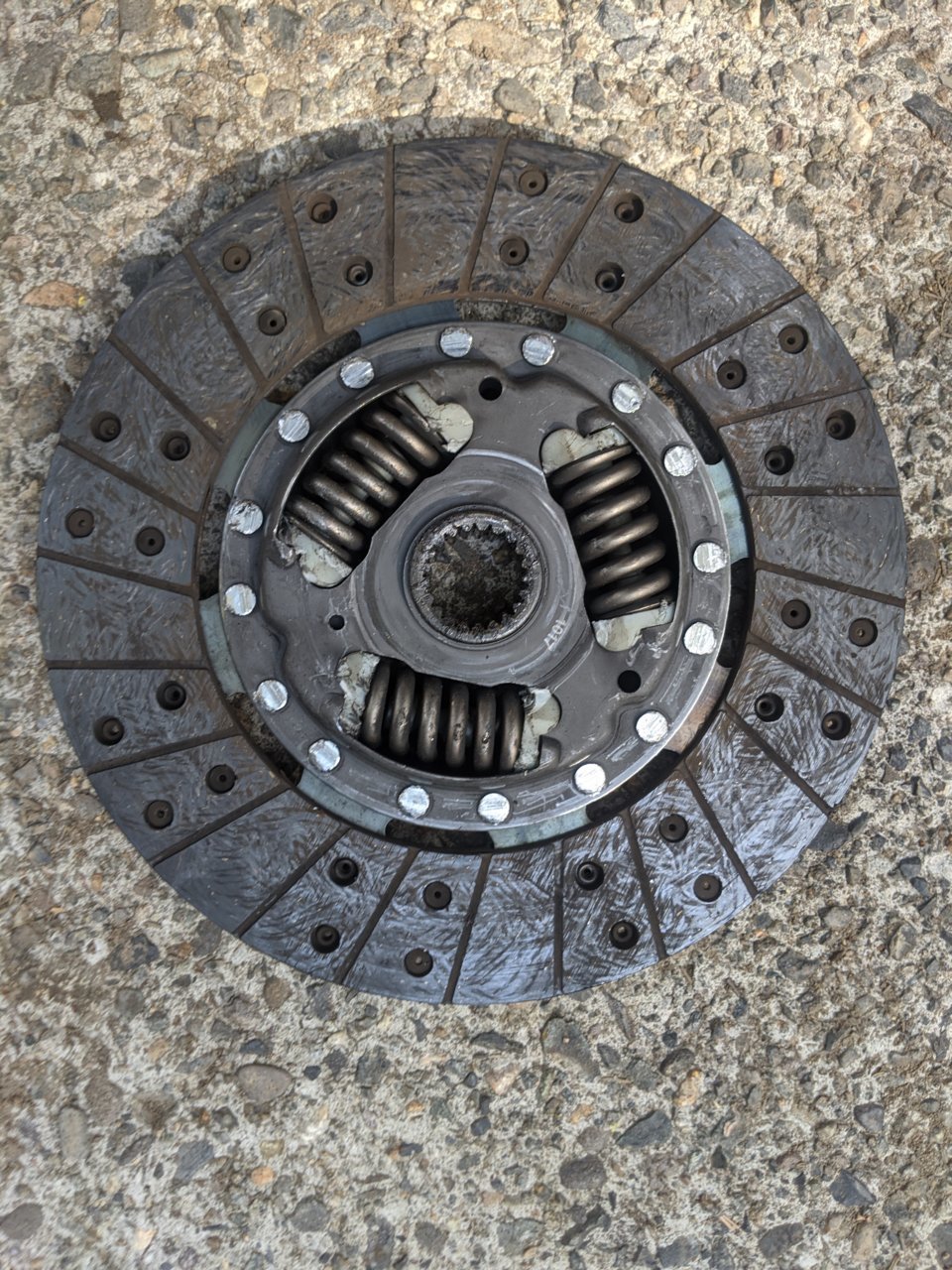

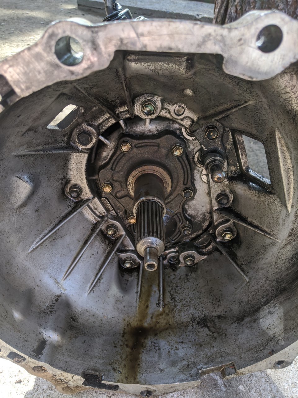

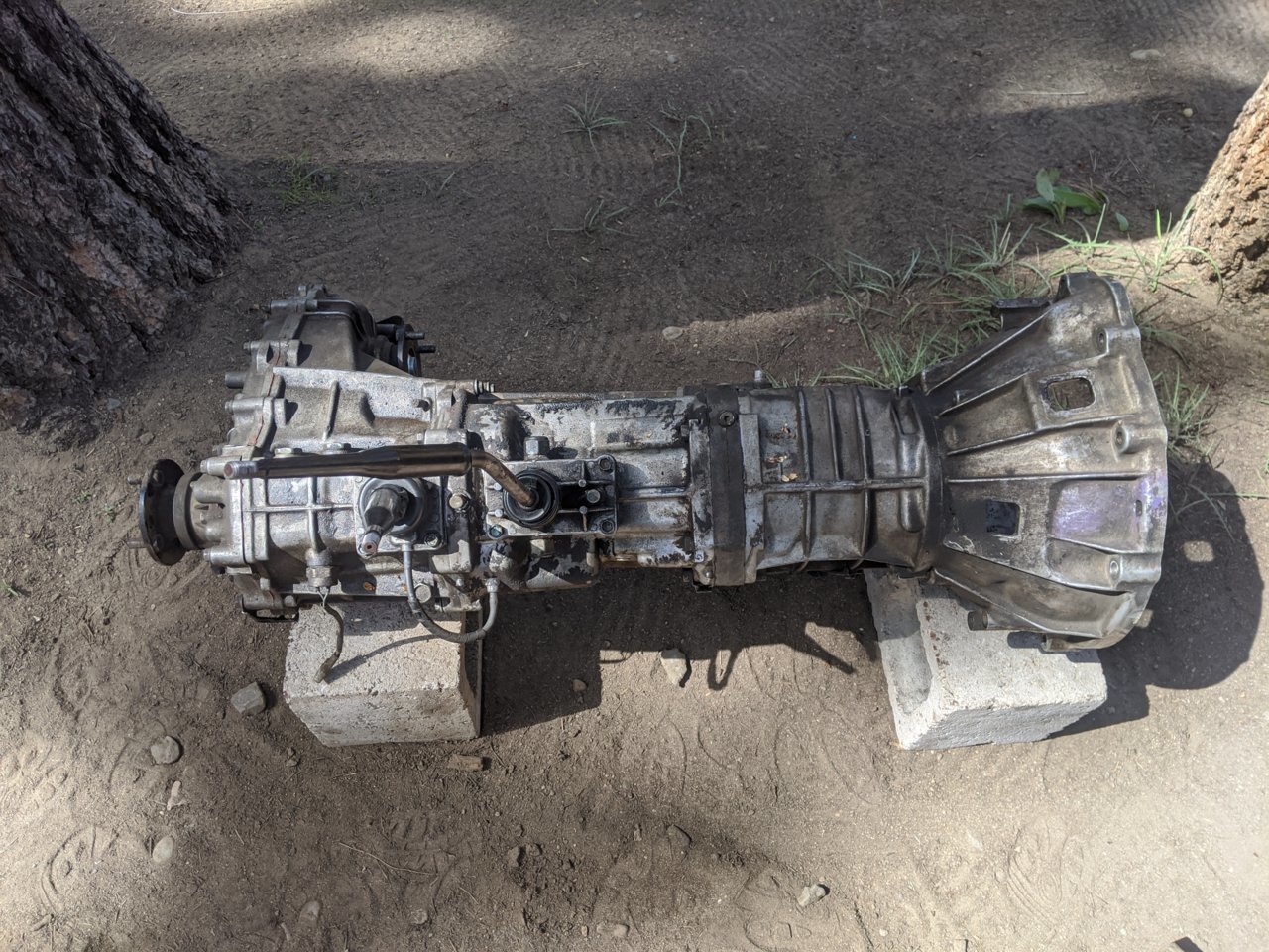

    Pulled the transmission today to figure out why the clutch was randomly getting stuck and not shifting probably. Found a bolt sitting in between the pressure plate and clutch plate. Not sure where it came from. And it did a little damage.

    Bolt still looks good :p

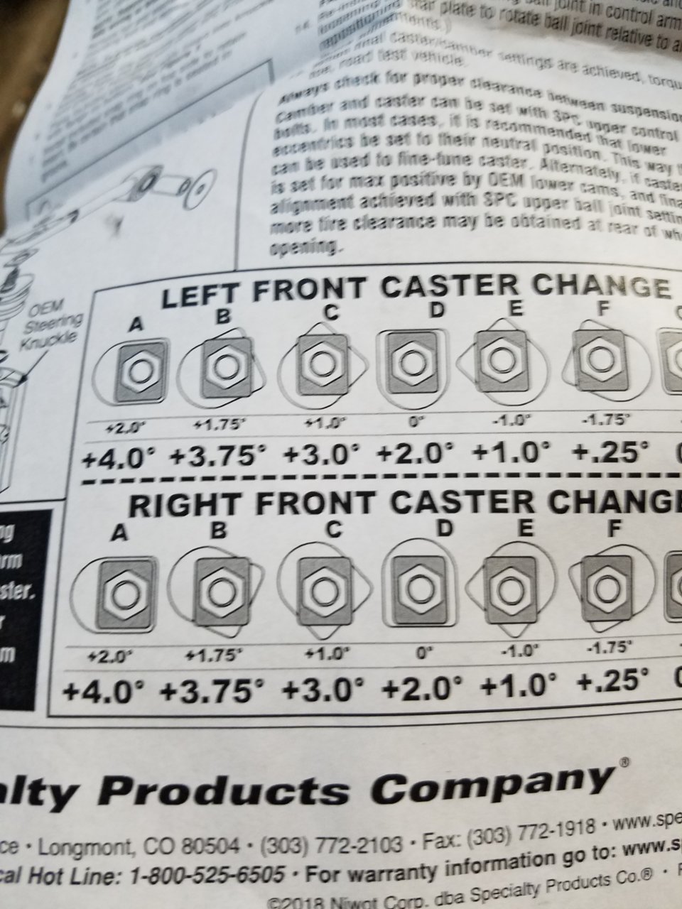

    Moving to the C position which is one back will add ~1 degree more caster

    Yeah I just need to rethread it and grind the top back into shape.

    No bolts missing out of the front of transmission?

    No they are all where they belong.

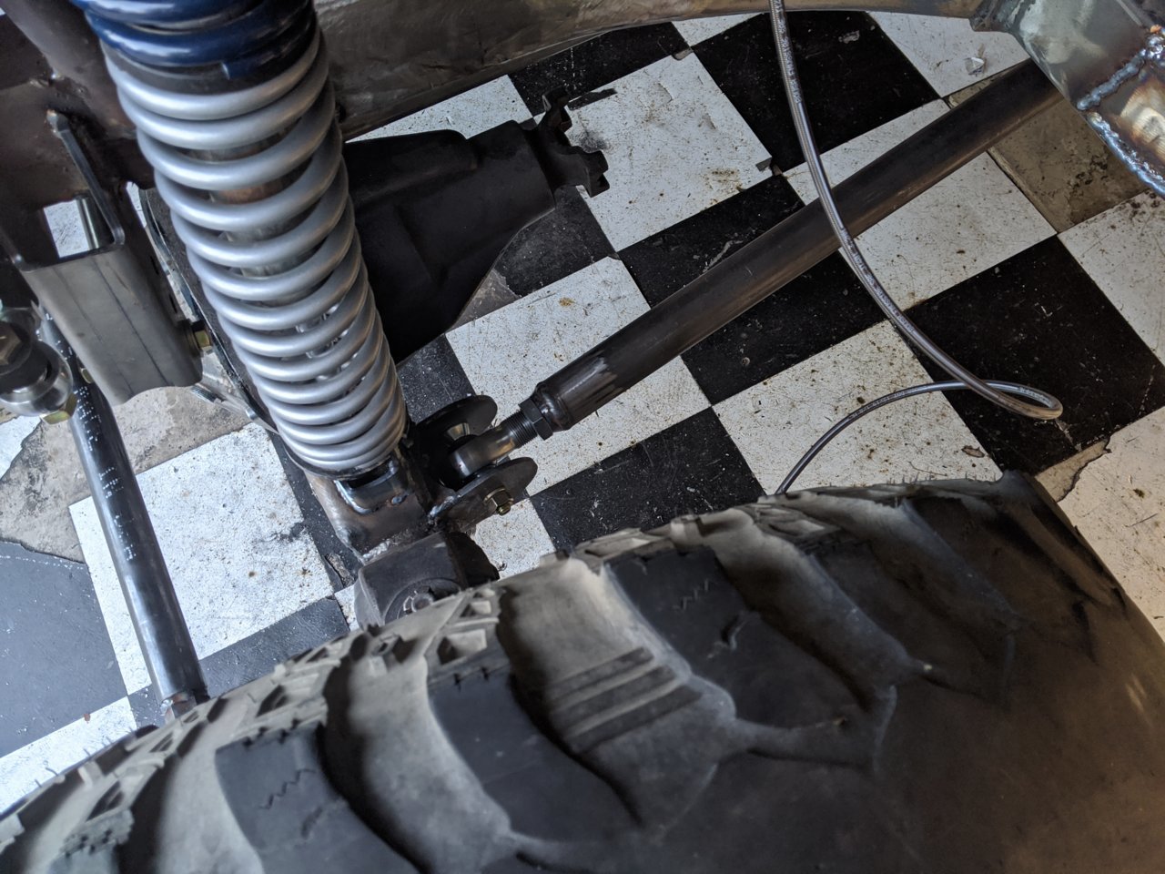

    Mode some ugly brackets and mounted radiator top and bottom, then burned in all steering and links.

    It's the C postion not the E position.

    Keep in mind that adding castor via the UCA will decrease your tire to firewall clearance.

    If you want more clearance have them max the lower cams to push the tire forward. Then everything else can be adjusted via the UCA and tie rod. This is how I do my own and never need to mess with the cams anymore.

    I haven't noticed any destruction of my LCA bushing having them oriented this way. I know some don't agree with it. Just something else to consider.
