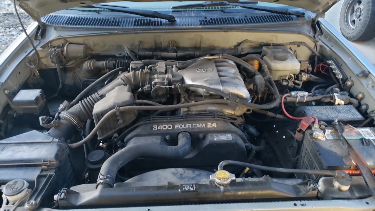

    Timing belt complete ✔
    Also put on the Tcase skid on my truck. But started bullshitting and it got too dark to take a pic :notsure:

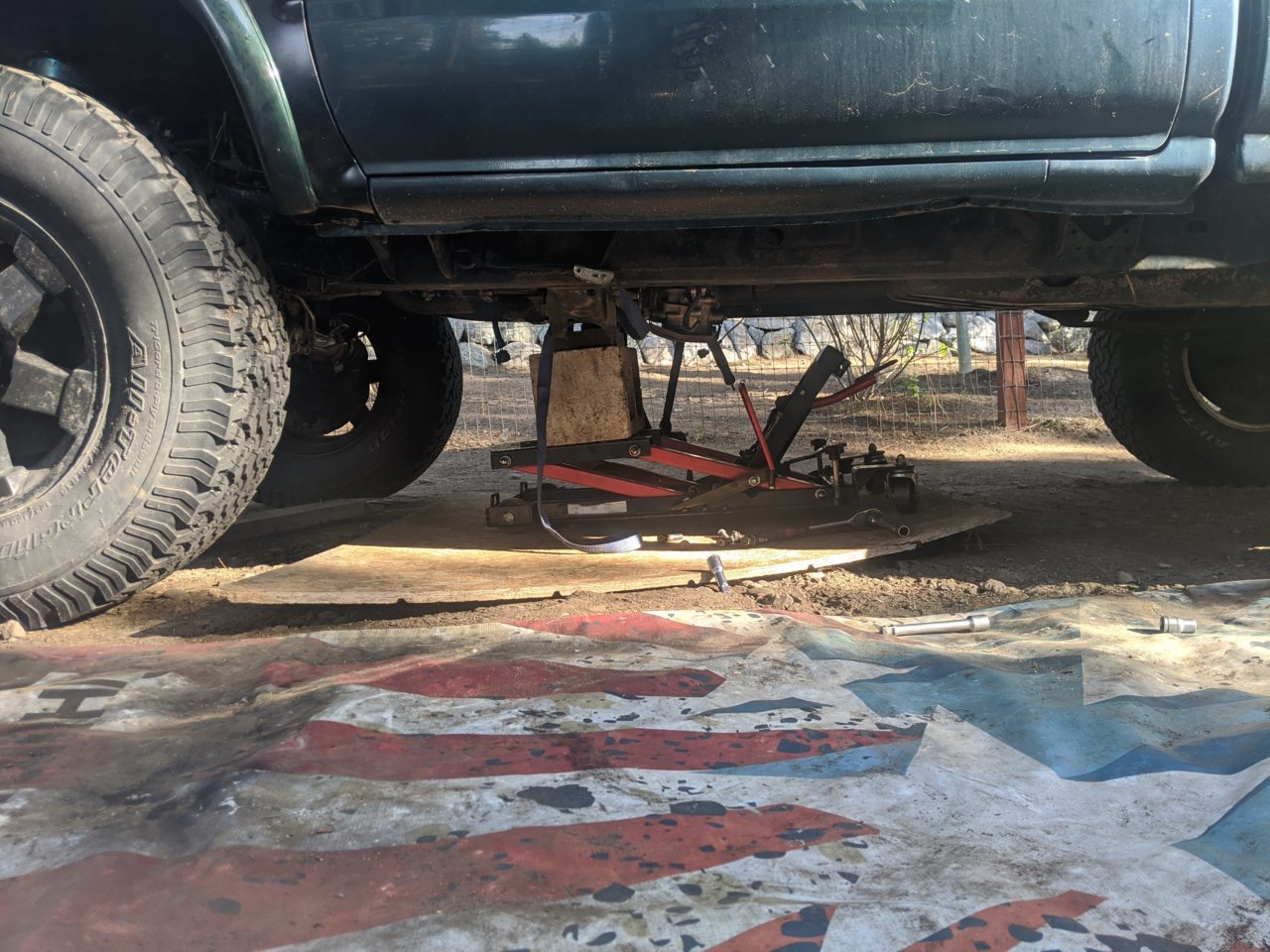

    Got the new clutch in and the transmission back up. It got dark so tomorrow I'll finish the drive shafts and take her for a spin! I'm so tired of laying in the dirt wrenching, I need a driveway.

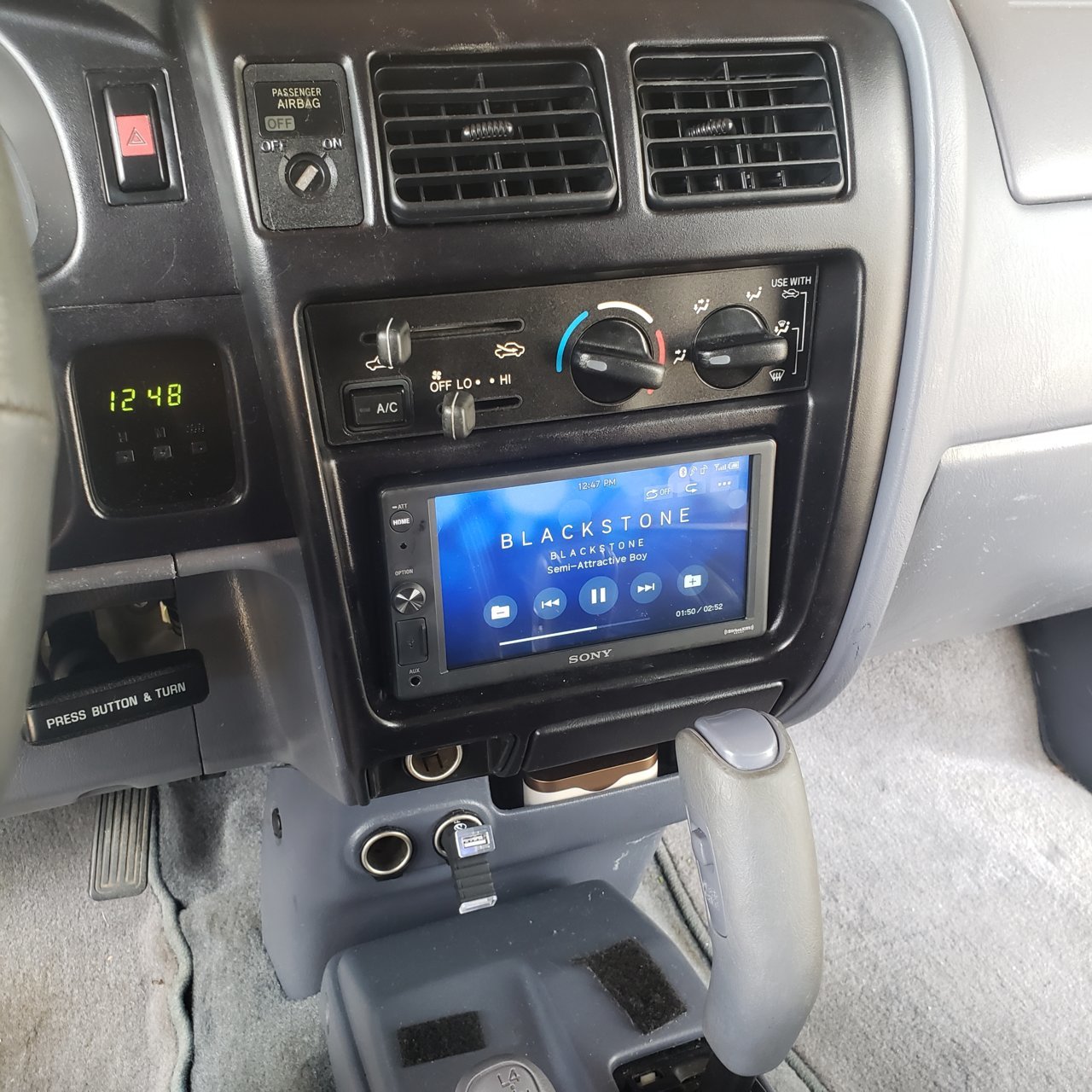

    Finally got a new radio put in!

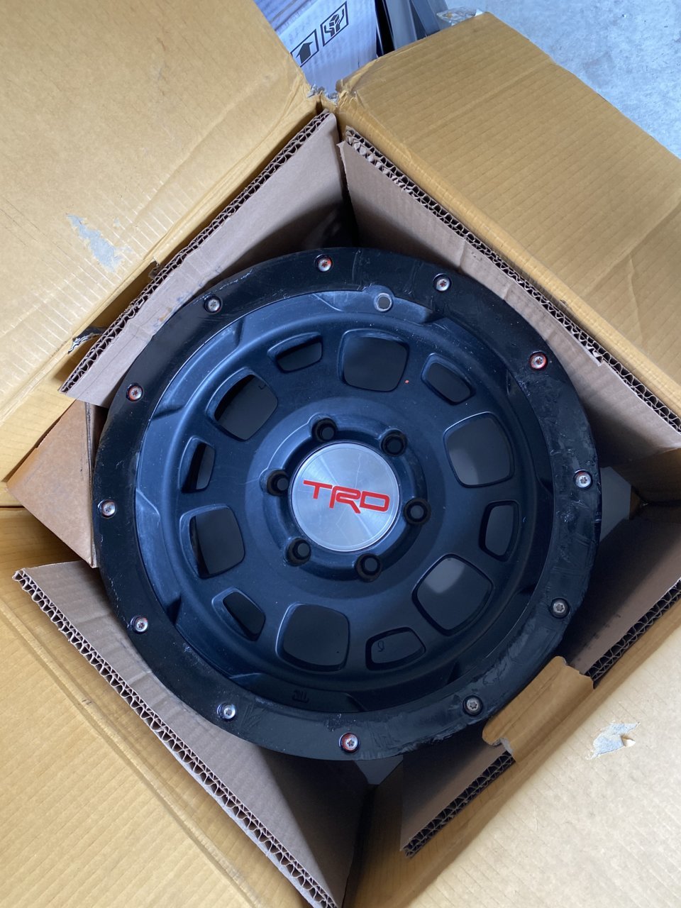

    Leave them, they look great. Great contrast
    What did they run you?

    my rings are super beat up, but heres a picture of one of them black. i dont think i like it as much as the silver look, but my tacos also black and im not a fan of the super murdered out look

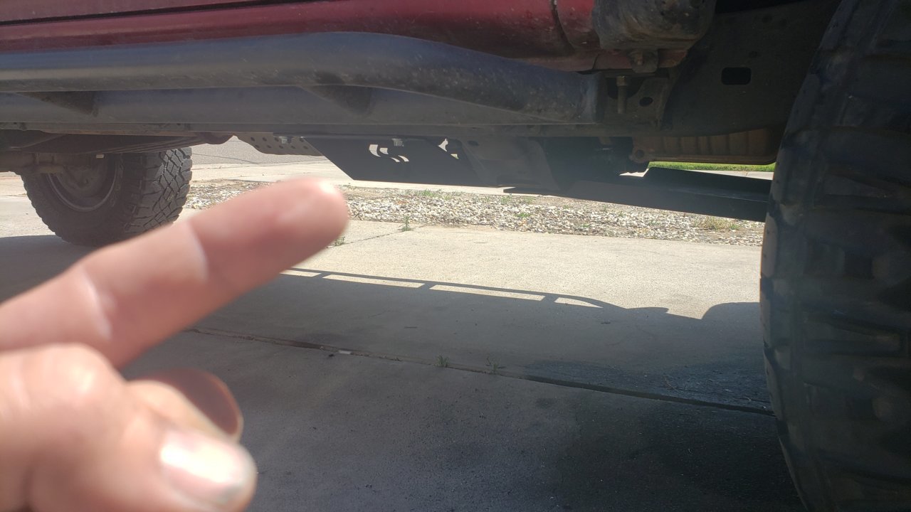

    Another ✔ Transfer case covered by Skid Row Offroad.
    Only minor modifications needed to make them work with my 4xInnovations skids.
    Will probably end up stratigically reinforcing them but I'm going to run them as is for now.

    Well I almost feel bad admitting it but the parts guy at Toyota had ordered these for some dudes tundra and he didn’t like them so I bought them off the parts guy with the new lugs and all for a grand total of $536 after taxes and all. I wasn’t in the market for wheels honestly but you can’t pass up a deal that good

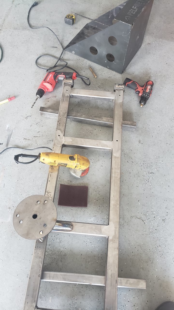

    Gas can carrier ready to bolt up after paint. Waiting on a few other goodies, to mount before paint.

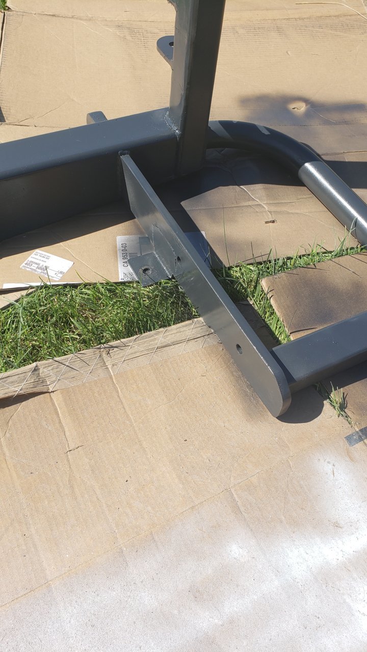

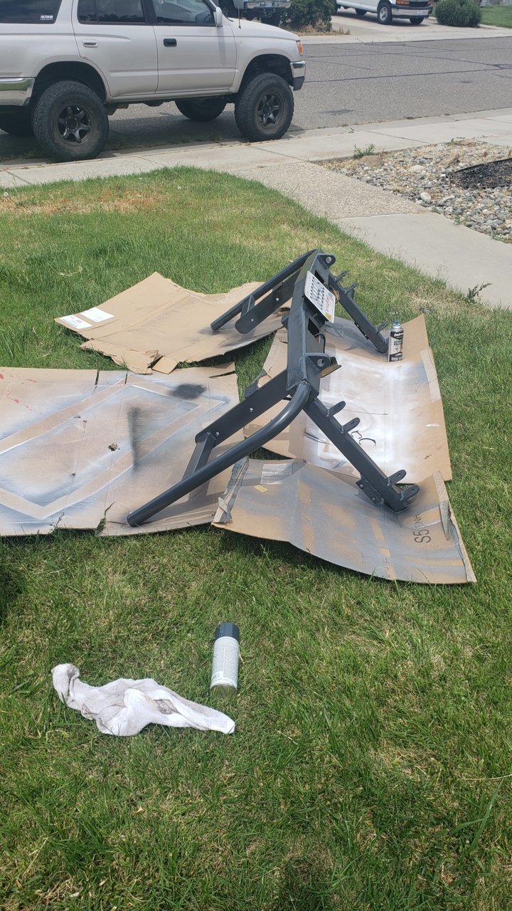

    Fresh coat of paint for the rear bumper :thumbsup:

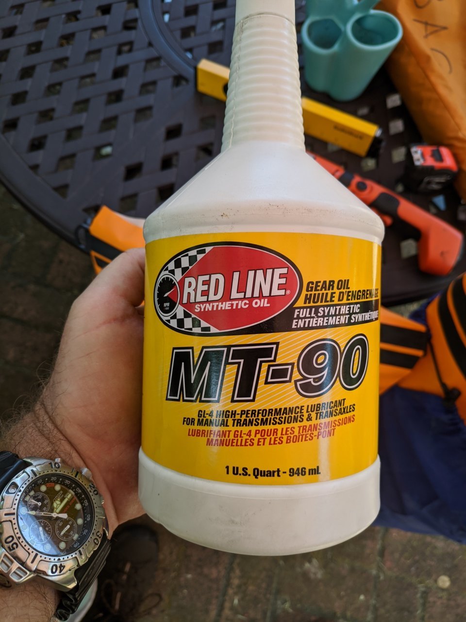

    Finally got my hands on 4 quarts of Redline MT-90 and changed the fluid in my transfer case and manual transmission. The first time I did it what came out of the drain holes was black and smelled like death from the depths of hell. This time everything looked good enough to pour over some vanilla ice cream but sanity prevailed. This was not really worthy of a picture but just to shut you all up preemptively... here you go

    Slap the belt cover on and call it good!
    Is this tying into the bed also?

    I wish... lol... The water pump was beginning to leak so it wasn't quite that simple.

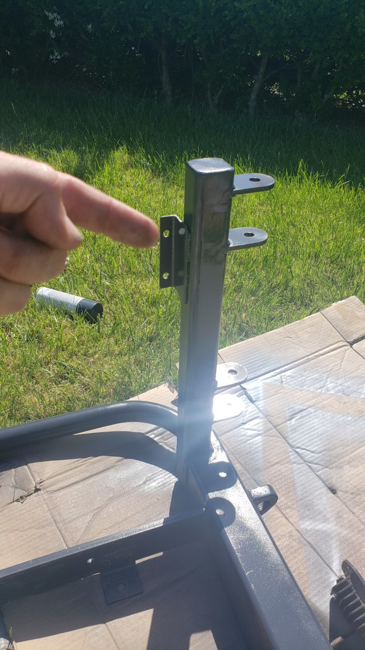

    This bracket bolts to the (former) tailgate latch mounting points.
    The bumper brackets are also 1/2 flat bar, mounting like a class III Reciever hitch. The 1/2 flatbar runs through the bumper solid and the tow points were shaped out of them. (in other words if you pull from the tow point you are pulling 100% on the frame, not the bumper.

    @Reh5108... The posts were also connected to the bumper like this. I don't even think I need the tabs that mount to the tail gate latch mounting points. Posts are 2x2 (3/16th wall)

    Can't hurt to have them. Seems like a pretty stout setup.

    It's been good for about a year. I'm just kind of re-configuring a few things I wanted to change (that I learned about when using it).
    It used to hinge on the pass side. But our camp is on the pass side (awning is on pass side) So we had to walk all the way around the swing out to get in the bed when the swing out was open. Now it swings from driver side. We're going to set up the kitchen area off the back of the truck now.
    Also the tabs for the hinge and pins were pointed in where the swing out was between them. Now the swing out is mounted on the back of the posts. Now the tabs for the latch pins, and for the hinges wont be in the way loading the bed. It also moves the swing out back giving me increase in bed length of about 2.5 inches. (Doesn't sound like much, but it is).

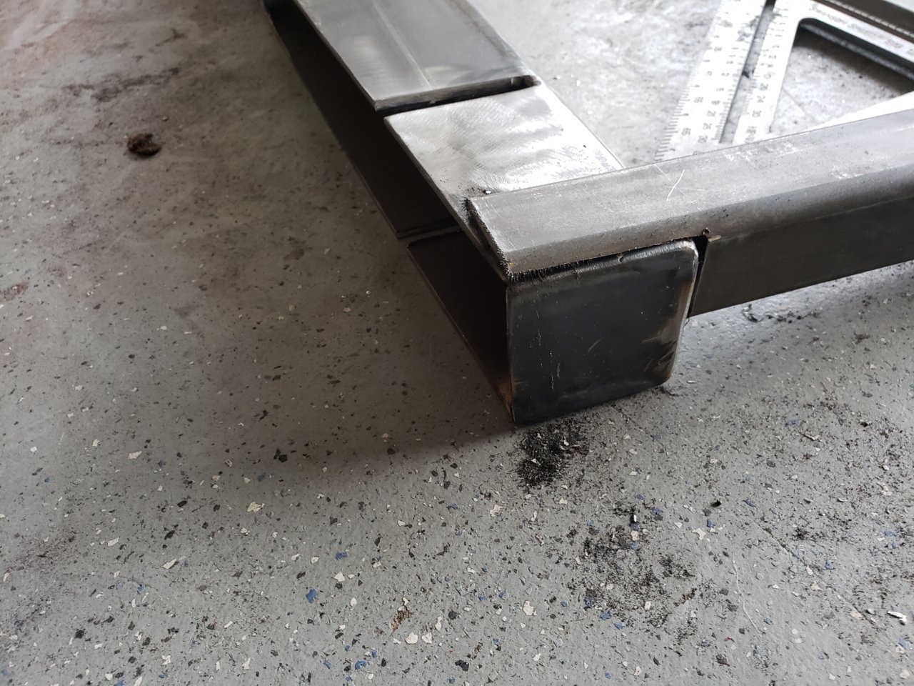

    @Reh5108 I figured pictures would make it easier to get what I just said. lol
    The tabs for the hinges and pins were inside the posts... like this.
    Now they are on the back of the posts... like this.
    When I did that, I had to completely redo the swing out, because the length increased, I also had to change the side of the swing out, I put the tire mount on, because I want the tire on the side closest to the hinge.
