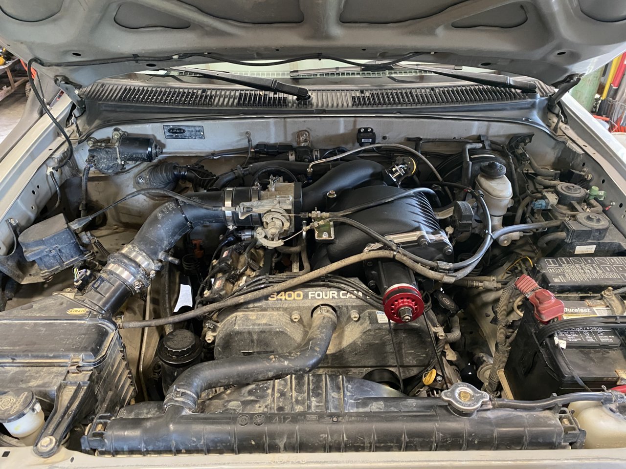

    You're radiator hose is backwards.

    Yeah I know. Been like that for years. Haven’t been motivated to switch it around

    As long as it isn't rubbing on the fan shroud it shouldn't matter.

    Usually thats alt
    My moms cruiser made that noise for years and my 4 runner has made it since i got it
    Even my buddies ask if my 4 runner is supercharged cause it sounds like a baby sc whine

    It’s not

    Lol. Baby sc! There we go!
    Hopefully whatever it is it wont take a dump or get worse while im in the woods

    Is yours aftermarket
    My runners alt is from autozone and my moms is from O'Reillys
    My tacoma and camry with their factory alts never made it

    I have never changed it. Im assuming its oem

    Idle bearing, PS pump or AC pulley are the 3 i always look at when I get a whine. when that Idle bearing goes it is very loud and distinct.

    Thanks rob. I think ps is good. Its gotta be one of the others. I'll keep on eye on them

    On f150s the idler pulley is always the first to squeak as well. Happened on my dads. Don’t buy no cheap plastic replacement either... but you already knew that:thumbsup:

    The idler one is easy to check from underneath, mine was obviously bad because you could wiggle the pulley and feel the play/looseness in it, which shouldn't be there

    I can dig up the link for the bearing if it is your idler. There pretty cheap, I bought a couple spares to keep in my parts container... because mud.

    Sweet. I'll check tonight

    If you've never changed it, I can almost guarantee that that's your problem.
