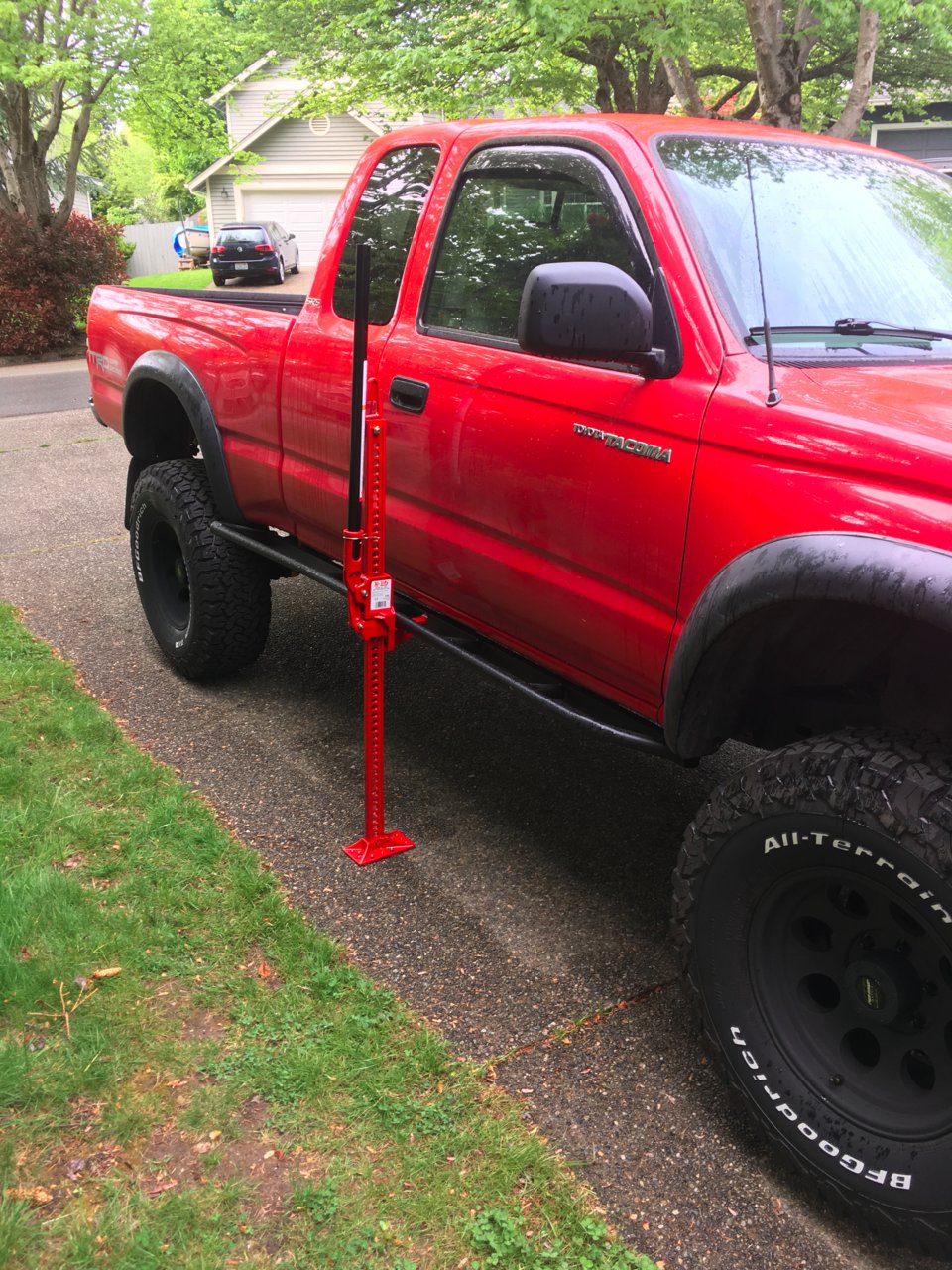

    gave my sliders a test run with my hi-lift
    looking at the picture now it doesn't look like the tires are actually off the ground... trust me, they are:D.

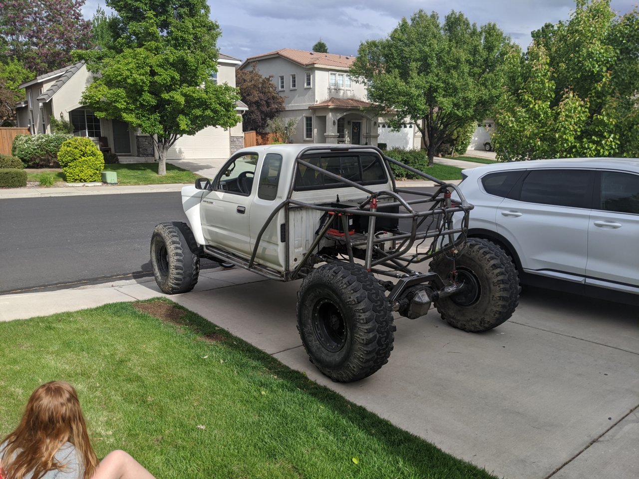

    First time out of the garage in 4ish months

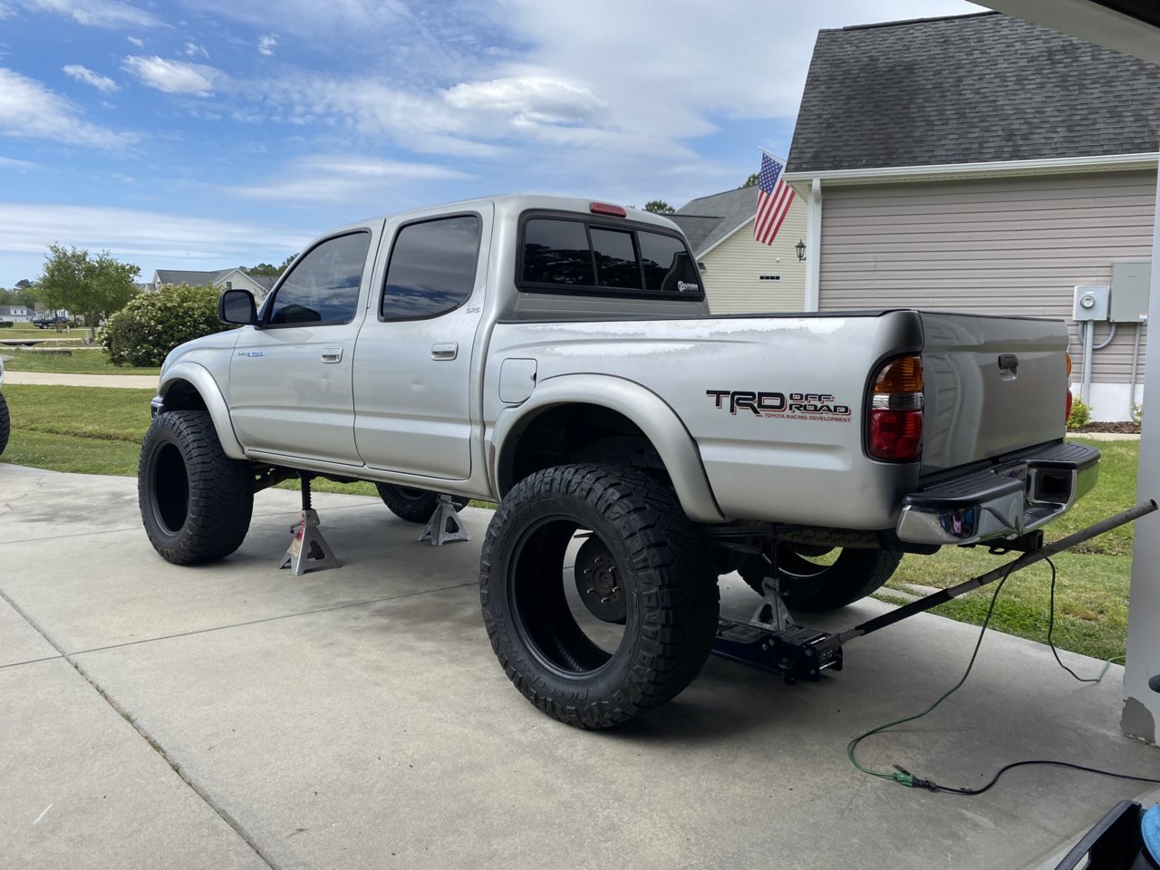

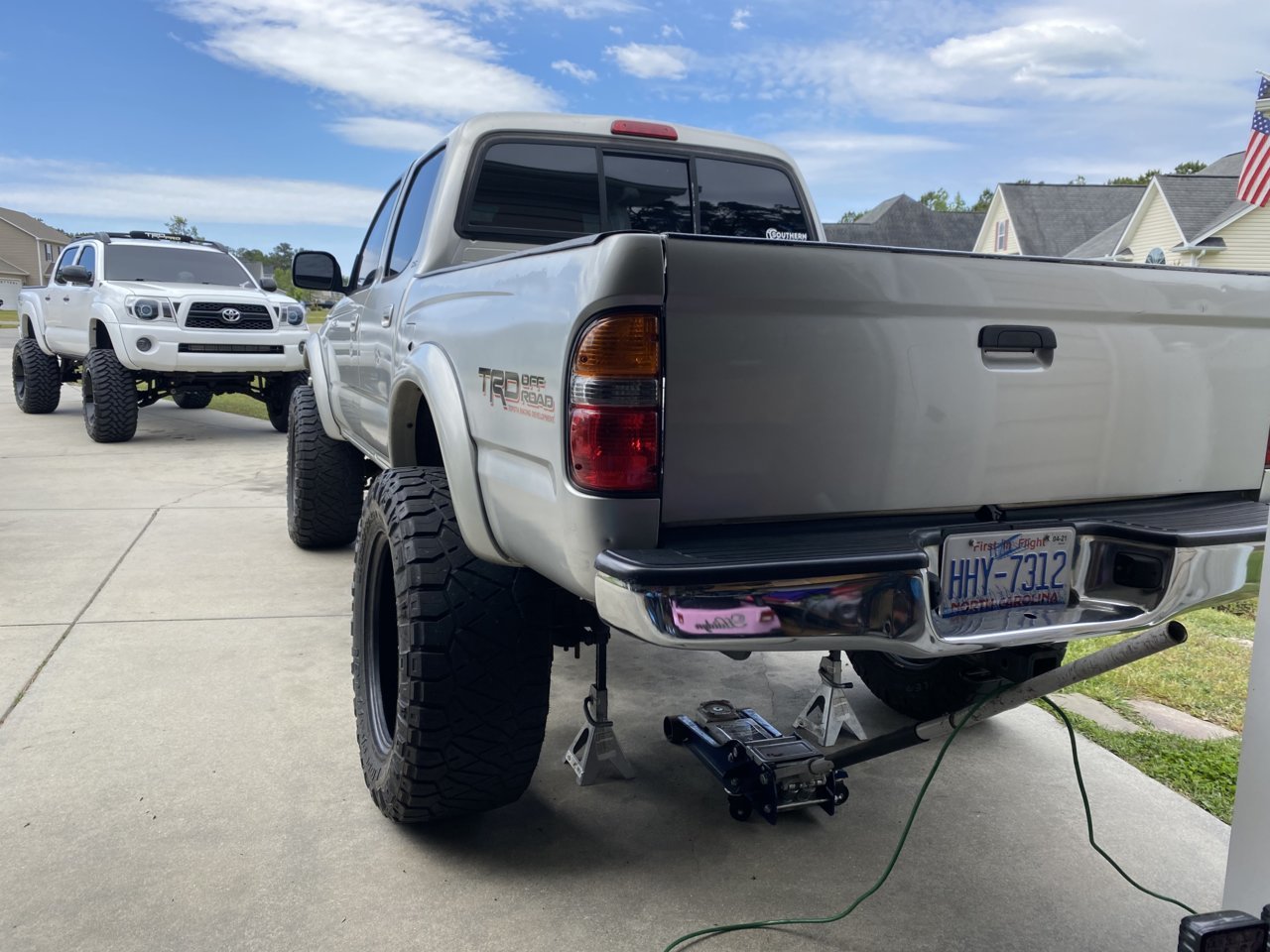

    SCS Ray 10 and new tires going on today

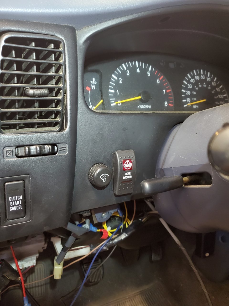

    Tundra guys love it. I’m going to have to figure out the cable situation. But should be easy enough since I don’t have a body in the way
    If I like how it all fits, the tundra will get it too

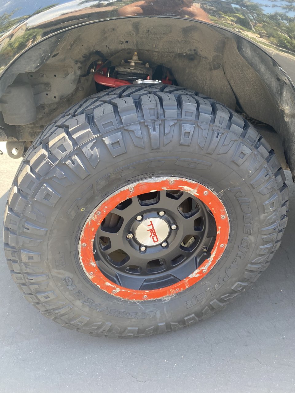

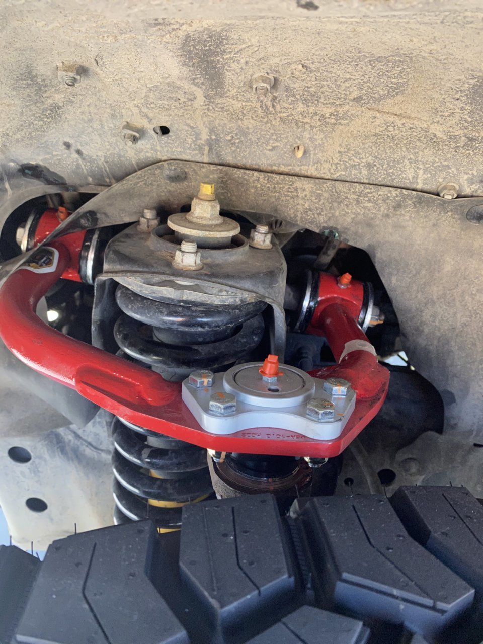

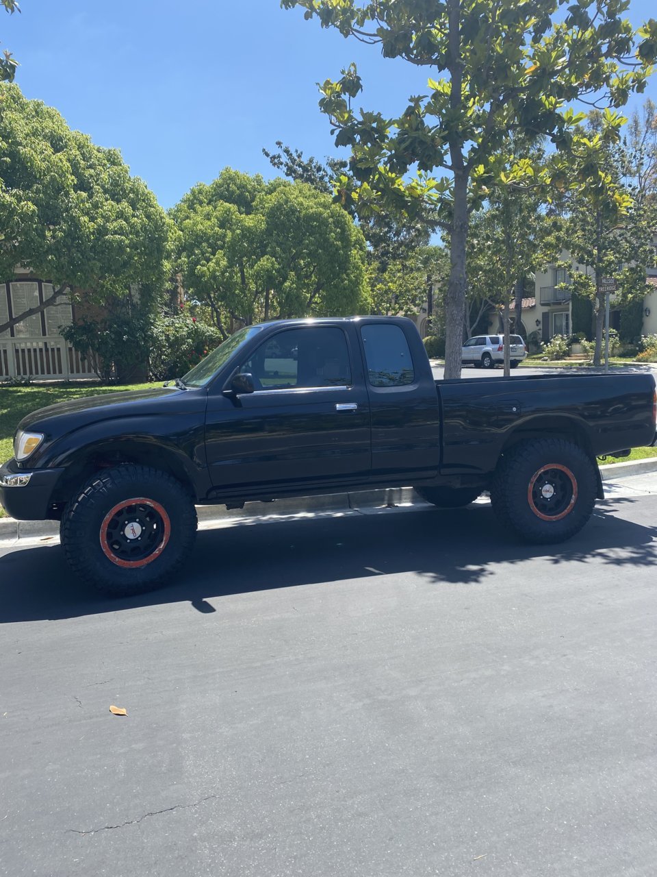

    got the TRD beadlock wheels installed with 285/75/16 nitto ridge grapplers. didn't end up needing a spacer and did not need to trim as much as i thought. will probably adjust trimming and what not as i go, still rub a TINY bit on the frame at full lock reverse. JBA uca installed as well got me 4 degrees of caster which helped. the JBA is pretty low profile and can still fit a hand in between the space between tire and UCA. also changed lbj went with OEM.

    looks great! digging the red bits too. adds a nice pop of color to the truck!:thumbsup:

    thanks! yeah the original plan was to sand and clean them up and spray them black, but i like the beat up orange/red for the contrast!

    yeah, i'd just leave them the way they are. they give the truck a kind of trophy truck/baja 1000 vibe:cool:. like i said, looks good, almost makes me regret my wheel choice;).

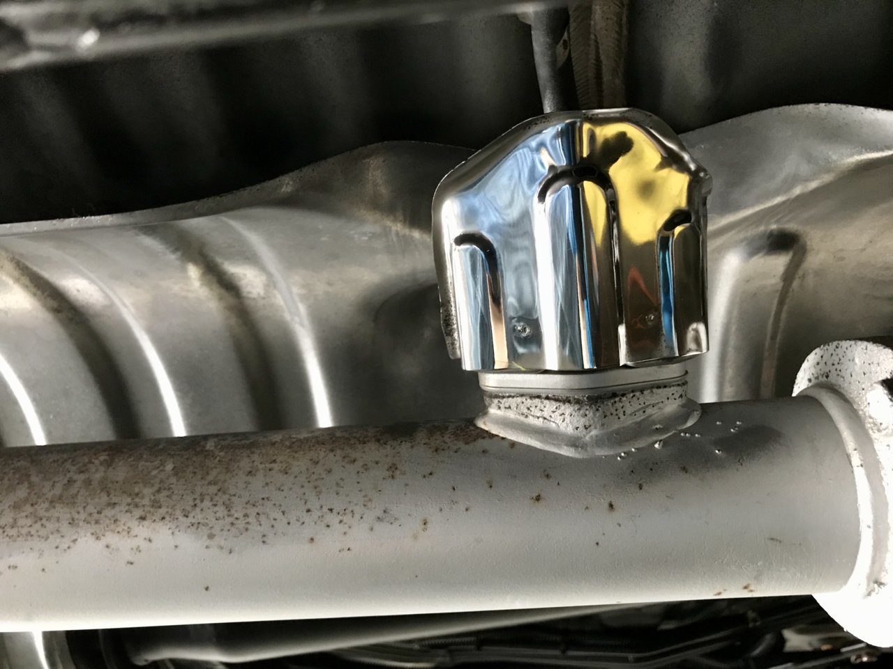

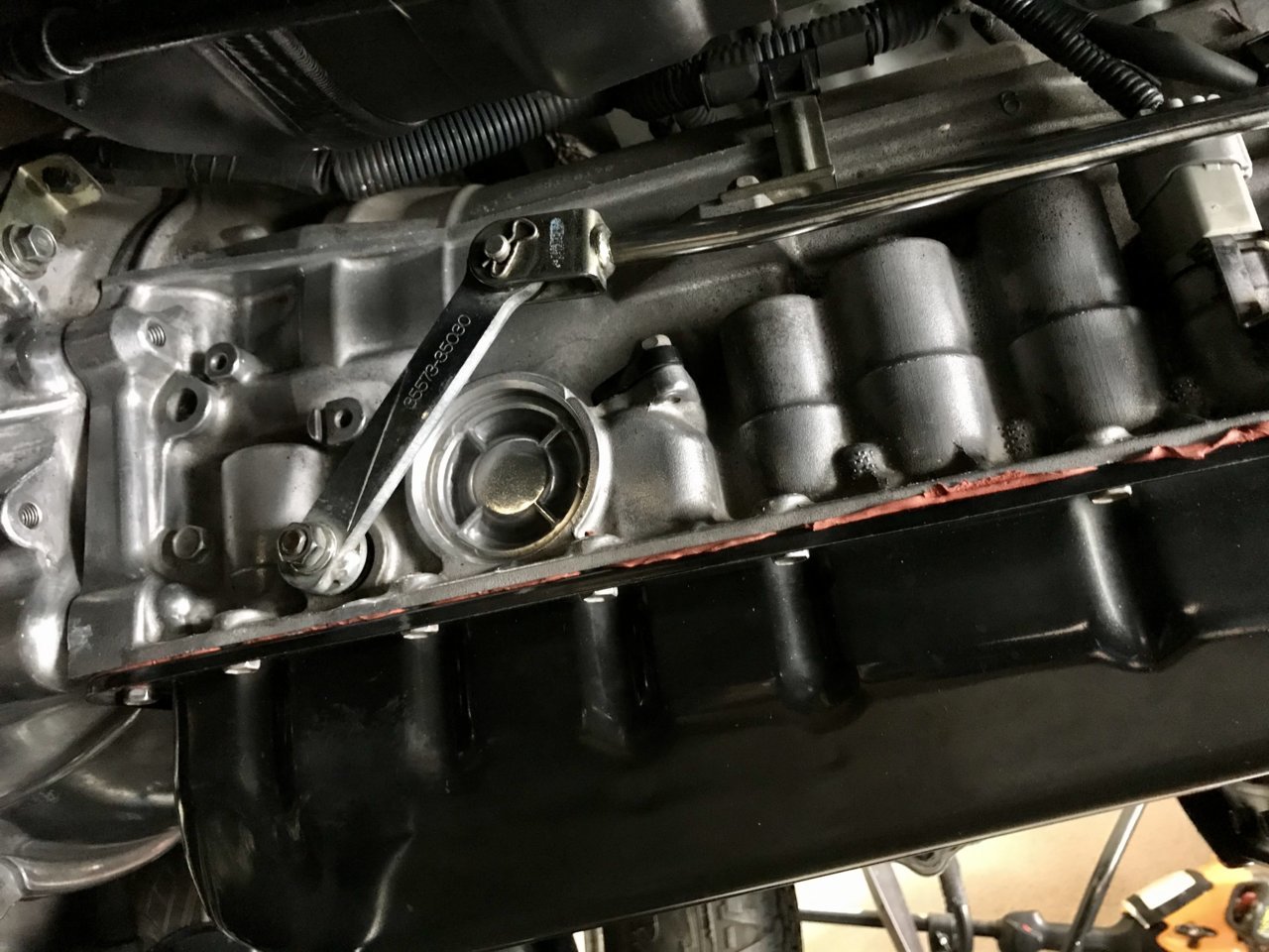

    Polished up the O2 sensor shield and the transmission
  16. May 14, 2020 at 4:02 PM
    Running Board Man
    Running Board Man Well-Known Member
    Feb 19, 2017
    #211024
    8,801
    none of my 02 sensors have had shields
    Hooks98tacoma and Taco critter like this.
  17. May 14, 2020 at 4:20 PM
    eon_blue
    Mar 4, 2016
    #180213
    69,806
    Azusa, CA
    Because most people just cut them off when it comes time to replace the sensor
  18. May 14, 2020 at 4:34 PM
    se7enine
    se7enine MCMLXXIX
    Apr 18, 2013
    #102322
    23,442
    Reno, NV
    They don't come with the Denso's I buy. Did Toyota put them on?
  19. May 14, 2020 at 4:36 PM
    eon_blue
    Mar 4, 2016
    #180213
    69,806
    Azusa, CA
    yeah it's not a part of the 02 sensor itself, doesn't come with the new sensors. It's just a tiny little "skid plate" or guard that Toyota puts on them from factory.
    They're a pain to get off though because the nuts that hold them on are behind them and you have to blindly work them loose, easier to just take an angle grinder and cut them off.
    I cut mine 3/4 of the way so I could bend it down and then bent it back up into place, most people just take them off though
