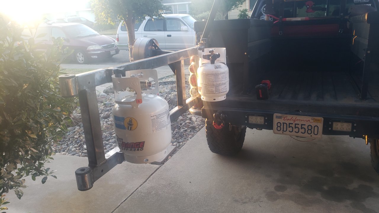

    More progress was made on the swing out. Fabricated mounts for my two 5 pound propane tanks.

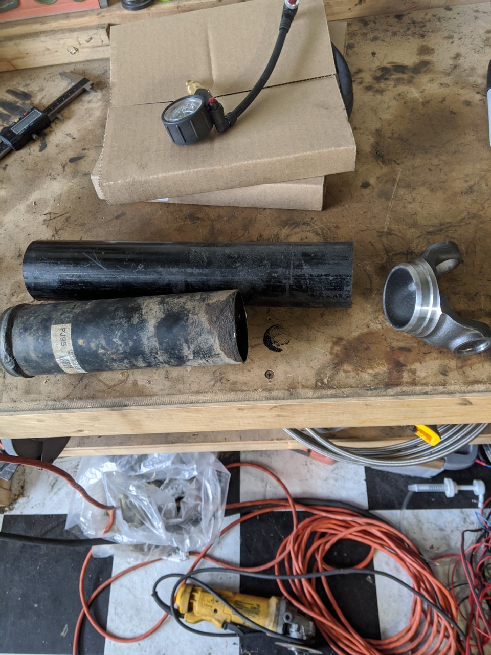

    Made it halfway through the front driveline lengthening. But I didn't like the fit.

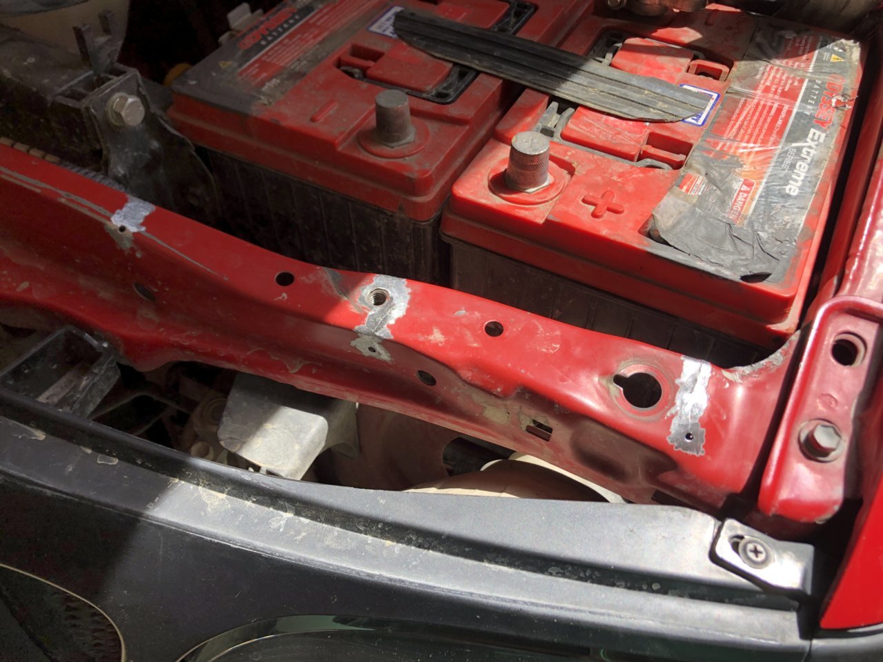

    Addressed some issues from rallying the truck with 100 lbs of batteries in the stock location. They'll be getting relocated soon.
    My truck lately:
    Drilled the ends of the cracks to stop them from spreading:
    All welded up and sanded:

    How's the core support look where it mounts to the frame?

    No issues down there yet.

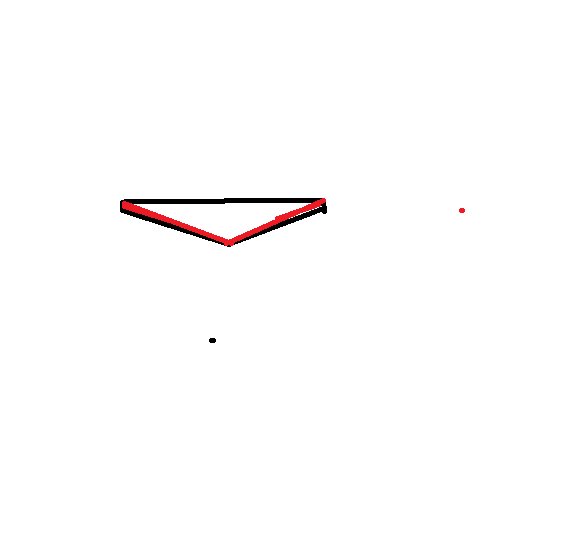

    I've run into issues putting that same switch in that location. Sometimes the switch will drop in to far causing it to limit the switch throw and not work. If you have the same problem do this. The rocker part of the switch pops off easily with a screwdriver. Then file off the red part in the diagram, that will give you more throw in the switch.

    Have you done the rear frame plates on your truck? That's a lot of weight to hang out there.

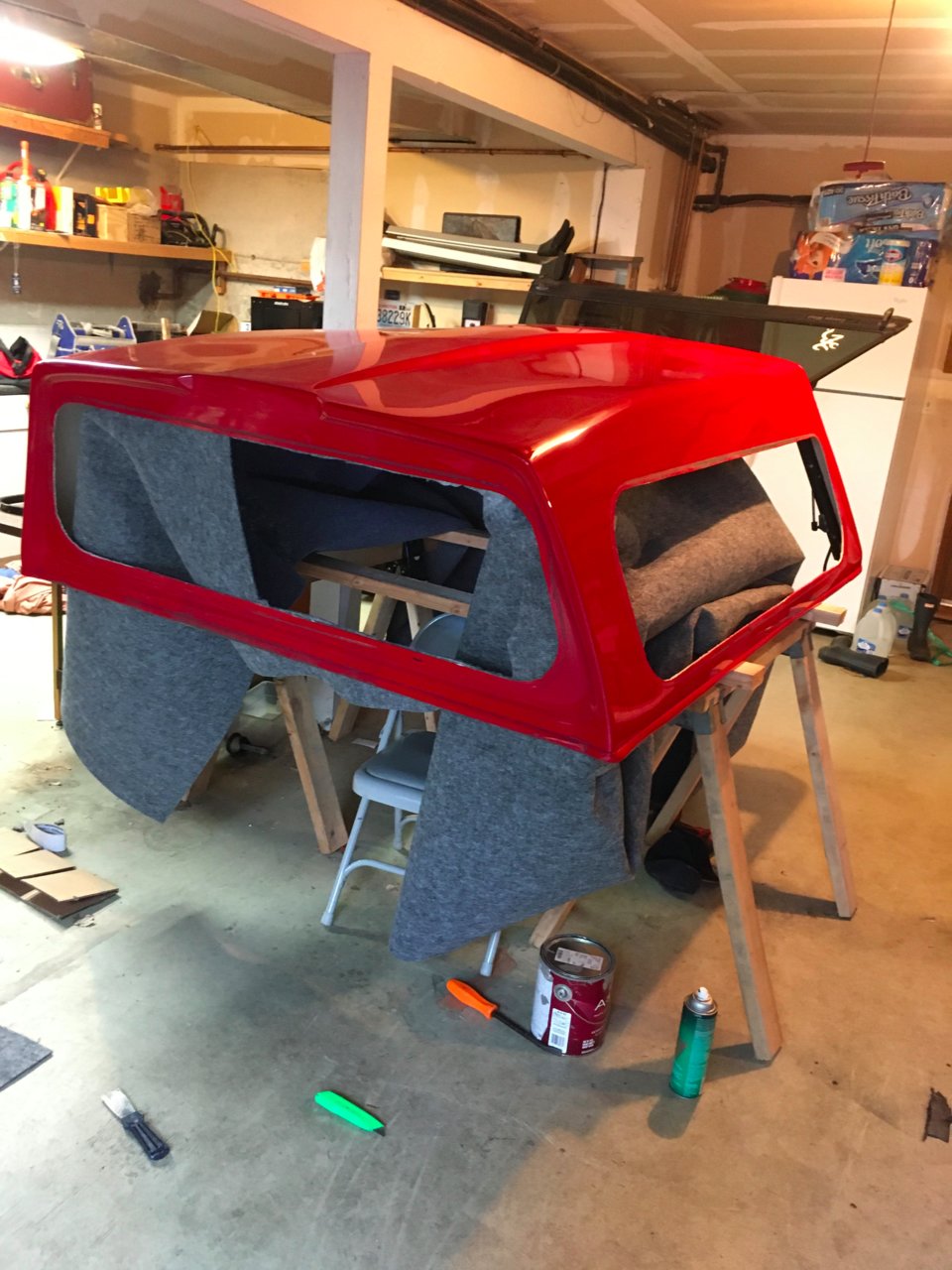

    worked on carpeting the interior of my topper. soon i will be installing new windows too, going with a set of vented Windoors.

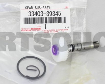

    I found my speedometer reads about 5% too fast with my smaller diameter tires I am currently running.
    So today - I pulled out my speed sensor gear and found a 30 tooth from the factory, and ordered up a 31 tooth hoping to get it within 1-2% of actual speed.
    This should help me from hitting the 108 mph speed governor a bit prematurely too! :thumbsup:
    Leaked a bit of dirty looking tranny fluid in the process, so I also ordered up some Red Line MT90 GL-4 to flush and fill while I install the new speedo gear. Hoping for smoother shifts from my W-59 and maybe a bit quieter on the sounds coming from the tunnel.
    This forum says it should be smooth as butter and feel like a whole new tranny, cant wait to see for myself!

    No. But they are on the sort list of things to do.
