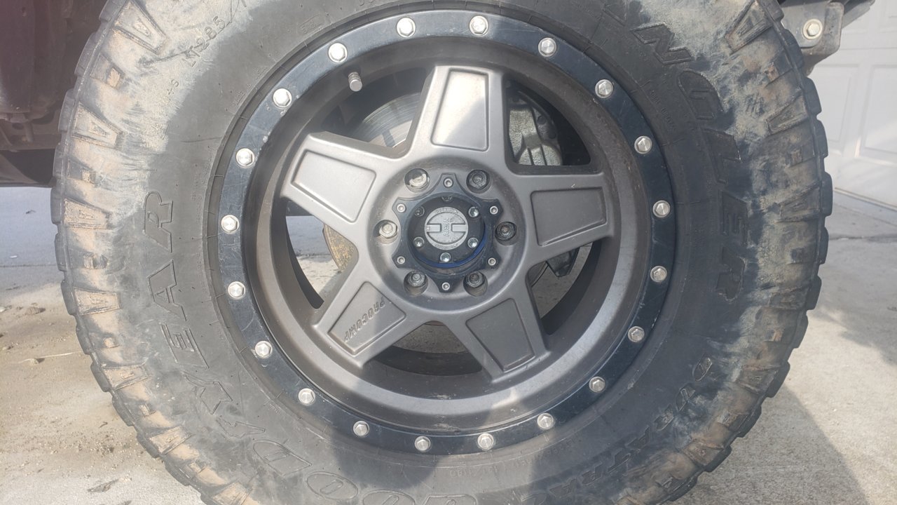

    OME nitrochargers, Dakars+AAL, JBA UCA 285/75/16 Nitto Ridge Grapplers on TRD baja "beadlocks" Flippac
    traded the black trd beadlocks for these graphite ones
