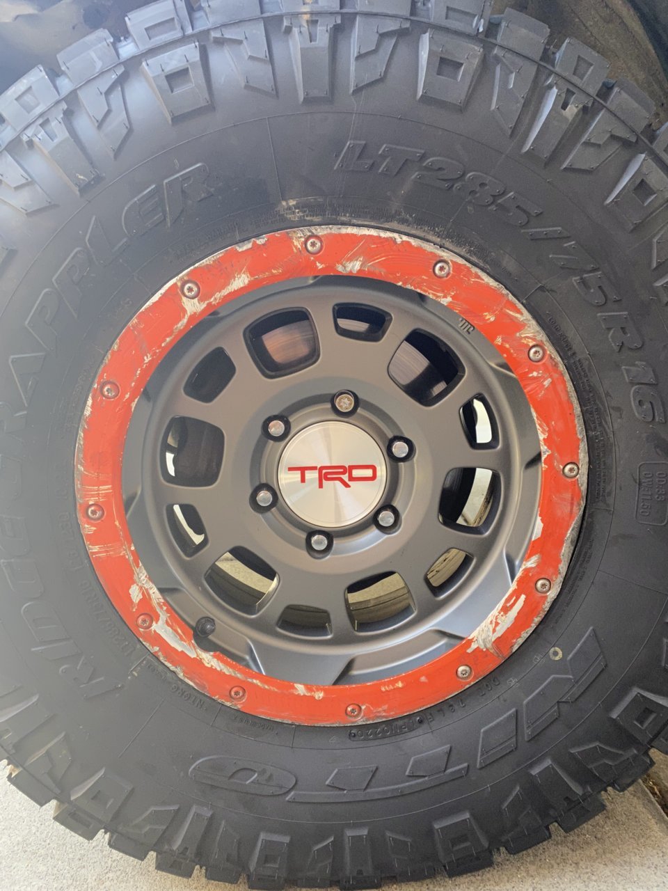

    I don't see any reason why any wheel would interfere with manual hubs

    I haven't personally read about it, but I am sure someone probably has. I can tell I am gonna need to add a leaf to my OME setup because it sags in the rear when loaded with just camping stuff.

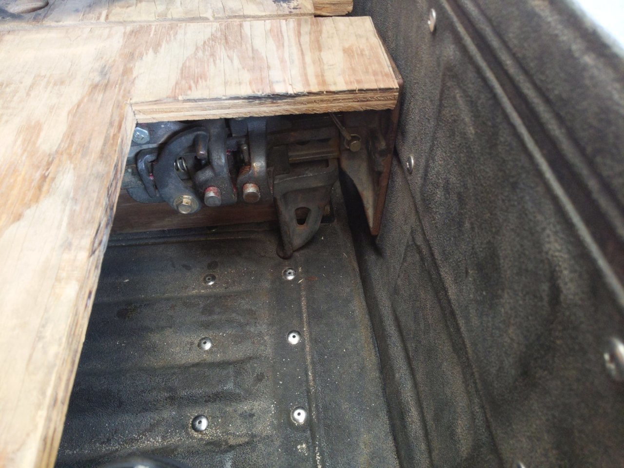

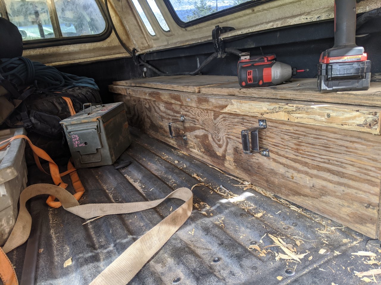

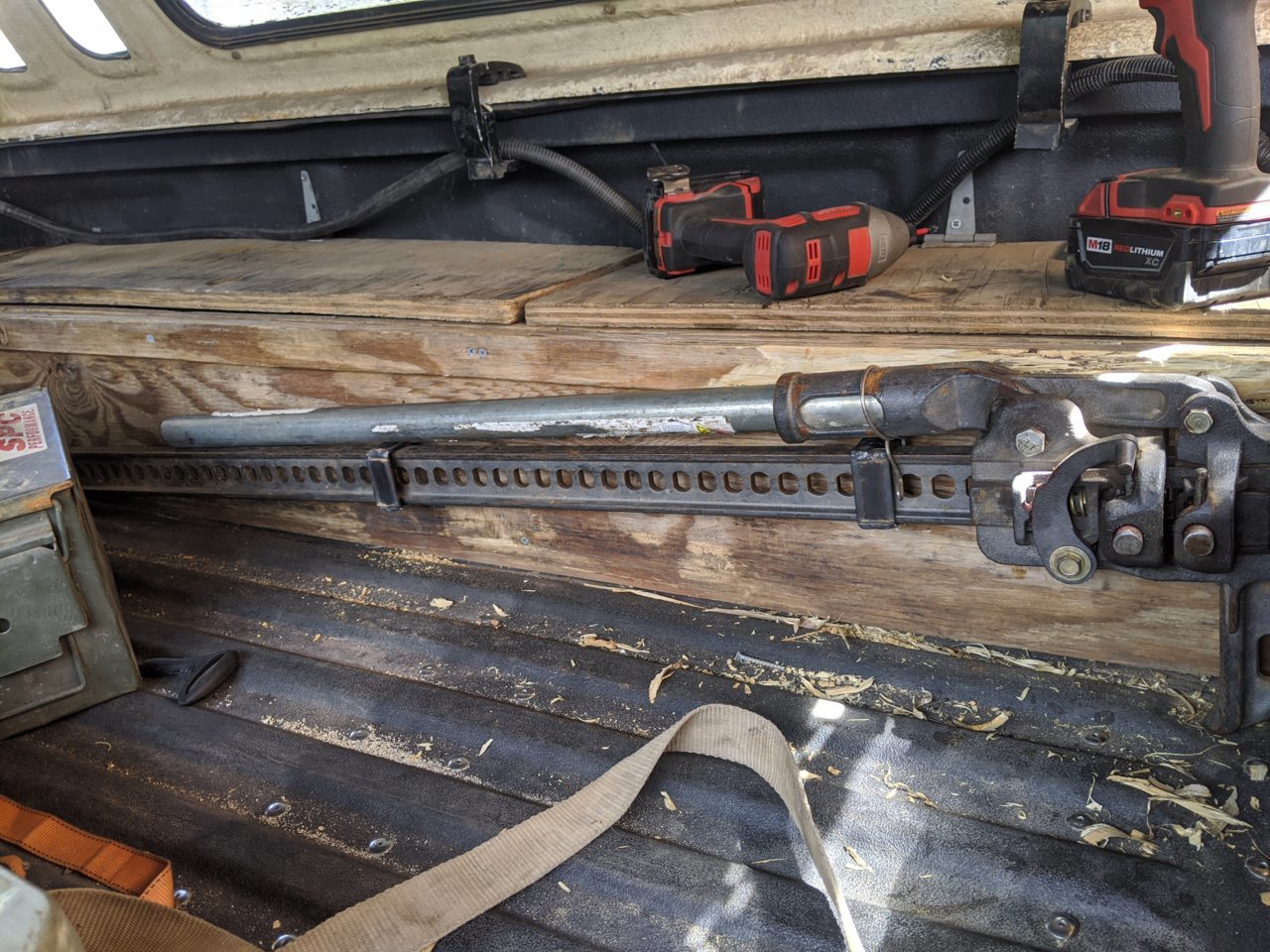

    Finally mounted my hi-lift after years of just letting it flop around the bed at will. Slides in, no tools needed to remove. I use mine all the time so it's nice to have quick easy access to it.

    Thanks for the information. The only wheels I've found that tick all my boxes are the F5's from Stealth Custom. But they don't offer it in a 4" BS, so I am considering the 3.5" BS 16x8, as those are the only wheels they offer that fit over manual hubs without machine work (adding additional cost)
    Here is a link to the wheels. Question is, would .5" enough to make look bad / handle weird? This is one area I have almost no experience in so am learning a ton as I go. I for sure don't want half my tire sticking out the side of my truck like you see some do (no saying anything is wrong with that, just not for me).

    The center bore is not big enough to allow the hub body to pass through, on some wheels.

    you should be fine with 3.5" bs. my only concern would be how many rocks the tires would kick up. it'd look fine i think but you'll deff be loosing the mud flaps with the 285s so if the wheel sticks out more, then you'll be looking at more potential for rock damage.

    yeah, on my old truck i ordered a set of wheel spacers from allpro to get some new wheels to clear my calipers. they were supposed to be lug centric (to clear the manual hubs) but they wouldn't fit over the hubs. sent those back and cancelled the wheel order. figured it was getting to be more trouble than it was worth.

    @osterhagen SCS also makes the Ray 10, which IMO looks a whole lot better than the f5. more importantly though, they make it in a 16x8 with 4" of bs for the tacomas. not sure if they work with the manual hubs but if the f5s do then these should:notsure:

    For our trucks (lifted with oversized tires) I think 3.5 backspace is the perfect spot to be in. I run 3.5 back space... you would just be doing it without spacers (which is better anyway)

    Yeah that is what made sense anyway. People with 4 say they still barely touch sometimes depends on tire. So this gives me more wiggle room anyway. Thinking of going with Goodyear Wrangler Duratrac's in 285/75/16. Still looking into tires though anyway. Won't be buying them till next week still :)

    Yes and no. I've seen a forum post where it said they fit, but I emailed the company directly and was told the F5's are the only ones that will fit without modification.
    Here is the thread: https://www.tacomaworld.com/threads/1st-gen-manual-hubs-with-scs-wheels.612074/#post-20741360
    Here was their response via email:
    "The only wheel model that is a direct fit to your 1st gen Tacoma with Asin manual hub his our F5 model. Our other model with center caps including the BR6 model will not.
    The BR6 model has a small lip inside the center bore that the cap snaps into. This 1/8" lip will need to be machine off for it to fit without interfering with the front hub. Many of our previous customers have done this to the SR8/Ray10 model with all positive results. "
    The thread makes it sound like it's just the bigger hubs on other Toyota models that may be an issue, but I don't want to find out the hard way.

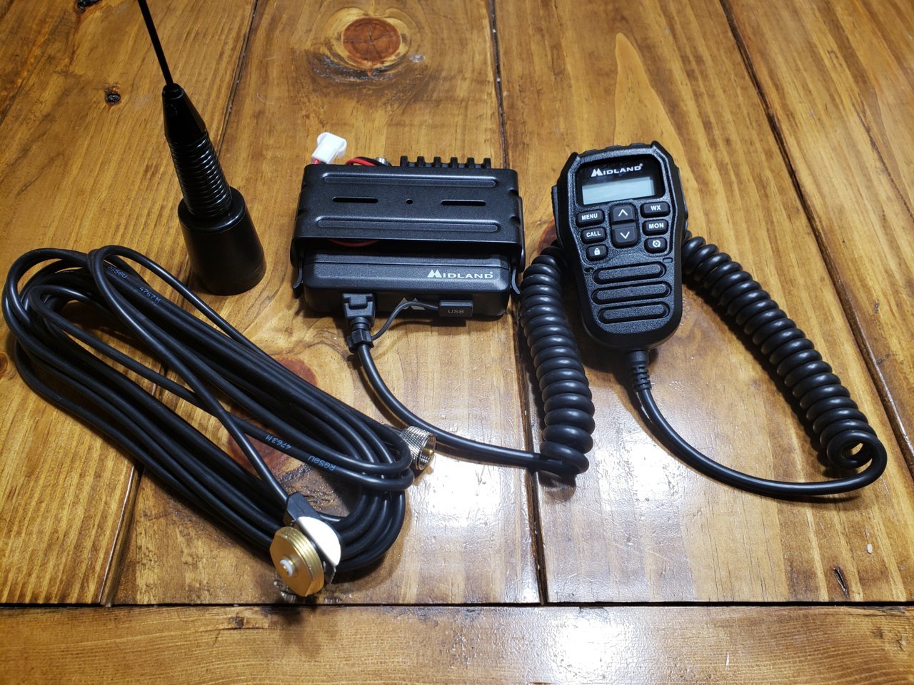

    Got everything for the radio install this weekend.
    -Midland MXT275 Radio
    -Midland MXTA26 6db Gain Antenna
    -Midland MXTA24 Antenna Cable w/ NMO Mount
    -Larsen NMO Cap (Not pictured)
    -CBI Ditch Light Bracket (Not pictured)

    Before I didn't have any flares and they did kick up a good amount of dirt and rocks. The first sign of any sort of mud or clay, it would end up all over the sides.
    Then I picked up a set of 01-04 flares and that helped a lot with that. Still kicks stuff up, but it's a lot better. I think they really help fill out the body better too with the wider stance.
