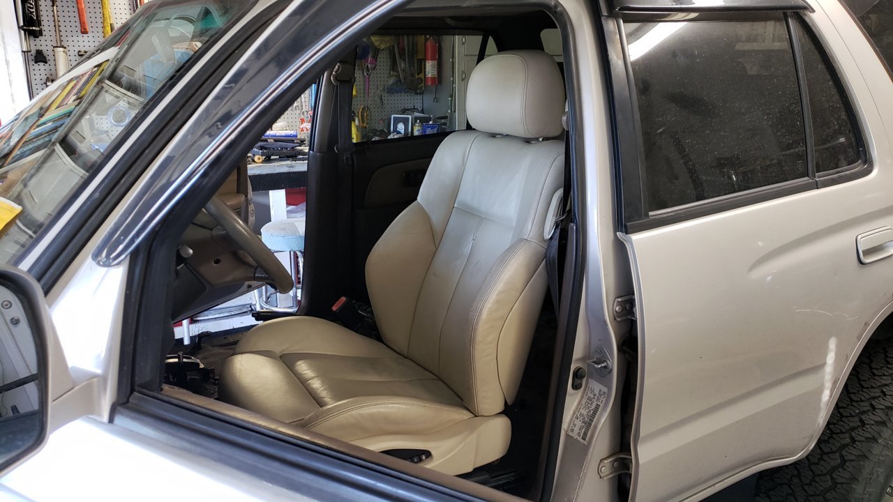

    I may be getting ready to pick your brain on some shit... lol
    I'm getting ready to do BMW seats in my kid's 3rd Gen 4Runner, like, right NOW. :rofl:

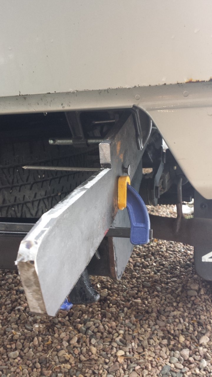

    Ok. Ok. Sorry. They are all on my phone and uploading to TW from the phone is painfully tedious.

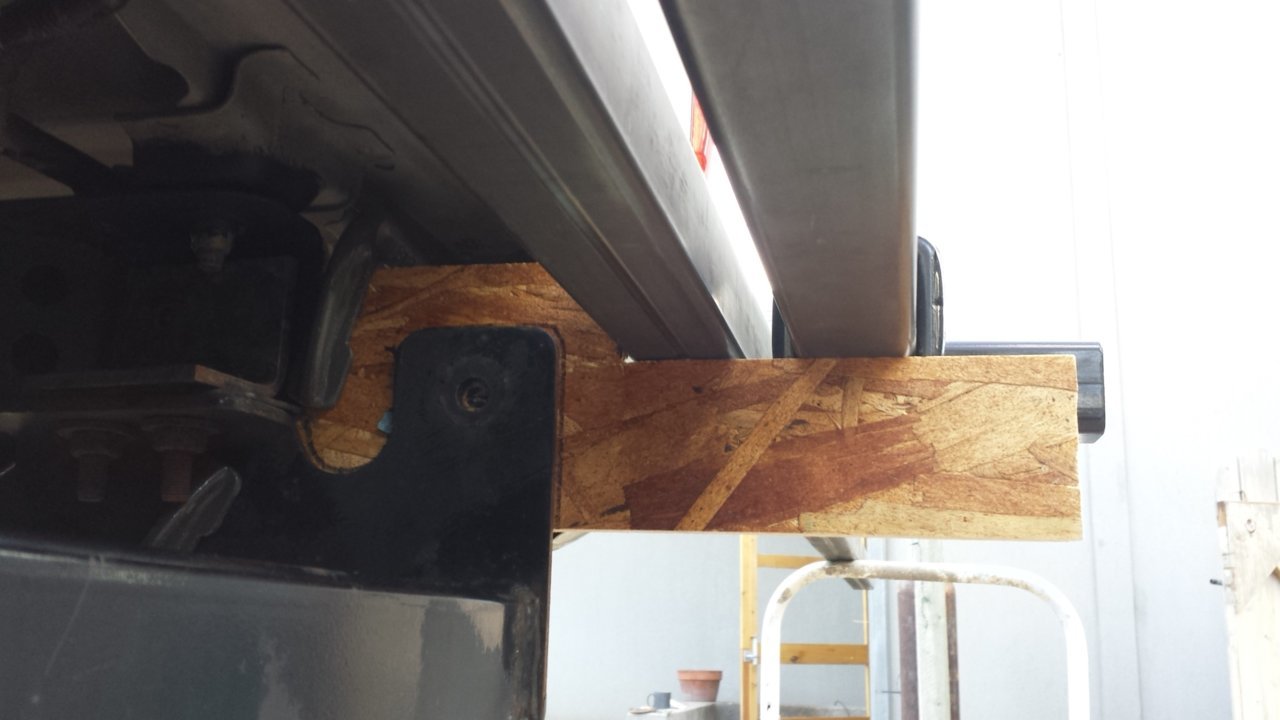

    Planning:

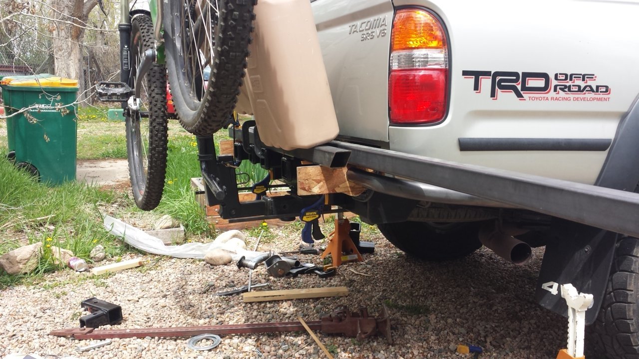

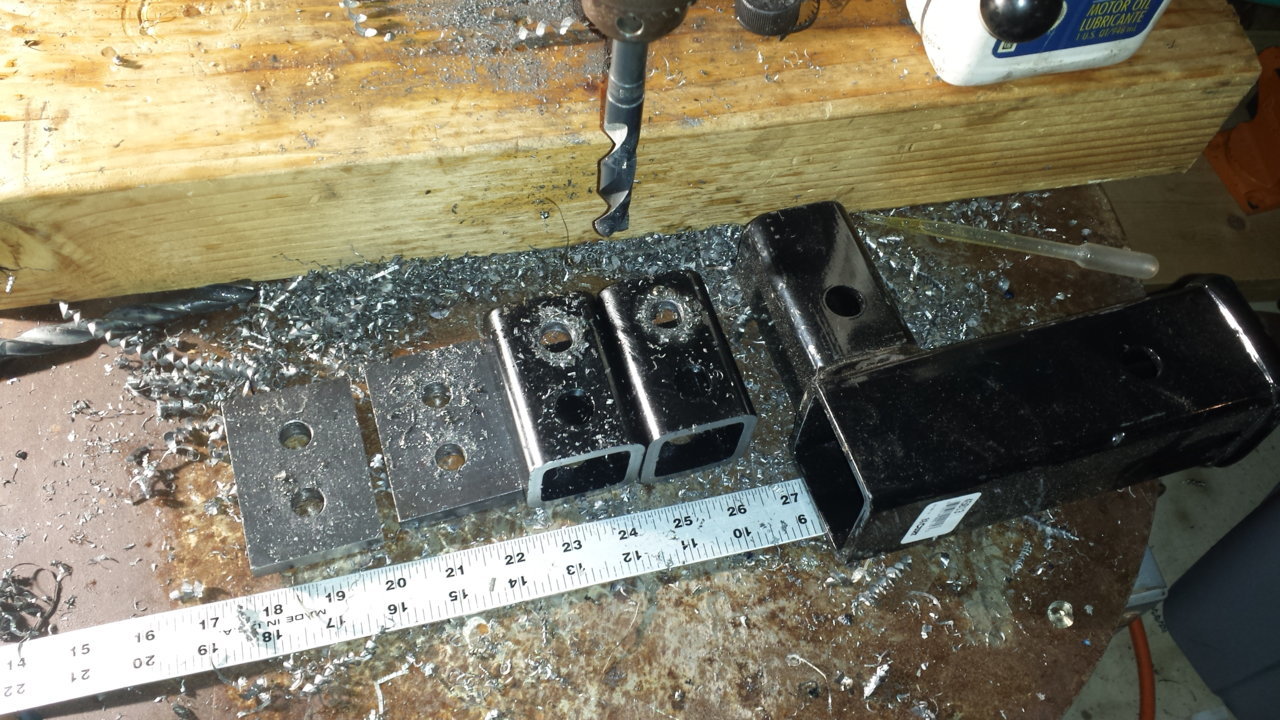

    roughing out parts:

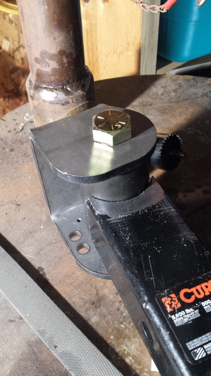

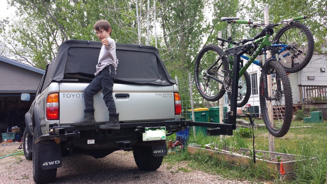

    Welded up and painted (i really hate that paint, it said TRACTOR on it so it should have been good but it was terrible. It is as if the tractor rustolium is marketing to is a tractor on a nerf farm where all the rocks and barbed wire have a Mohs hardness below "fingernail"):
    As you can see it is built with lots of receiver hitches. I do this on the arms so I have have a set of arms for only the bike and the gate comes straight down over them, or I bolt on the set of arms with even more receiver hitches mounted vertical to take the jerry cans and the spare tire.

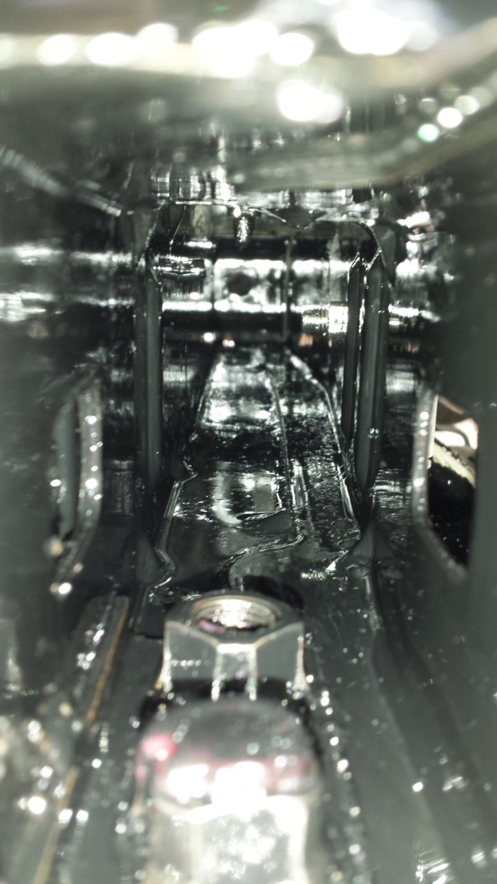

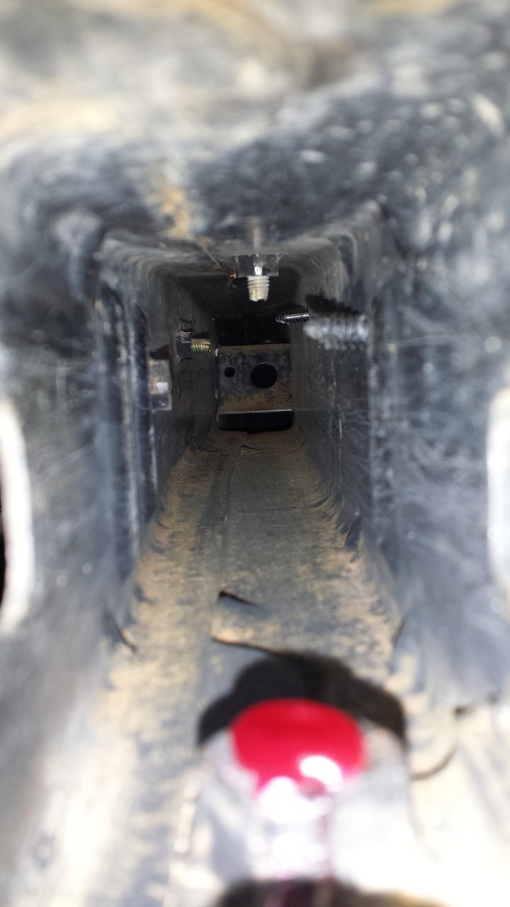

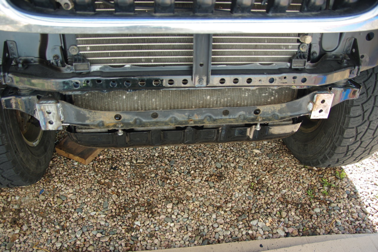

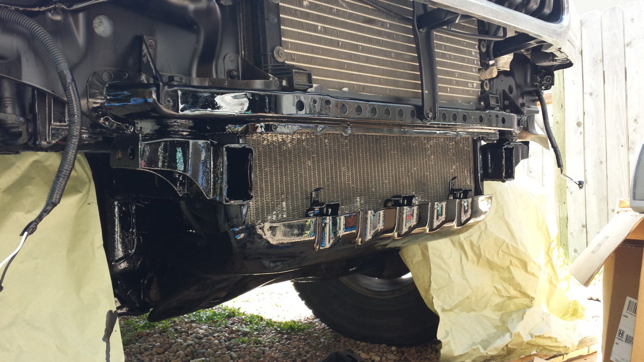

    Chassis Savered the anterior most 3 feet of the box frame as I will never get access to that part again.
    before
    after

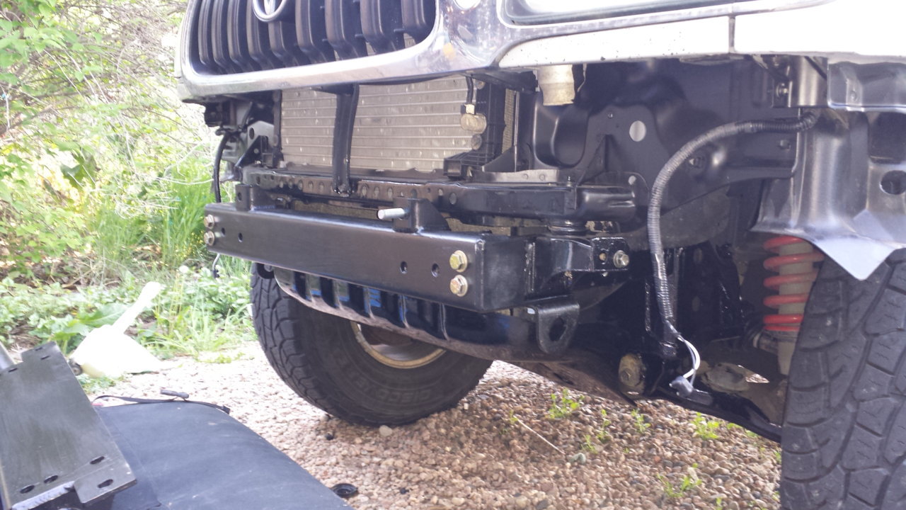

    plates with 1/2? nuts welded to interior and OEM skid plate, not a fan of that but i plan to make a beefy radiator guard after i finish my boat projects:

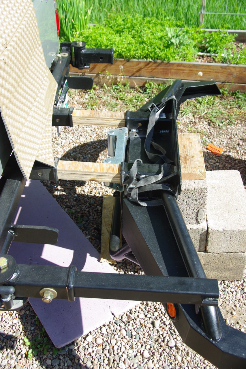

    using the rear dual receiver hitches as a jig to weld the front 2:

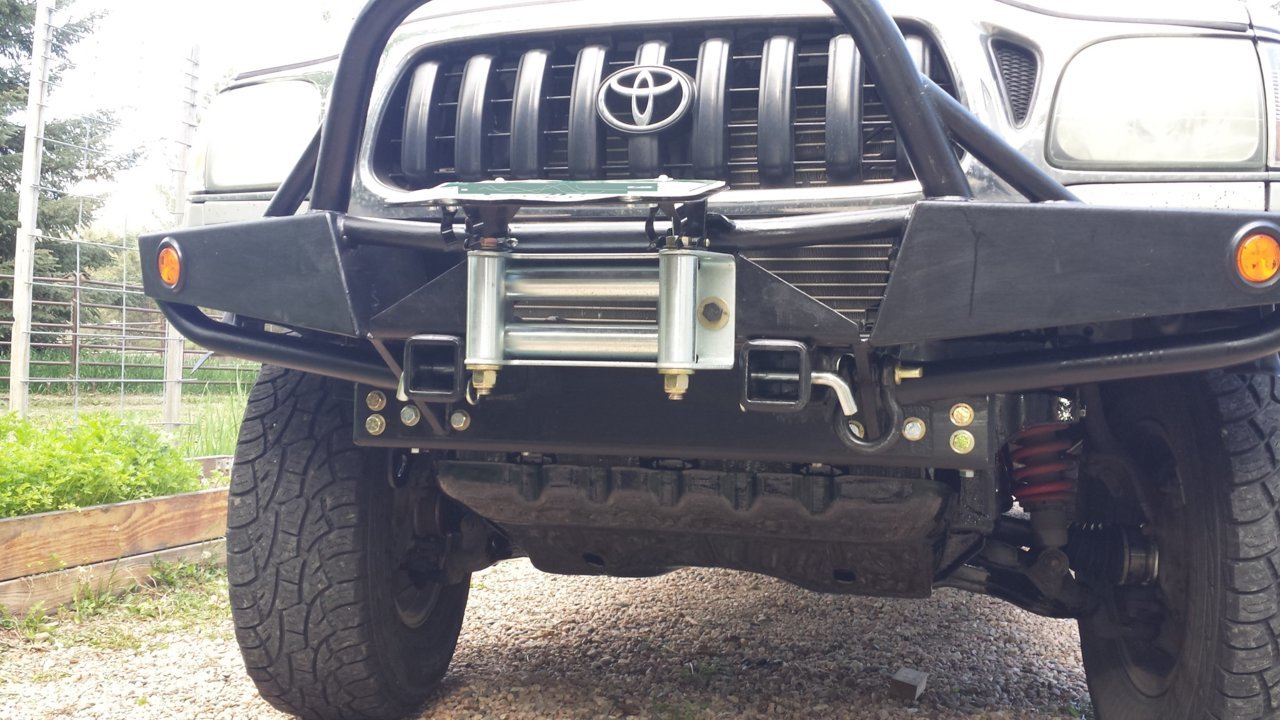

    done with front:
    It is not how I wanted to do it. Not being allowed to leave the house for COVID closures made me use what I had not what was ideal. But it got done.
