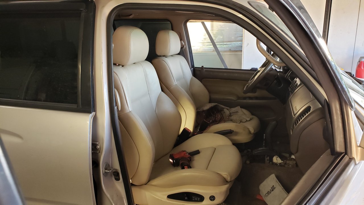

    2 down... now for the wiring.

    looking good!:thumbsup:
    did I hear you say that those are out a BMW?

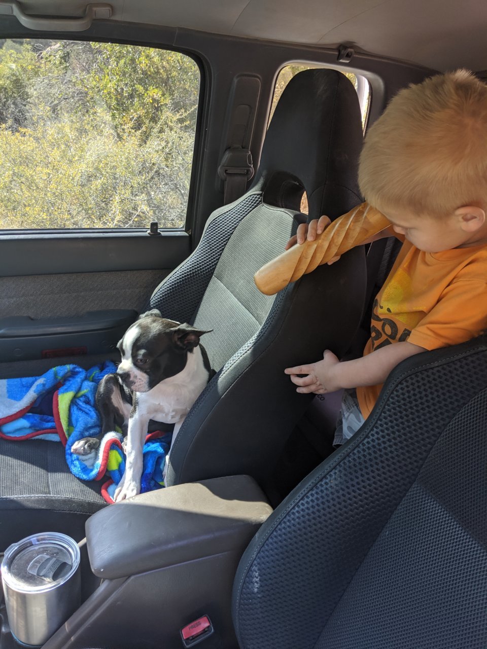

    I definately see what you mean with the seat height. We ended up just rolling with it and welding the mounting tabs to the base of the BMW seats this time. It's my kid's T4R and he's only 5'7" so it works for him. He's actually stoked about the seat height.
    If I do this swap in mine, I'm definately going to have to figure something out, as I'm about 4 inches taller than he is. Feels a bit cramped for me.
    As for the wiring. So far it seems to be working with just power and ground. I don't think the memory fuction on driver's side will work, but honestly I don't think he would ever use that anyway. Hot wired, power and ground, the seats are functioning the way they should. I just need to wire them permanently now.

    Yep. 330i seats.

    nice! i don't think i'd go with BMW seats myself... but maybe a set of king ranch seats are in my future? i'd imagine they'd be kind of a bitch to fit though, given that they're coming from a full size. certianly seems like a cheaper alternative to my idea on getting Katzkins leather. and maybe more comfortable too:notsure:. looking good though! i'm especially impressed that you got the wiring working

    The seats were only $250 for the set and the rails are really close to the same width apart as our trucks. Also, the seat belt fits in the BMW seat belt latch. Makes swapping not that difficult. Not sure there's enough room for a full sized truck seat in there. You're working with really limited space side to side.

    Mine were from a 2011 328i. They would work with just power and ground when you first hooked them up, but after making the initial adjustments and about 30 seconds or so, they would freeze, and until you disconnected the power, they would not move. Glad it's working out better for you!!

    I'm not out of the woods yet. We'll see how it goes when it's actually hard wired. Jumping it off the battery, we weren't staying with constant power the whole time. Hopefully it'll stay this way once it's all wired up. But I'm done dinkin with shit today... wiring sounds like a perfect job for tomorrow lol.

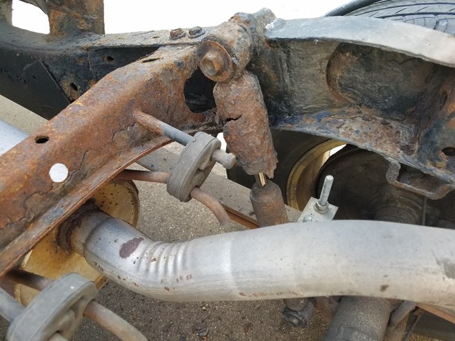

    So, I kept my original Tacoma rails but ended up using the Subaru ones for a year. I recently swapped them over because the fitment wasn't exact so it tweaked the sliding rail enough to give resistance.
    I would have changed them out, but I had a friend looking for Subaru rails and he gave me money.
    Picture added to previous post so you can see them

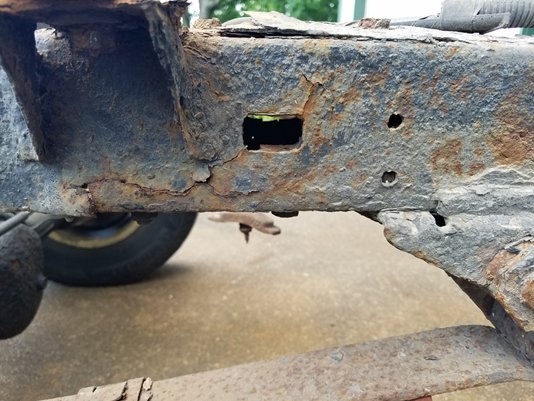

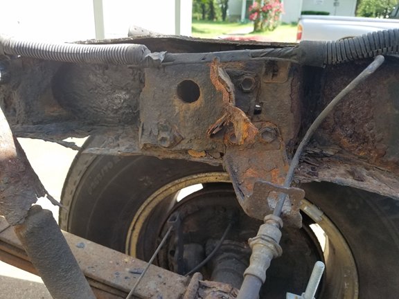

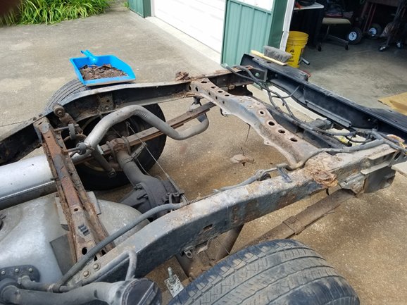

    That road salt gave your truck leprosy. If you’re rehabbing the truck I’d follow the build thread.

    you should see the frames that come into work up here in in indiana..
