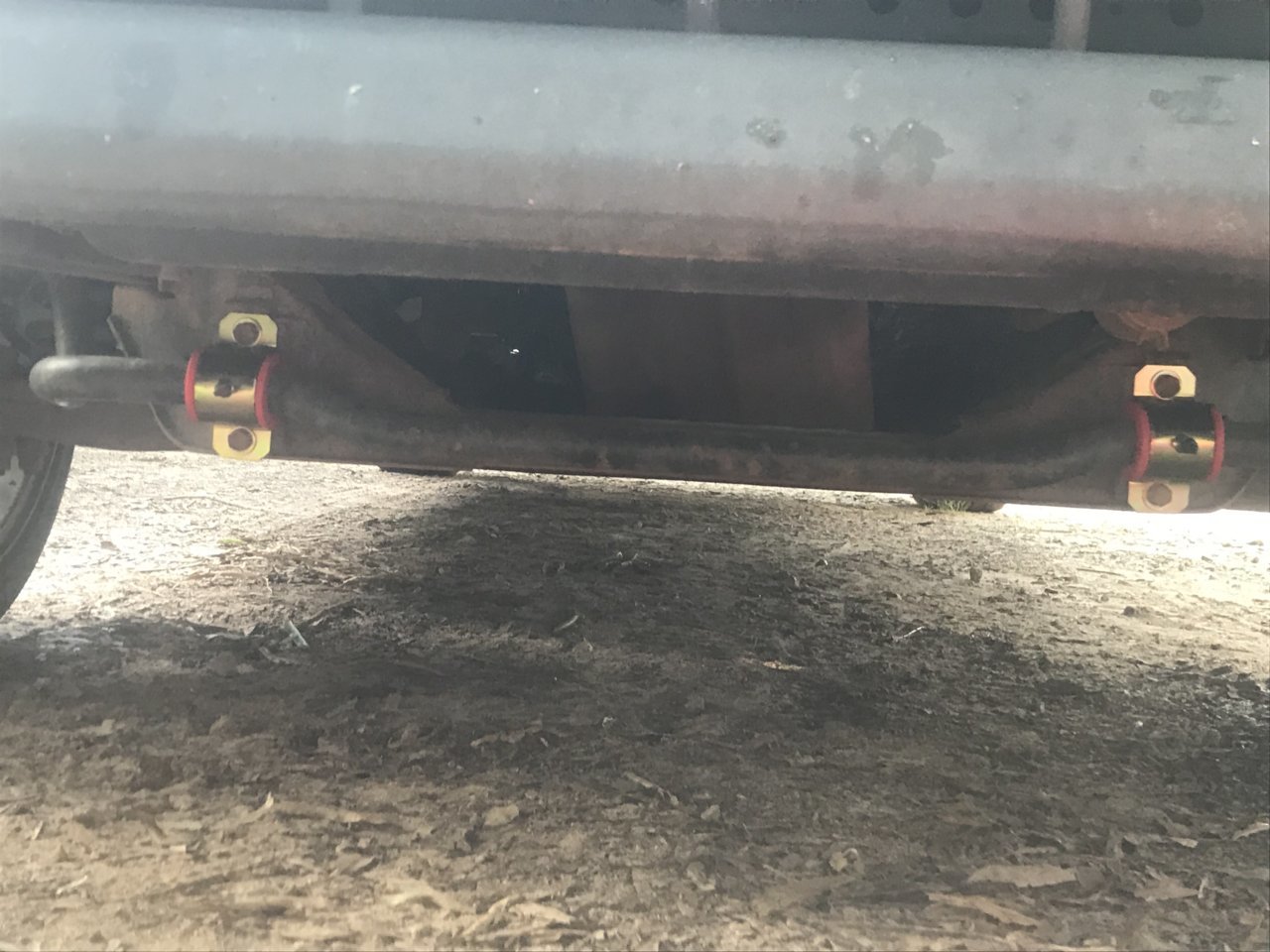

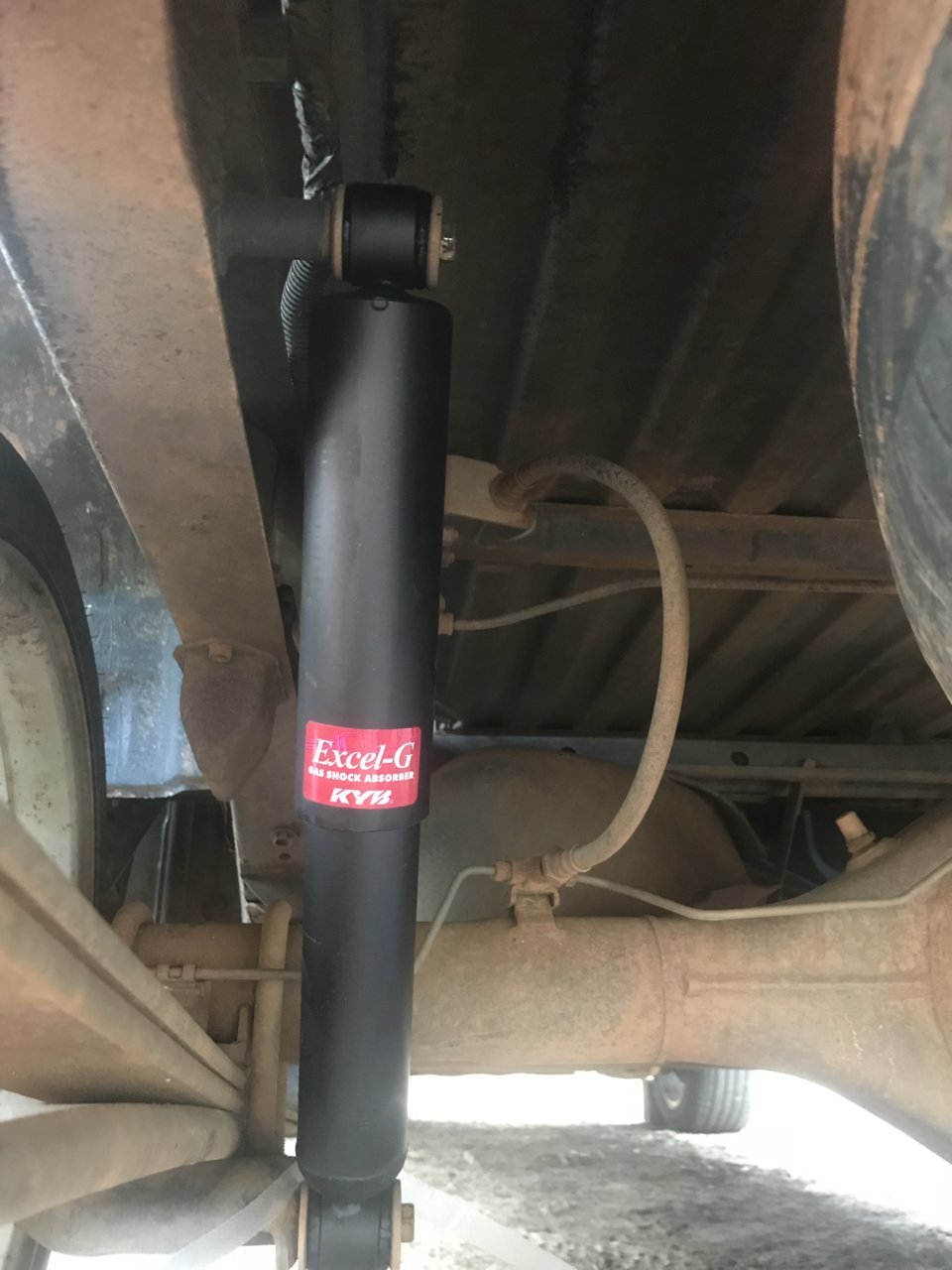

    Put all new poly bushings from energy suspension on the sway bar. DE628CA2-94AD-4F2F-9C14-E022994775E6.jpgAlso the links. And put new rear shocks on. 392DA921-4E4F-4B7C-B965-30E9254E54A4.jpg Officially done with things to do til I decide what to order next.

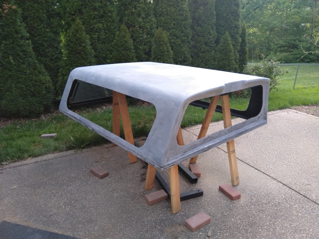

    Got my camper shell sanded. Going to the painter in the next week or two.

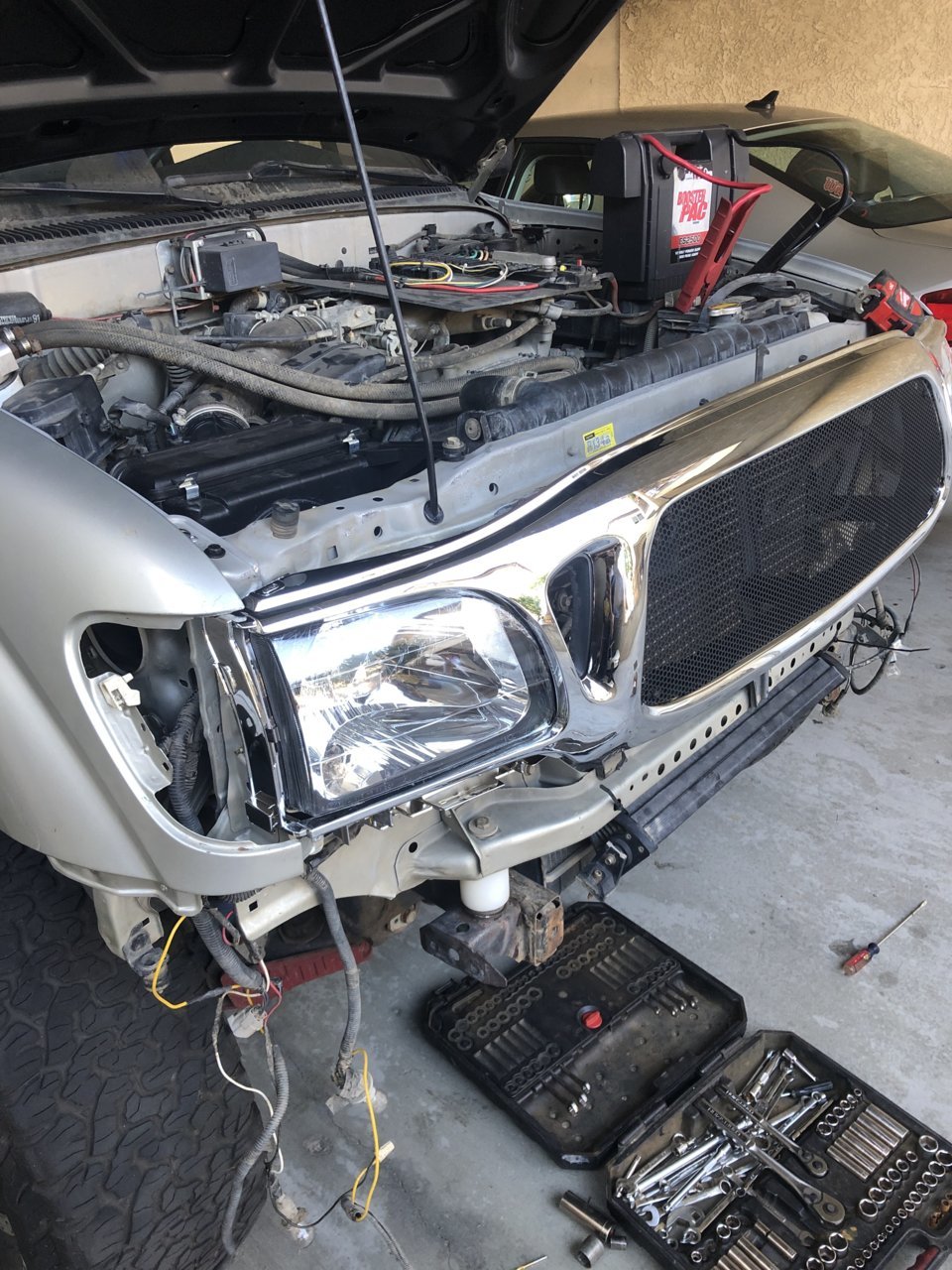

    Update: Realize I still have my whole gender so I used a spot weld cutter to remove the brace and then use rivets to put it on my new one. Worked out...
    after lots of hammering on the radiator Support The grill fits and the light path of the headlights is lined up properly

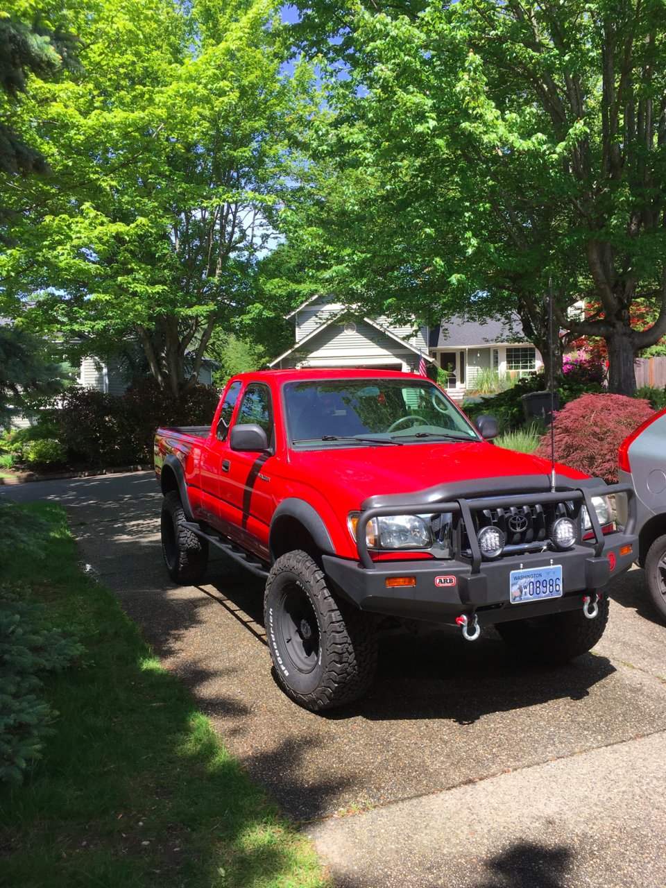

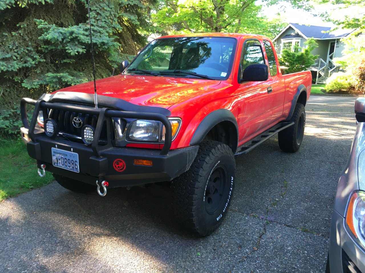

    washed the truck today:
    Before:
    After:

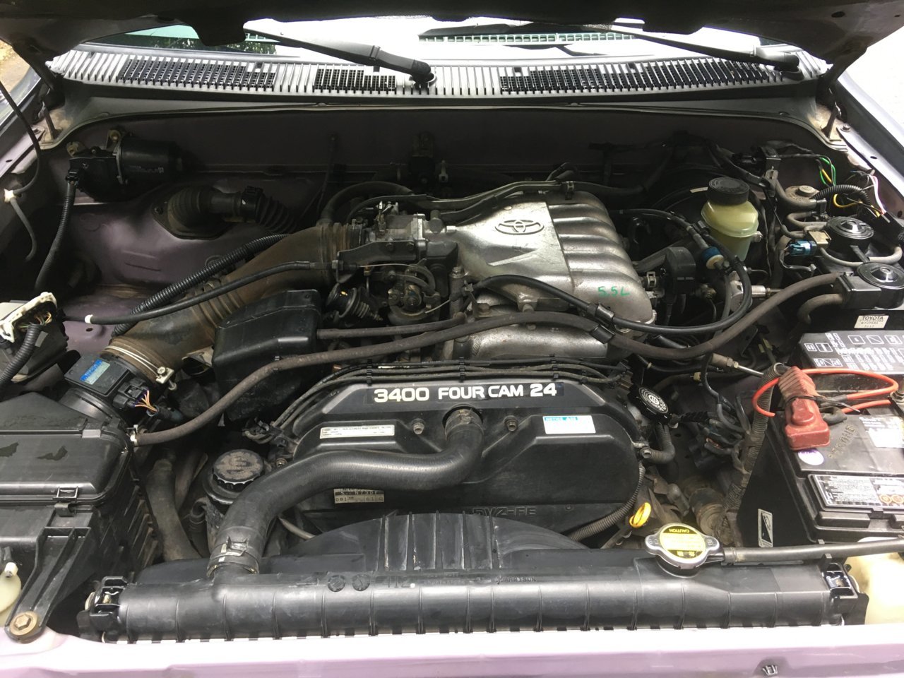

    Cleaned the engine bay today. Used some engine bay cleaner, and heavy duty armour all wipes. Didn't turn out as well as I would have liked, but still a bit better than before.

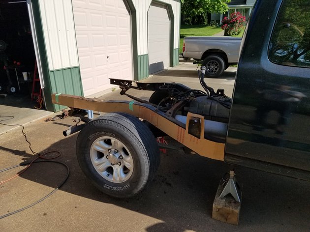

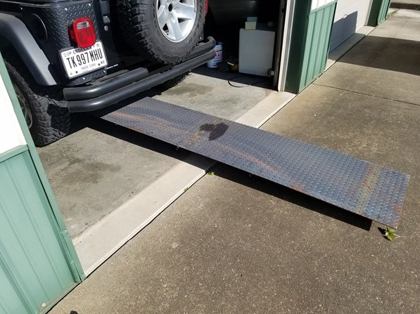

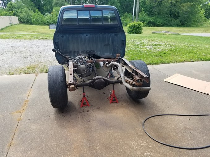

    Finished stripping for my rear section frame repair, except front bolts on leaf springs. Frozen of course. Need a new blade for saw. Too close to fuel tank for plasma cutter.
    Found a donor frame hiding under my Jeep.
    And, got started on some CAD (cardboard aided design) part design.

    i cut those SOBs out with a 6" cut off wheel

    Yeah, I usually use my reciprocating saw, but my blades are shot. I might use the cutoff if I don't get anywhere tomorrow to buy a blade. Thanks for the suggestion. I should just go ahead and drop the tank, since I probably will get pi$$ed off at some point and remove it anyway. :)
    The tank and the lines are only 2 years old so they should come out pretty easy.

    surprisingly ive never had an issue removing the tank straps. so i would just do that honestly.
    plus the plasma is just straight up fun

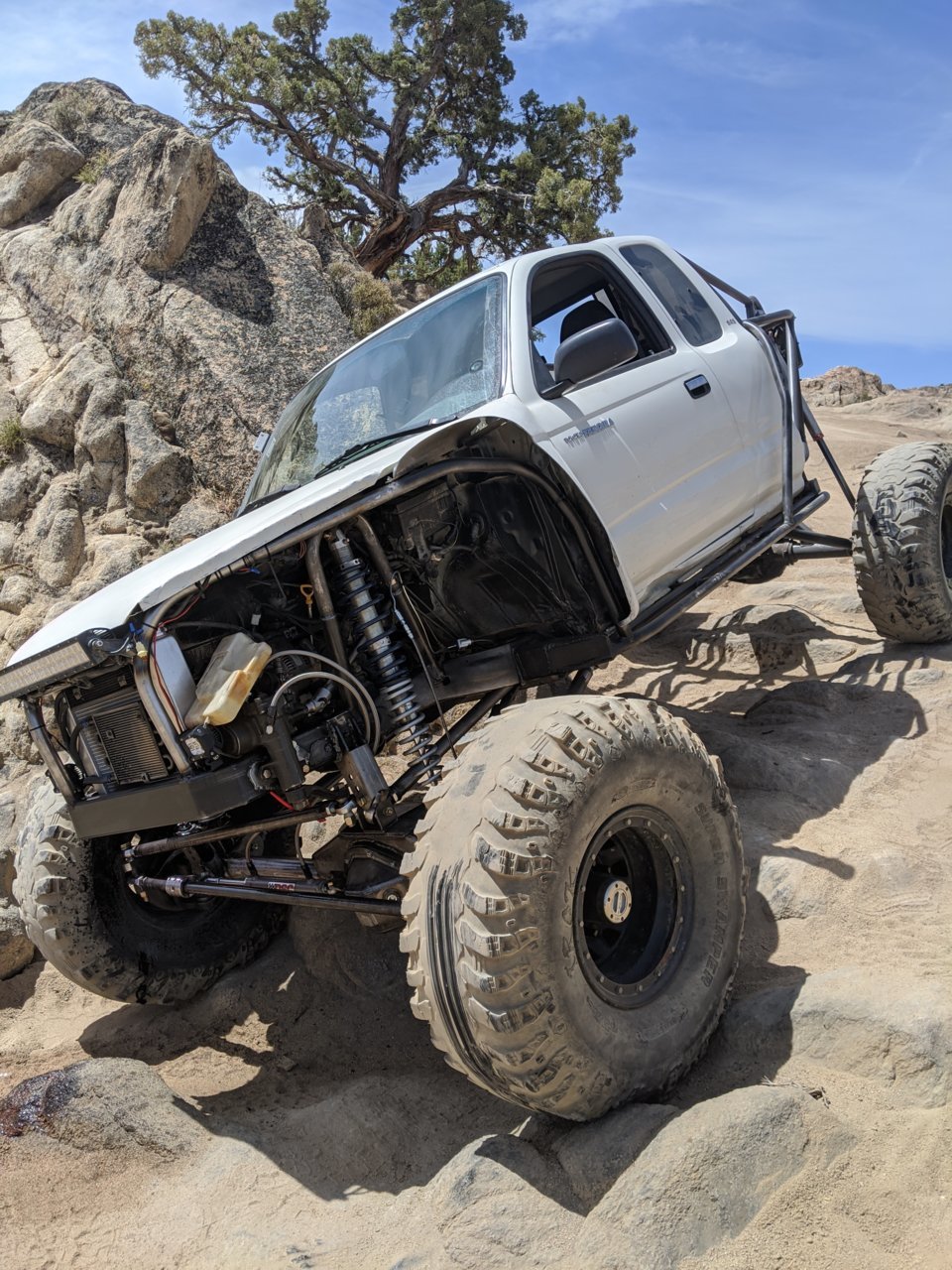

    Shakedown at Moonrocks.

    Haha shake down on bald tires. Fun

    Yeah, less than optimal, but about 10 miles away from my garage and bunch of friends with trailers already out there, seemed like a no brainier to go see what needs to be mechanically squared away and it anything binds.
    Tires were ordered Friday. 39.5x13.5x16s
