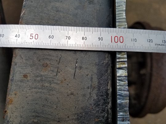

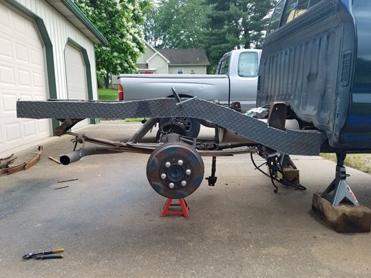

    Had to cut grass, but I got both side pieces cutout for my rear frame repair. I had a 2' x 8' plate 6mm thick. That's a little over twice the thickness of the original frame. Should outlast the rest of the truck.
    60 amp PrimeWeld plasma cutter. About 1.5 hours to cut and bevel edges for welding. Already had the cardboard template made. They still need some glamour work, but they are roughed in.
    I need to trim out around the front bed mounts. The two sides need varying amounts of top and bottom rail repairs. I am going to get some 3mm stuff for those plates, and add some gussets in the spring mount areas.
    Both rear bed mounts were beyond repair, as was the LH upper shock mount (ordered). Probably use some oil well casing pipe I have, and washers to recreate those bed mounts.

    Yeah, this truck is one of those that had too good of a motor and drive train to think about parting out (4x4,<160,000 miles), but the frame was pretty sad. Here in the Midwest, those are hard to come by, so I am rehabbing it. I already completed a lot of body work too.
    Likely, it's going to be a truck for my nephew, so I am trying to stay low investment, since it will be his first vehicle... meaning wrecked in less than 6 months!
