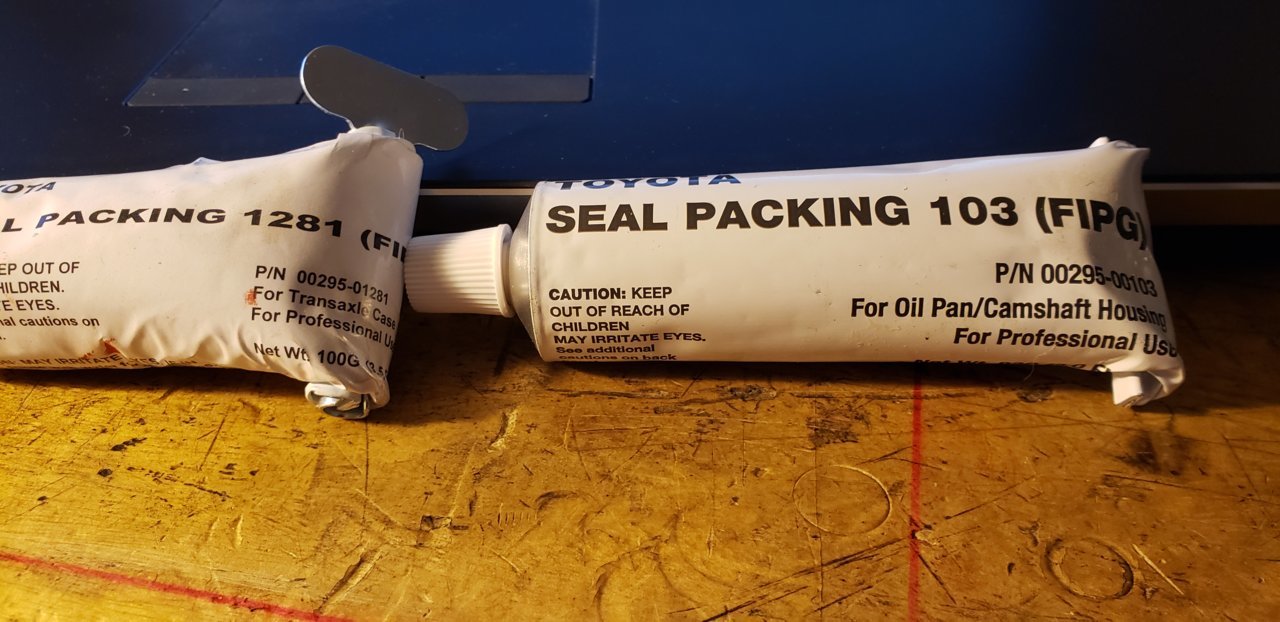

    I did some deep digging, and actually found on a different forum where it was said NOT to use FIPG for the manifold gaskets. Also, it was not specific in the manual like it was for the VC gaskets, half moons and the cam covers, so I assumed I was safe. So I used no FIPG on the manifold gaskets.
    Speaking of FIPG, I’m putting my new gears in, would the black FIPG be acceptable an acceptable sealant?

    00295-00103 trans Pan Sealer, Lower Timing Cover Sealer, Gasket Sealer, Sealer, Engine Sealant, Fipg Oil Pan
    00295-01281 Can be used on the transmission cover, clutch housing, differential cover and carrier, extension housing, front bearing, ring retainer and rear axle shaft connection
    I first used the OEM paper gasket, even with proper torque, and a recheck after the initial 50 or so miles it leaked. So I used the red, no leaks.

    So then the 00295-00103 isn’t acceptable to use for the 3rd member or the front diff. Ultra grey should be suitable for the job correct?
