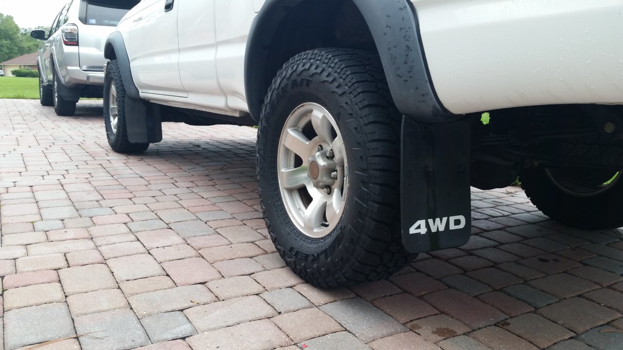

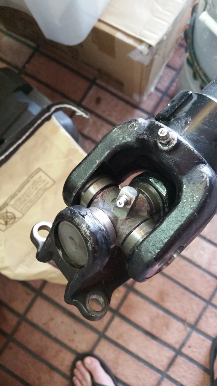

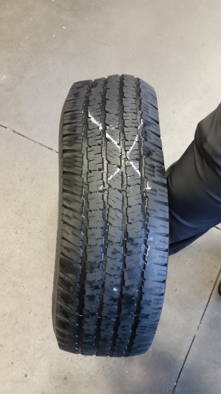

    Yesterday: Drive train vibration resolution. Belt had popped and was shaking the shit out of the truck over 40mph. Tire was trying to become a pretzel when dismounted!
    New shoes:

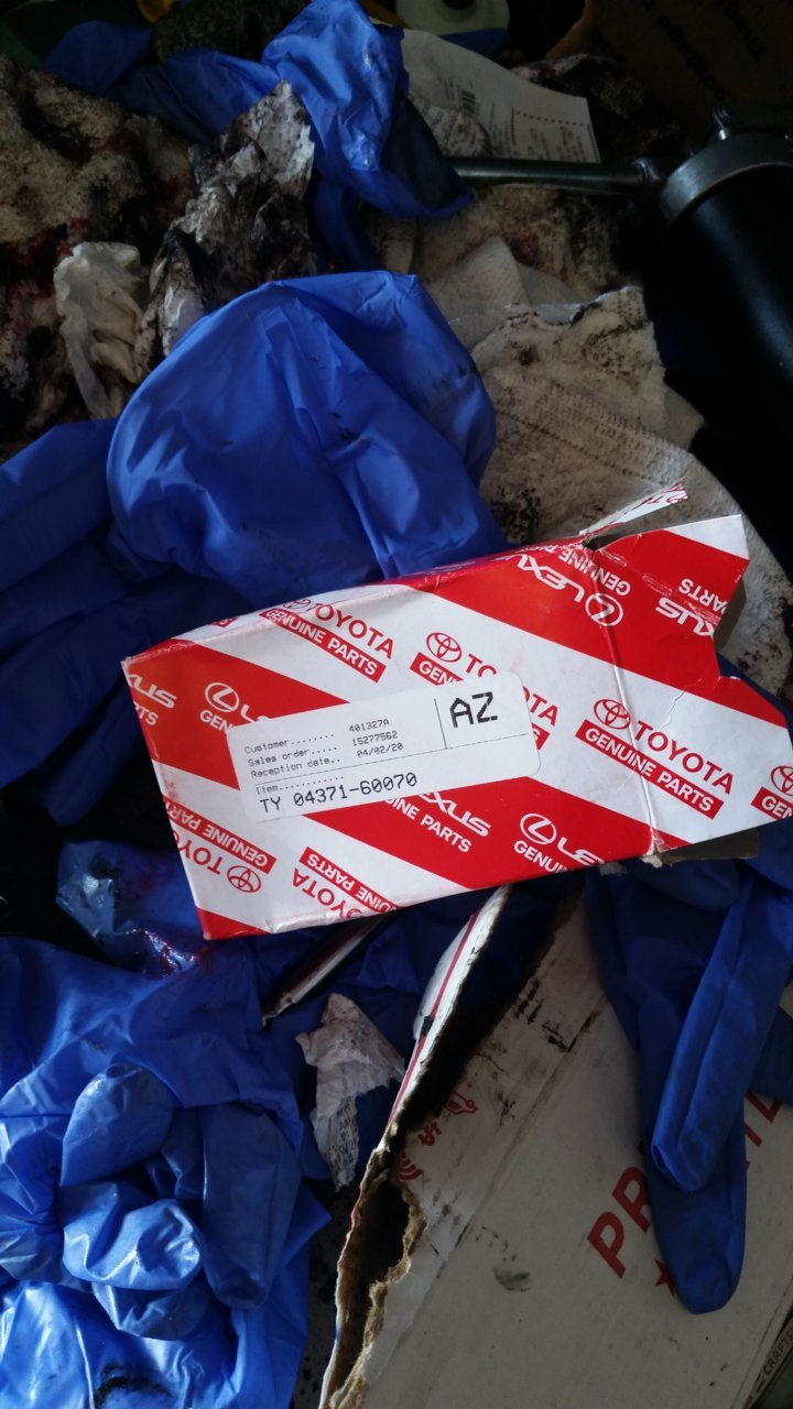

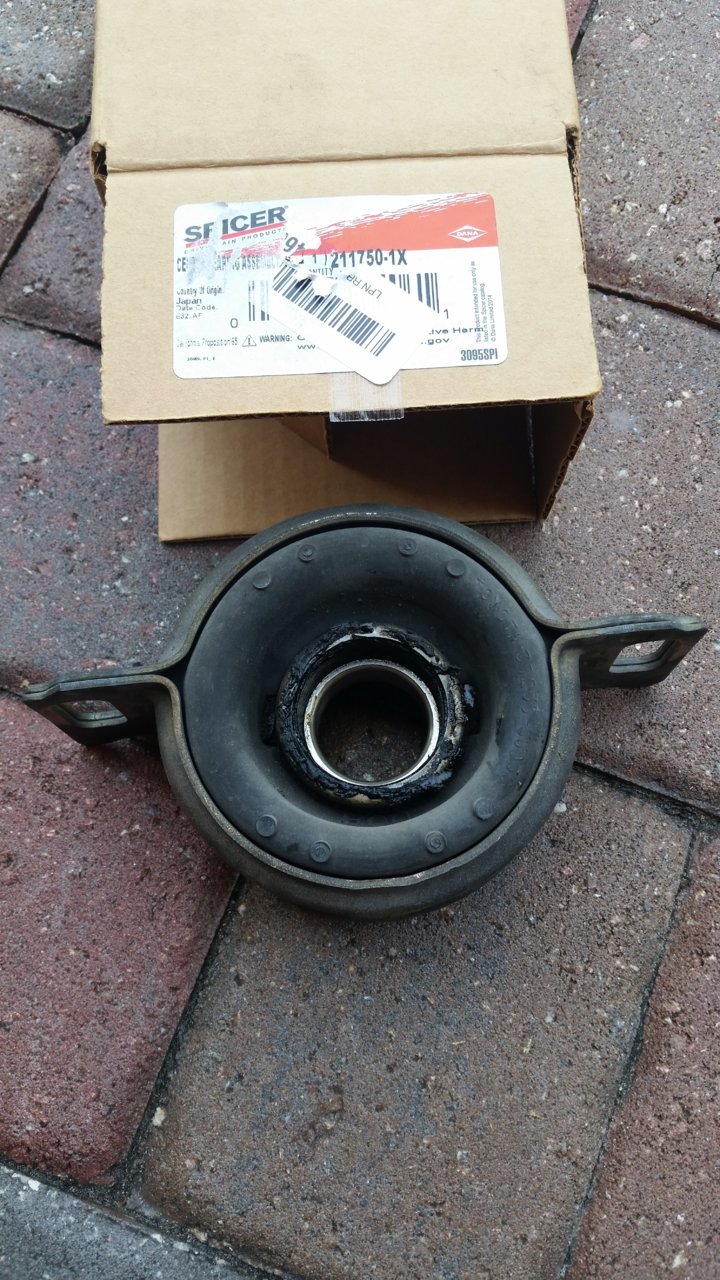

    Today: Rear diff u-joint that was also in need. Thought it was the center bearing and this u-joint that was the truck shaking culprits which ended up being a tire. Replaced anyway.
    Done for the day.

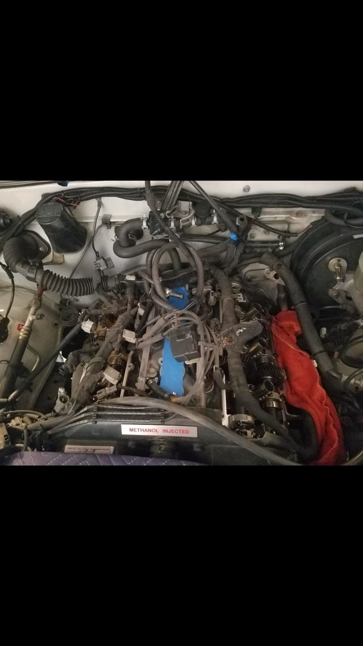

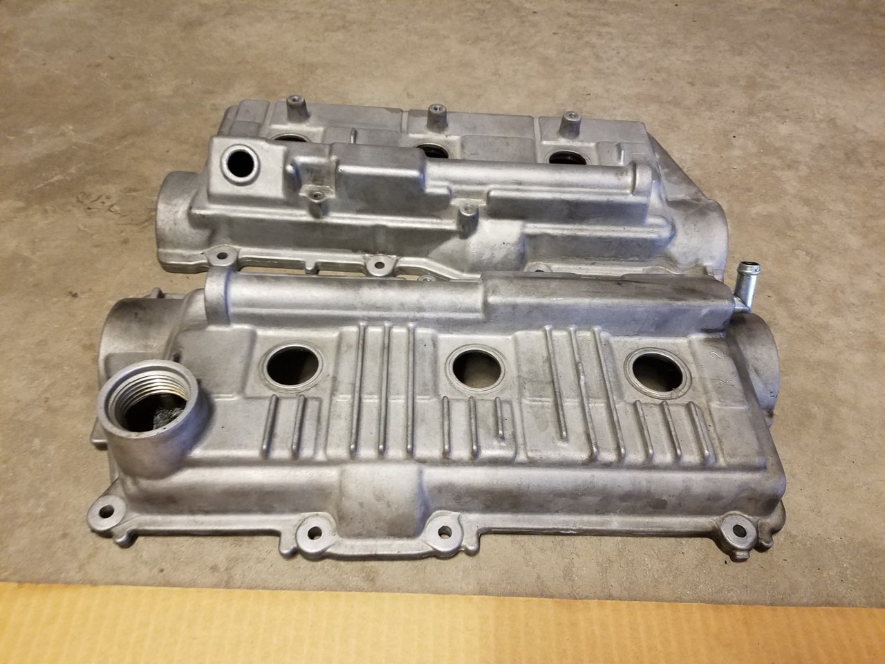

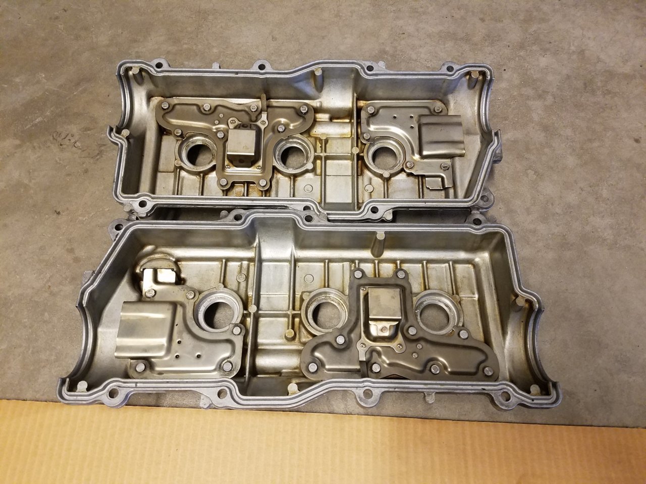

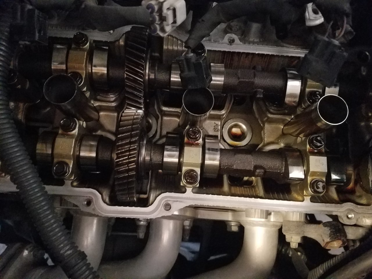

    Just spent 2.5 hours pulling the supercharger and valve covers off and some cleaning.
    Monday will get the valve covers painted red.
    Going to do the valve gasket while everything is off too.

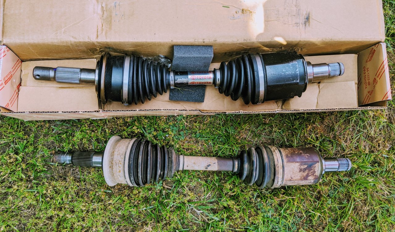

    Finally installed the remanufactured OEM CV I ordered several months ago. Had a leaky boot on my FEQ axle that finally gave up the ghost.

    That was a perfect opportunity to swap out that problematic diff bearing with the ECGS sleeve!

    That's on the other side, may do it when I swap out the other axle.

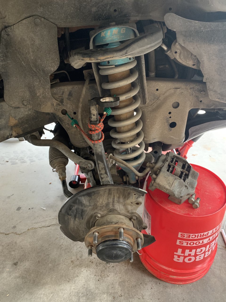

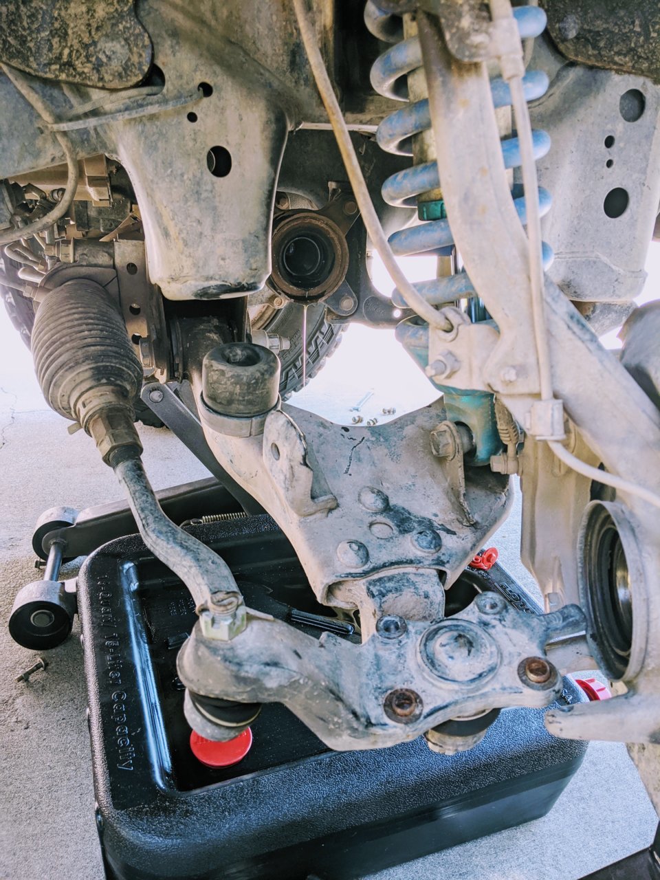

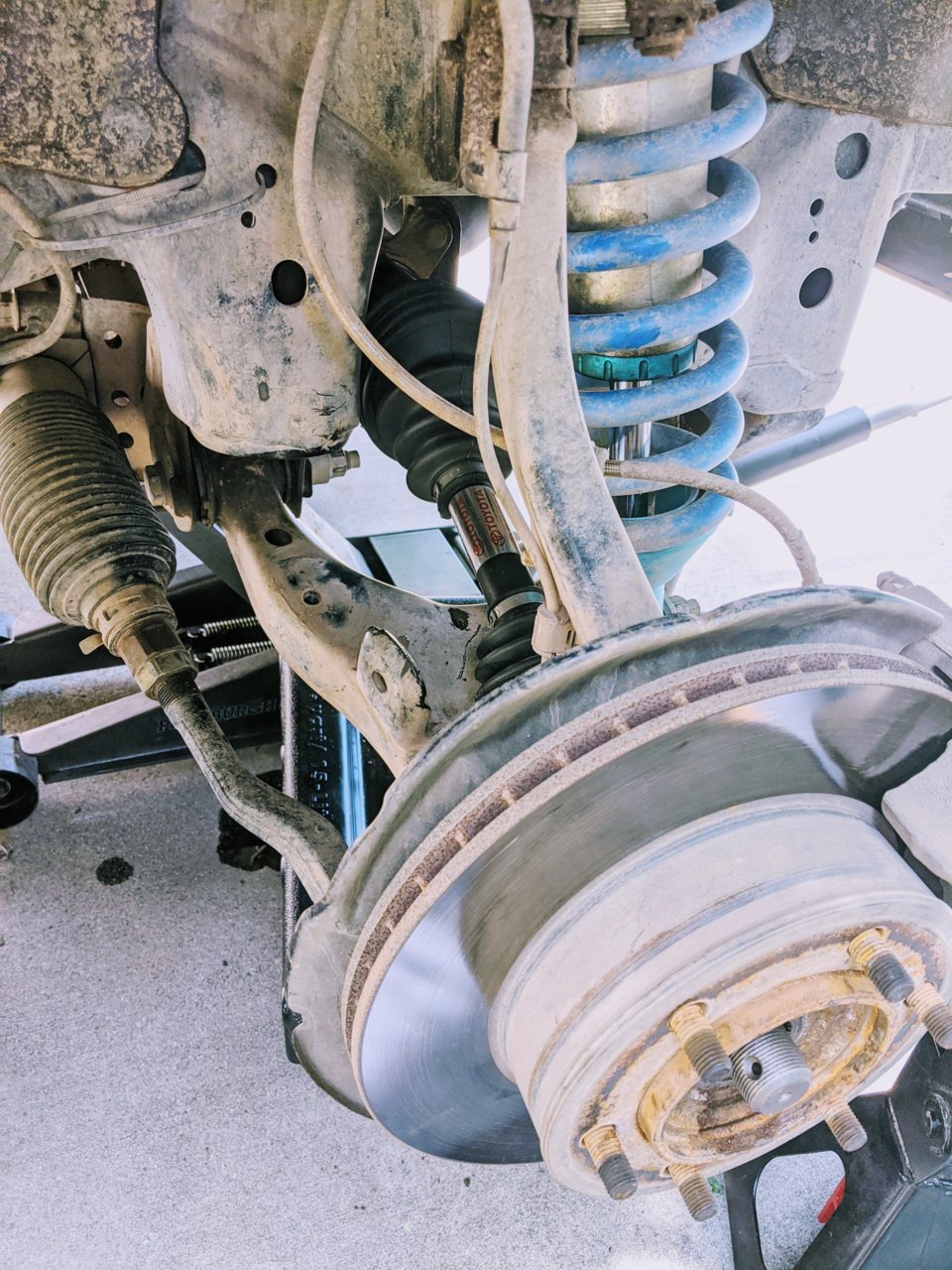

    Started replacing my upper balljoints today and everything was goong smoothly until it came time to press the new ones in. Decided that pulling the whole spindle off was going to be the way to go after I couldn’t fit my c press in the wheel well.
    That was until I realized I didn’t have a 35mm socket to get the cv out....
    Ordered one on Amazon and it should be here tomorrow.

    Yep, I quickly glanced thinking it was drivers side. Doh!

    With my luck I'll be doing that one again soon, damn cheap parts store CV axle boots tear if you look at them wrong. Part of the reason I got a reman OEM axle for the passenger side. Gonna pick up another to have ready for the driver side next time.

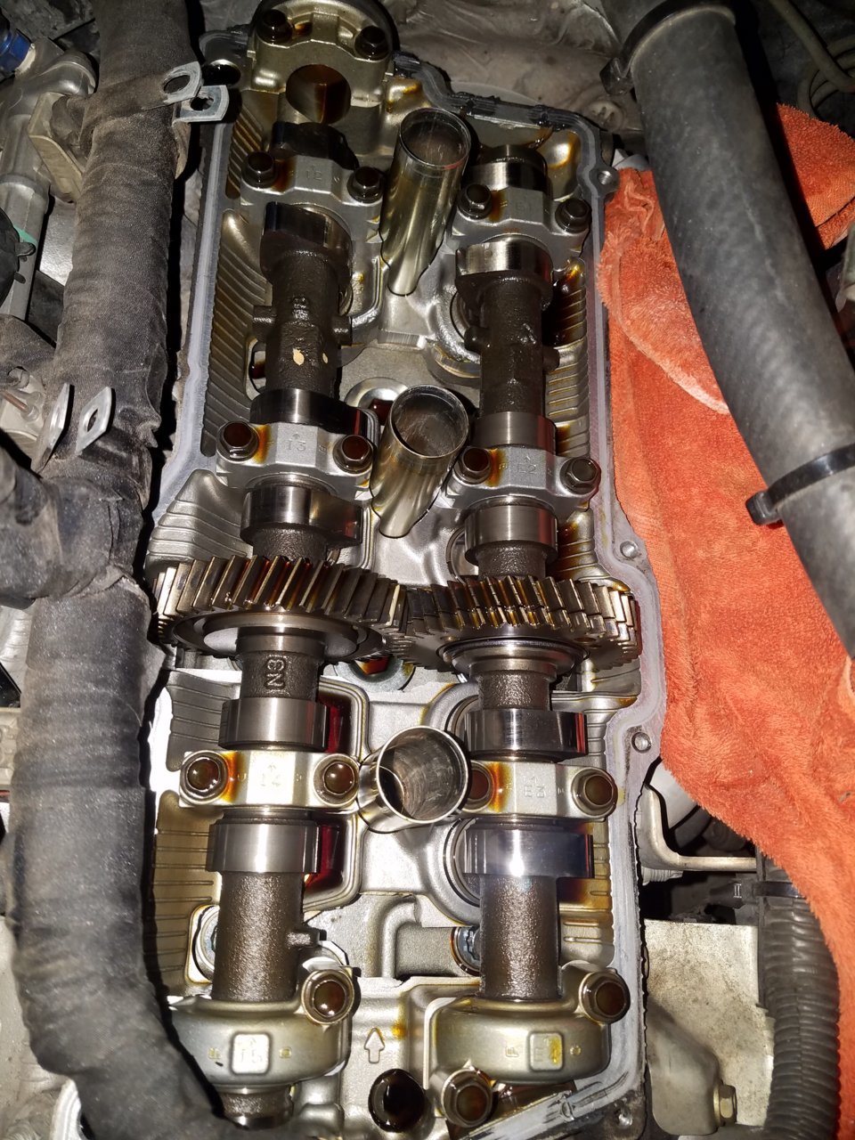

    Wrapped up installing the new ECGS gears, new valve cover gaskets and coolant bypass tube. Waiting on the FIPG to fill cure over night and take it for a test drive tomorrow afternoon. Here’s to hoping i did everything correctly :fingerscrossed:

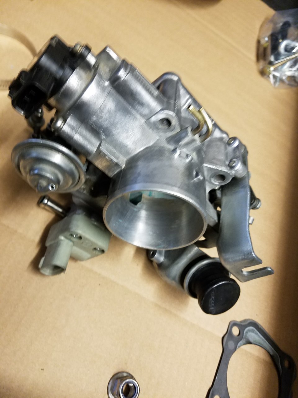

    Then I got the drill with a wire wheel and cleaned the old crappy dark finish to a shiny glow on the throttle body :)
