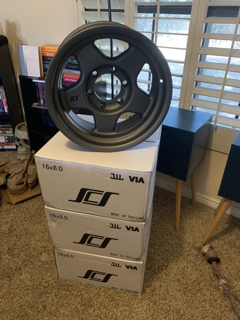

    Thanks man! Yeah me too. It's been months in the making between research and part sourcing. So much happening this coming week. Front driveshaft arrives Monday. Tires should arrive Monday, transmission should be delivered Tuesday.

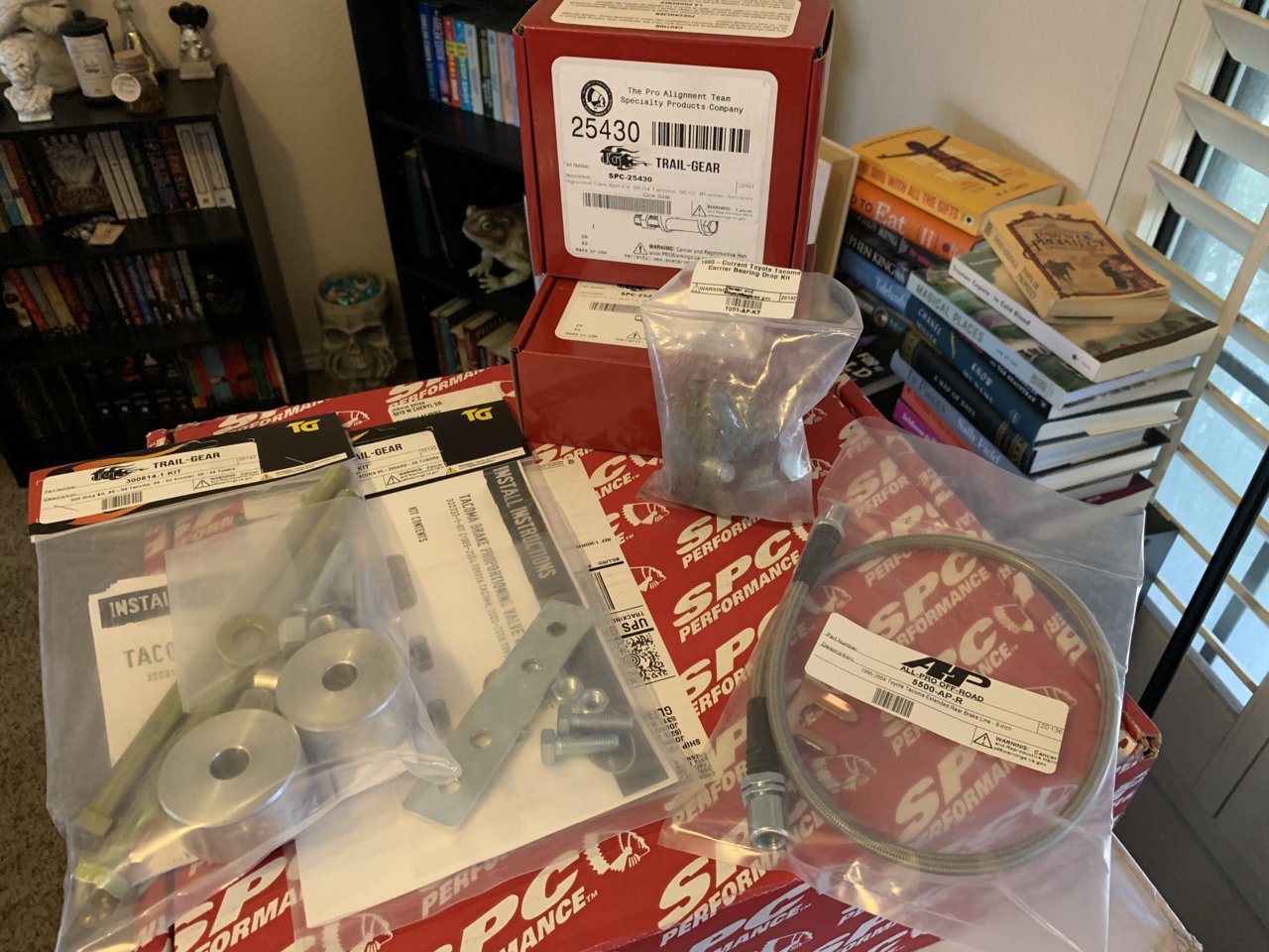

    Wheels got here yesterday as did my SPC UCA's, various drop brackets (front diff, carrier bearing, prop valve and longer rear brake line). Add a leafs, and steering rack from wheelers/low-range OR are still awaiting shipment. Order from Toyota with all the bearings, hubs, cv axles etc should ship this week.

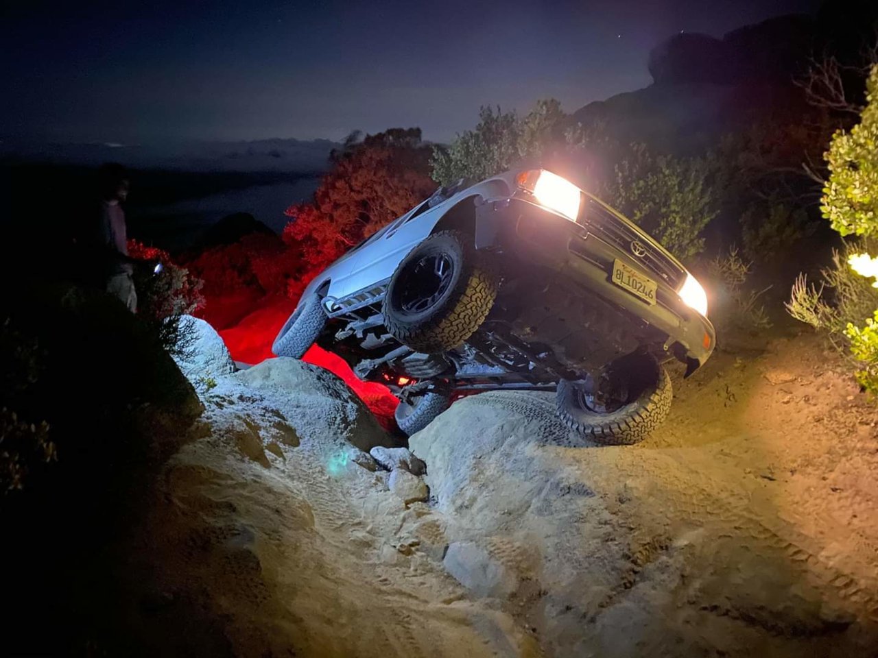

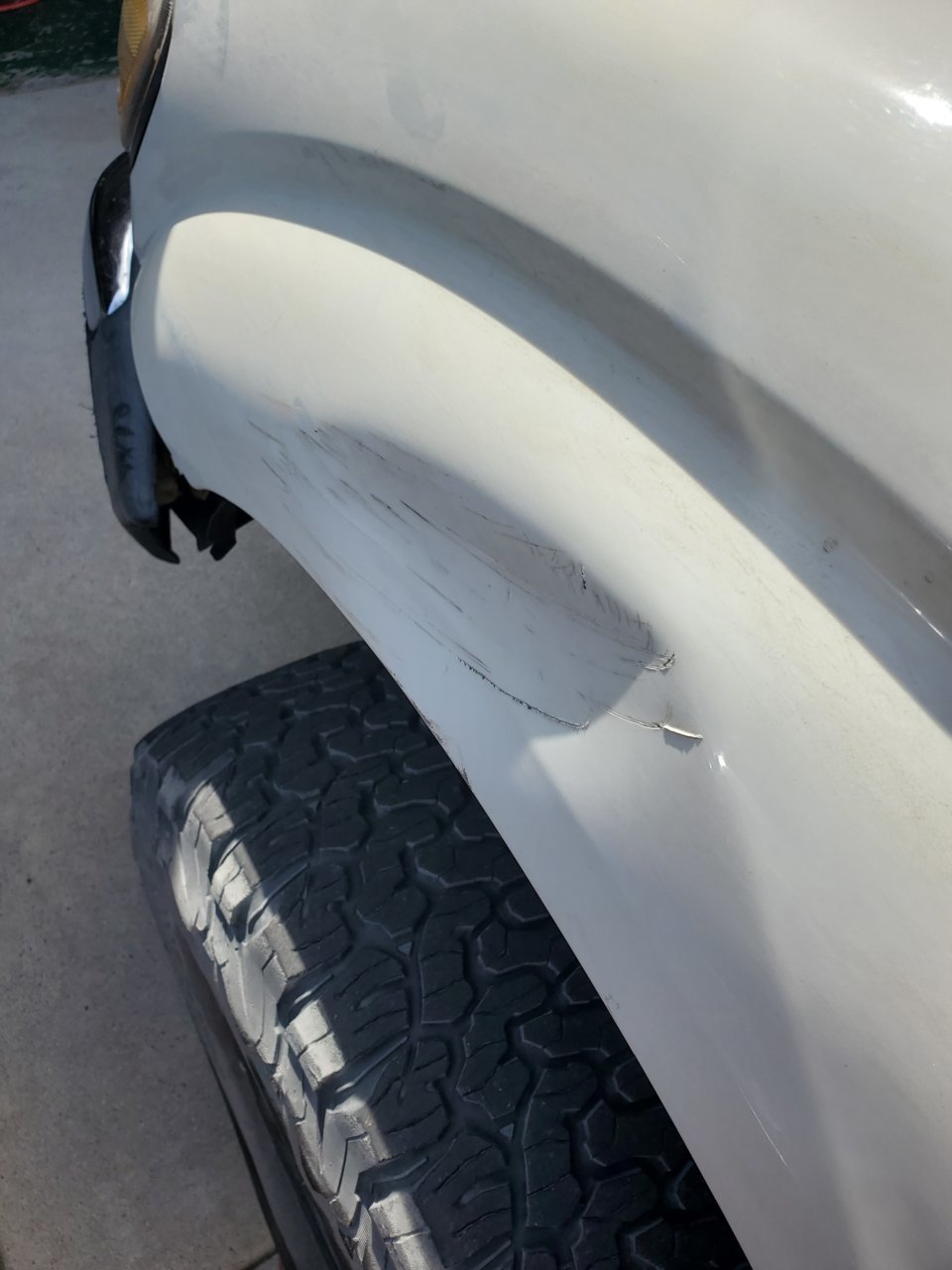

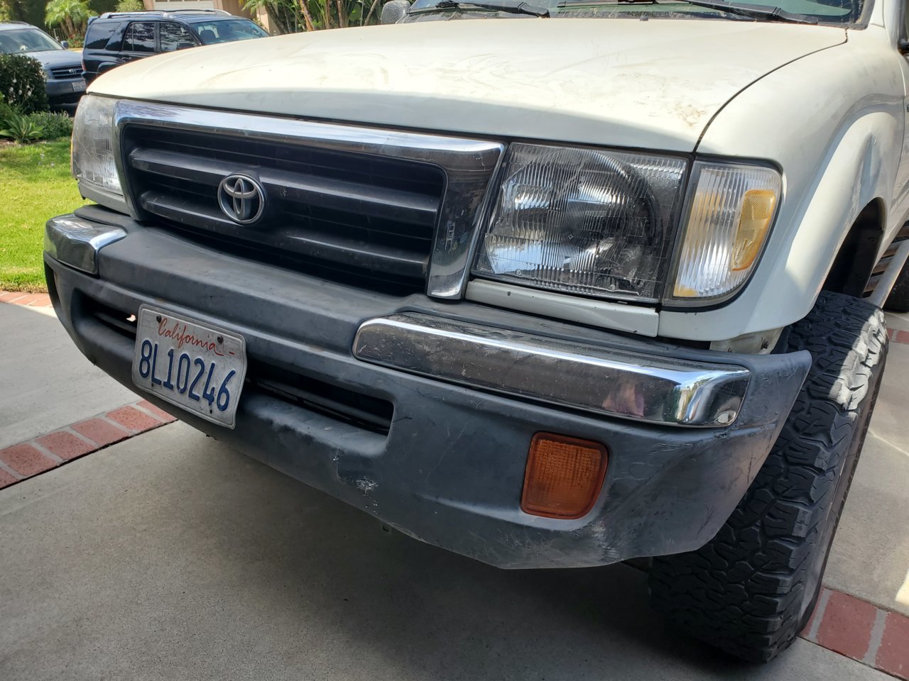

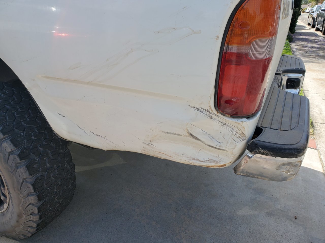

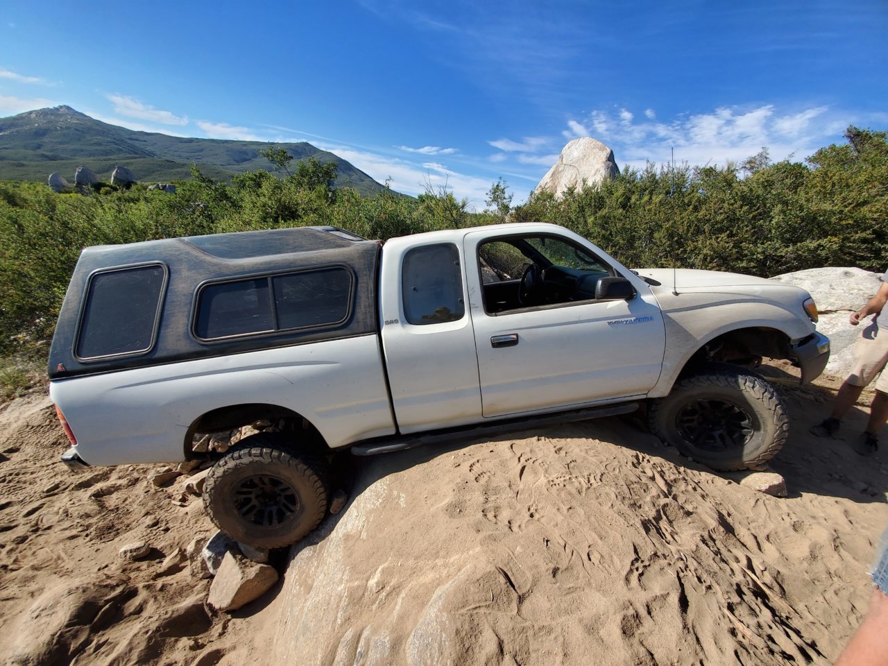

    Went up bronco peak yesterday in corral canyon ohv and was massively under prepared, dented some shit and used my sliders to their fullest potential.

    Holy fawk. How did you get a hold of those wheels? I’d watch the thread, check the website and never had F5s in matte black.

    Added a pic of the SPC box and various other goodies. Got a set of the SPC cam bolts because I wasn't sure if mine were shot or not.
    Yeah I was very pleased that they had the gun metal available in the right 3.5 -25 BS on the shelf. @scs_vuth was top notch and had me squared away in no time. Wheels arrived like 2 days after I ordered them :)

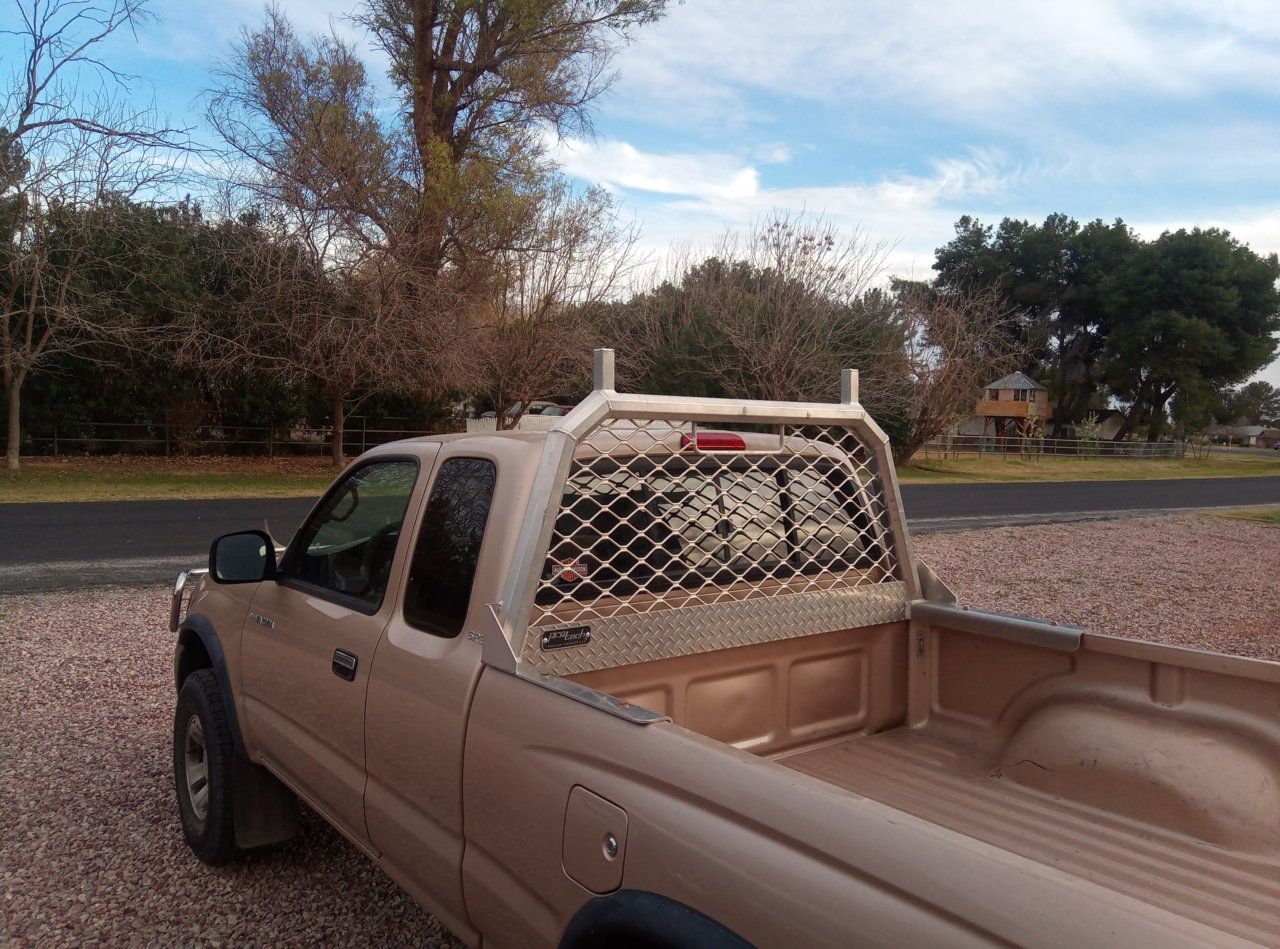

    Got a protech headache rack a while back. I think it looks nice.IMG_20200209_170306_4.jpg

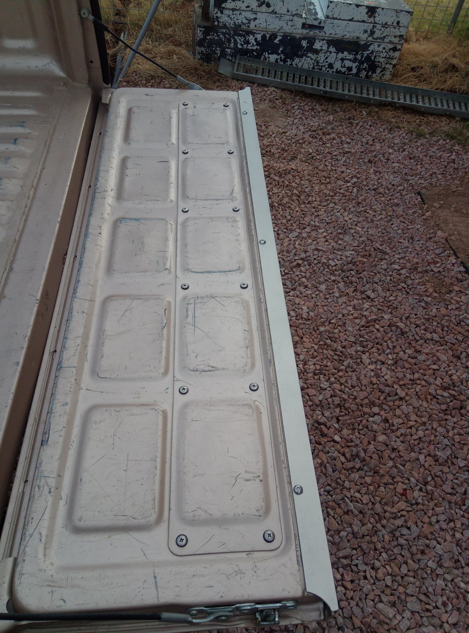

    Also bolted a piece of angle iron to my tailgate to hopefully make it stronger.IMG_20200209_170301_3.jpg

    There wont make a difference, its the area in the perimiter that caves in
    It also looks like the rear could use that treatment

    that might help a bit with keeping the tailgate from "smiling" but I can't imagine it'd do a whole lot of good. if you want to really beef it up get a piece of 1/8" plate and but that on the whole tailgate. if you've got a welder just cut a rectangle and weld it on to the angle iron. then take some screws and use the existing holes for the access to the latch. 1/16" is too light gauge, 1/4" would also work but it's way overkill. if you need 1/4" to support what you're putting on there... chances are it's too heavy for the truck.

    Thanks for the advice, I'll get on that!

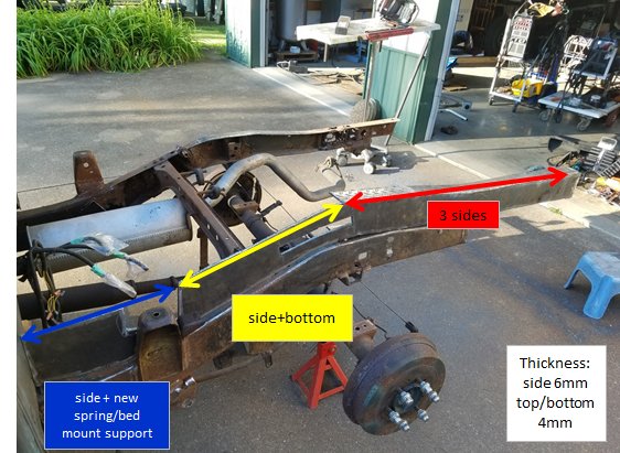

    Worked on my frame repair this afternoon. Added top and bottom to the LH rear section and cut out a welding slot on the side to weld to good section of existing frame. Also cut out a new inner side plate to support front leaf and bed mount area(forgot to take picture).
    I've ordered from General Springs: leafs, LH/RH shackel kits, u-bolts (had to cut them off), and front leaf bolts. LH upper shock mount ordered form LaGrange. Rear spring perches are discontinued, so I will need to try to rehab or make new ones. I am going to replace the fuel tank/muffler and spare tire carrier cross members with 1"x2" tubing.
    It's going to be much stronger than original.
    I have decided to make a flatbed for it.
