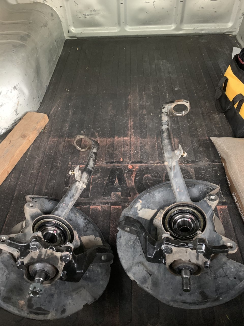

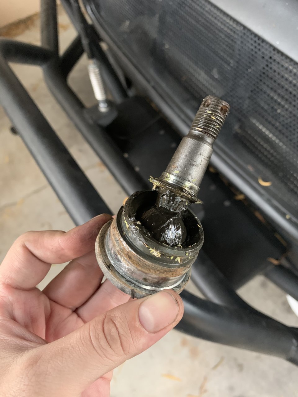

    Drivers side is off, took almost exactly an hour, 20min dedicated to getting the hub cover off without jacking it up. Dropping them off at Tucson Driveline tomorrow to get some 555 ball joints pressed in.
    Pretty sure the ubj’s were original, even with my 2ft breaker bar on the c press I was really having to work it to crack them loose of the spindle. Was pretty loose and gritty in terms of play. Not to mention the GROSS grease that was still in there.
    In the middle of the same minus the uca bushings. Tough finding motivation in this 100 degree heat haha

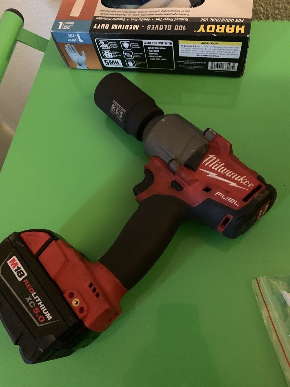

    Get an impact... it makes you lazy
    Captain Magma[QUOTED] likes this.

    Oem uppers are so cheap though. Even cheaper though is rented a ball joint press for free to do it yourself.

    Oh I got one, just weird about using it on presses. It zipped my axle nuts off like it was nothing though, which was very welcomed

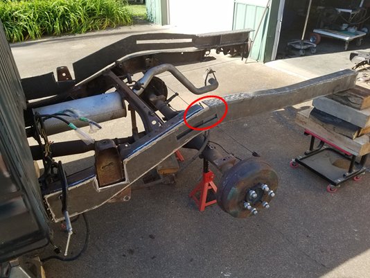

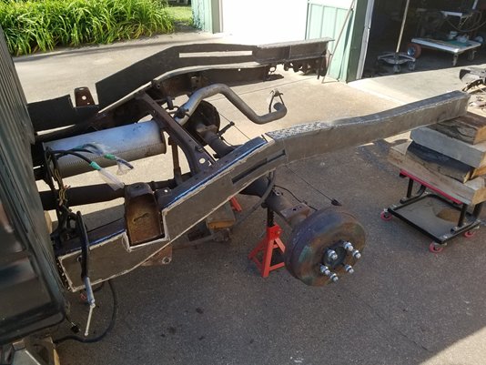

    Made a little more progress on my rear frame rehab.
    I am going to make a joint stiffener for the circled location. I ended up cutting out more than I thought was going to be needed, so I don't like all that rear section hanging without some additional connective support. You can see on the other side, I am only completely removing the last 22". RH top and side plates were still fairly solid except that last 22". Bottom is bad in some areas.
    If all my parts come by end of day Thursday as promised, I hope I can wrap it up this weekend.

    True, but I already had an order I had to make to Low Range and figured I’d just throw them in as well. I only need them to get me another 6 months or so, then I’m getting some MCM uniballs. Was going to order those instead back in March/April, but that’s when all the Covid stuff was kickin off and I wasn’t sure how solid my employment was and needed to tighten up the spending.
    I would rent the adaptor set to get them pressed in, but I’m working out of a carport and don’t have a bench or vise available. I know it can be done, but it’s been 100+ and working outside blows, so I figured the $60 I’m paying to have them pressed in is worth it. Plus I’m getting pretty comfortable with working on the front end now, which is nice plus.
