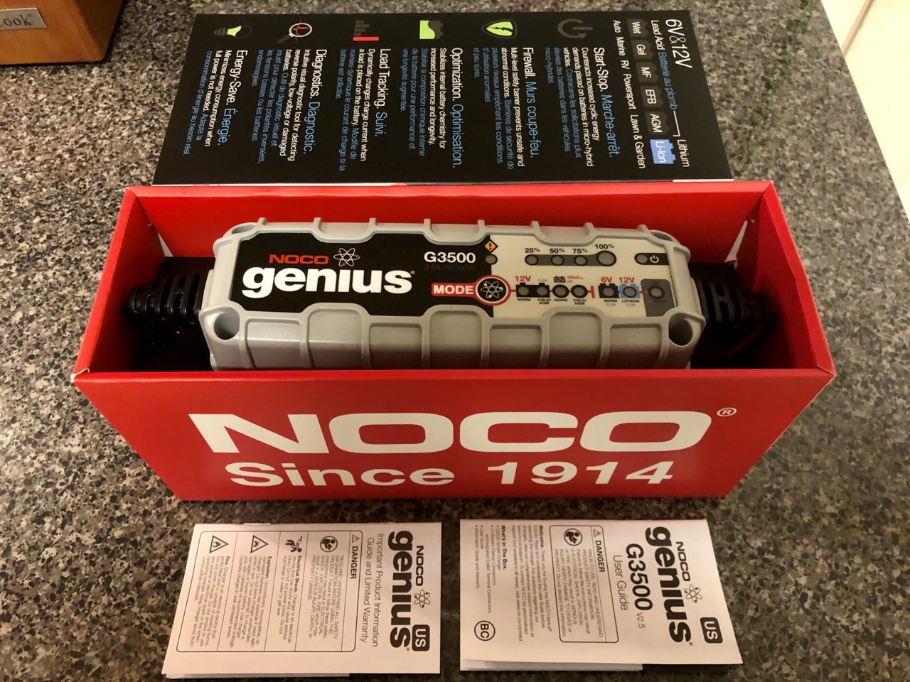

    Got a maintenance charger for the AGM battery.

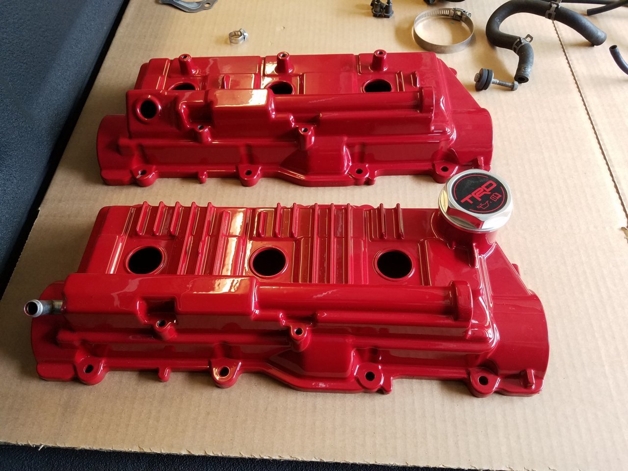

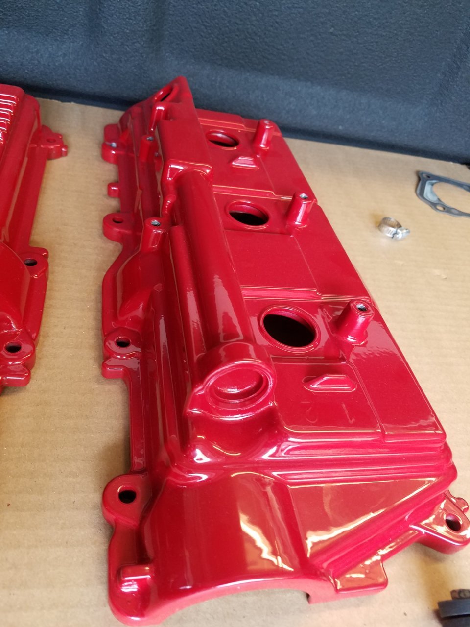

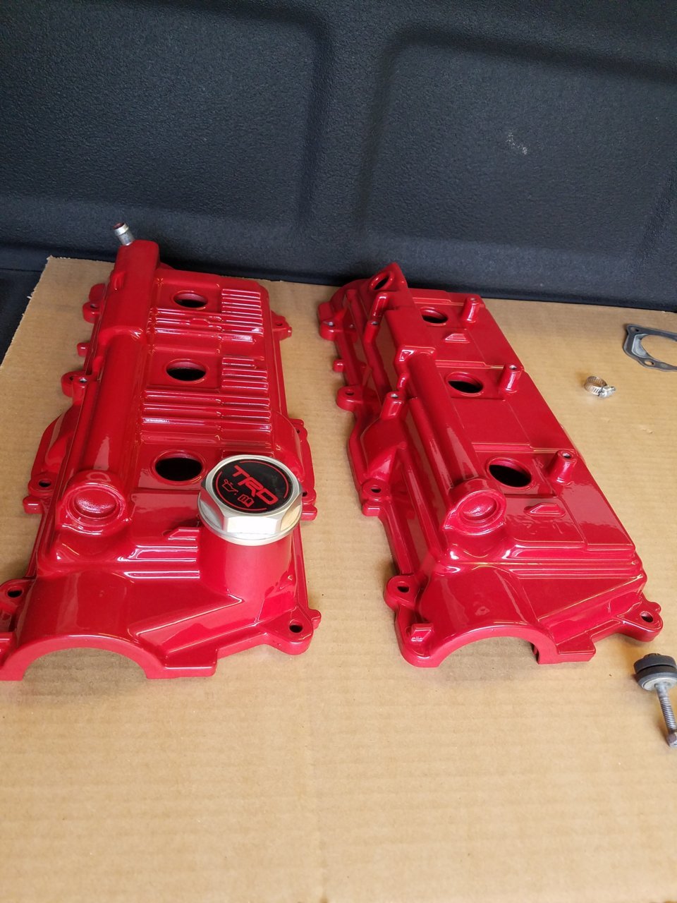

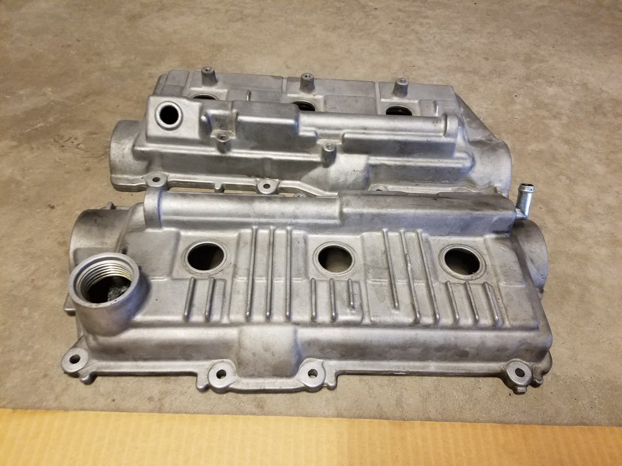

    Made some progress today,
    Got the gaskets in,
    The half moons in,
    Cam seals replaced,
    Spark plug seals in,
    they are now torqued and bolted down :)

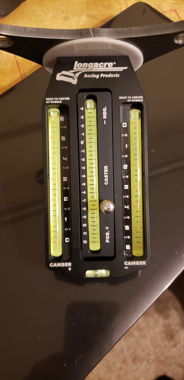

    Did my first DIY alignment. I went by the write up on here, that harbor freight gauge is a piece of garbage, no matter how I calibrated it is would be off 2 seconds later. I even used a machinist level, no dice. So I bought a longacre camber/caster gauge, machined a mount and it made the process way easier. -.75° +3.5 drivers, -1° +3.5 passenger. Drives way better, keeps straight and corners well. No more arguing with the alignment dicks that I want + caster not - and - camber and not +. After three alignments my truck still looked like \ / and drive like crap. We'll see how it goes, I'll drive for a few days and tweak it a bit and see what I like.

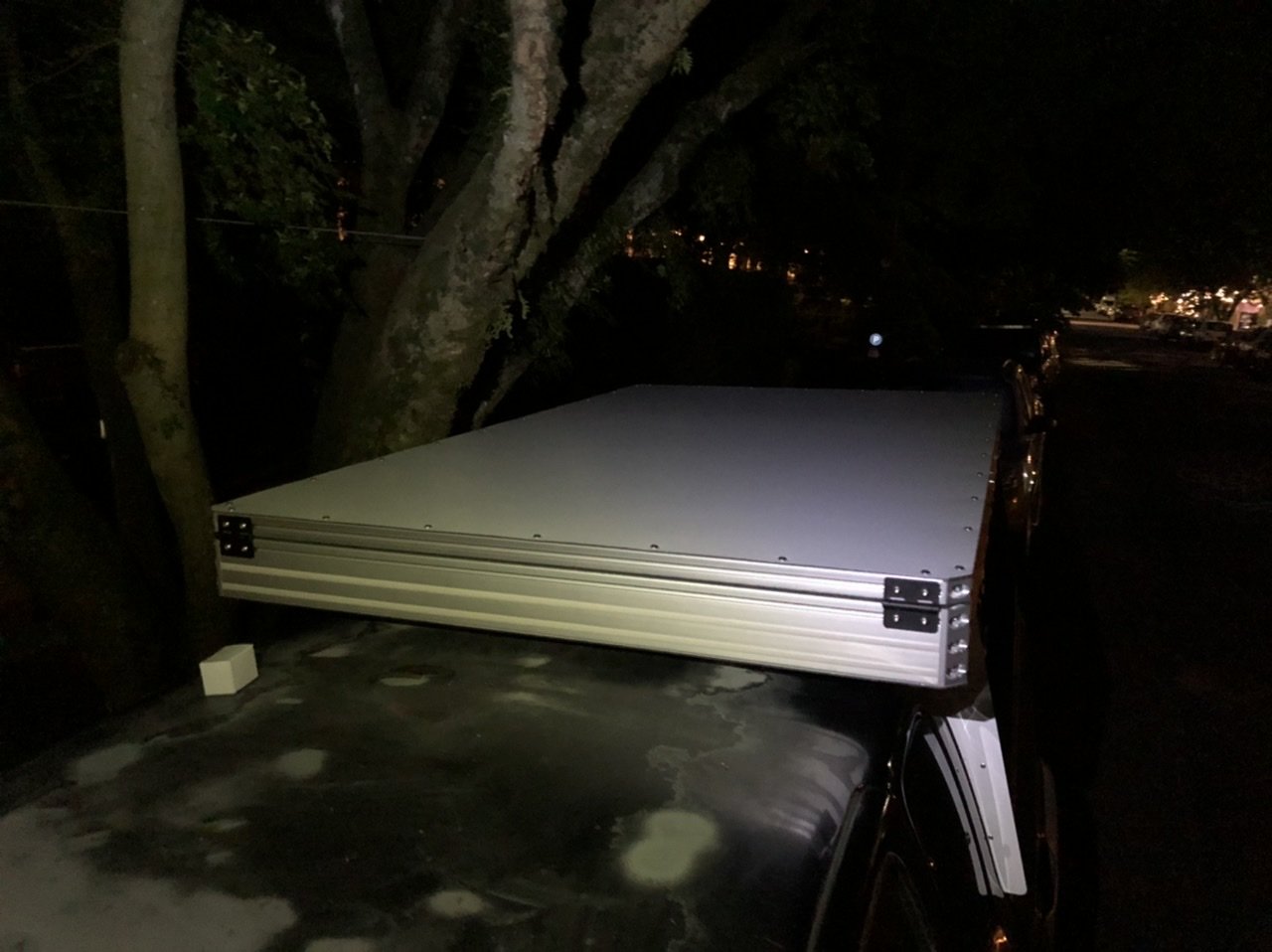

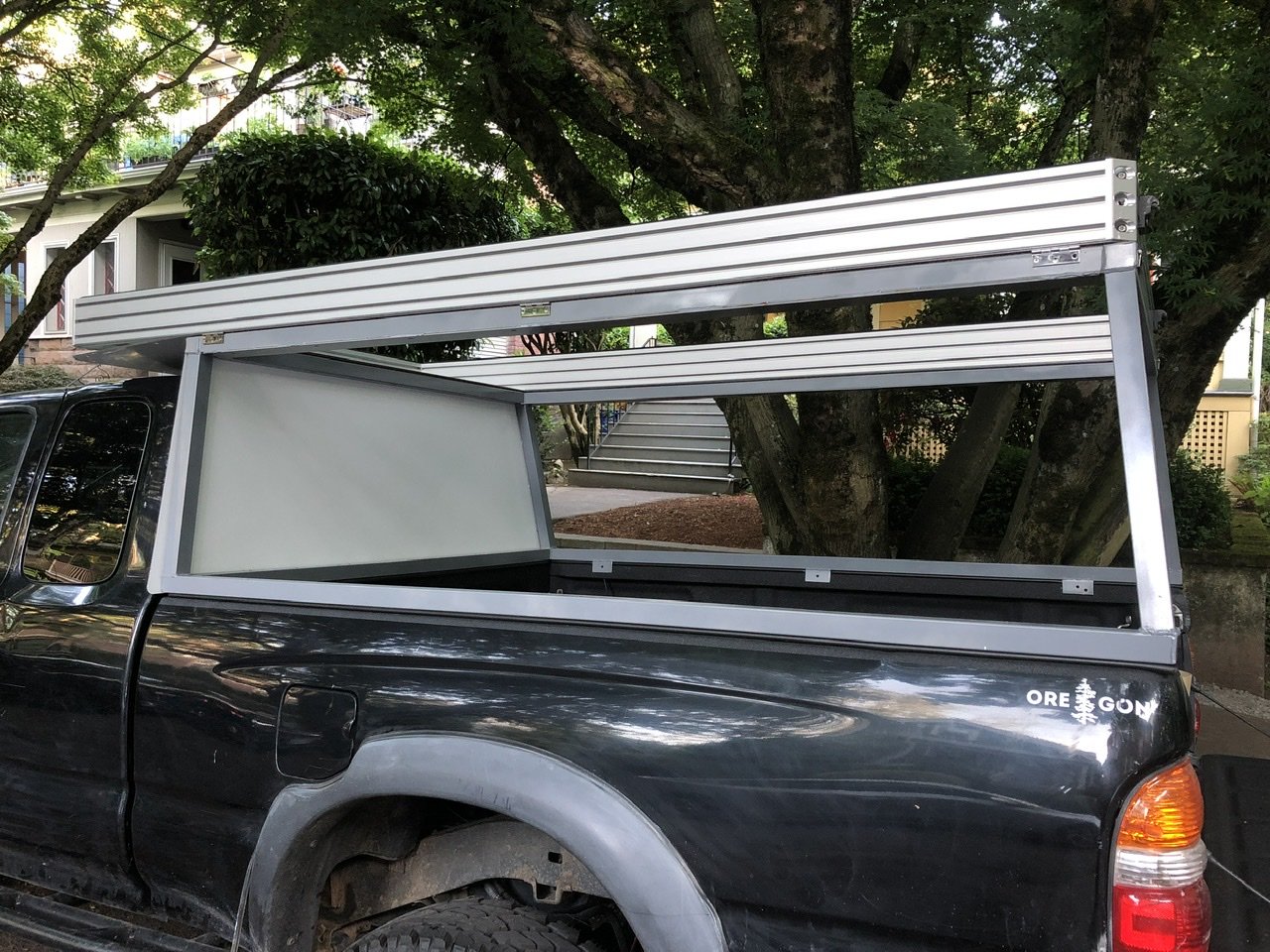

    Closer...just plain giddy with how it’s coming together and very thankful for carefully measuring and lining everything up before drilling and painting.

    Looks good!
    I can already recommend beefier hinges.
