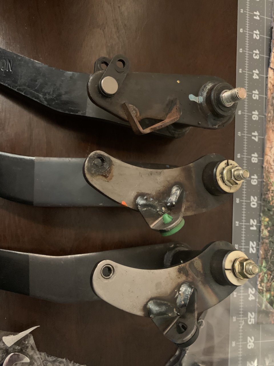

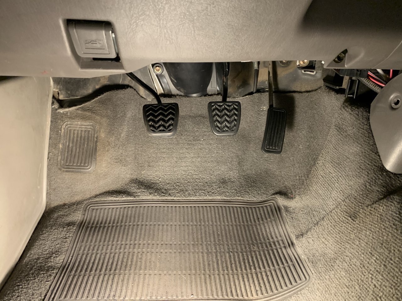

    Well she has three pedals instead of two now! Pretty sure it's more a manual truck now then an auto... Just an FYI the brake pedals are different between the early first gens and later models like mine. Different bolt and sleeve size, different curve where it connects to brake MC. So ended up having to purchase a second one from an 03.
    Here is a pic of all three: (Top is 99' manual, Middle is 03' auto, bottom is 03' manual) You can see the top one is shaped differently and the bolt is larger along with the pin that connects it to the brake booster/MC
    L.O.R.A - Now with more pedals:

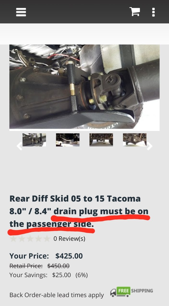

    I get what you're saying. Sometimes Toyota just doesn't make sense. My 8 inch e-lock housing is on the driver side. The skid fits up tight to the diff, so if the drain is in the wrong side (I'm assuming) the drain wont allow the skid to get close enough to install (hole in skid allows drain and ring to pass through it)
    If I were positive that is the only thing that would cause a real problem, I'd be interested. But doesn't seem like there's any real interest to find out on a 1st Gen.
    One of these days I might see if a local 2nd genner has the diff and would let me test fit, I don't know.
    But as far as fitment info... I'm just going off what it says on Jerry's site.

    That's because the booster and MC are totally different in the early years vs later. So makes sense.
    Hm so this is saying that 2nd gen axles all drain on the passenger side then. Interesting. Wonder why that wouldn't fit with a 8.4 1st gen axle.

    I agree 100% about the 8.4... it SHOULD fit. As far as I know they are the same housing/3rd (I think the 2nd Gen axel is a little wider though iirc, but that wouldn't make a difference here).
