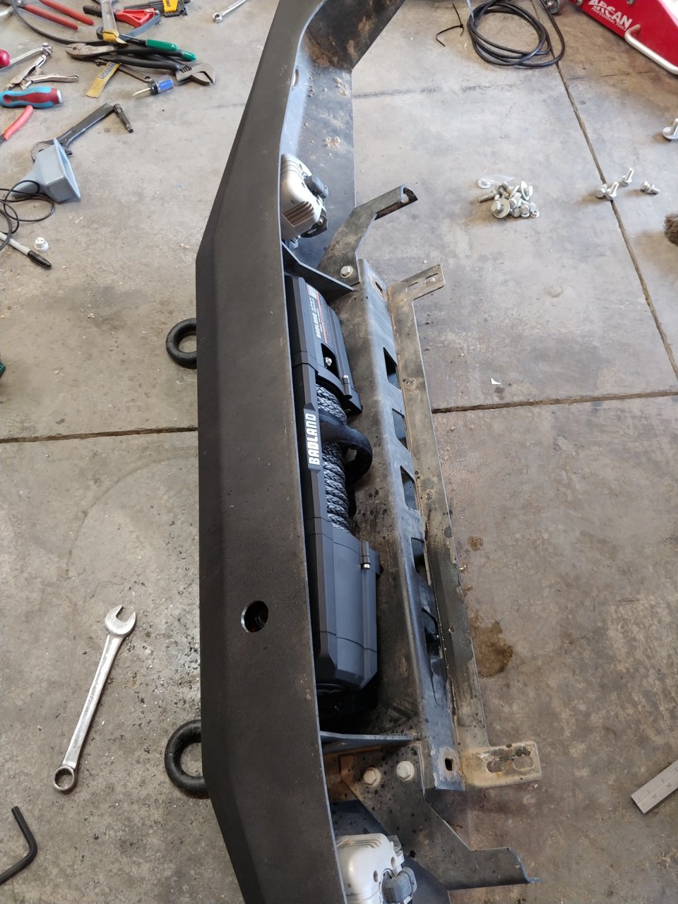

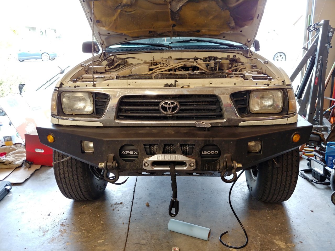

    Looks good,
    What’s the weight of that winch

    The way this one is configured with synth rope and the contactor box relocated the winch itself weighs in just a hair over 42lbs

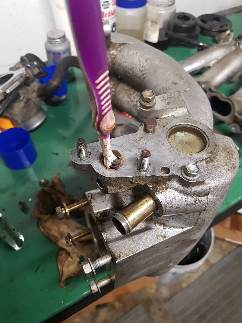

    What is that? Your intake on your Plenum?

    3rz intake, the top half. 200k miles of pcv and egr crap. I can get it off...if I can get to it. I can't get to most of it.

    Xylene does wonders for this

    Hmm. Acetone did really good on the oily stuff, is xylene good for the EGR deposits?

    Pretty much anything oily or carbony. At work if we have to work an an aluminum intake manifold we just soak it in a bucket of the stuff and it comes out new. Alternately if you want to avoid dangerous chemicals you can soak it in marvel mystery oil or atf
