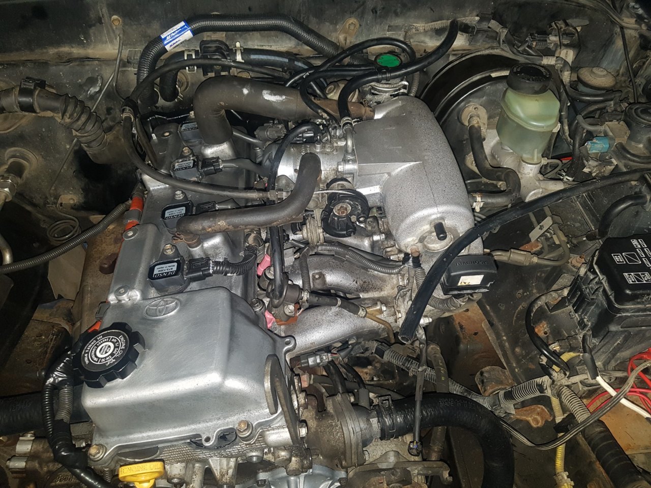

    Yeah I don't mind strong stuff, but I don't have a good way to dispose of it afterwards.
    I got the lower manifold looking pretty good with a toothbrush and dishwasher detergent, then soaked it for a bit and let it dry. The upper is still in process, and I'm afraid to do too much cleaning on the throttle body having heard of idles speed issues that I don't want to diagnose right now.

    With any luck, I should get it running again this month. Yaay. Next step - figure out where these bolts go, find places for all the hoses and plugs, and then check them.

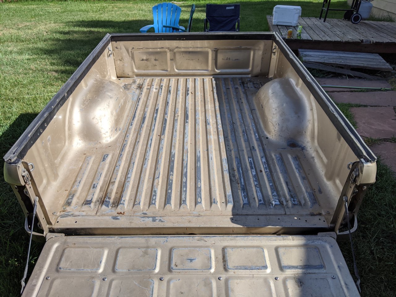

    Took my topper off, removed all of the windows and roof rack, sanded and got it ready to apply Raptor Liner tomorrow. Looks to be a nice cool, low humidity day, so should be great for painting.

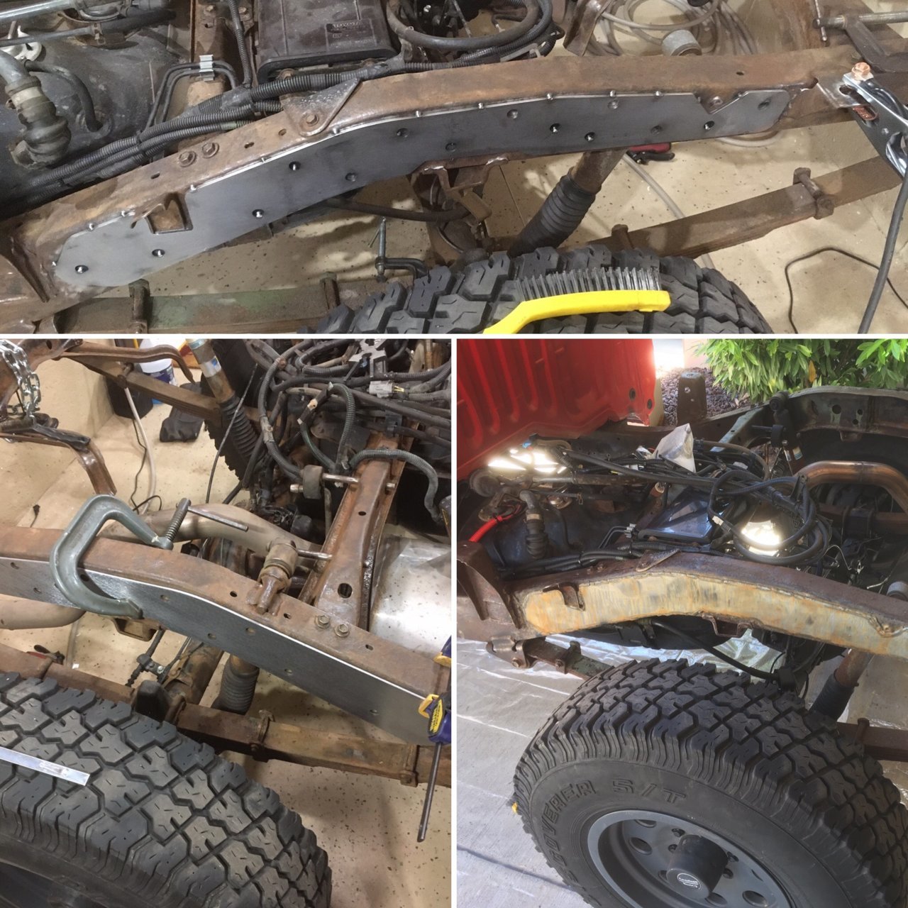

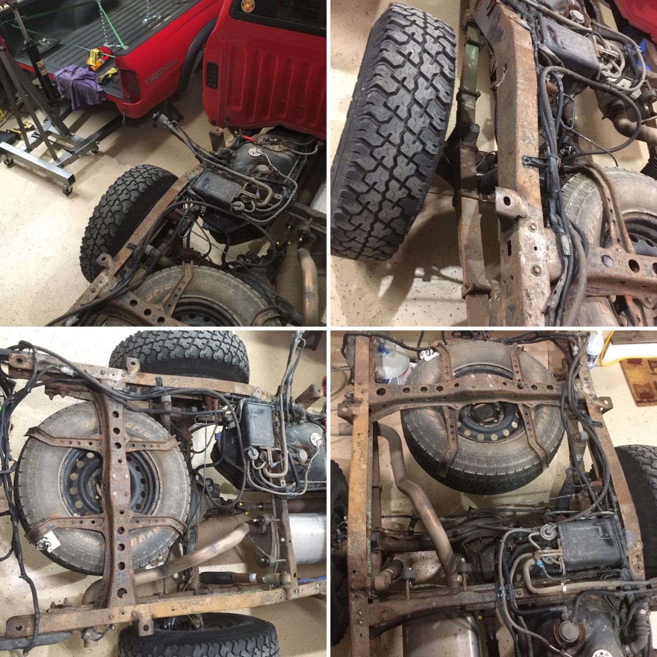

    Continuing the rust prevention project, the bed was pulled off this weekend. Spent a good part of the day grinding, brushing, cursing, contorting, and otherwise trying to knock off as much loose rust as possible from every spot I could reach. Powerwasher and a air wand was very useful for the nooks and crannies. I used Eastwood internal frame coating for the boxed front sections of the frame, but the stuff sprays so quickly, I wasn't able to finish the whole thing with just two cans.
    Before removing loose rust:
    I was alarmed by how much rust flakes there were, so about two weeks ago I ordered some CBI frame reinforcement plates to reinforce the already weak sections that were probably even weaker from all the rust. I was surprised when the plates showed up this weekend, the website said they had a 12 week lead time. Much easier to weld while I had the bed off. After welding it out, I prepped the bare metal by letting it rust lightly so the rust treatment sticks to it better. Washed down everything with degreaser and now she's all ready for Chassis Saver.

    Curious, what did you paint the frame with?

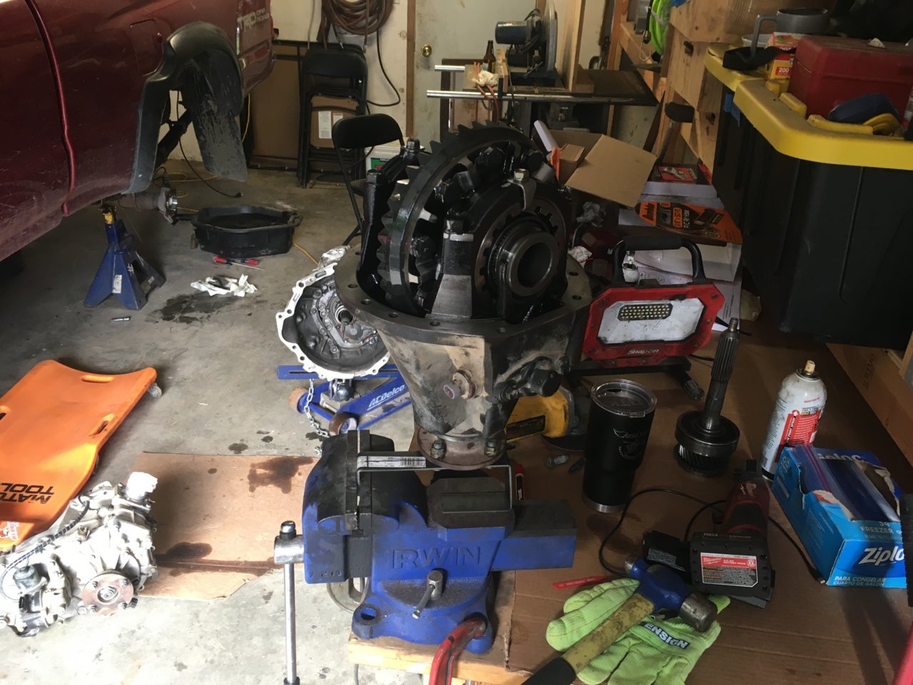

    I’m waiting on some tools and a few parts from ECGS that will be here tomorrow. Trying to get everything prepped so when the tools show up, I’m ready to dive into the actual regear and locker install. I got the rear diff out and the mating surfaces cleaned up yesterday.
    Going to get the front out today, and work on routing my trans and tcase breathers to right above the brake booster.
    I pulled my trans for a noisy clutch release bearing that should be here tomorrow. Going to replace the pilot bearing while I’m in there the clutch only has 9,500 miles on it, otherwise I’d be throwing a heavy clutch in it. My output seal on the trans was leaking too and the seal was a little messed up. Probably my fault from last years transmission input shaft debacle. I’ve been running Lucas 85/140 in my rear end and think I’m going to start running it in the rest of the gear boxes. Most of my driving in this vehicle has become lugging in 4 lo, 1st gear and there’s been a lot of gear noise associated with that under 750 rpm. The condition of the gear oil upon draining made me feel that I’ve had too much load on it at low rpm. Hoping that the combination of 5.29’s and 85/140 help out with that! (Maybe I just need to hurry up and finish sourcing parts for my dual case) Going to up my oil change intervals too for the gear boxes.

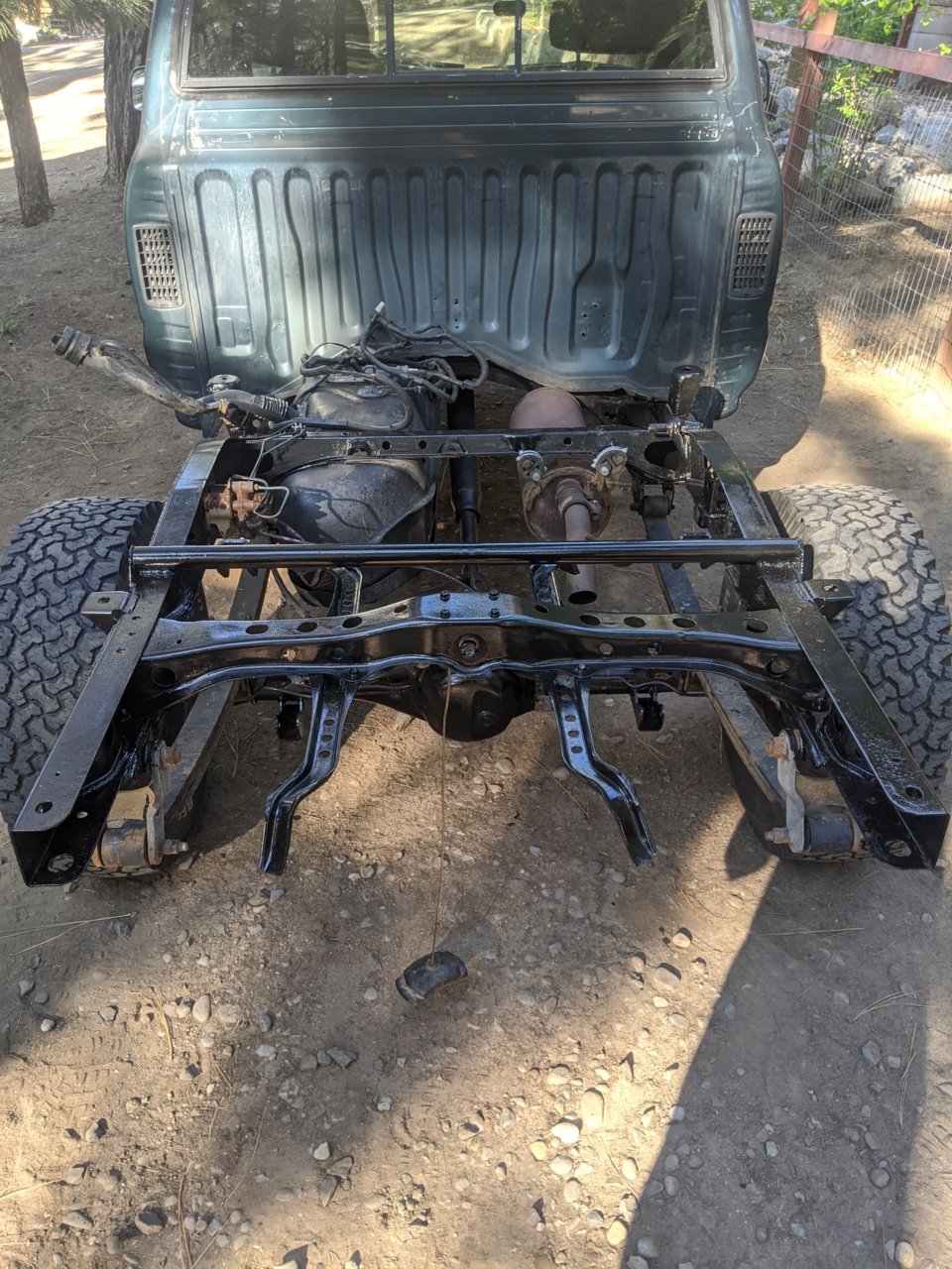

    I just used Rust-Oleum oil based black role on. I don't have to deal with rust like on the east coast. Just wanted cover up the bare metal
