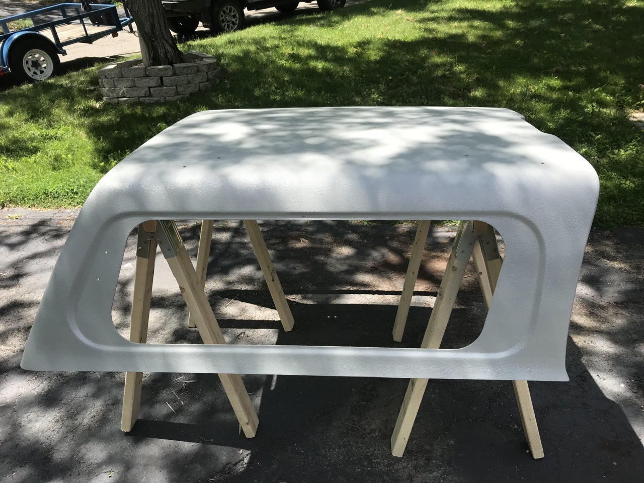

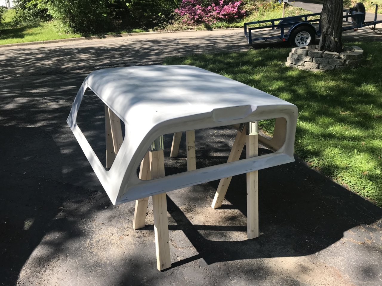

    First portion of Raptor lining the truck. Went reasonably well. I wound up with a bit of streakiness across the top. Mostly, the fault was with the spray gun that came with the kit. It was not adjustable to get a low flow of material. However, half way through, I switched over to the Professional version of the gun, and it was like night and day. Should have just started with it, but..... But the streaks remained a bit even after the second coat, but greatly diminished. Fortunately, they will be hidden under the basket rack anyway. This was a great trial run for when I start doing the remainder of the truck. Up next will be the new bed that I acquired in Florida. A little body work to do, mostly just bumps and dings. Fortunately, the bodywork will not have to be absolutely perfect, as Raptor will hide a lot of my sins.
    This is after sanding and cleaning, ready for Raptor.
    Here is all of the materials that I assembled
    And here is the end result:

    That came out great! I plan to do this to my shell and then the whole truck as well.
    What color did you end up using? Did you tint it to a toyota white or is that the standard raptorliner white?

    That is actually tinted to Lunar Mist silver, same as truck. The sun and shade didn't work well for photography. But it is a pretty good match to the factory paint, color wise, but the metallic doesn't show, as they had advised on the website.

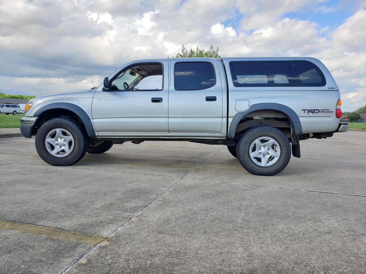

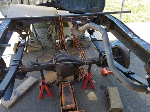

    Reference my rear frame rebuild:
    Got my General springs and Monroe shocks mounted. Used ratchet straps to pull the rear diff into proper alignment to get the spring datum pins into place: one strap preventing diff from rotating down in front; the other pulling forward off the trans crossmember.
    Frame still has some minor things to be done, but it is already a lot stronger than original, even with no rear crossmember (spare tire mount) bumper, or trailer hitch.
    I bumped the right brake line near the drum with cutoff wheel while cutting off the u-bolts. Fluid leak (see spot on concrete RH side near wood block). Will be replacing the line feeding the right wheel cylinder. I was going to drain and refill brake fluid anyway, but still disappointed I hit that line. I got the bleeders and the line fittings broke loose. Had to use the heat + candle wax trick on one line fitting.
    Also, you can't buy rear spring mounts anymore. That's not the worst news. The inner diameter to match the rubber bushings is not SAE: 1 1/4" is too big and 1 1/8" is too small. Believe it or not, I had a salvage yard scrounge swing out spare tire carrier from a Rodeo and the inner diameter of the tubing was perfect.

    Looks good! Where did you get the tint from? I'm trying to tint mine the factory natural white but was having trouble finding the tint without the binder.
    Are you planning on painting your door jambs or leaving them since you're color matching your factory paint?

    I just went to the local automotive paint store, told them I needed to tint Raptor Liner, and they knew exactly what I was talking about, and took my paint code and mixed it up.
    No, I am not painting the jambs, under hood, etc. since it will match up well enough, and there is no need to paint those areas, no rust, etc. I'm not sure about painting the back of the cab and the end of the bed area. Right now, I am leaning to just mask off a line below the top of the bed and stop at that line on the cab, and not do the front of the bed.
