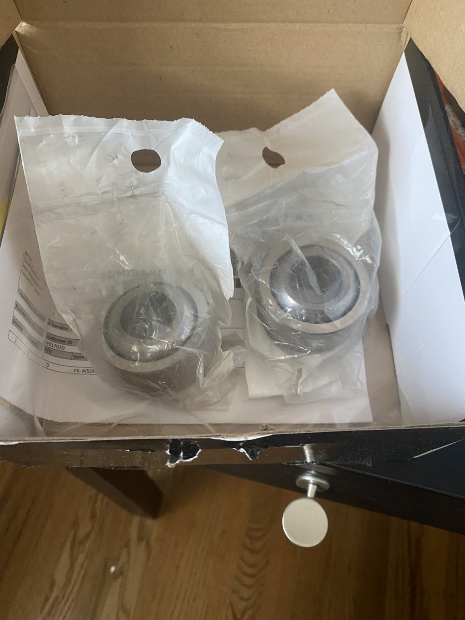

    I need to do this. They been sitting on my counter for months. Lol

    That’s how it goes for me a lot of the time. Trying to change that! Lol got these a few days ago
