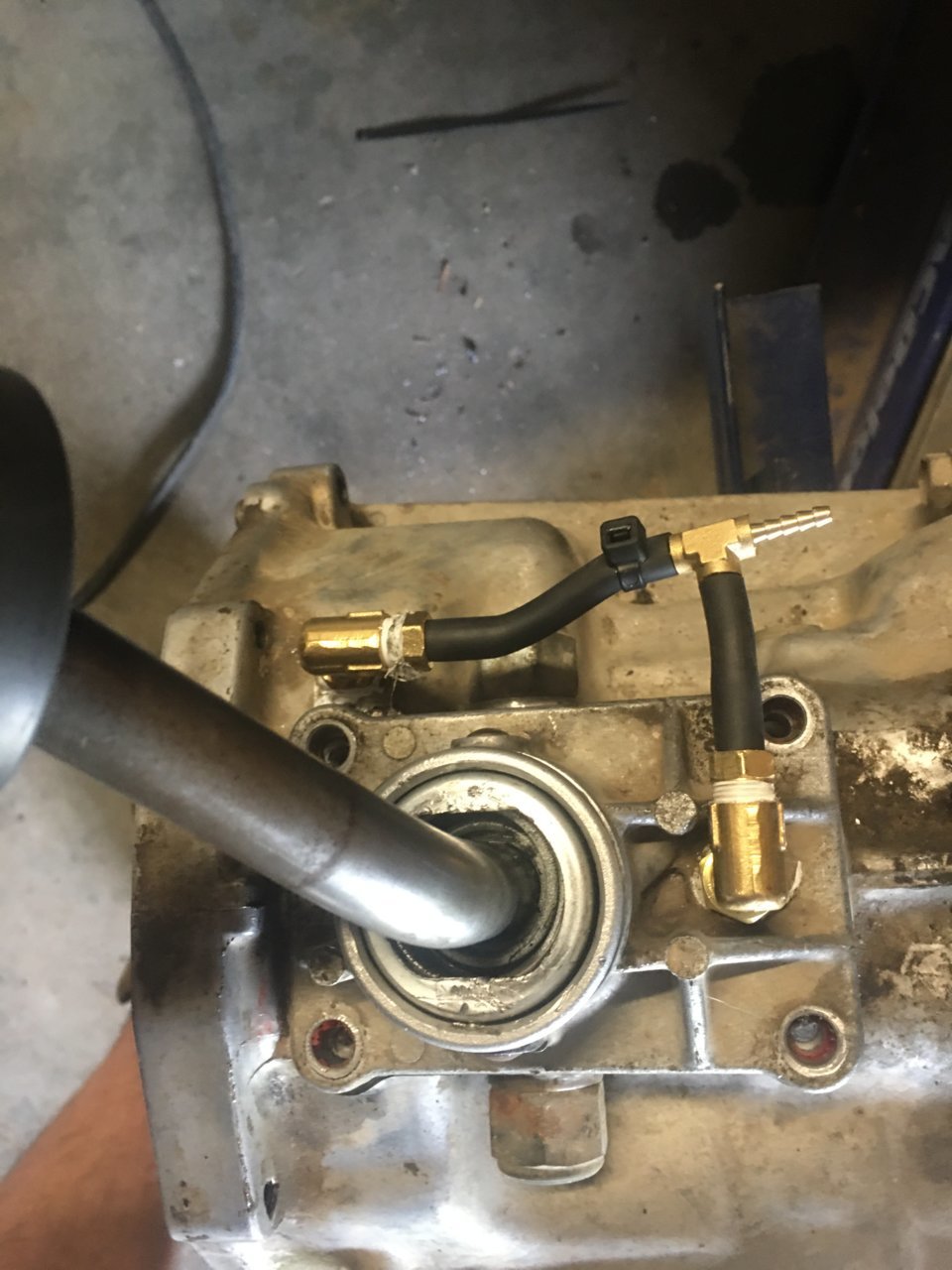

    This is how I am going to do the tcase and transB3BA5C9A-1F06-48AA-8454-8B19B22CF3DD.jpg I got this idea from a google search that led me to a 4Runner forum. The guy in that post got rid of the breather in the space between the trans and tcase by blocking it with a plug. I figured that every cavity should be vented to equalize the pressure. I used a 1/4” npt tap total the existing breather holes. This could also be done with the assembly in the vehicle, but I thought I’d do it while it’s out. Debating whether or not to run my rear diff vent all the way to the fire wall or bring it up somewhere in the rear. My thought was to put another “t” in and just run one line forward from the trans that includes breathers for the trans, tcase, and rear diff. Anyone have any thoughts on that?

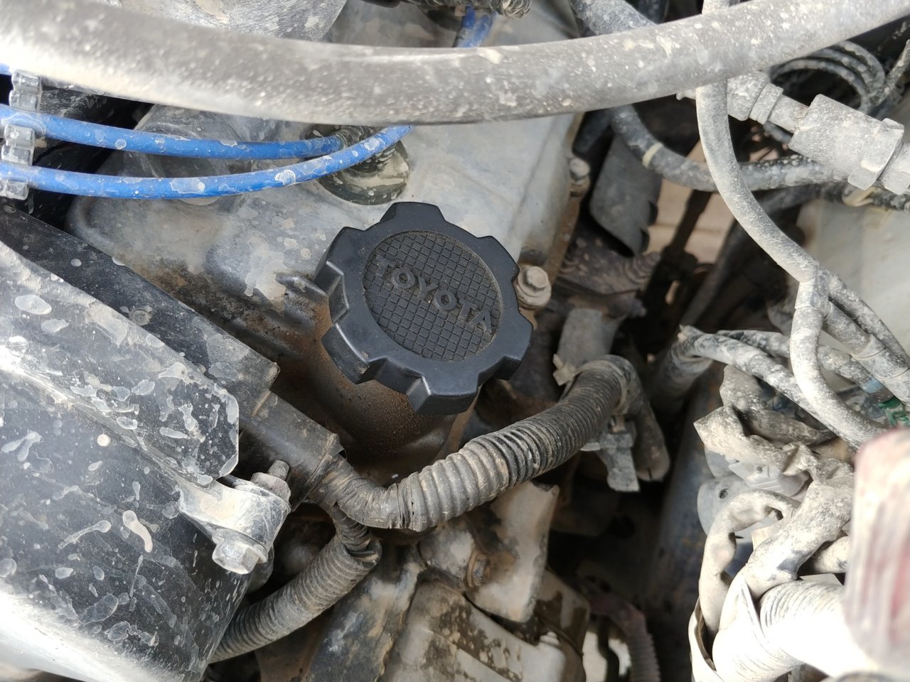

    i have that same oil cap on the tundra... came off a 86 corolla.
