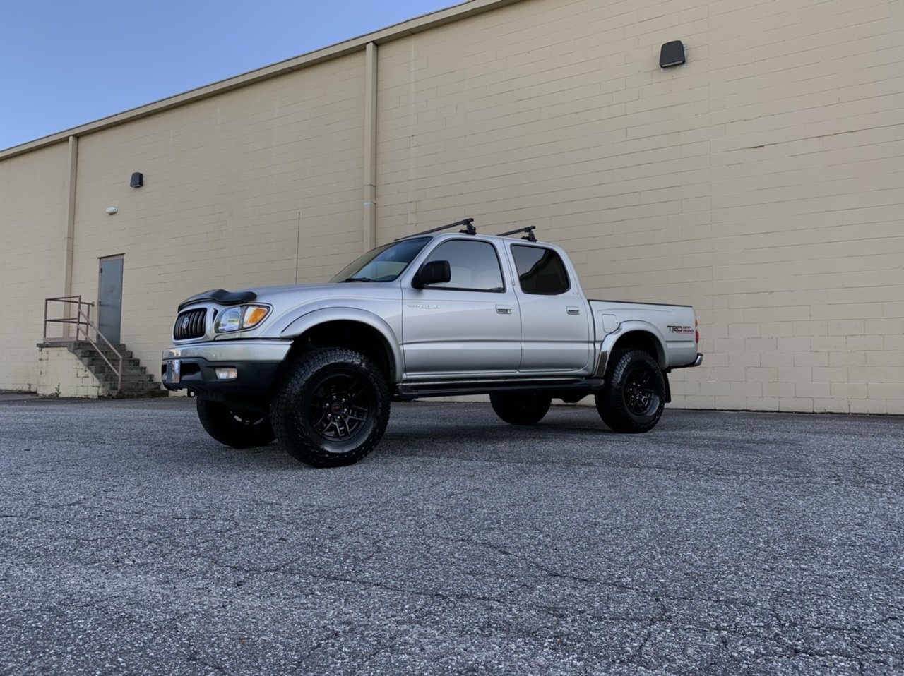

    2001 4 Cylinder 2WD PreRunner
    4 Bilstein 5100’s, 1” Toytec blocks, 2020 Tacoma TRD Pro 16” rims, w/265/75/16 Falken Wildpeak’s
    Lift and Tires installed! Bilstein 5100’s all around and 1” Toytec blocks in rear.

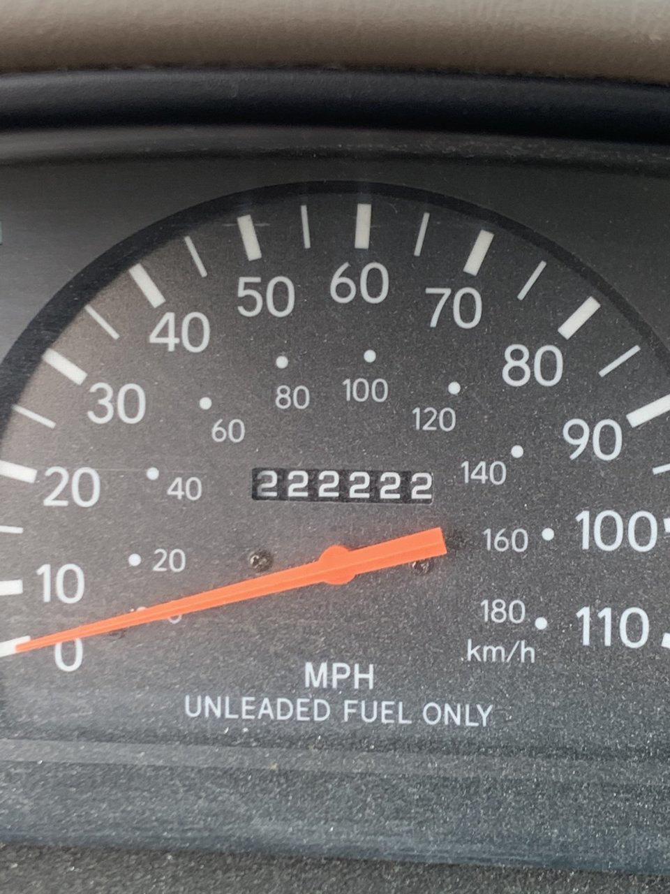

    My 99 hit this mark earlier this week

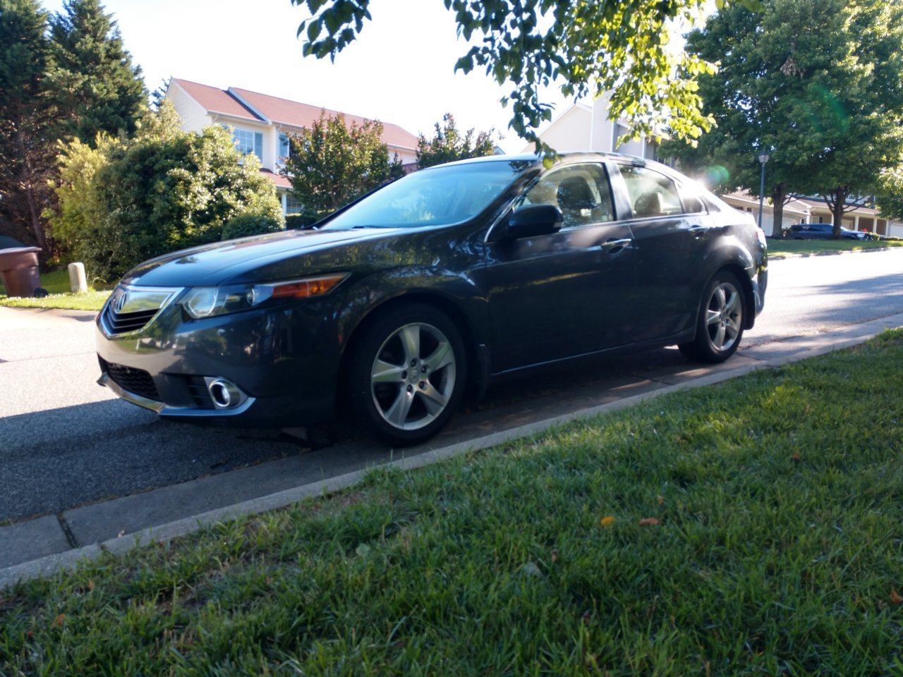

    2018 Sport
    The daily driver mod.
    2012 Acura TSX
