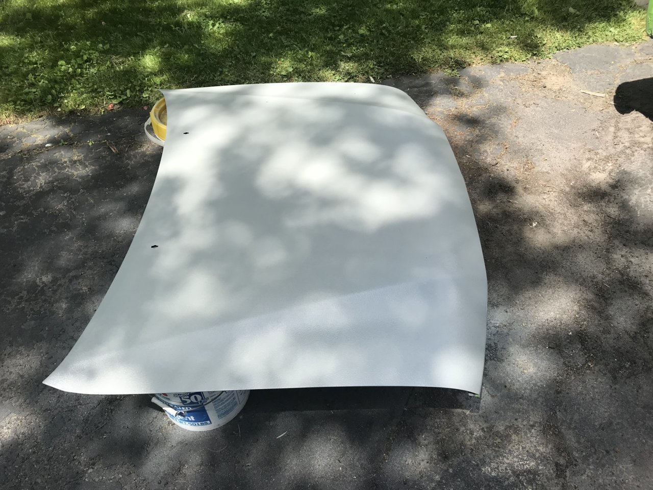

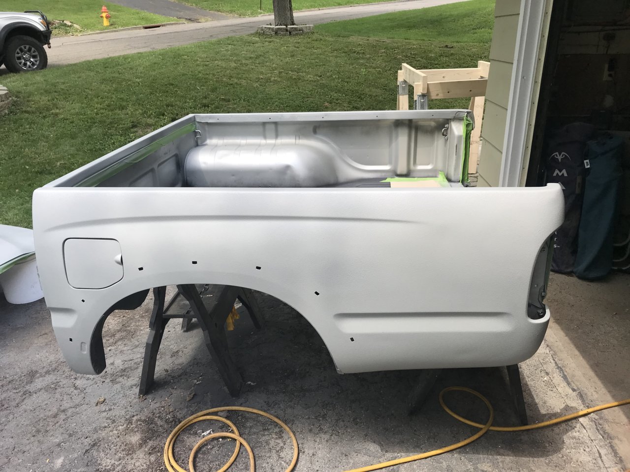

    Bodywork and paint continues to progress. My replacement bed has had a small dent repaired, sanded, and a coat of Raptor Liner. To use up the remainder of the liner that I had mixed, I also sprayed the hood. (I had prepped it just in case.) Next up will be swapping on the passenger doors from the Florida wreck.
    The splotchiness is shadows, not variance in the color.

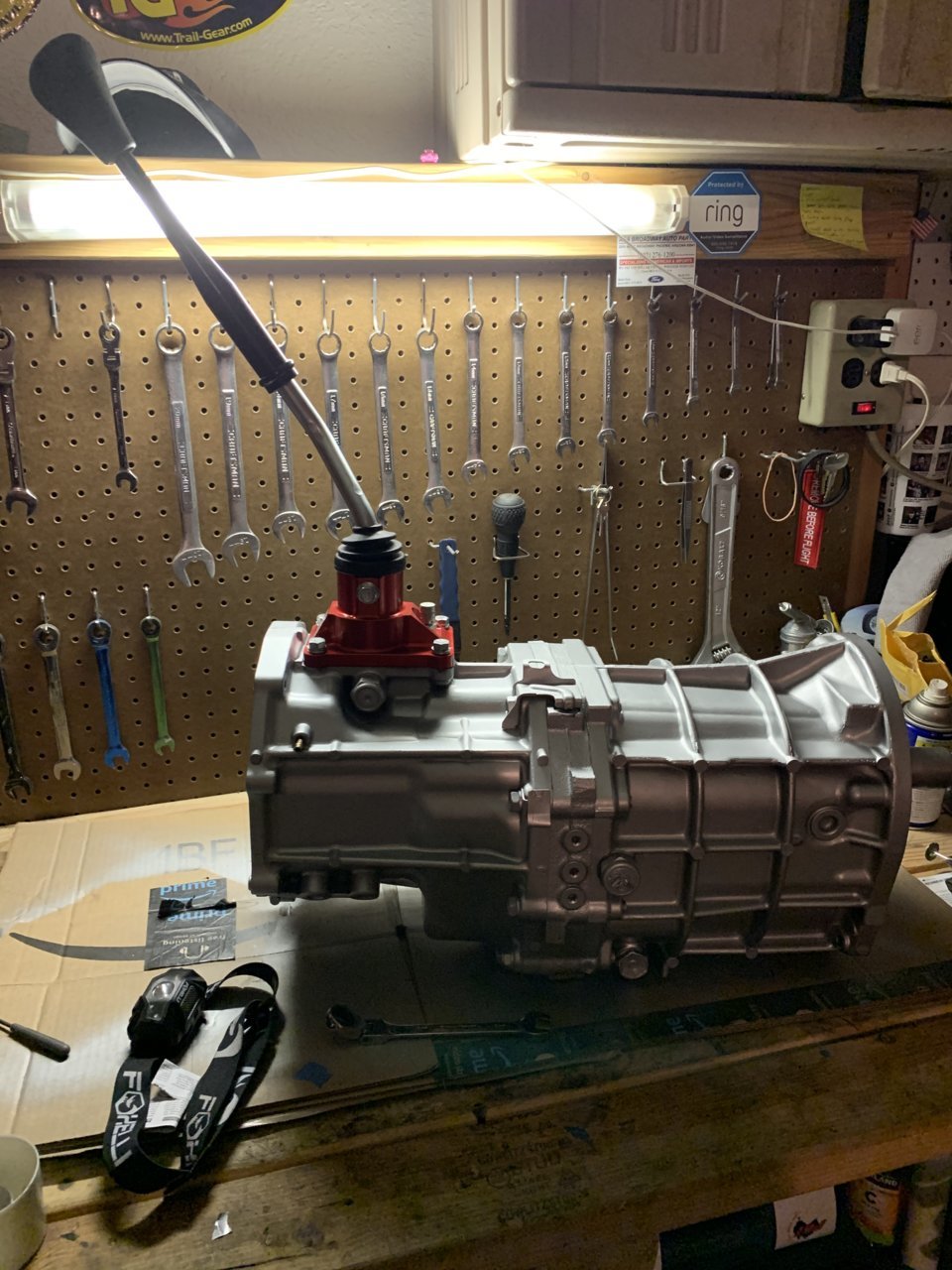

    Update on yesterday's project:
    Transmission is coming on nicely. The Federal Express dude never showed up at the door with Toyota order so still waiting on seals and stuff to button up the transmission. Got it all wire wheeled down and painted again (not that it will last, rocks & mud etc) and test fit my shifter base.
    Had some fun along the way as is normal with this stuff. Came from E-Bay with a broken bolt in the bell housing and the pins from the back of the motor stuck in it... Luckily the bell housing bolts all came loose. Broke everything free to make sure all was good. Drilled out the broken bolt and used a torch, vice grips and penetrating oil to get the stuck pins out.
    Hope today stuff arrives from Toyota so I can finish this up. Loads more still to do...

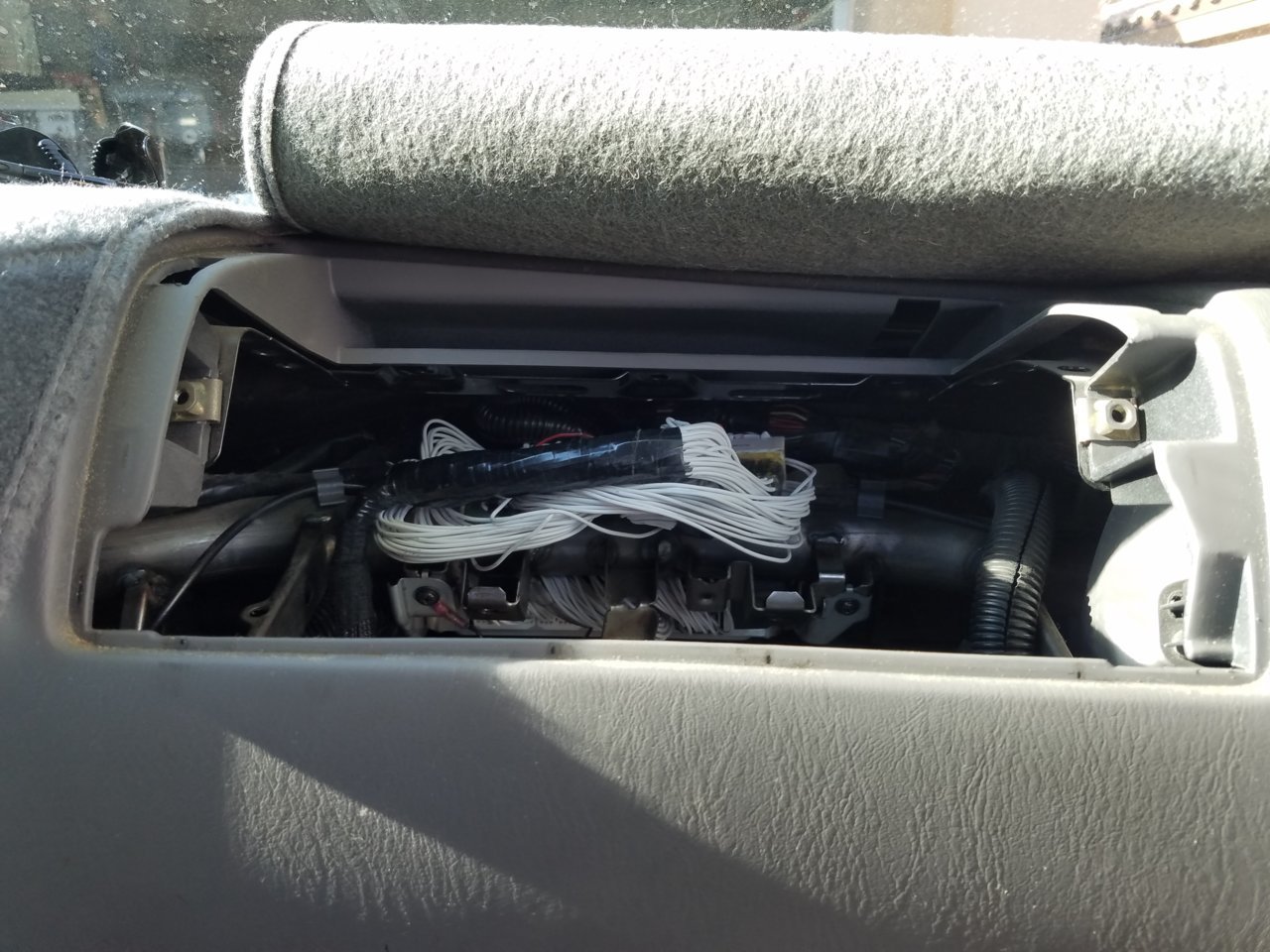

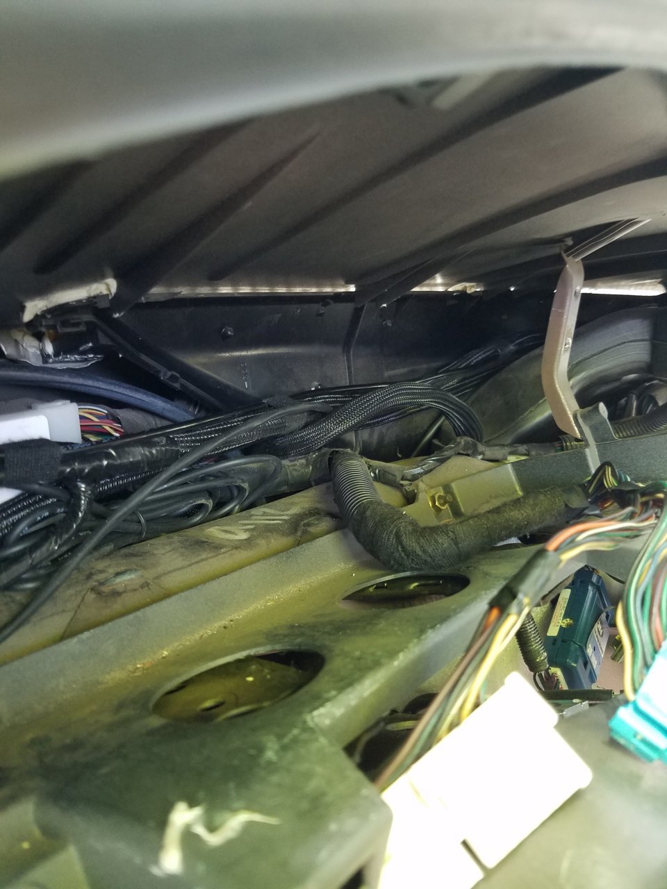

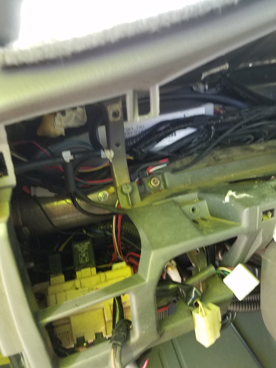

    Added i few things in preparation for supercharger install.:D
    Ran all the wires in a loom up and over the top of the A/C duct.
    Airbag removed makes it much easier to stuff fic/6 harness up and out of the way.
