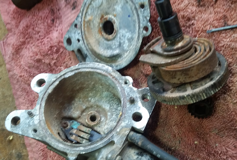

    How does one remove that shaft with gear? I am trying to swap to a manual shaft tube. Do I have to crack the whole case open? If so anything to watch out for? Never done one of these. Will be looking at the FSM also, but could use some input:
    Thanks for any insight folks :)

    It should just pop out. Kind of like the CV axle should pop out of the front diff.
    That being said, it's a royal pain in the ass.

    Ok, that's keen at least. Yeah it's gonna be a PITA for sure then. Bloody FSM shows a SST of course... :(

    Yeah I checked it out after @MattJakobs clued me in that it just pops like a CV.
    Funny you should bring up Timmy lol, couple of pry bars and some "man strength" and she is outta there!
    @Madjik_Man per your request good sir :) - It's a solid PITA, but i'd wager it is worse for some than others.
    Thanks for the help fellas :)

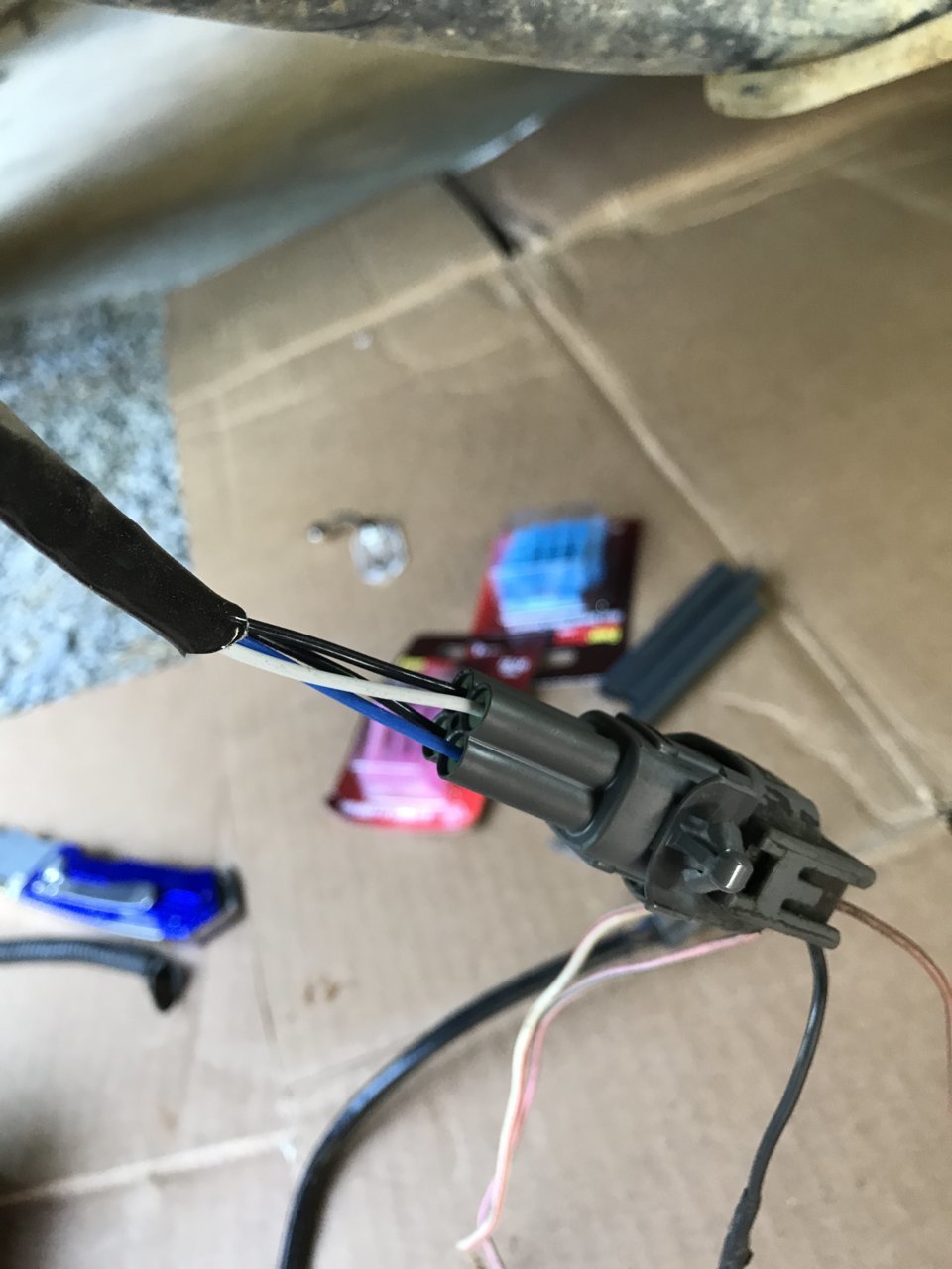

    I’m working on a new project I found sitting up. Squirrels or some rodent chewed up a lot of the wires and some connectors are gone. It’s a-
    1991 Toyota Pickup 4wd, 4cyl 22RE, SWB, Manual transmission.
    I’m working on replacing the Oxygen sensor and need help with the wiring underneath the truck. There’s no connector, just 4 wires hanging down-
    White/red
    Pink/green
    Black
    Brown
    I bought a new Denso O2 sensor from Amazon and it has 4 wires-
    Black
    Black
    White
    Blue
    Thanks for any help and information.
