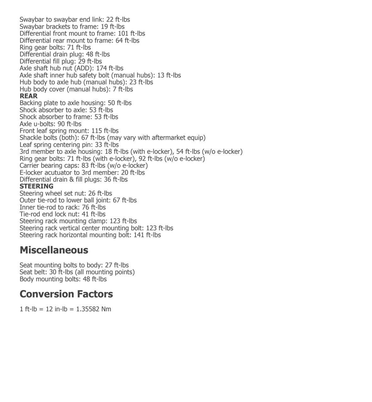

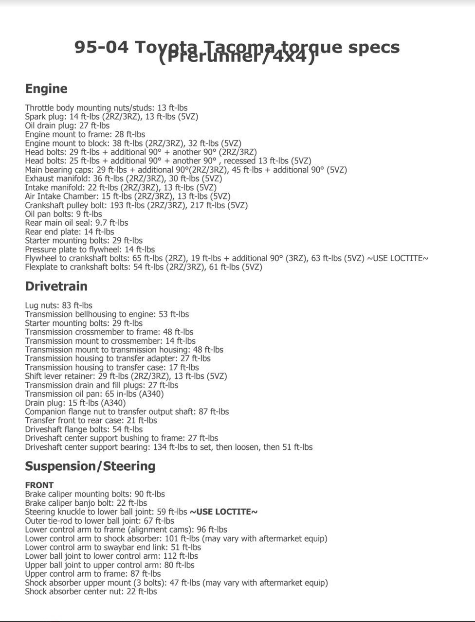

    Should I wait to torque the bolts down until I have the weight of the truck back on the front tires? And is 101 ft lbs correct for the lower shock bolt? I don't see any way to get my torque wrench onto the upper bolts.

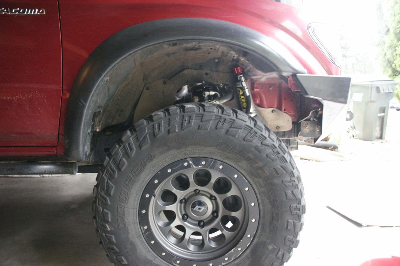

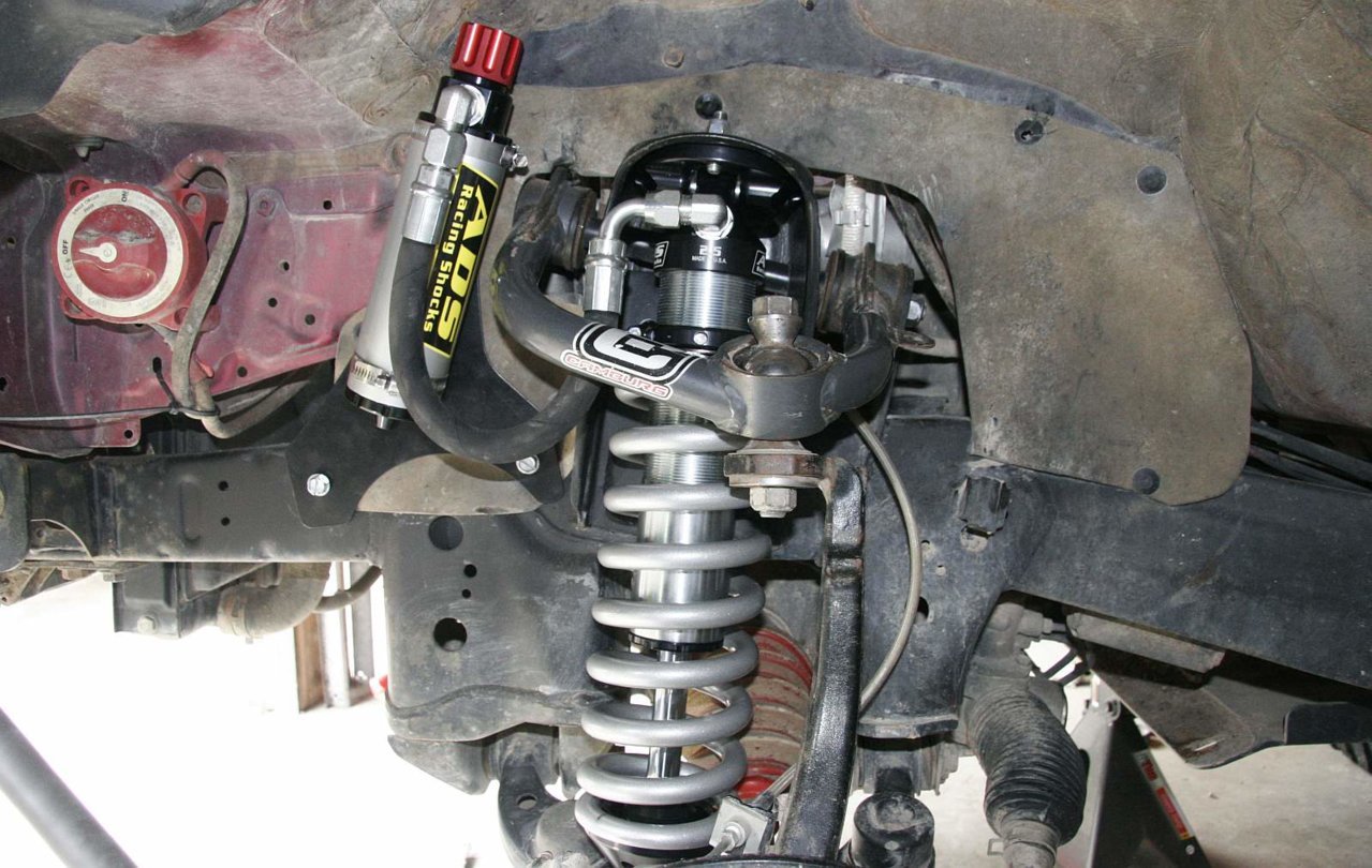

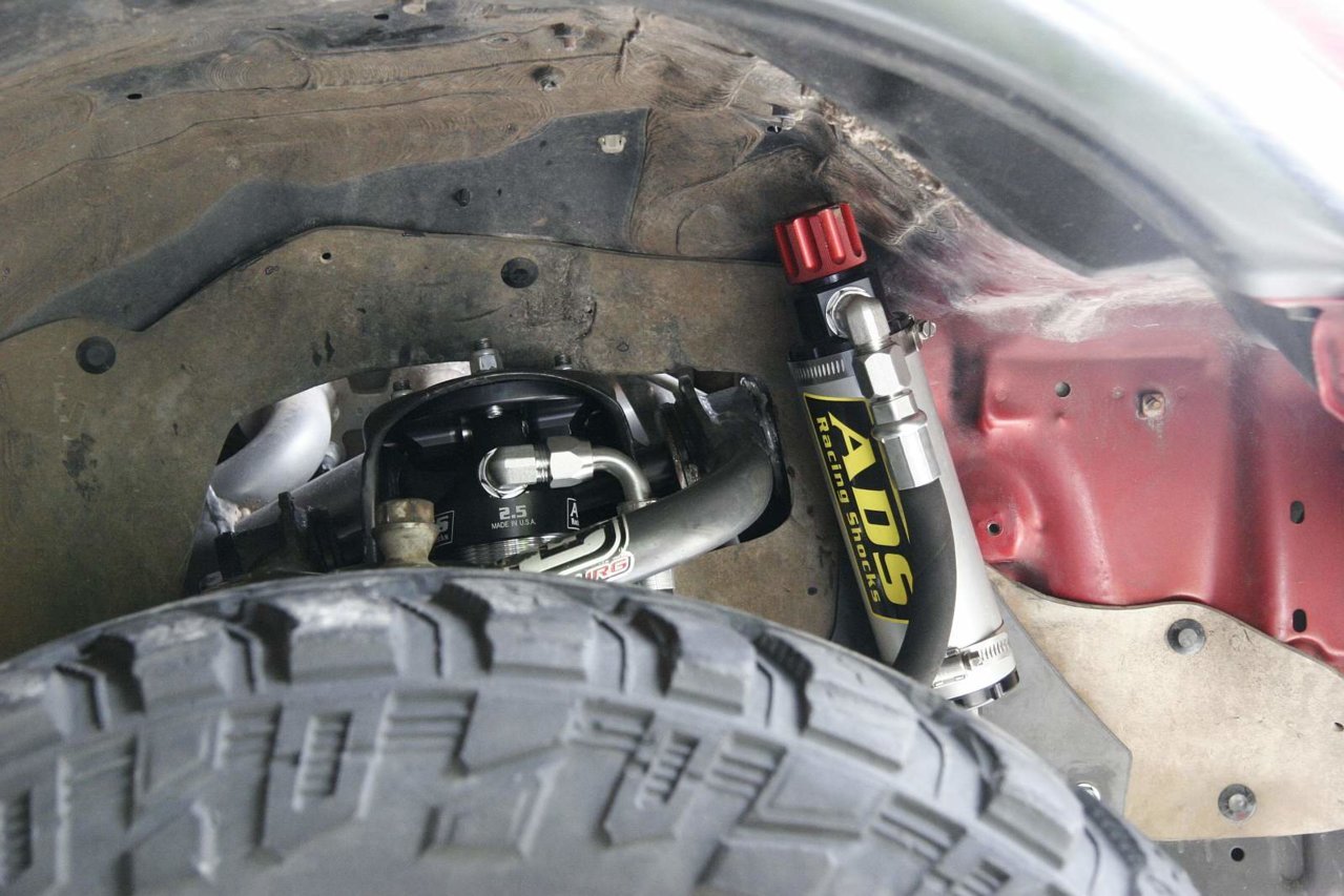

    No rubbing but only on the street so far.
    Not so much worried about the resi can, it is pretty high up and looks plenty recessed, but the bottom hose loop might be a bit exposed. I might try to rotate the can a little so the hose and fitting is pulled in more but not sure there is enough room between the can and the TC gusset. Plus, that hose is very stiff.
    They are a smooth, plush ride so far. But I've only had them on pavement with the clickers set to zero. The real test will come once I get a chance to take it out on some trails.

    Yes, hand tight then lower the truck then torque. I was also unable to do that so I used my best guess doing it by hand.

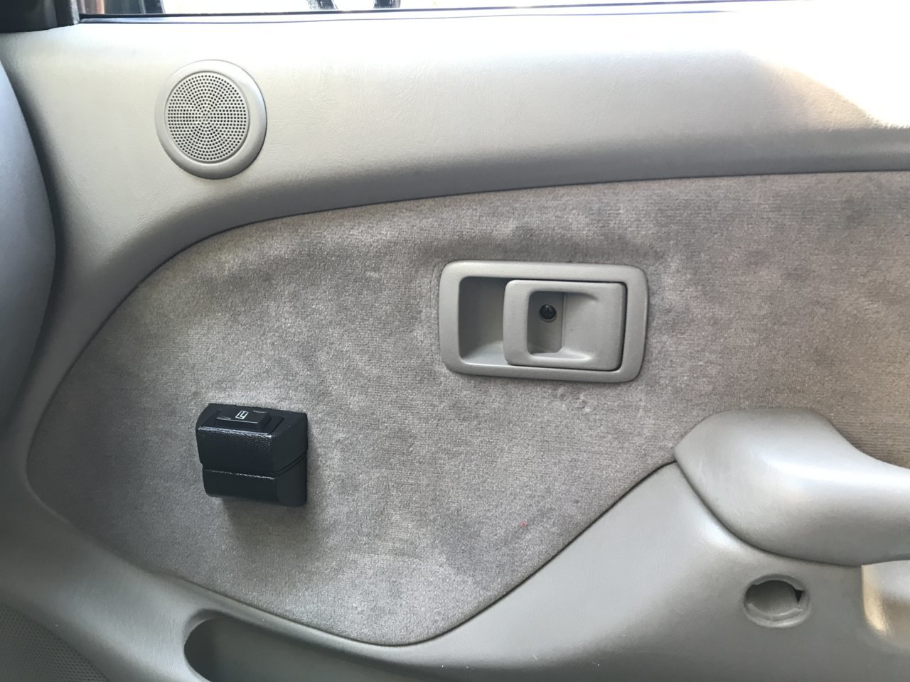

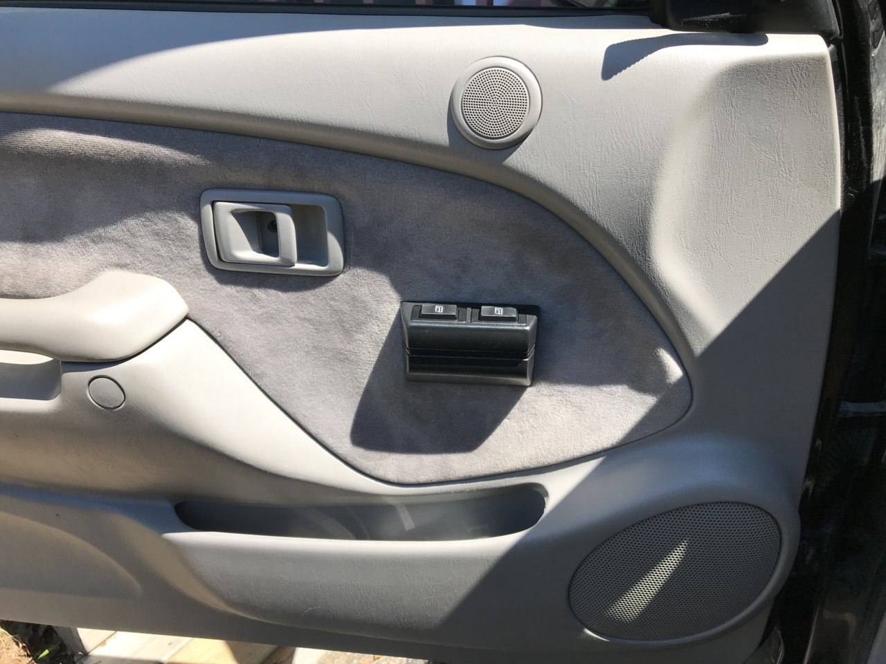

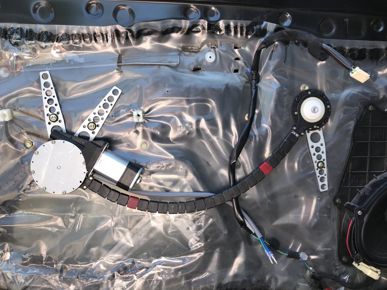

    ABS sucks.

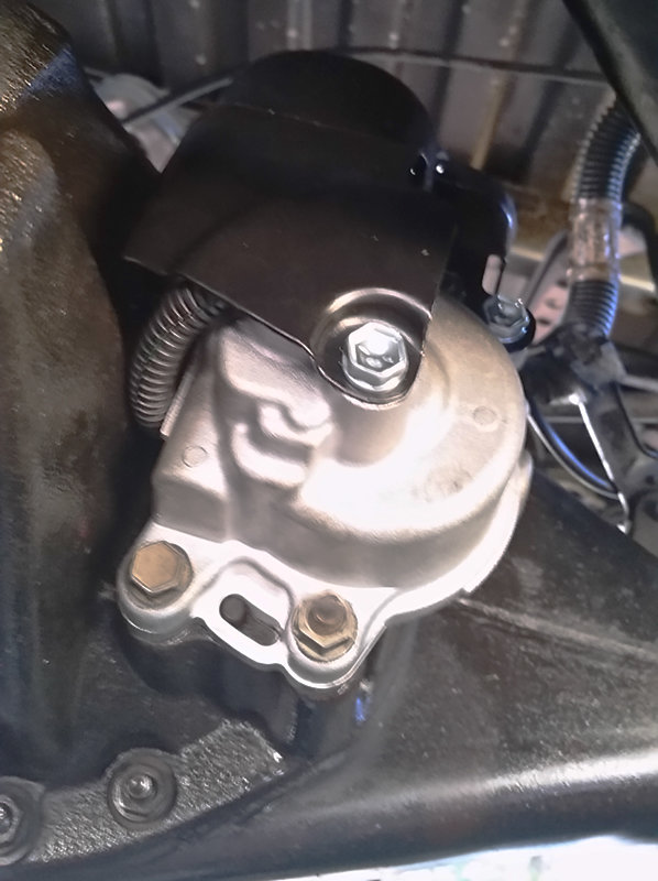

    Installed the brand spankin' new diff lock actuator today. After a couple of weeks of rewiring, testing, replacing the ECU and general hassle with this thing, I fired it up with great trepidation, realizing that I now expect it NOT to work...
    but it WORKED! Oh yaaay! - Now I can finally file all those wiring diagrams, button it up and go get stuck somewhere to really test it out...
    Of note was that the new actuator had a tube of thread locker included, and the install instructions said to make sure and use that.
    My first reaction was, "are you kidding?" - I never use thread lockers on the Tacoma - the rust will have 'er locked in a couple of days anyway.

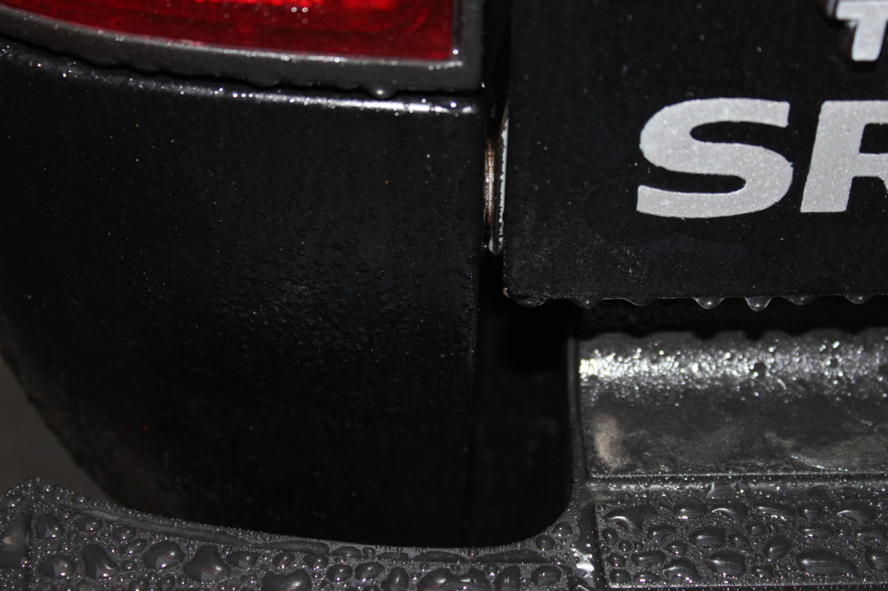

    truck has a little spot here on the tit of the tail
    put some touchup toyota stick paint on it and maybe help or not.. idk
    no body rot after nearly 1/4 century please, i have toiled so hard at it lol
    before pic
    also found a couple of other stray spots in the tail that the pressurized air gun i used to spray anti corrosion stuff in the tailgate area blew off at the edges/hinge at 100psi

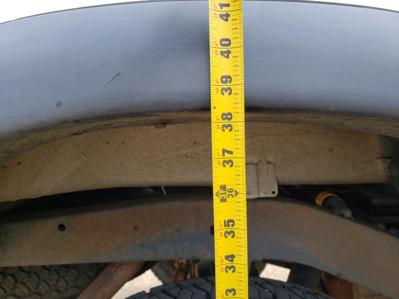

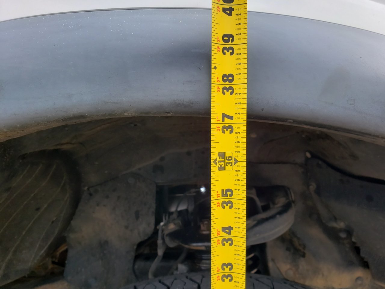

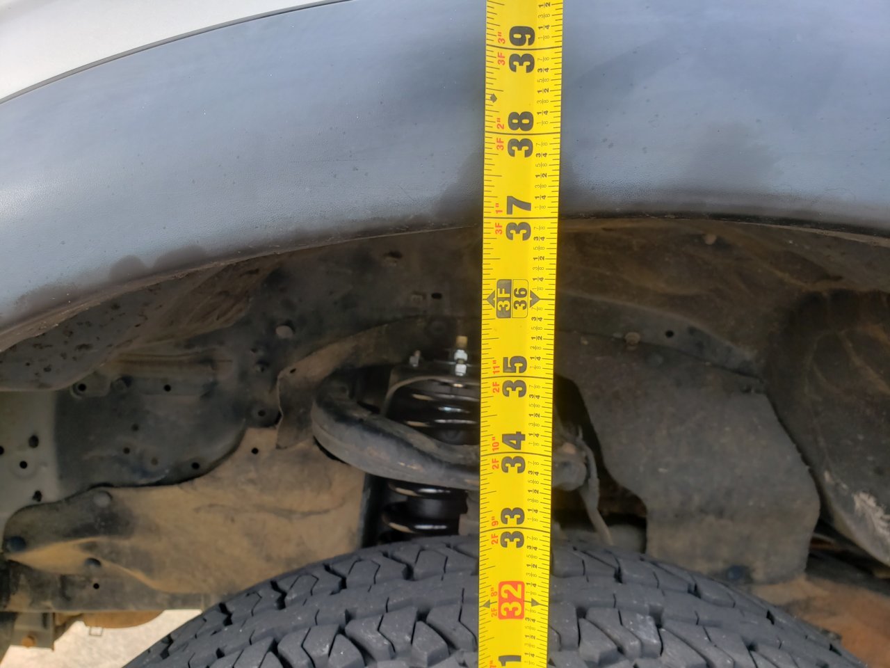

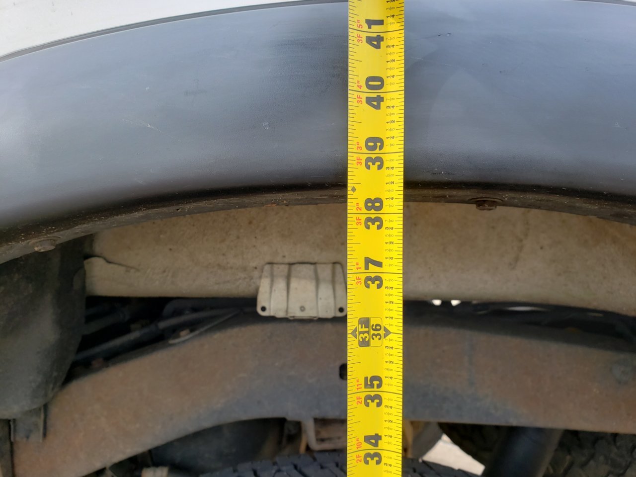

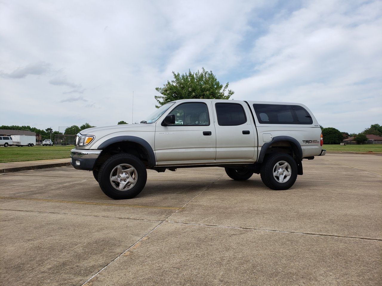

    Finished installing the coilovers. No more stink bug for me!
    About 1 inch higher in the rear, but may settle a little more. Only had the rear suspension installed about 2 weeks. I hear people talking about cycling their suspension after they install it. I don't have anywhere nearby to do that. Could I just drive each corner of the vehicle onto a rhino ramp individually to help it settle in? Other suggestions for how to do this? Thanks to everyone here on TW who answers my questions and/or posts videos and tutorials on DIY'ing the 1st gen. I couldn't do it without you!

    What suspension set up?
  16. Jun 22, 2020 at 6:05 PM
    Bluecord
    Bluecord Well-Known Member
    Sep 7, 2019
    #304573
    373
    Jeff
    Louisiana
    2003 Tacoma 4x4 TRD Lunar Mist Metallic
    OME Nitrochargers and Dakar leaf packs with add a leaf in the rear. OME coilovers with 881 springs in the front. Everything suspension wise on the truck was original equipment. With 270k miles on it.
  17. Jun 22, 2020 at 6:16 PM
    Madjik_Man
    Madjik_Man The Rembrandt of Rattle Can
    Dec 2, 2009
    #26893
    19,774
    Colorado Front Range
    1998 Ext Cab 3.4 4x4 TRD 5MT, 2004 DC 3.4 4x4 TRD
    I have the same set up on my 98 without the AAL. Interesting that you have little, to no, rake with the AAL in the rear. With seemingly stock weight back there.
  18. Jun 22, 2020 at 6:32 PM
    Madjik_Man
    Dec 2, 2009
    #26893
    19,774
    Guessing it’s just a double cab thing. They had to start making new short beds for 01 whereas they could reuse the long beds from 95-00 productions.
    cynicalrider[QUOTED] likes this.
  19. Jun 22, 2020 at 6:39 PM
    Bluecord
    Sep 7, 2019
    #304573
    373
    Jeff
    Louisiana
    It has settled about 3/4 of an inch since I installed the rear. I do have an 80 pound floor jack in the bed plus the topper.
