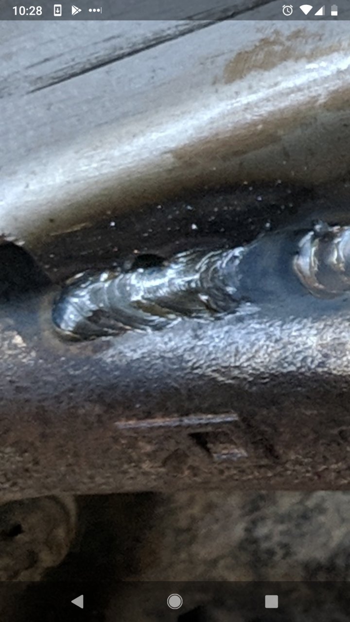

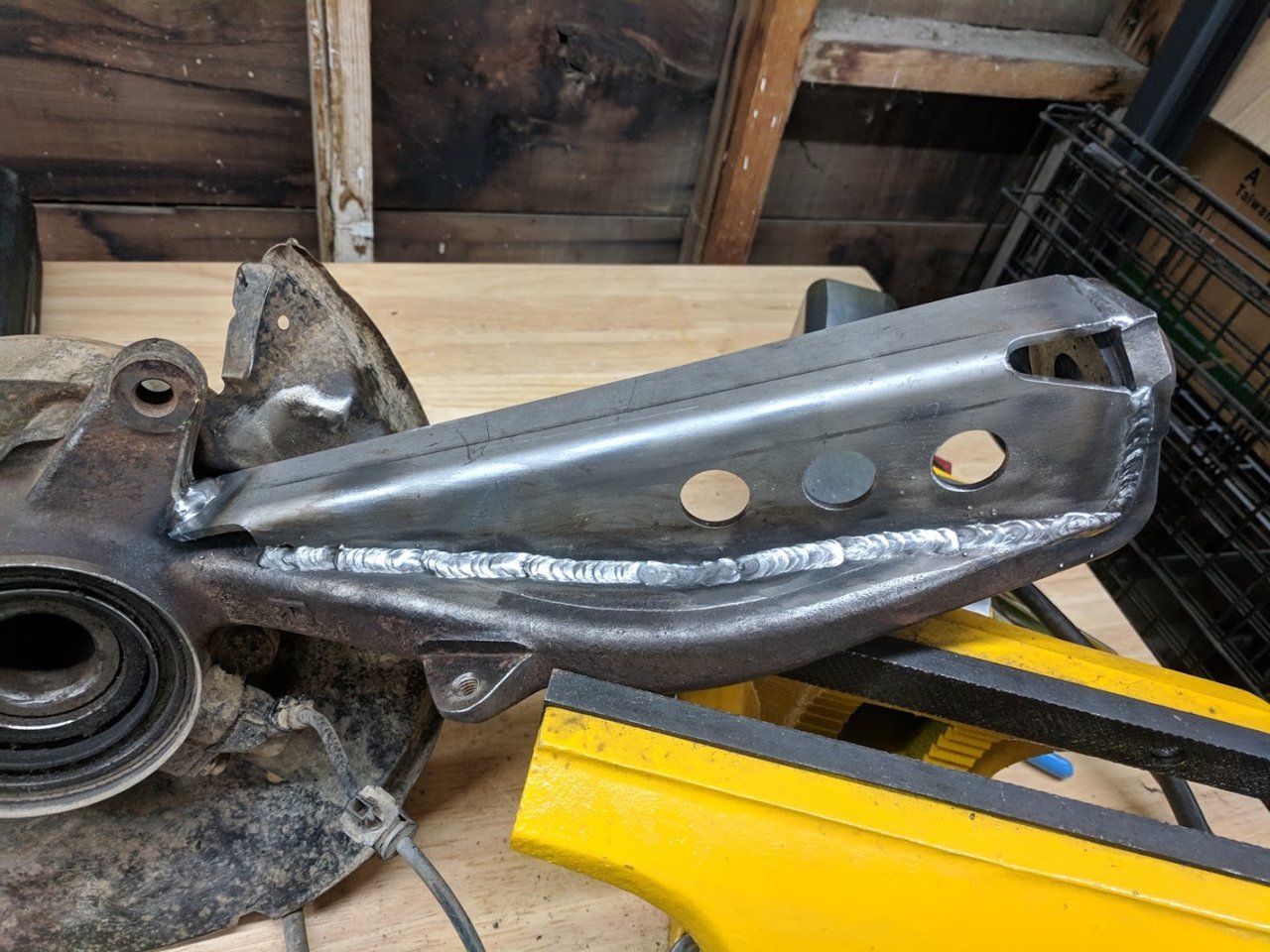

    Dimes look good and all but that looks extremely cold, especially on forged metal. I'd crank the amps up and slow the roll, burn them in right.
  6. Jun 26, 2020 at 9:16 PM
    Speedytech7
    Feb 20, 2014
    #123587
    58,548
    FCQM+VG Cheney, Washington
    It's less Tacoma and more mod
    I see evidence of heat, honestly doesn't look bad at all. More amperage certainly isn't bad advice, but I think given the size of the machine he has this is a pretty solid result. He wire wheeled it all afterward.

    Yeah that's a cleaned up photo.
    Any more heat and the gusset would have blown away. I blew through it here as it is.
    It was pretty damn hot. And the gusset is only 1/8 so gotta sorta find a middle ground. As it always is with welding small stuff to big stuff. The puddle was always on the spindle and drawn to the gusset.

    Thin spots of Forged steel can be deceiving, blue colored areas don't always mean penetration.

    Thin to thick can be troublesome with cast, did you post heat?

    Yeah a bit. Just a few minutes with the torch. Not my first set of spindle gussets. And those are still going strong on a 2nd gen who's spindles are much more touchy about this.

    This is true. As long as his preheat was substantial enough it shouldn't be a big concern. Again you're right that more amperage would've been safer, I think he was up against the limit of his welder though.
    I'm going to do mine at work, we have a part oven and the bigger 3 phase welders can really kick it out with the heat cranked up. Would you post heat or just control the cooling ideally with forged steel? I only deal with T1 at work which is just a finicky alloy.

    I've read your best off heating it up and then if you can control the cooling as much as possible.
    My welder can go hotter. Was only about 55-60% maybe? It's a 200amper...not sure my long ass cable extension and the old house wiring before that would let me do full click hahaha

    You can throw them under the BBQ lid after a good night of debauchery for the post heat with good results I've been told...

    I have heard that too!! Haha
    But I don't have new seals so not about to do that.. haha

    Pre heat/post heat is the key to carbon-cast welds. A long post heat helps the cast from cracking. Sand heat pits hold the product in place plus the heat.
