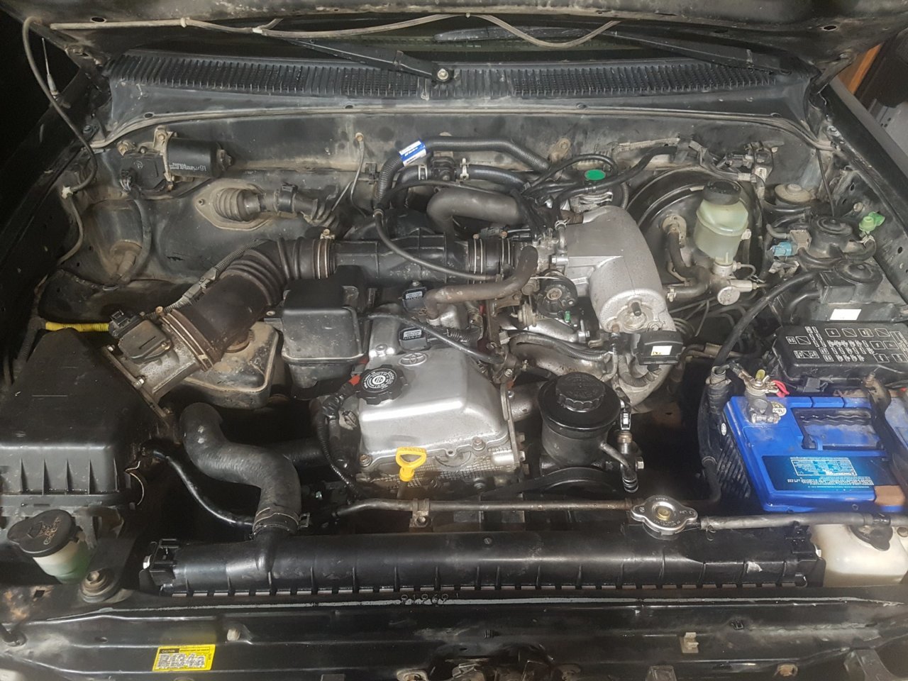

    And thus concludes Phase 1 of my Quarantine 2020 Burnt Valve Adventure and Sanity-for-Andy Project
    • Burnt valve fixed
    • new valve seals
    • new head gasket
    • new injectors
    • new hoses
    • new cooling pump
    • new egr valve/vsv
    • cleaned out power steering resi
    • new power steering cooler
    • new radiator
    • new belts
    • replaced idler pulley bearings
    • new oil pressure switch
    • upgraded horn
    Runs great, still idles a little funny. (Occasionally drops to like 500 rpm after you let off the gas and put the clutch in). Either I've got an air leak, or osmething... I dunno, still looking for it.

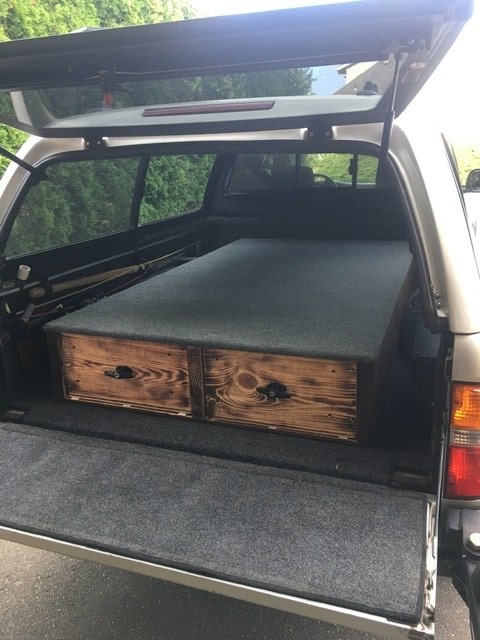

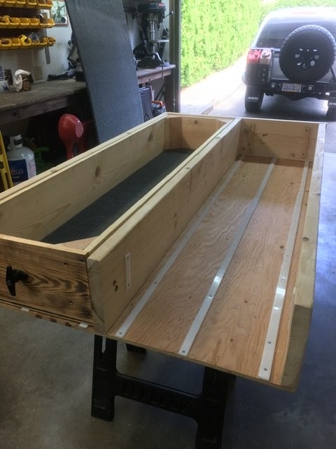

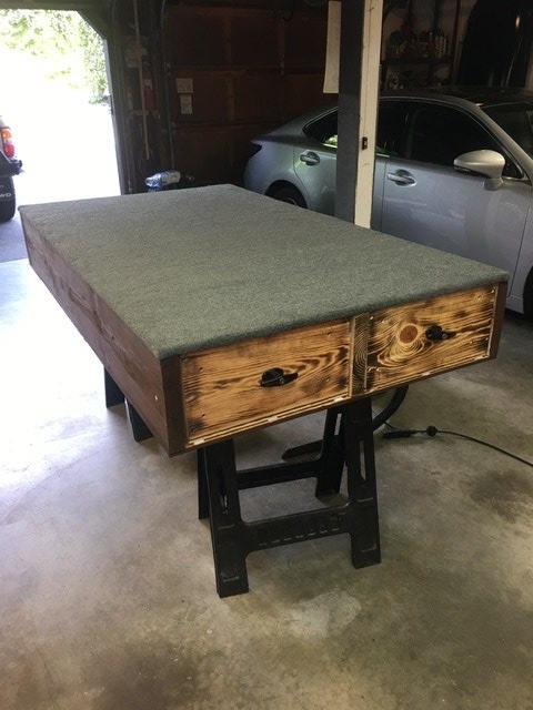

    I made a sleeping platform/drawer storage solution for the past few days. Check out the build for more pictures. I'm very satisfied!

    Are to Delrin strips?

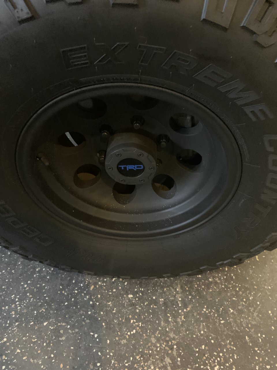

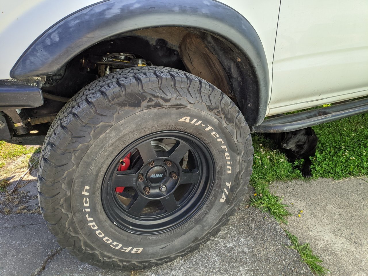

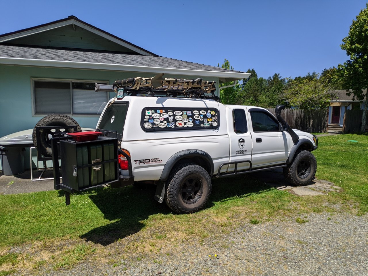

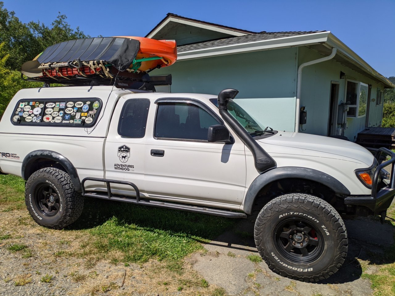

    Was time to rotate the tires and decided to really rotate them off the wheels and flipped to show the white lettering. I've heard both yes and no, pro and con about changing a tire's rotation but these are KO2s, non-directional and I decided what the hell.
    Used to look like this:
    Now they look like this:
    Dog tax paid by my girl hanging out in the shade under the Taco.
    I think it gives the girl a bit of an old-school vibe and at 16 years young she is kinda old-school.
    Looking at those pics I've just decided that my next project will be taking off the fender plastic and painting it. Done the heat gun thing twice and it worked but seemed to revert back to faded quicker each time. Happy Tuesday BTW.

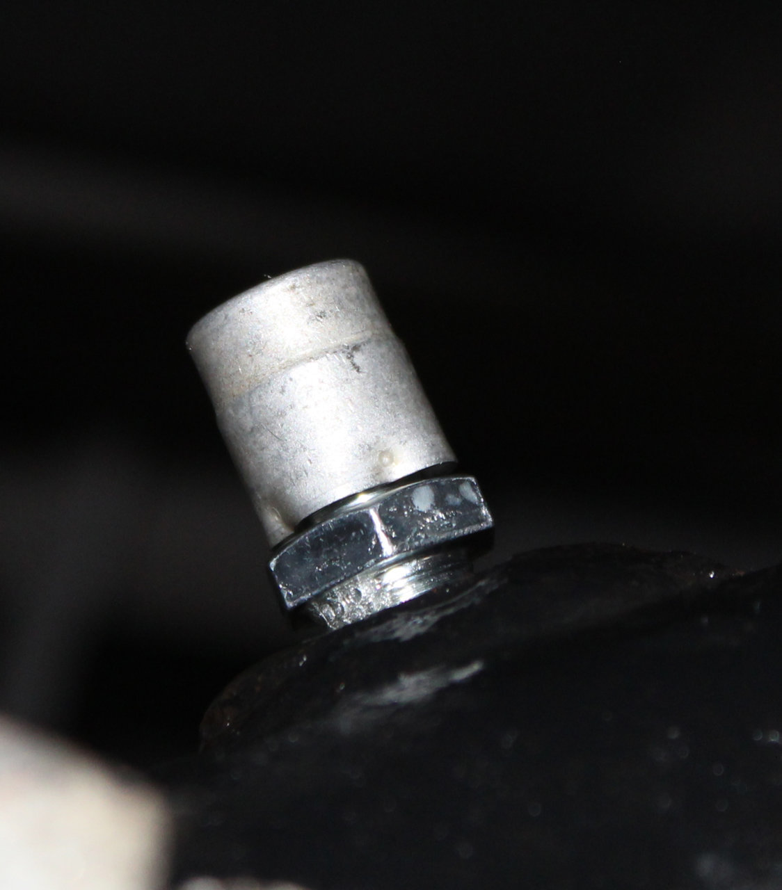

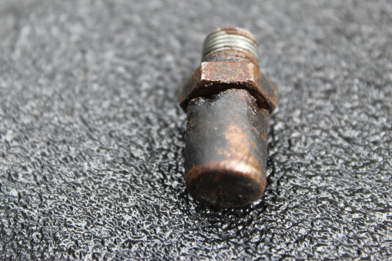

    this was easier than expected to replace after ~278 months (as far as i know its original equipment and not ever replaced during the old 15k, 30k, 60k, 90k maintenance schedule)
    used a ratchet with longish 9/16s deep and contorted my elbow above side of spare tire on ground non-lifted level concrete and it came out like smooth butter, ...was quite worried it was gonna be seized and stuck, but no problemo!
    this old one had a hard time jiggling and the top part would not twist as easily as the new part installed did, probably getting clogged up
    the new one
    finger tight then a couple ratchet turn to snug it up

    Jay, you know there is one for the front diff also. They are already on a piece of tubing and are up closer to the engine. I can look a little later and take a pic if you need.
