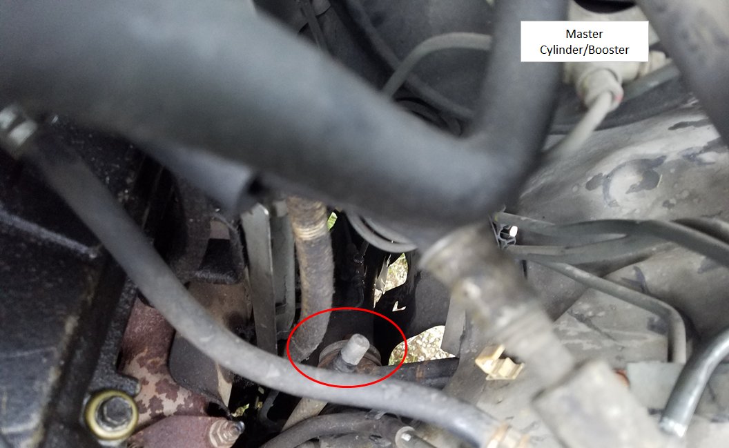

    Jay, you know there is one for the front diff also. They are already on a piece of tubing and are up closer to the engine. I can look a little later and take a pic if you need.

    Aug 13, 2015

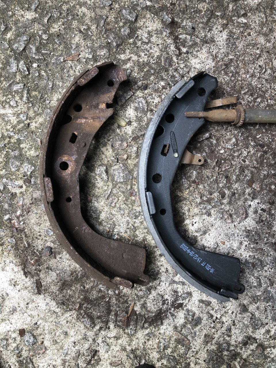

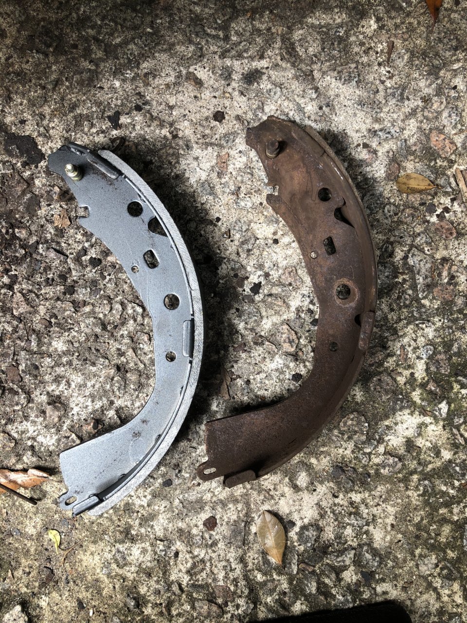

    Replaced rear shoes and cylinders (due to shearing a bleed valve, very rusty)
    Shoes were a bit thin...

    What's the best way to check the diff breather's functionality? Just push on it and see if it moves up and down easily?

    Just for you man I went out in the rain and got this picture!

    how are you supposed to know if that is clogged up and not working properly?

    Same as the other one. Feel it and see if the cap moves freely. You can grab it in one hand and still feel it.
