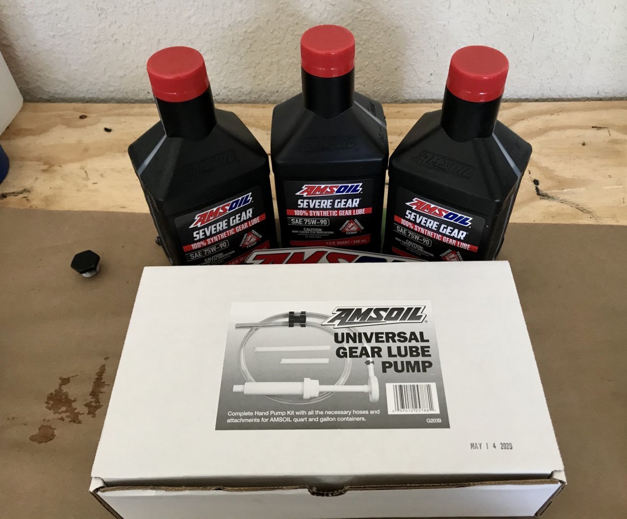

    Well you bought amsoil so should have just bought the stuff in the bag not the bottle. Easy to squeeze in that way.

    I've been looking for the Amsoil in pouches. Great concept.
