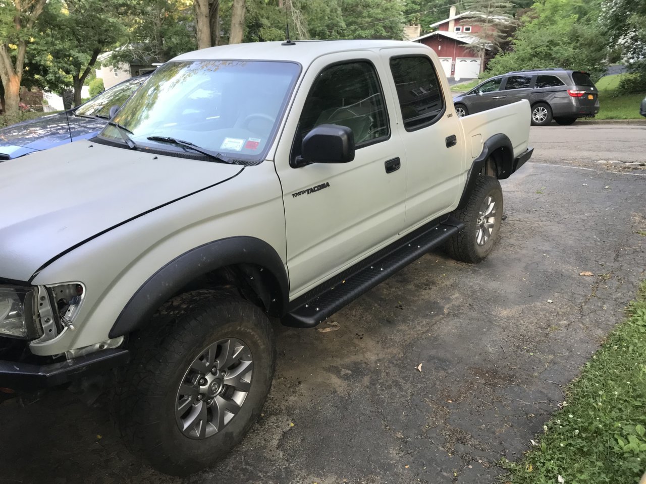

    Much more progress today, at least to the untrained eye. Driver fender and bed reinstalled, along with the running boards. Hold up on passenger fender while I await a bracket that had to be replaced. (wasn't obvious as I was disassembling) All in all, I am quite pleased with how the Raptor turned out. Time will tell if it was the best decision. (hood isn't closed, so ignore the gap!)

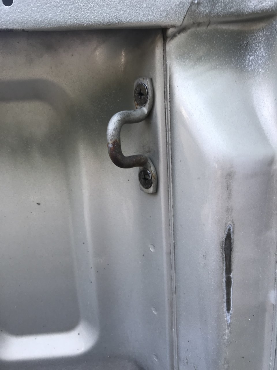

    Also newsworthy, reinstalled the rope hooks. I'm living on the edge, didn't even knock the rust off, let along paint, powder coat, or plate them.

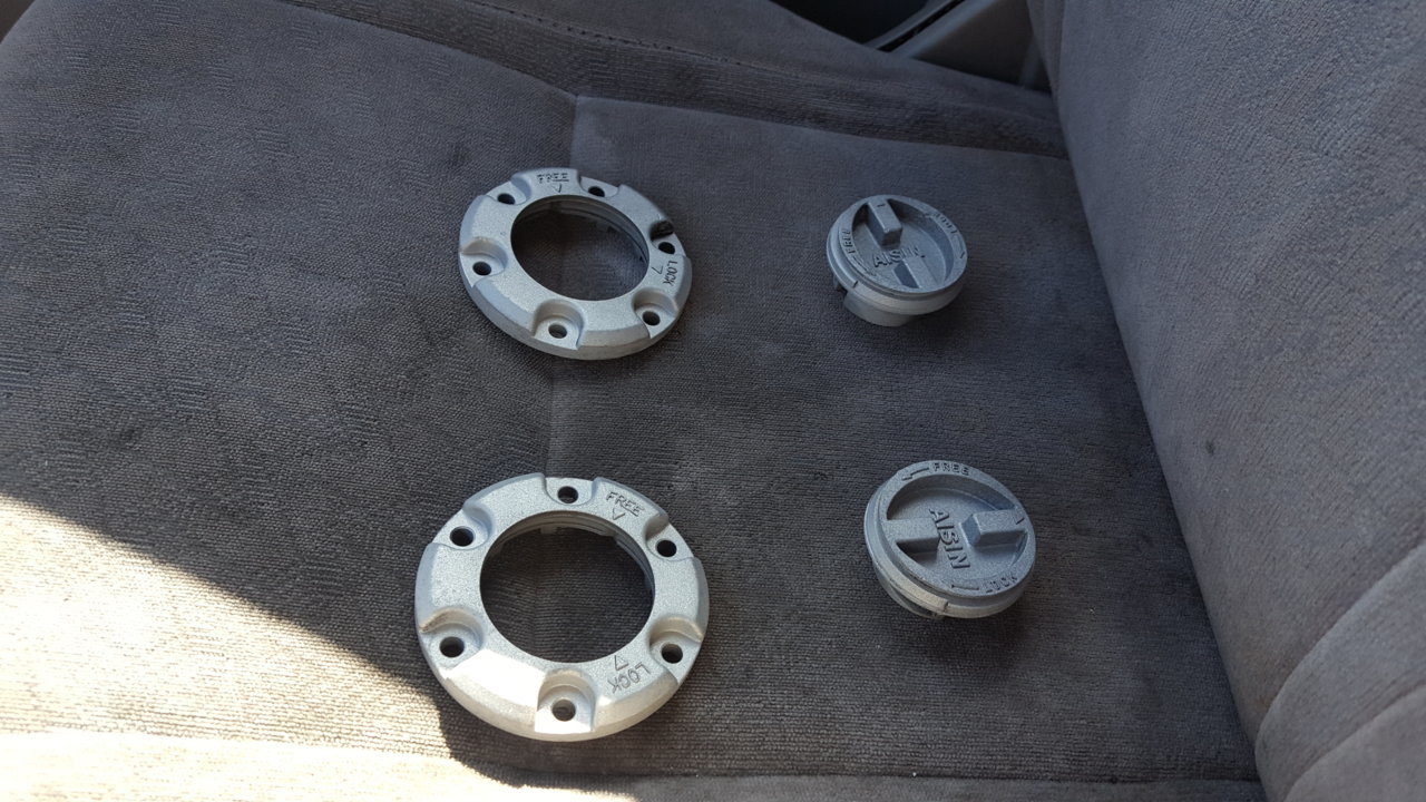

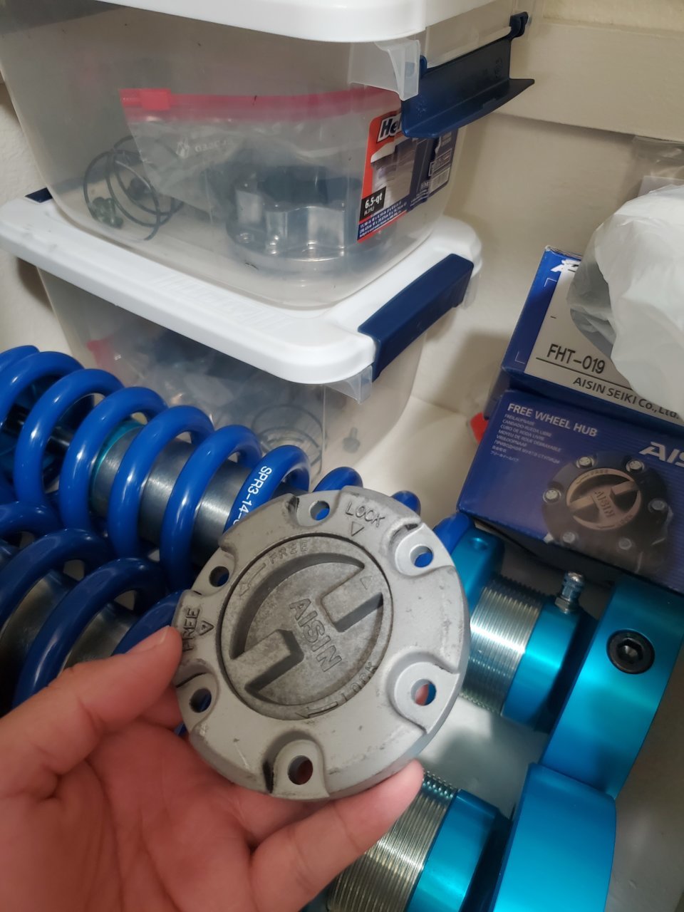

    Building another set of hubs but for @johnnywideopen because two is one and one is none

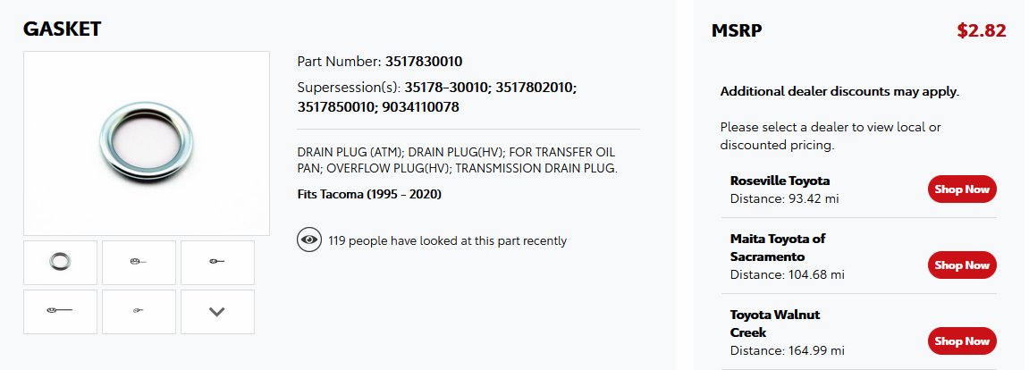

    Is there a crush washer of some sort for the transmission drain bolt? In the search of trying to fix a leak, I realized I have a leak coming from the drain bolt.

    If it’s a manual transmission the drain plug washer part number is 90430-18008. Same part number for the fill plug washer.
    Edit: that’s the part number for my ‘03 manual transmission, an R150F. Not sure if that’s the same in your ‘99.

    Mines an auto, should have clarified...my bad.

    Mines a DC auto and I reused mine and have no leaks

    Yes,

    Are those OEM red hub dials or did you paint them yourself? I prepped and painted mine a while ago and could not get the paint to stick. I even used special aluminum primer. Every time I touched them the paint would flake off. I finally just media blasted them back to bare metal.

    I’m pretty sure I don’t have one, likely why it’s leaking.
    Thank you!

    Whenever I've painted them, I always had them blasted first.
    Here's one set
    Here's another set from last year
    Forget the exact paint but I use a fast drying enamel spray; even though it's ready for another coat within 15 minutes, I wait an entire day
