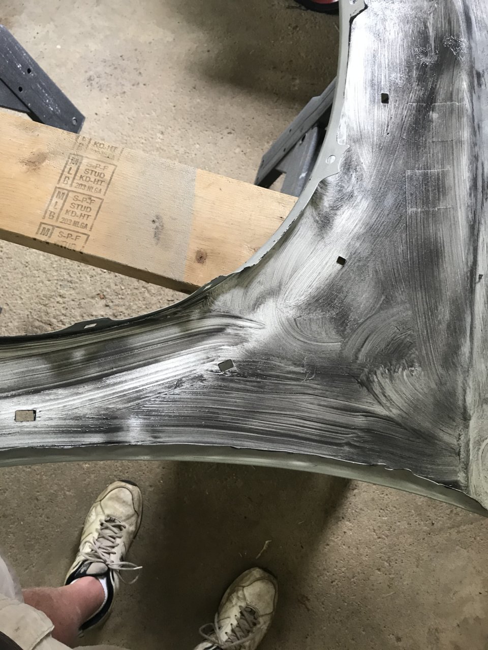

    Here is an image of my "poor man's rustproofing", nothing more than a $5 can of wheel bearing grease, liberally brushed on to the interior surface of, in this case, the front fender. I did all of the underneath of the bed, and up into the cavities. I will also do this under the bed liner.
    After pulling my bedliner from the old bed, I am thoroughly convinced this kept the rust totally at bay under the liner (for fifteen years).

    Oh god there are old men who come into autozone with grease slathered on their terminals and i have to replace them
    I get that it works but for the love of god why

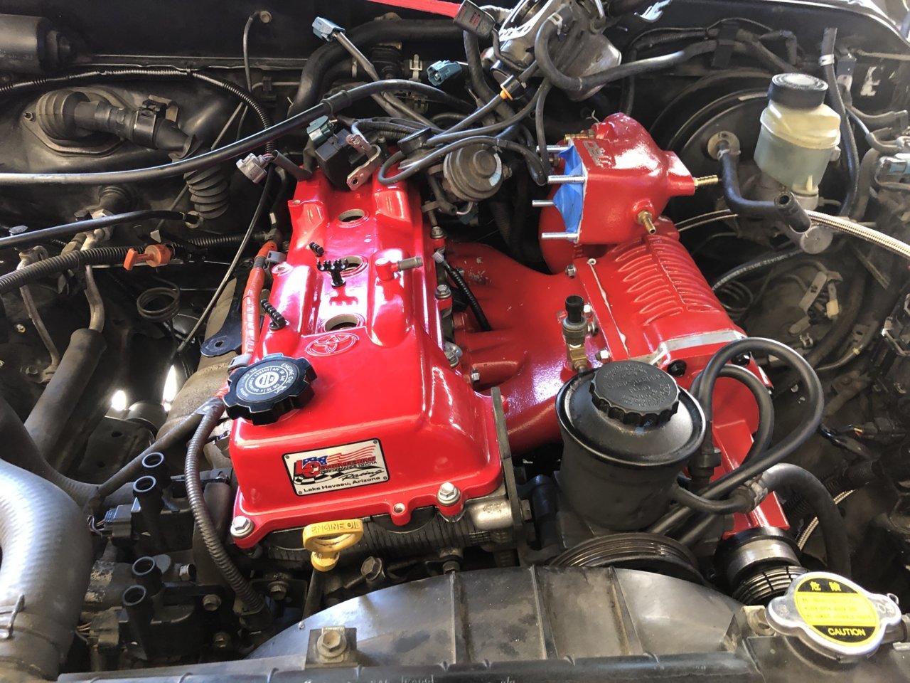

    So I put the supercharger back together, and replaced my 01-04 pink injectors with my stock 1998 brown injectors (lower CC than the pink ones)
    This has seemed to solve my misfire, I believe the pink injectors were causing it. However, it appears I'm running lean at idle. My fuel trims read 11 LTF and 0 STF in Open Loop when idling. But when at full throttle, my fuel trims read 4 LTF and 0 STF so it appears to be good in normal driving conditions.
    LTF and STF read 0 in Closed Loop. Think it might be a vacuum leak, or something else?
    Picture for posterity:

    'Cause it works!!! It's a rust belt thing!!!
