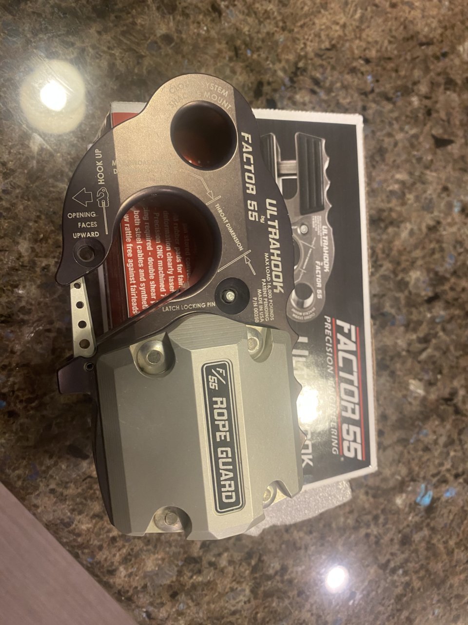

    Just got home from 4 days of camping in Eastern sierras, and camp home to a little a little present! AF9D376E-68E4-432A-80AA-82C87A90F6E3.jpg
