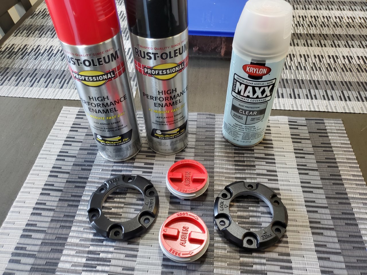

    @DJB1
    Never came back to reply about the paint I use but here it is-

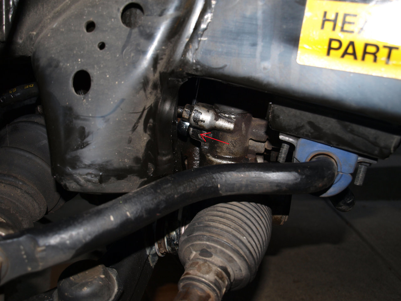

    @CrustyTaco there’s a bracket holding the power steering lines up on the inside of the frame, unbolt that for a few extra inches to work with

    Good stuff. I’ve painted hundreds of horns using that Rustoleum Enamel.

    It was a major PITA getting that off, I'd just completely remove the rack to get it off, there is a bolt holding the lines down that once removed gives you more room. Go ahead and watch Timmy's video on removing steering racks as it'll help. I also had to buy a 17mm flex head line wrench as I still couldn't get any leverage on the nut

    Thanks for the advice. I have removed all of the bolts that hold the lines down, and I have the return line completely removed.
    As it would happen, I watched Timmy's steering rack video last night, so I'm feeling a little less intimidated by that job now. I'm hoping I can keep the tie rod connected on the passenger side and just loosen things up on the driver's side.

    You may be in a tougher spot since I was replacing the rack, but it may just be easier to bite the bullet and remove the rack and throw new bushings in since you came that far :notsure:

    I got new steering rack bushings when my frame was replaced last year, so I shouldn't need to replace those. But based on Timmy's video, it doesn't seem like the steering rack is going to have any wiggle room until all of the mounting hardware is removed. So I'm expecting I will have to pull the rack. Thanks again.

    With new OEM or poly's? FWIW I bought a brand new Toyota rack with brand new OEM bushings and needed to replace the bushings at 5k. Regretted not putting the bushings in from the start.
