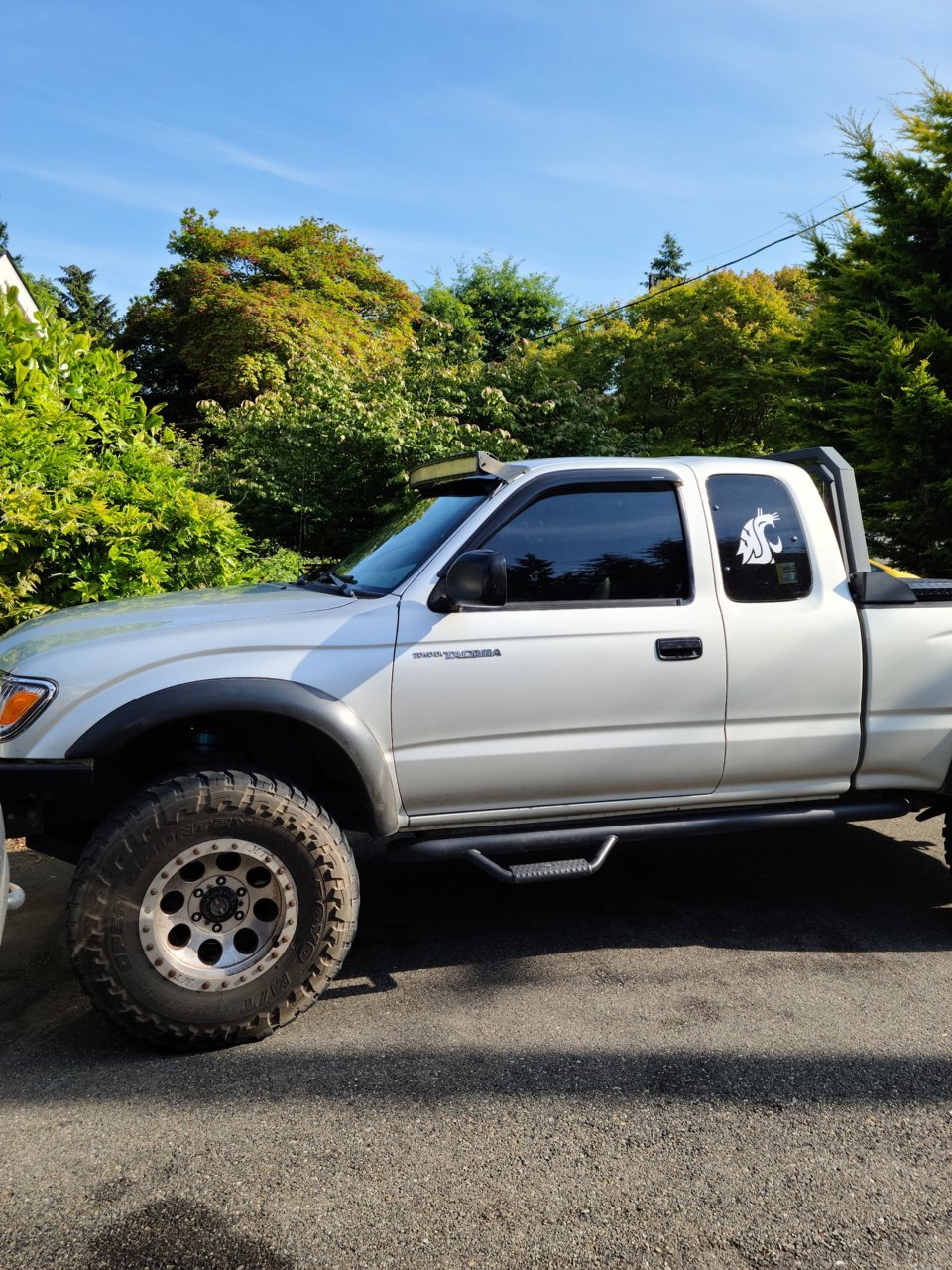

    Got my front windows tinted with 25%. It made a much bigger difference than I was expecting so now I might go back and get my windshield done with 50%.20200708_175820.jpg

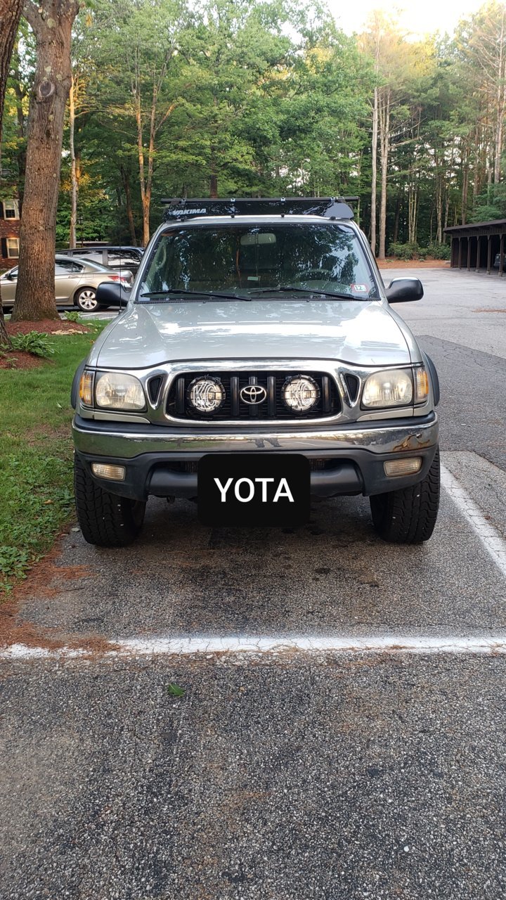

    265/75/16, Yak Q towers
    Installed 6" KC HIDs
    Installed Yakima Bars
    Replaced broken tailgate handle. Had to drill out the old bolts and replace with new.
    Shout out to @sinks88 for the idea
    And shout out to @PoweredBySoy for the lights
