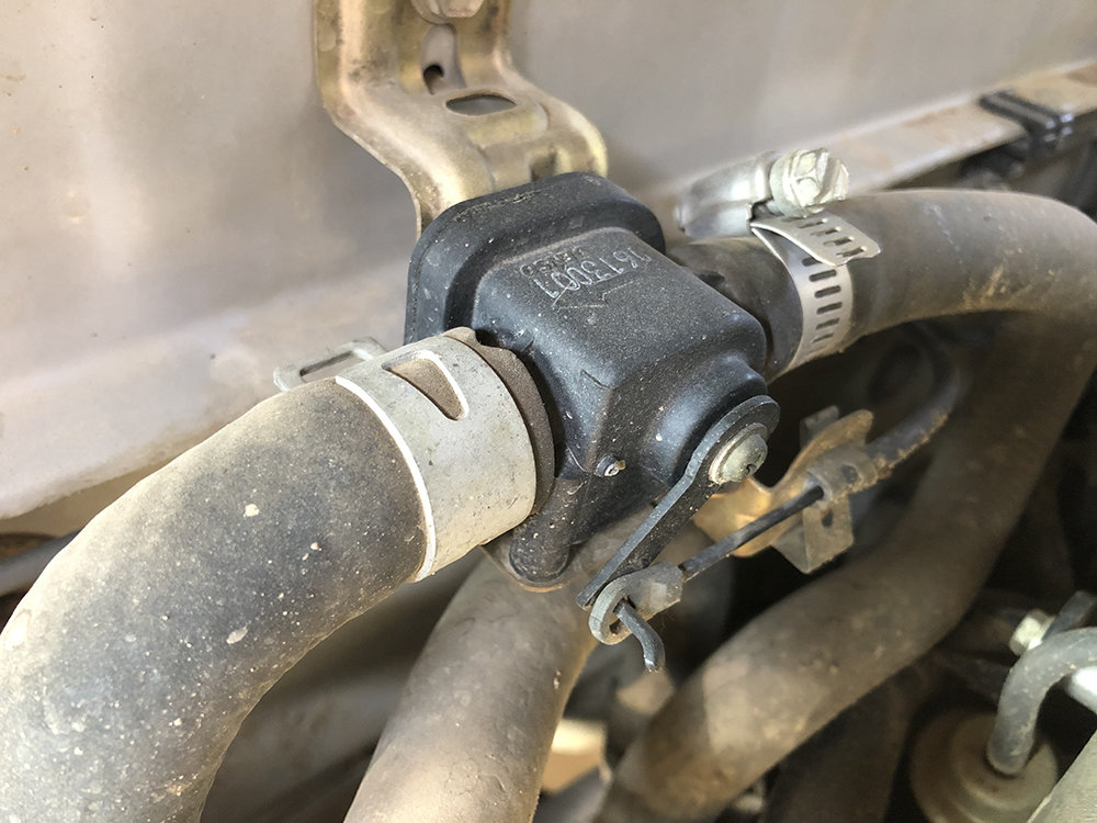

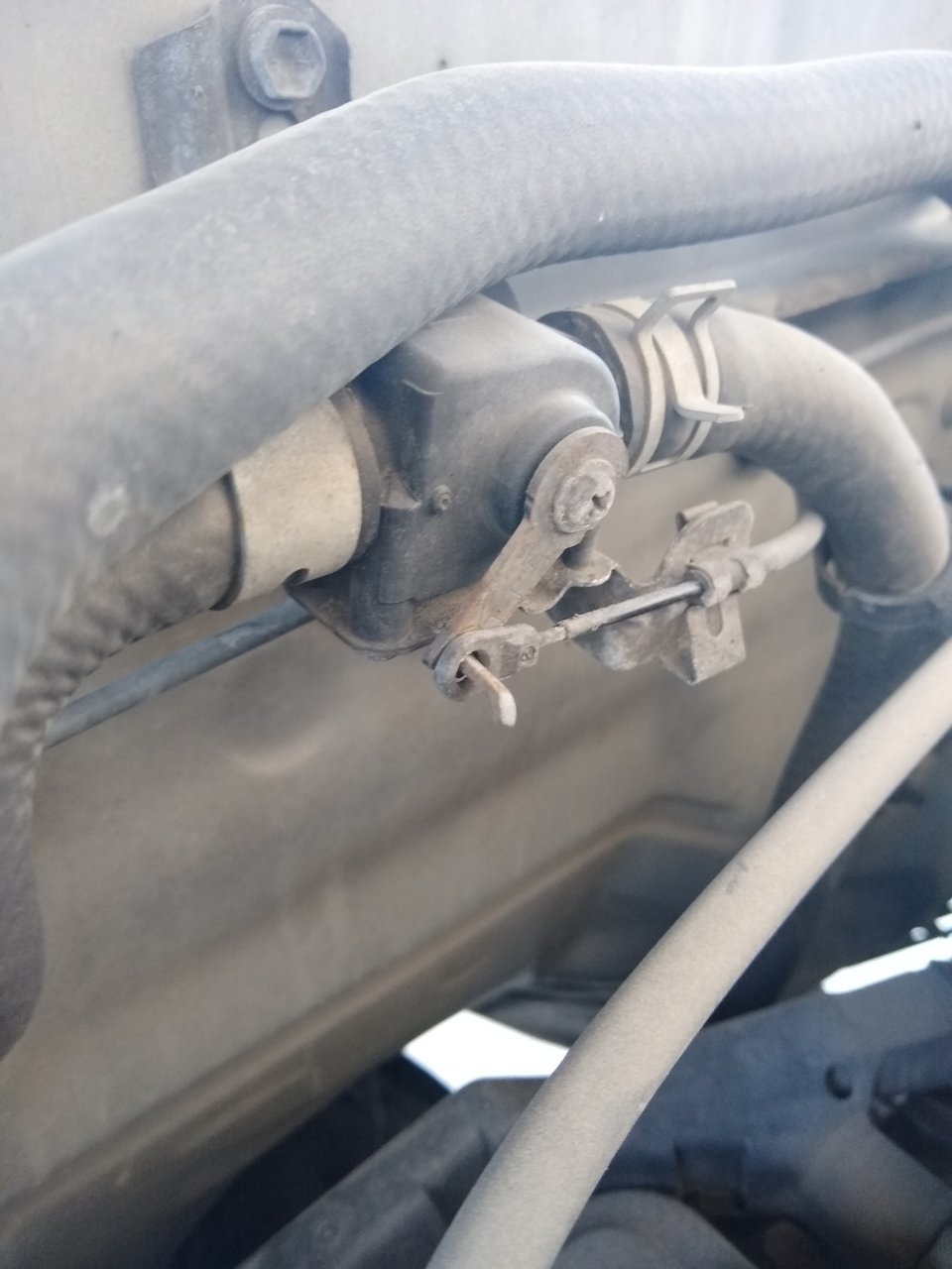

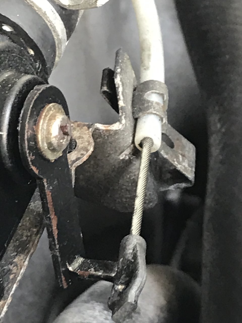

    Quick question/request!! I noticed this cable end was disconnected from the valve that controls the flow of water to the heater. It doesn't seem that it would be designed to just slip onto the bare metal arm of the valve, and it didn't show wear like it had been on there. I am assuming that there was probably a plastic piece, that has broken and fallen off. Both the cable and the valve move without issue. Can someone give me an image, that I may go forth to the Pick-a-Part? Since Tacomas are a rarity, I imagine I'll need to find on some other Toyota model. TYIA

    No plastic parts or anything on mine. The end of the tab has a bend to help hold it on, but that's it.

    I was pretty sure the cable end just slides over that tab and just stays connected on its own.
    I guess I could see the valve seizing up and then the cable not being able to move it and then sliding off??? I dunno, could just be a fluke or someone disconnected it to mess something and forgot it

    Ewwwww, a non OEM, worm drive clamp on one of heater hose ends.... I'm playing, man:rofl::D

    Many thanks!! I guess my bracket is just bent a bit, as it was putting a slight bend in the cable. No scavenger hunt for me!!

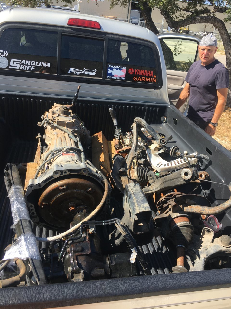

    I Bought the main Bulk of 4x4 parts to convert my 2004 Pre-runner!
    Moving to the mountains in December so will finally have a need for a 4x4

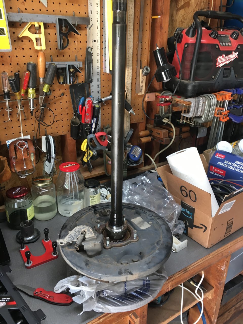

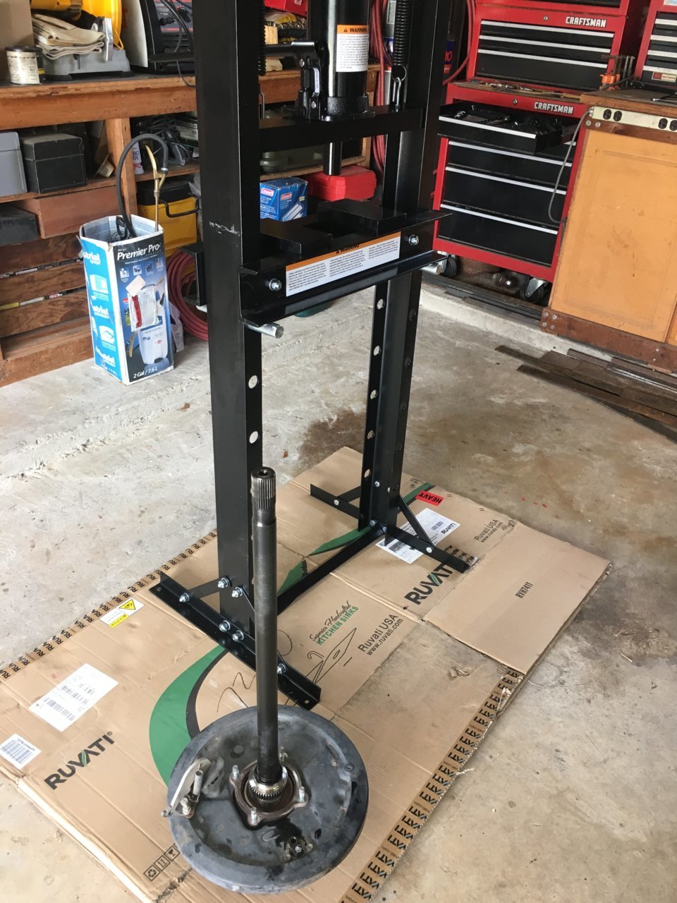

    Also pressed in New rear axle bearings and new axle seals before getting on the road to go pick up the parts. Got 225,000 miles out of my original bearings and seals. Bearings were still super smooth when I took them out! But they had a little more play then I was comfortable with.

    Yea, that was a temporary fix years ago that just sort of became permanent.
