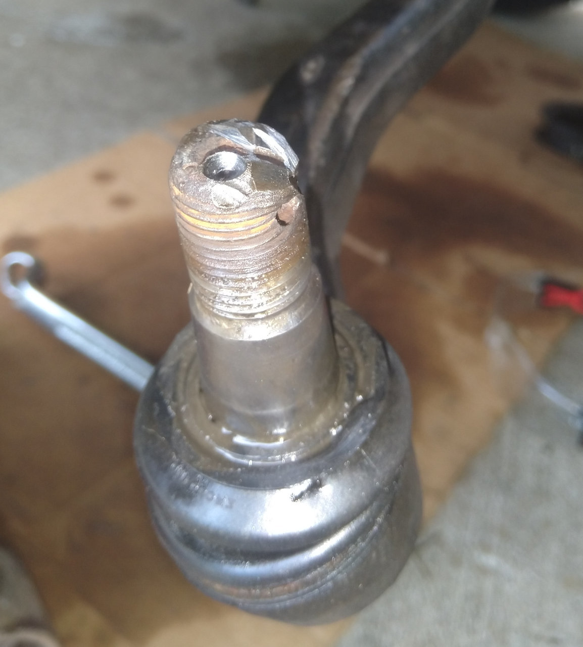

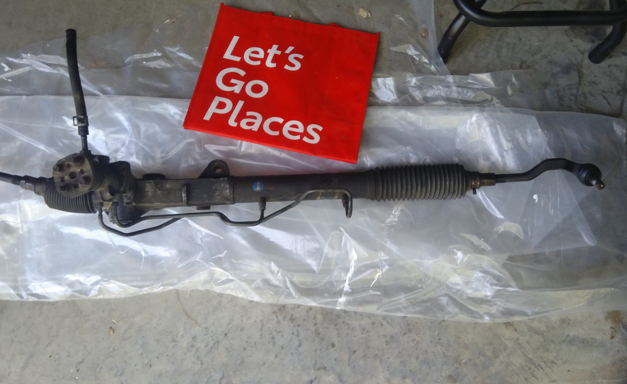

    Made some progress replacing my power steering lines. On Thursday I got a little too rowdy with the Pittman puller and ended up deforming the end of the tie rod bolt, I had to use the angle grinder to shave off enough to disconnect the TRE.

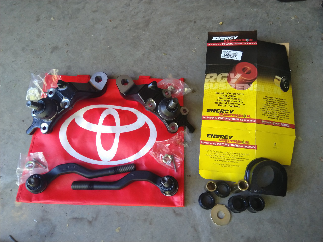

    Today I went to pick up new LBJs and outer TREs from Toyota of Louisville. At 162k, I figured it was time to replace the LBJs. This afternoon I got the steering rack removed completely, trashed the old lines, and have the new lines bolted in place.
    I bought some metric service wrenches at Harbor Freight to remove the outer tie rod ends, but I don't think they're going to be long enough with the amount of rust I'm fighting. What kind of wrenches should I be using for those 27mm and 28mm tie rod nuts?

    Penetrating oil and heat is what you need.

    I've been using both, I feel like I'm going to need a longer wrench. The harbor freight service wrenches are pretty short.

    Have you tried a cheater bar? I'm not sure what wrenches you're using, but with combination wrenches you can hook two together if you don't have a cheater bar.

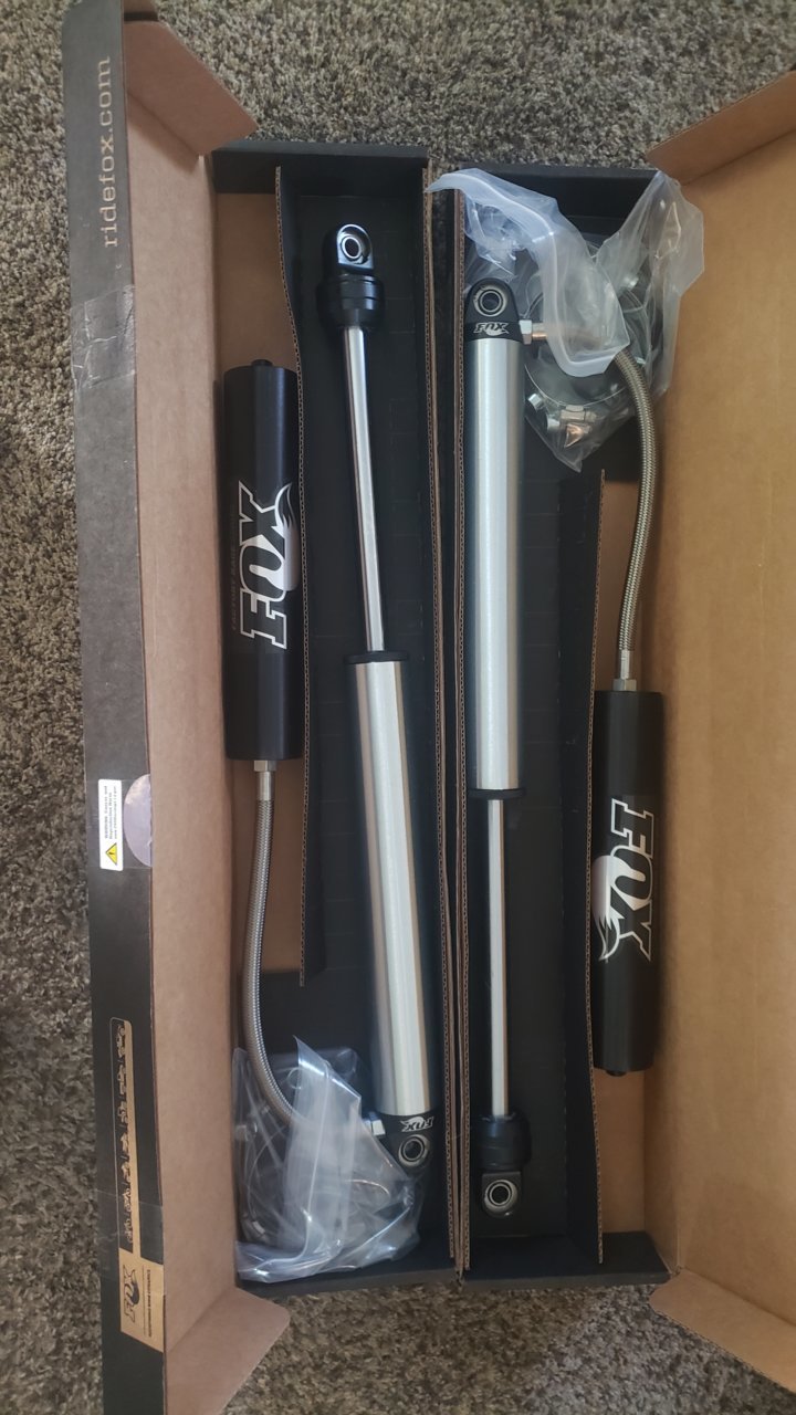

    Finally had a chance to drop by the shop and pick them up... after I finished liftin @Reyes87 truck today.
    New shiney shit for the truck :thumbsup:
    10 inch Fox 2.0 Reservoir with 7/8 shaft.
    The 10 inch Fox 2.5 bodies were too long, so I went with the 2.0s... but was still able to get the 7/8 shaft instead of the 5/8. With the resi, I think the 2.0 should be more than adequate for what they will be doing.
    I mean we all know this is just for a mall crawler after all. :notsure:

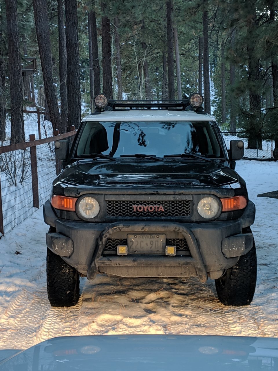

    That's just to hot. I lifted a friend's FJ last November. That was bad. there was already 3inches of snow on the ground.

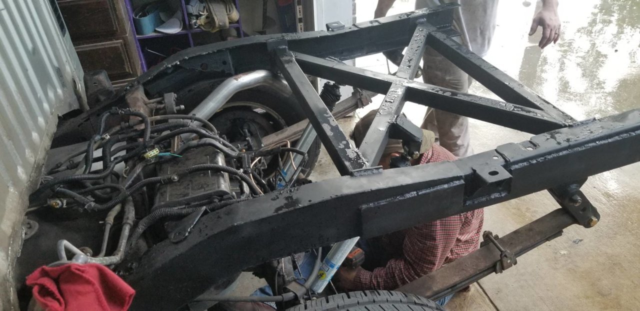

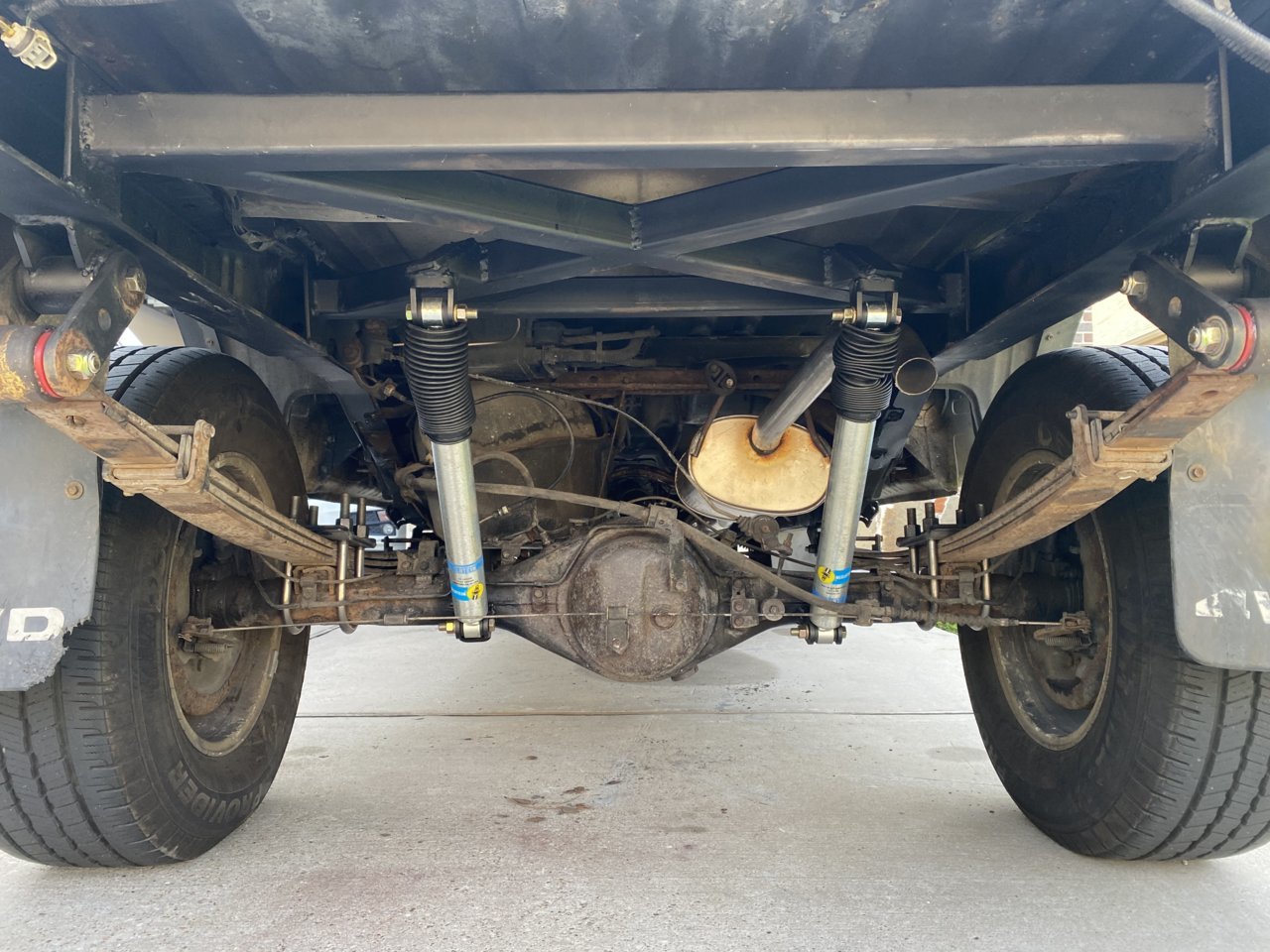

    Yea about that...I bought the taco for dirt cheap bc of the frame. I replaced the rear section of the frame and installed Chevy 63 leaf springs. When I was replacing the brakes today, noticed how much rust it has may sell it. AB44486B-988D-4427-8644-234D9EC11940.jpg342A8CEE-DF0D-4923-82D2-025351079BBA.jpg

    We're complaining of working in the blazing heat and you post a snow photo you bastard haha
    Although doing repairs in the snow sucks in it's own way. Have only had to do that once personally.

    a 3 ft section of inch and a half schedule 40 PVC pipe is my go to cheater bar.
