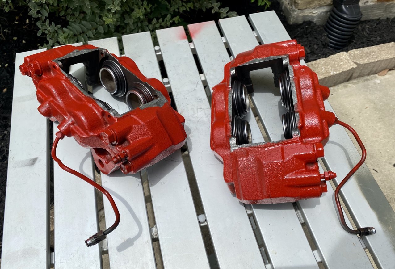

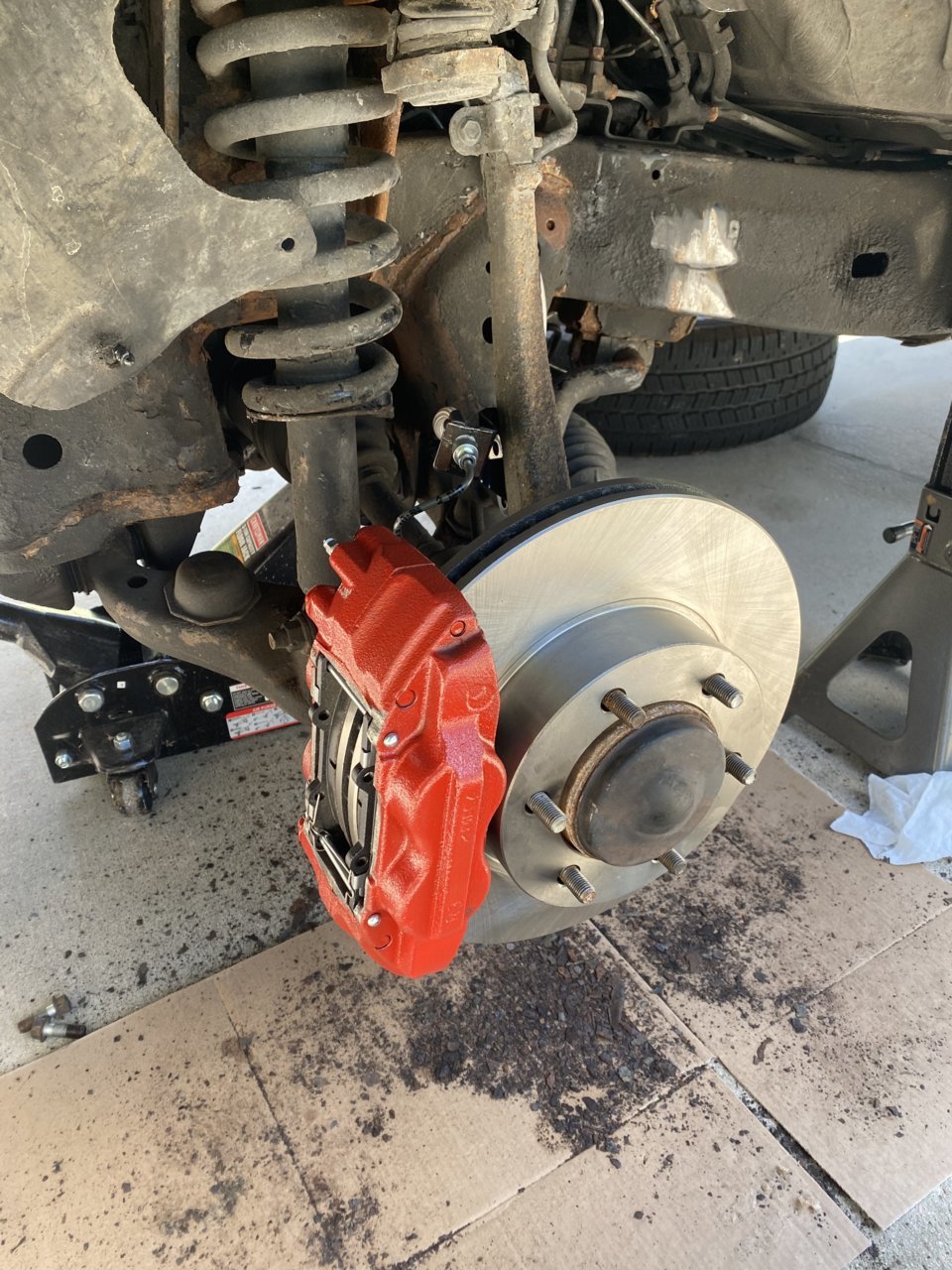

    I can’t wait to do this upgrade. First thing I’m going to do after I finish the 4x4 conversion. Where did you get your brake calipers and rotors from?

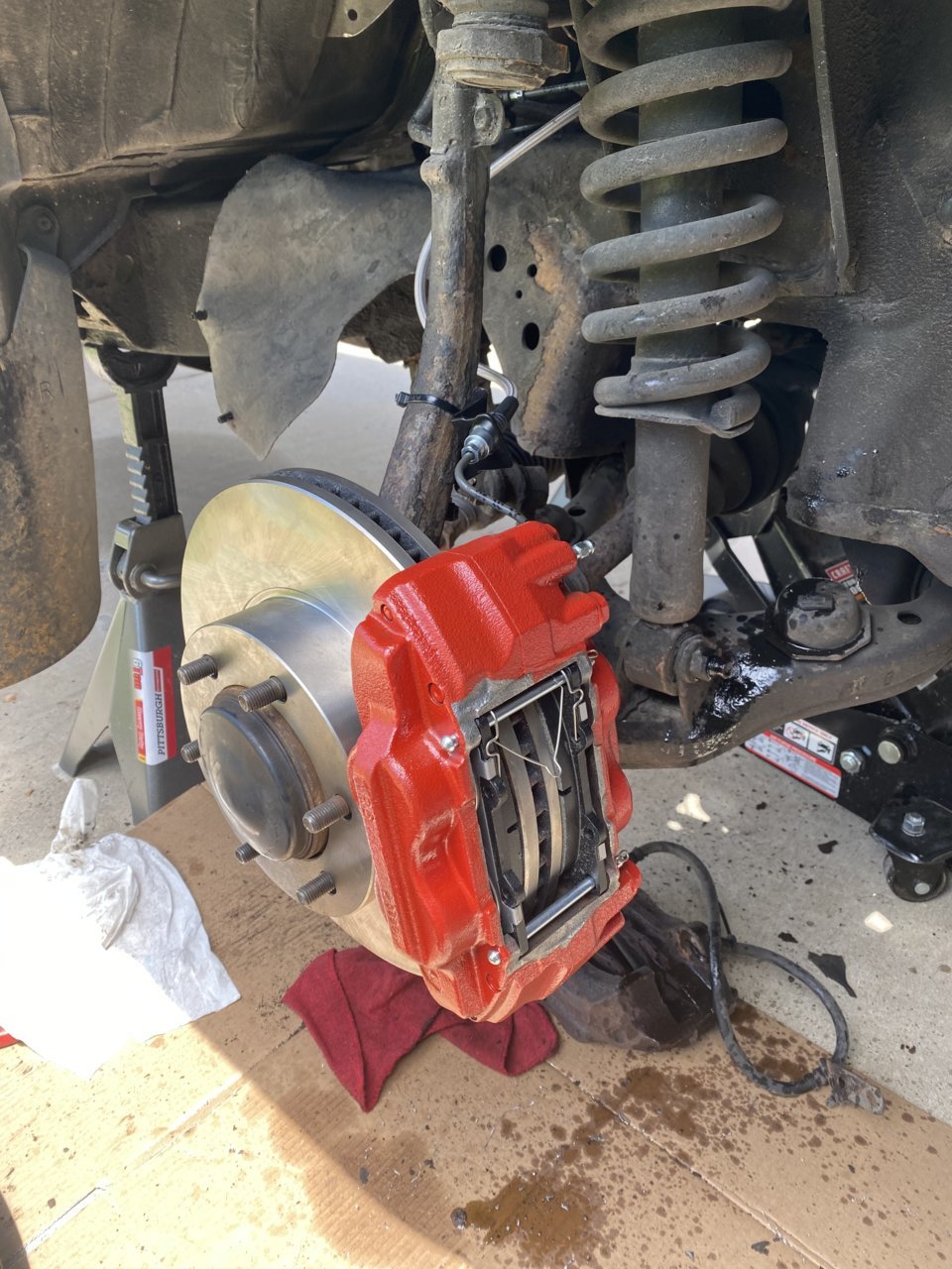

    The calipers are from pick a part (sequoia 05) and rotors from autozone. Wanted to go with OEM pads/rotors but a little too pricey for my blood. I rebuilt the calipers with Toyota parts ($20)26466CE8-95CB-4B28-AF69-993F616902AA.jpg

    Very Nice! I’ll probably keep an eye out for a pair of salvage calipers as well. Definitely a more affordable option

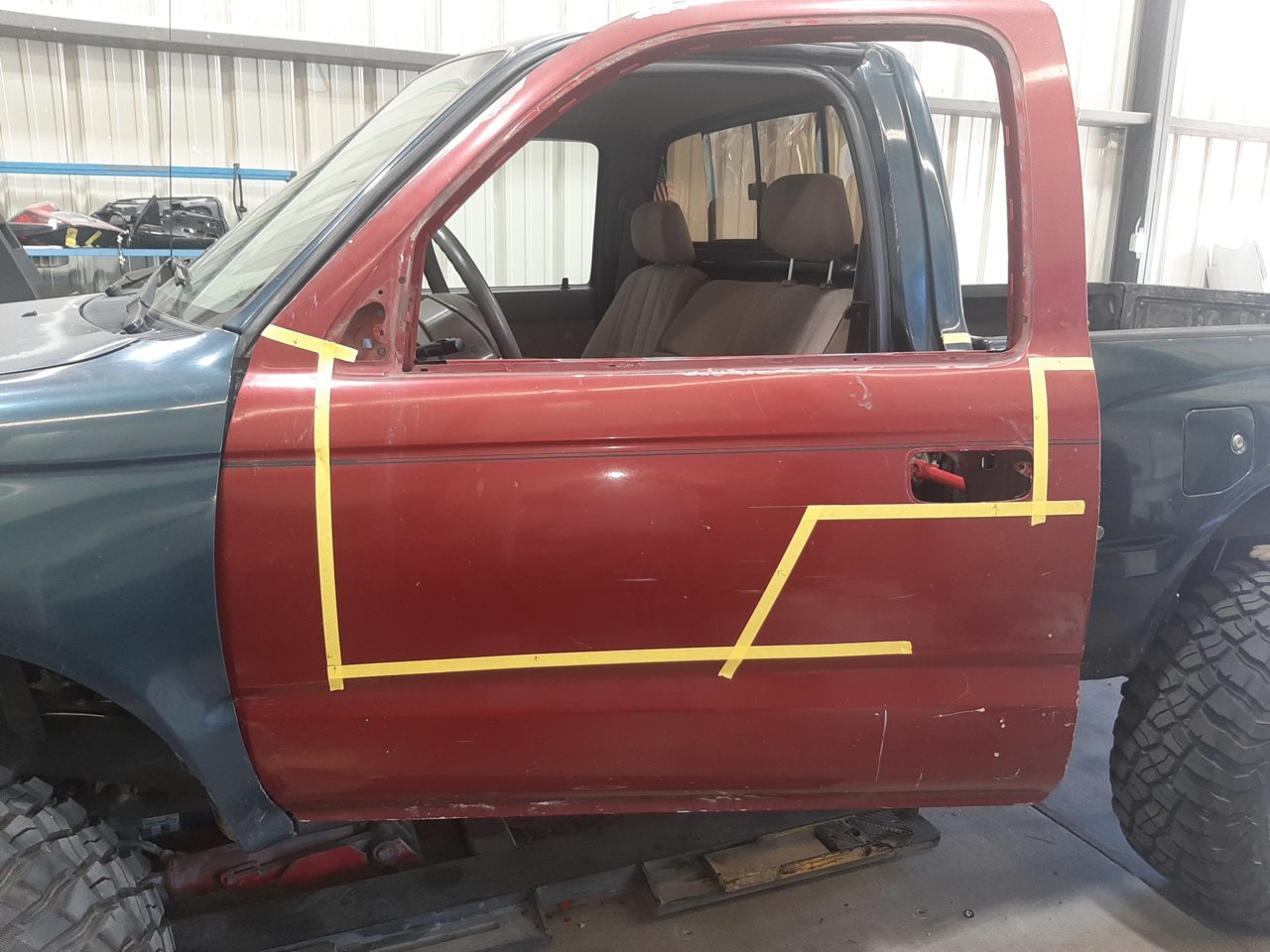

    Working on a little side project, I'm almost done bracing one of the doors. But I ran out of steel, so I get a break until monday. I'm still trying to find a cool handle that will work from inside or out.

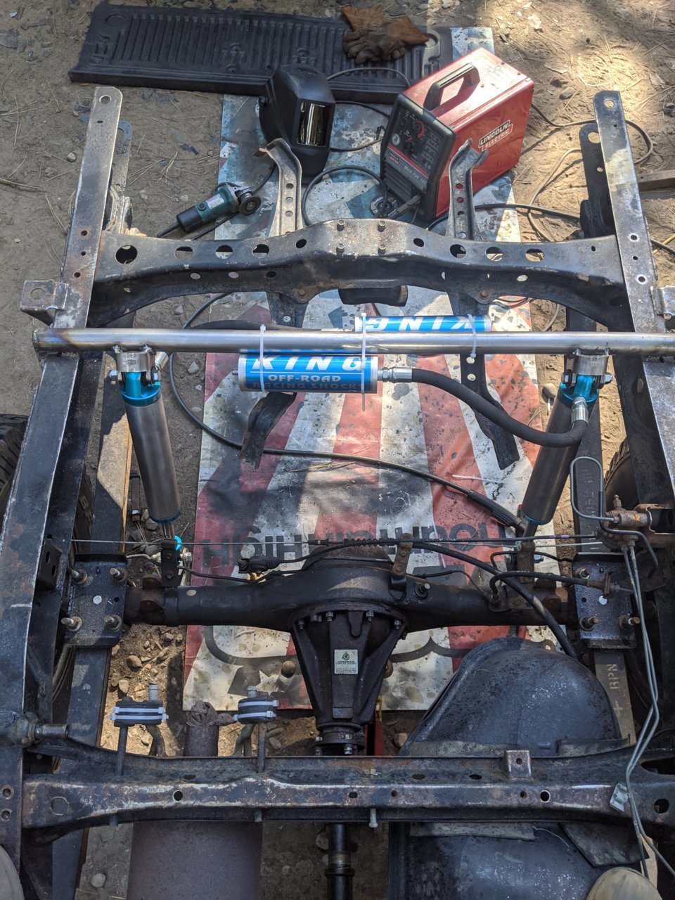

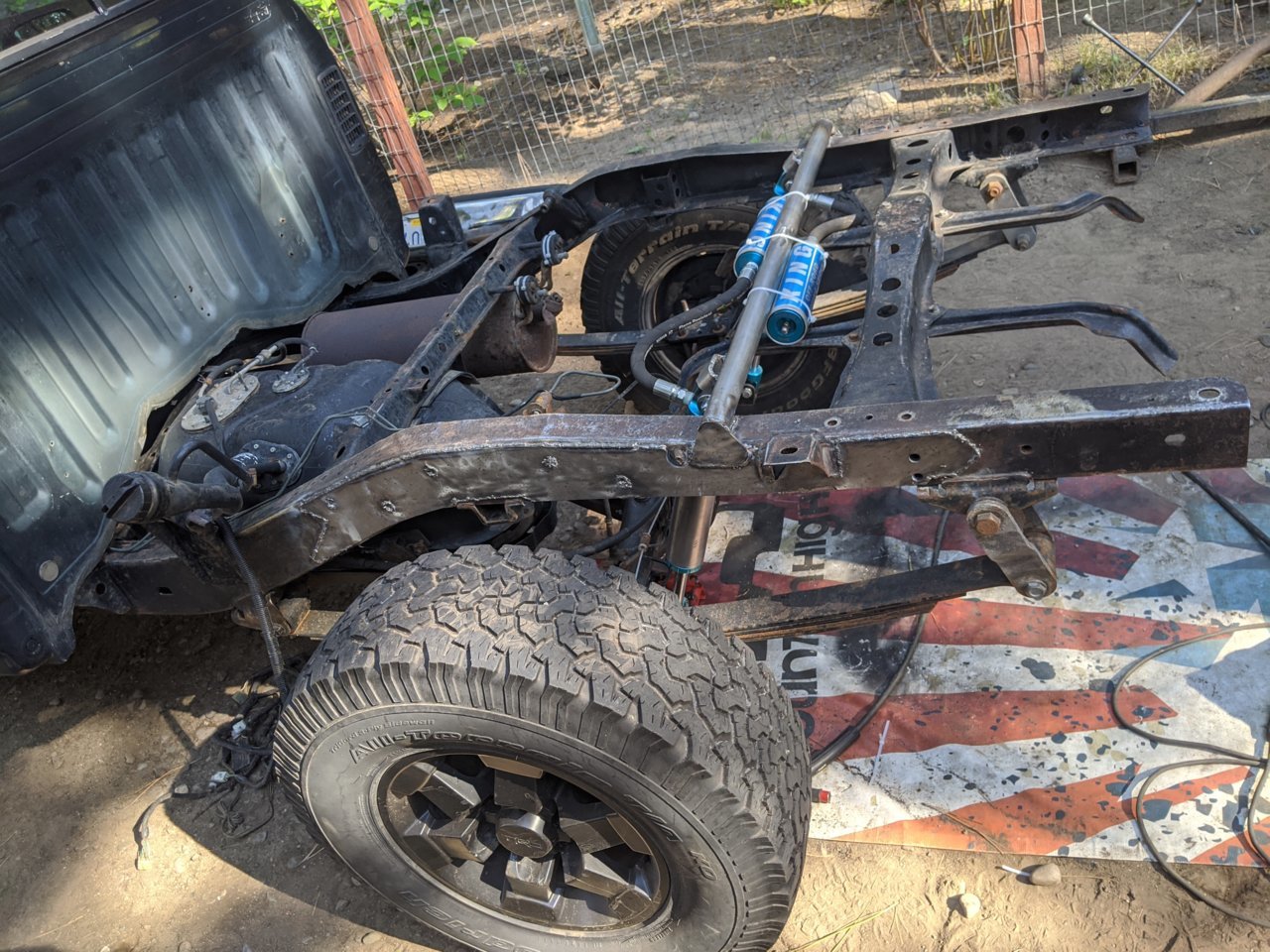

    Question... how are people determining how far behind the axle to mount the upper shock mounts, when doing this relocation?

    I went as far back as I could, then welded the bottom bracket to match

    I'm thinking driver side stock mount dustance is a good place to start. Seems like everywhere I've read has just been a bit of a guess on this.
    I wont have spare tire or spare tire bracket in my way, so that takes that out of the equation (not that I want to go back that far anyway). But the stock angle of the stock driver shock seems to be where I'll go off of.

    It's a good place to start. I think it's about 25° from vertical. Here are some pictures of mine with out the bed.

    I just used a plum bob and set my tube so it hung about 1.5" behind the axle to accommodate the shock mount. Doesn't need to be exact by any means. Most I think just push it as far forward as they can without interfering with the bed. 1" BL helps get it vertical.

    That looks a lot like what I think mine is going to end up looking like. 25° sounds like it is a good spot to not start sacrificing too much dampening. As long as the length of my shock bodies body will allow it.

    Using the size of bar I did and with the brakes for the top that I used, you end up about a 1/4 further back than the stock top mount. Provided you don't have a body lift at least, if you do (be prepared for that to destroy your bed mounting pads without reinforcements) you could get 100% vertical but if you have the top mount e brake cable it'll need some work to have a snowballs chance at clearing anything. I'd be more apt to have the axle side mounts move outward another 1-2" to make up the angle rather than move the top closer.
