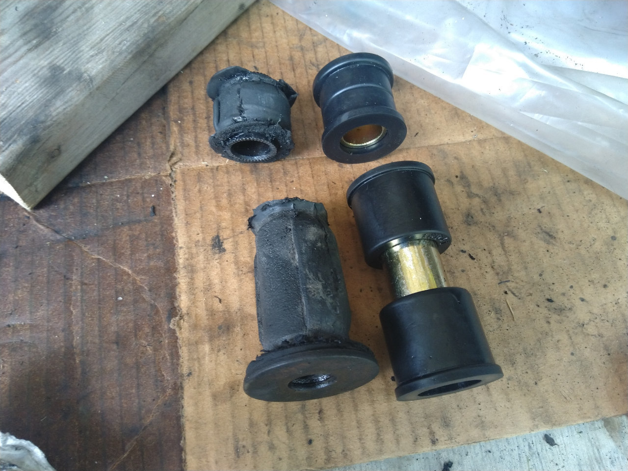

    Day 5 of my power steering line replacement. I got the old steering rack bushings burned out, installed the new ones, put the new outer tie rods on, and got the rack reinstalled. I've still got the rubber hose to reconnect, but I'm getting close. I want to thank everybody who recommended the poly bushings. I told the dealership to replace the steering rack bushings when I got the frame replaced, but apparently they only replaced the big bushing, not the other two with the metal sleeves.

    You’ll love the results. I couldn’t believe how tight my steering was after installing the poly’s

    Aren't tie rod ends fun, I had to use a pipe wrench since I couldn't fit 2 wrenches on the flats. when I did the passenger side my neighbor should up with a adjustable wrench that would fit. so glad I go that job done with new lower ball joints.

    I thought my steering was super tight after the frame swap. Between the new bushings and tie rods I'm interested to see how much of a difference I will notice.

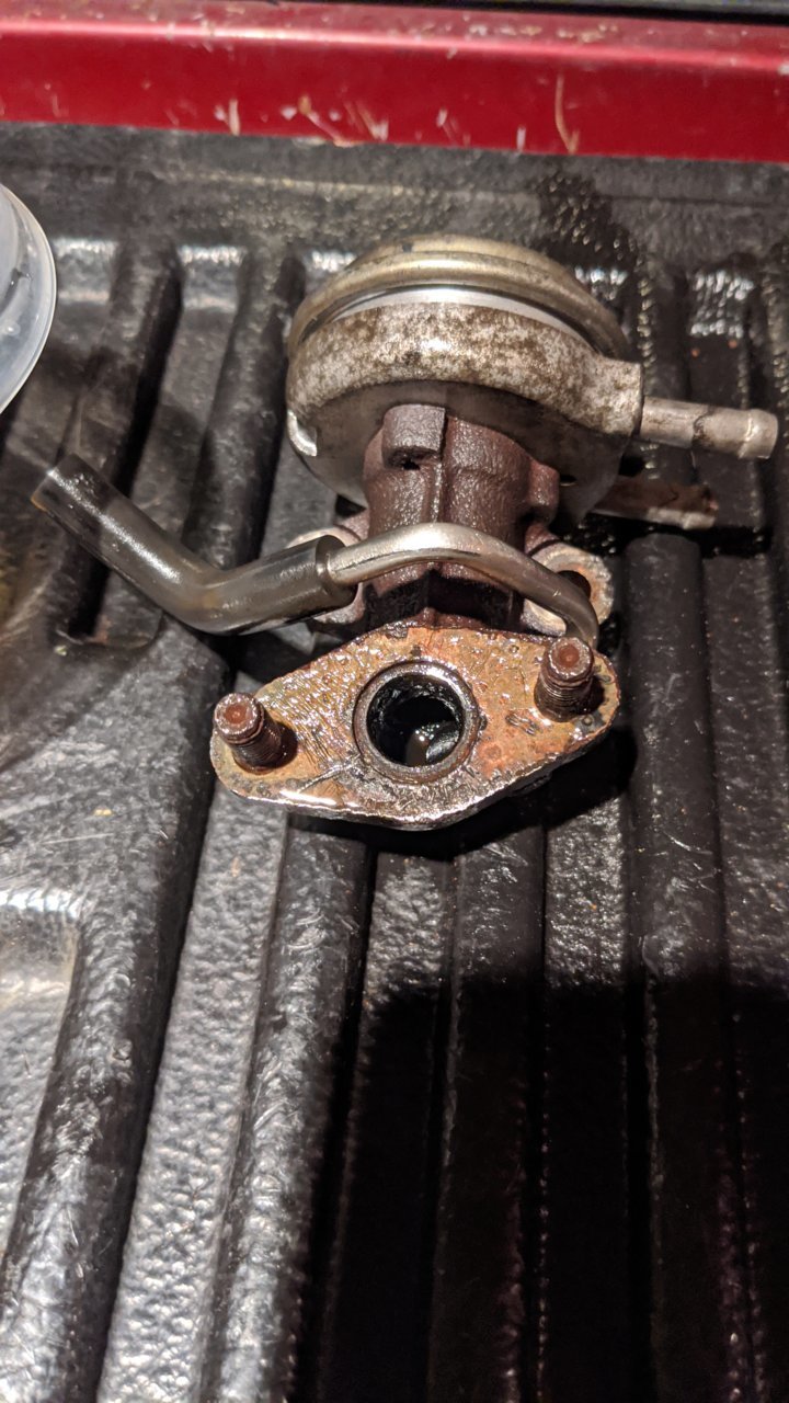

    Replaced my radio head unit that crapped the bed.
    Used a hot water extractor to clean my seats and carpet. Super satisfying to see the grime come out of them.
    Began removing EGR valve and tube to clean and replace gaskets, in order to hopefully eliminate P0401 code that keeps coming back.
