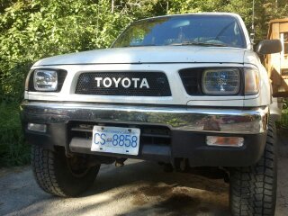

    Installed new headlights

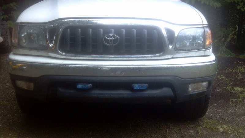

    Installed these hoping they would give extra lights on the side of the road for when we travel at night....lots of deer and moose this time of year....
    Lights are worthless garbage..only spent $25 on them though...

    Are those roundeyes?
  7. Sep 5, 2012 at 12:00 PM
    MapleMoose
    MapleMoose Drunk Canadian
    Feb 15, 2011
    #51211
    8,575
    Ian
    West Kootenays
    1996 Tacoma SR5
    3" Eibach Coils, 3" AP Springs, AP 6" Shackles Toytec Diff drop, BAMF Sliders, Deck plate mod,Volt meter, Highbeam mod, PIAA fogs, 18" Magnaflow, LED dash swap, Color matched Satoshi Grille, Custom Rear Plate Bumper
    Nope. Cheaper:D

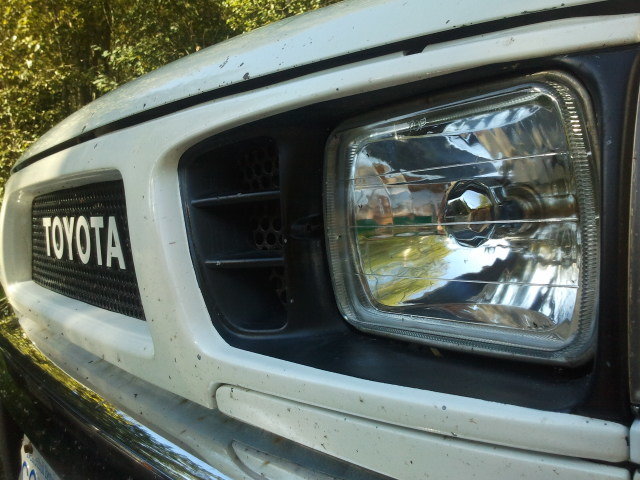

    The main reason i got them was cause they're not a sealed headlight unlike the oem ones. Now i can replace the bulb without pulling my whole grille off.
    They work great at night. Ive always wanted a nice white light and these came with a blue H4 bulb that produces a nice white light. They also spread very nicely on the road. Very happy for the price! Id like to HID retrofit some day too.

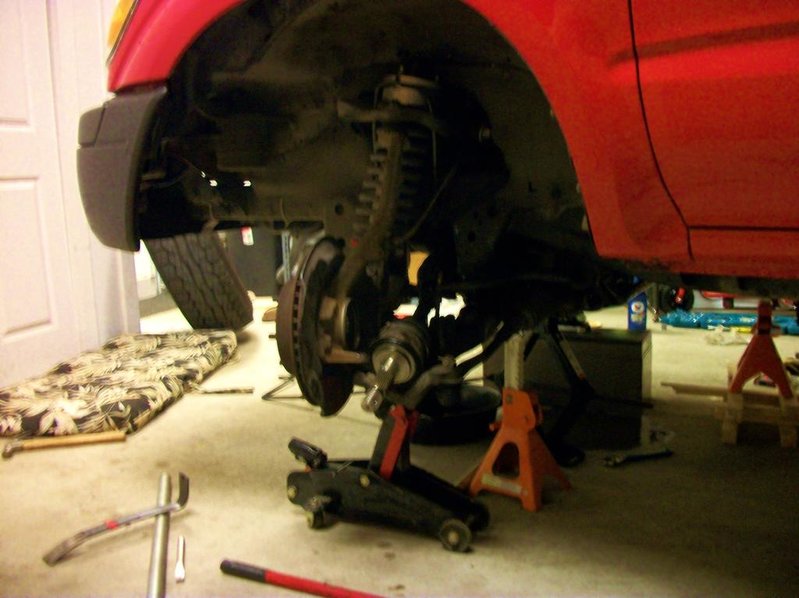

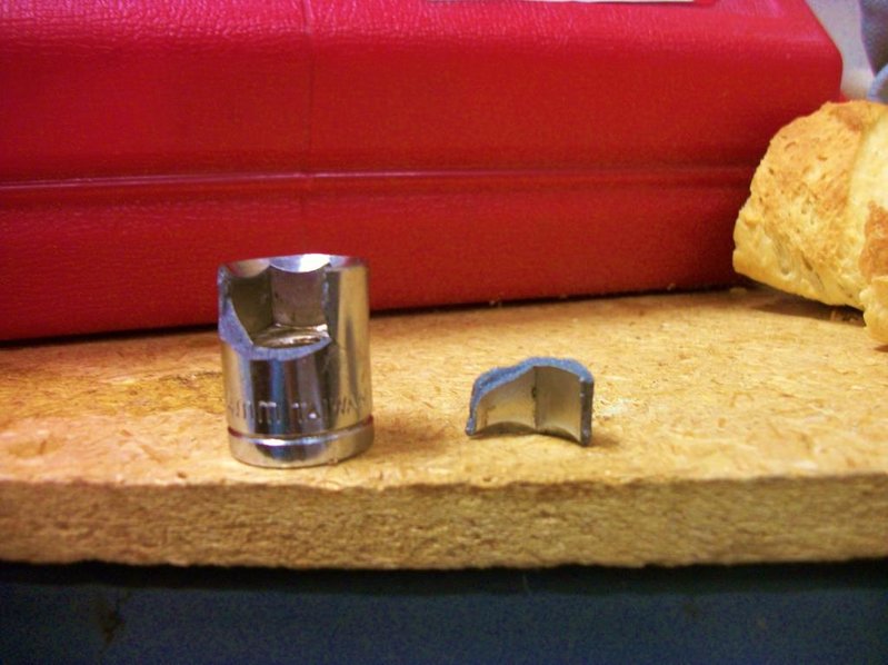

    Got it all taken apart, after breaking a few sockets, just to figure out Autozone gave me the wrong part -_- ha

    fuck..that would be intense..haha tho im not sure the housing could handle the heat of a bulb like that..

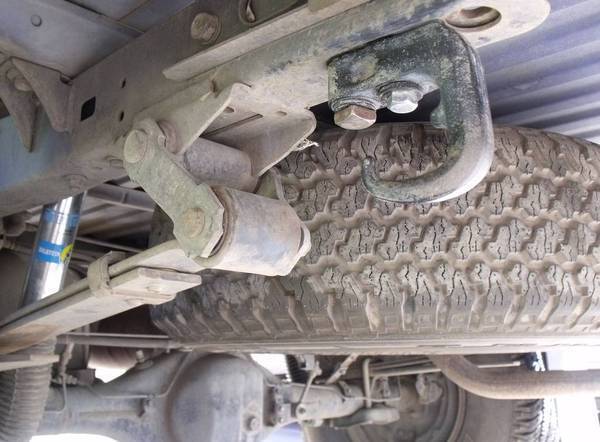

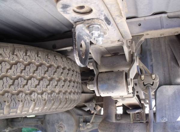

    Relocated the factory tow hooks to the back of the truck since I had to remove them to install a brush guard. There were already holes there so I only had to drill one hole on each side to install.

    The hoop is not meant for towing/tugging/pulling/fornicating.
    That's a tie down hoop meant for securing the truck during transportation. If you try to use it as a recovery point, inform your friends so they can stand back and watch it rip off the frame.

    well it will be fine with some positions of fornication

    Sweet, I picked up an extra set of those tow hooks just so I could mount them in back.
    Thanks for the location, I tried lining them up with the bolts of the bumper bracket.
    Just a normally drilled hole is fine for threading a bolt through?
