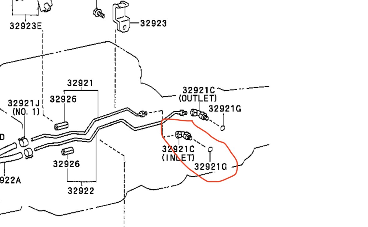

    That's the output line from the transmission to the cooler in the radiator.
    It uses a crush washer. Not sure what would cause it to start leaking though.

    I'll take a closer look. I don't recall seeing a crush washer. It's a used trans so it could have been done incorrectly. It was loosened to adjust the angle when I pulled and reinstalled the trans a couple months ago, but that's been it. It seems odd it's leaking from the outside of that nut. I did find this parts diagram where it shows an o-ring :notsure:

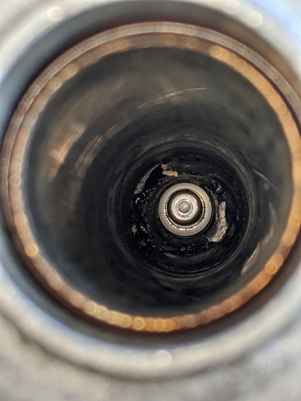

    Oh and here was the before pic with the rubber melted on my plug

    2000 ext cab, 2.7L, auto, 4x4
    Yeah if there is an o-ring, I could see that leaking on you if it was loosened and moved. Know what I mean? Old rubber seals.

    Is that melted aluminum around the plug? :confused: I’m having a hard time figuring out what I’m looking at

    Yea I could be wrong about the crush washer, but I know it has one or the other.
    If it's an old trans then I would just get a new o-ring.

    Time for you to upgrade to a magnetic spark plug sock :)
    No rubber insert needed

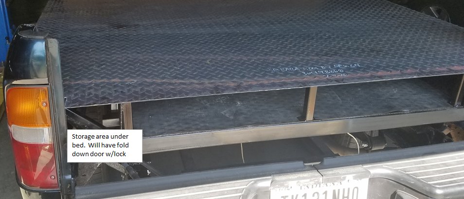

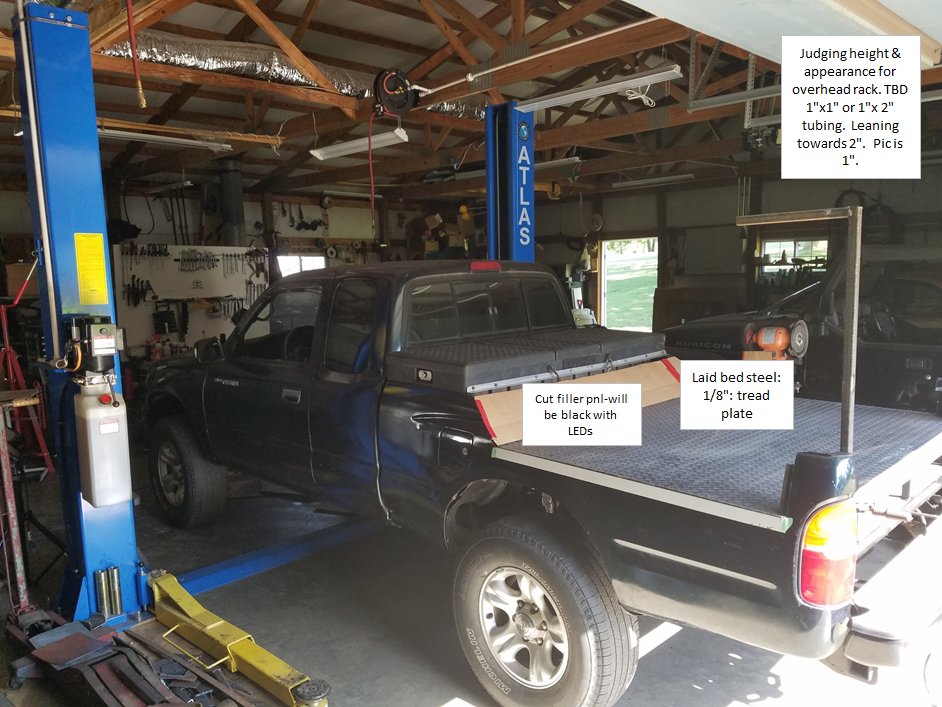

    Worked on my flatbed project some this afternoon. Got the rear steel cut/laid in, cut some aluminum filler panel for gap flatbed to bedside, and started looking at overhead rack placement and tubing sizes.
