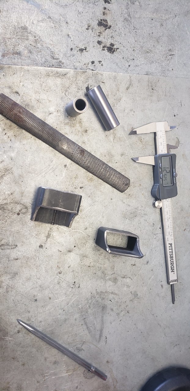

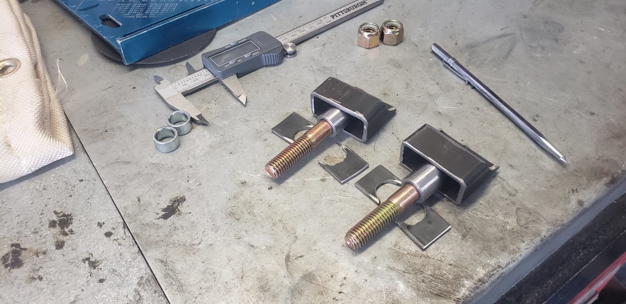

    Ok... so I guess I'm going to do it differently than most, I guess.
    I tried 3 different upper shock mounts and didn't like how any of them worked. So I started looking through the scrap pile and boxes of random shit I knew I would need sooner or later.
    Decided the the upper mounts are going to be custom.

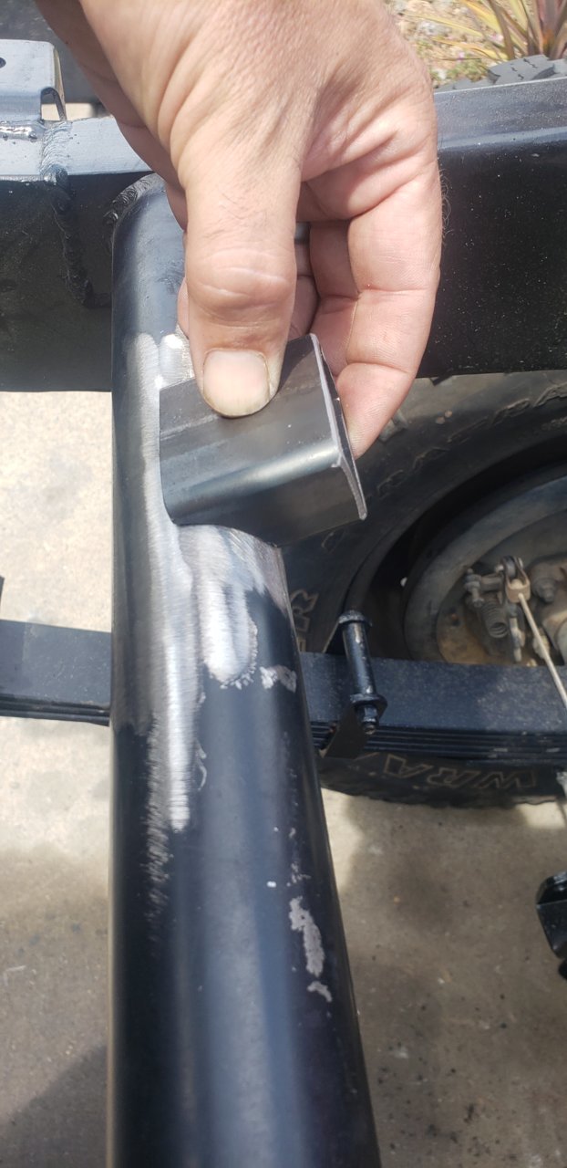

    Might want to try and make them double sheer. Not crucial because leafs will still support the truck but will be a bouncy ride if it shears the bolt

    I'd also consider having the bolt run parallel to the tube not perpendicular. not sure the shocks joints with like moving as much as it could in that position with the axle swing.

    The double shear is why I didn't like the other shock mounts. The portion of the mount around the bolt hole kept hitting the top of the shock on (less than) full articulation.
    And... lets be honest... fucking with trying to get the misalignment spacers in between there while fighting 200 pound charged shock, is dumb.
    The single shear mount hear is stronger than either of the (OEM) single shear mounts I just took off the truck.

    The bolt running perpendicular to the axle shouldn't be a problem. It's the way the Low Range Offroad cross member is designed. The body and shaft are independent of each other... the shaft will turn inside the body.
    Mounting them like this fixes another problem, with the resi hose. It makes it so the resi hose will not rub on anything around the area.
