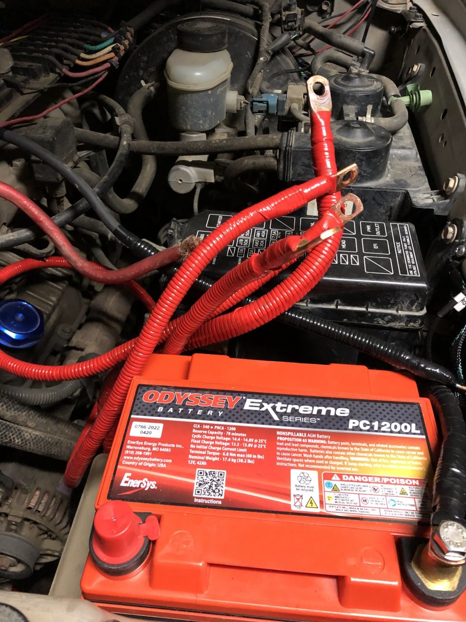

    Need some HELP!!
    Ok so this is totally on me but i went ahead and started replacing the big 3. Along the way i also replaces the main power wires coming out of the fuse box. Its been about a month since i pulled everything out. Finished up tonight, started the truck and it stayed on for 3 seconds and shut off.
    here is what I replaced
    1)block to battery
    2)ground to block
    3) alternator to battery
    4)both power cables coming out of the fuse box. Both to battery im assuming?
    where did i go wrong?

    Only one goes to the fuse box. The other used to go to your alternator. It used to go Battery > fuse box >alternator. Now that you have one dedicated line to the alternator you only need the one to the fuse box.
