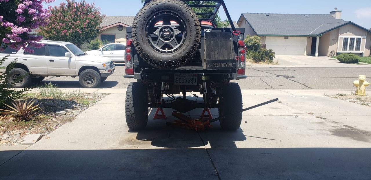

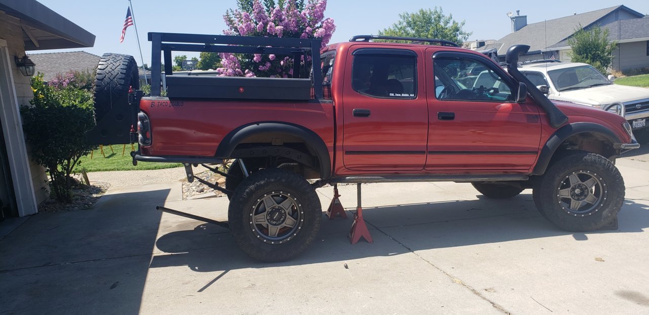

    (Almost) Full droop

    20200725_140127.jpg 3.5 inches of up travel seems good :thumbsup:

    Notice your bed is empty and no tent... What's that neutral level at with the usual wheeling weight?

    The boxes are pretty much full. The only thing the truck is missing from full wheeling weight is the tent. It's only 115 pounds.

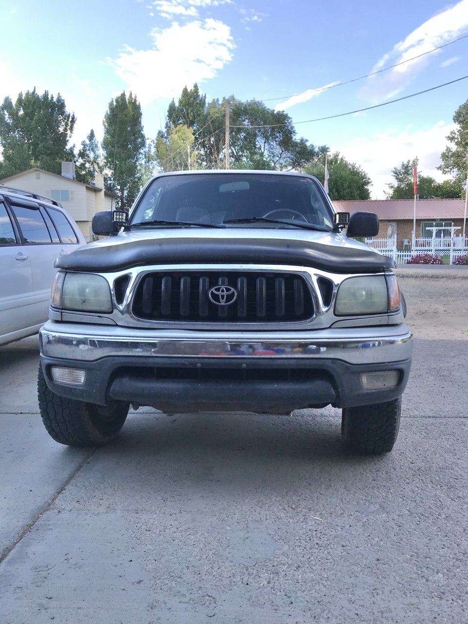

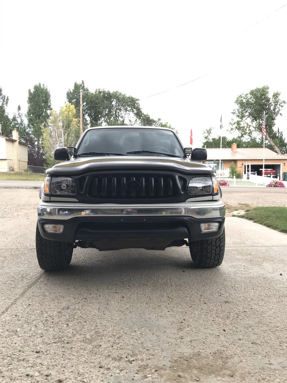

    So much better
    A9253F0C-78E0-4649-8FE1-3BCBF8F76826.jpg 23D08A0A-86B7-4683-A557-CD57693E978B.jpg
    minus the missing badge

    Looking nice

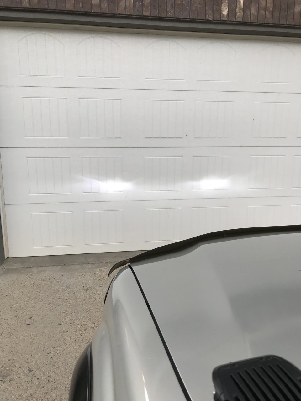

    Is like a general height the headlights should be aim to?

    Are those 10" shocks? I've personally found (since I had to do this twice, hahahaha) that uptravel is more valuable than droop when it comes to the rear. At rest (loaded), I now have about 5-5.75" of shaft for uptravel and I wish I had more. (If those are 8" though, makes sense that you've got about half.)
    ...could just be my style of driving though. I find that at speed, hitting whoops, etc. are much more likely to compress the rear than extend it. But, I'm not jumping the truck (at least as much as I can help it).

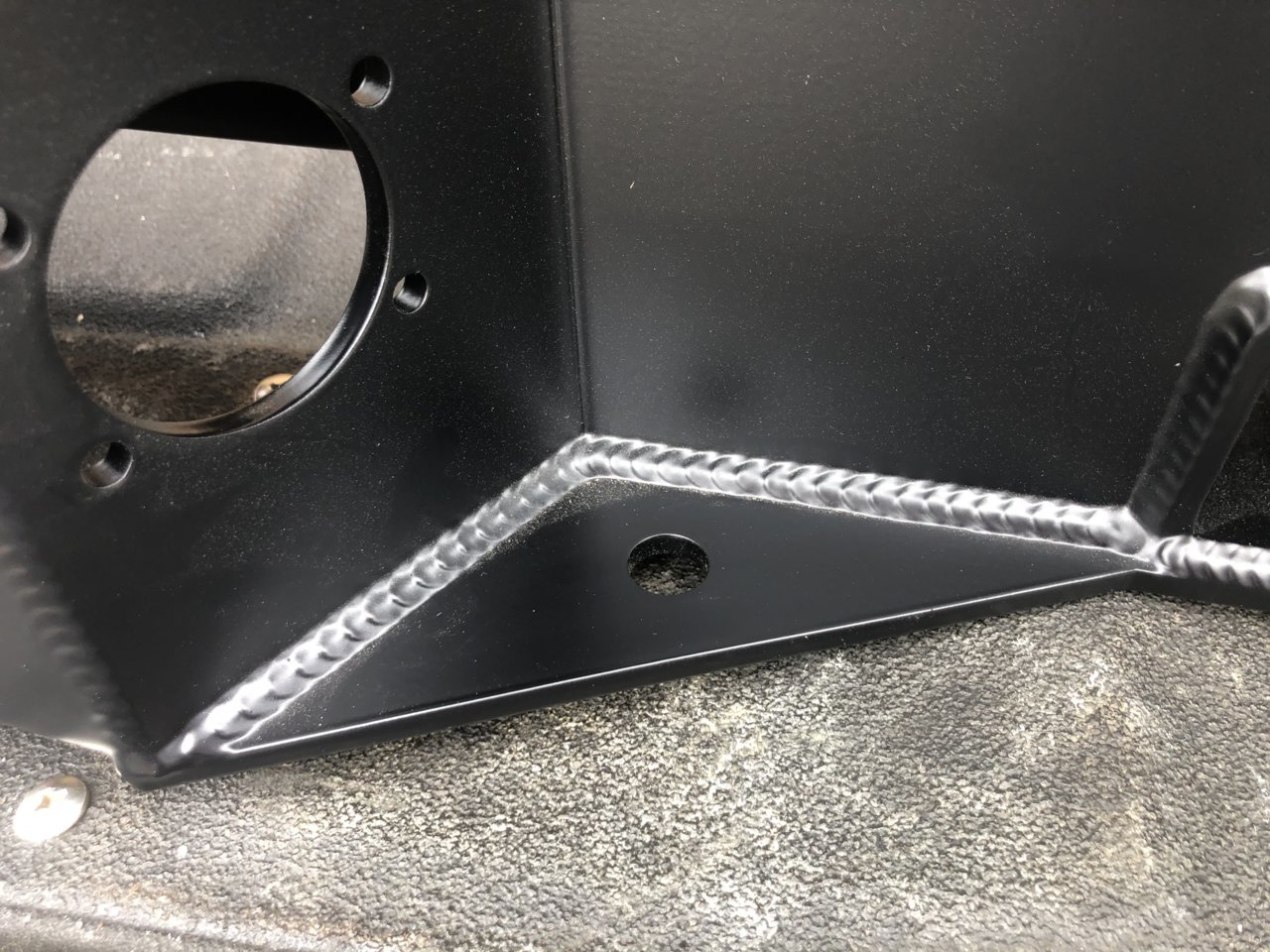

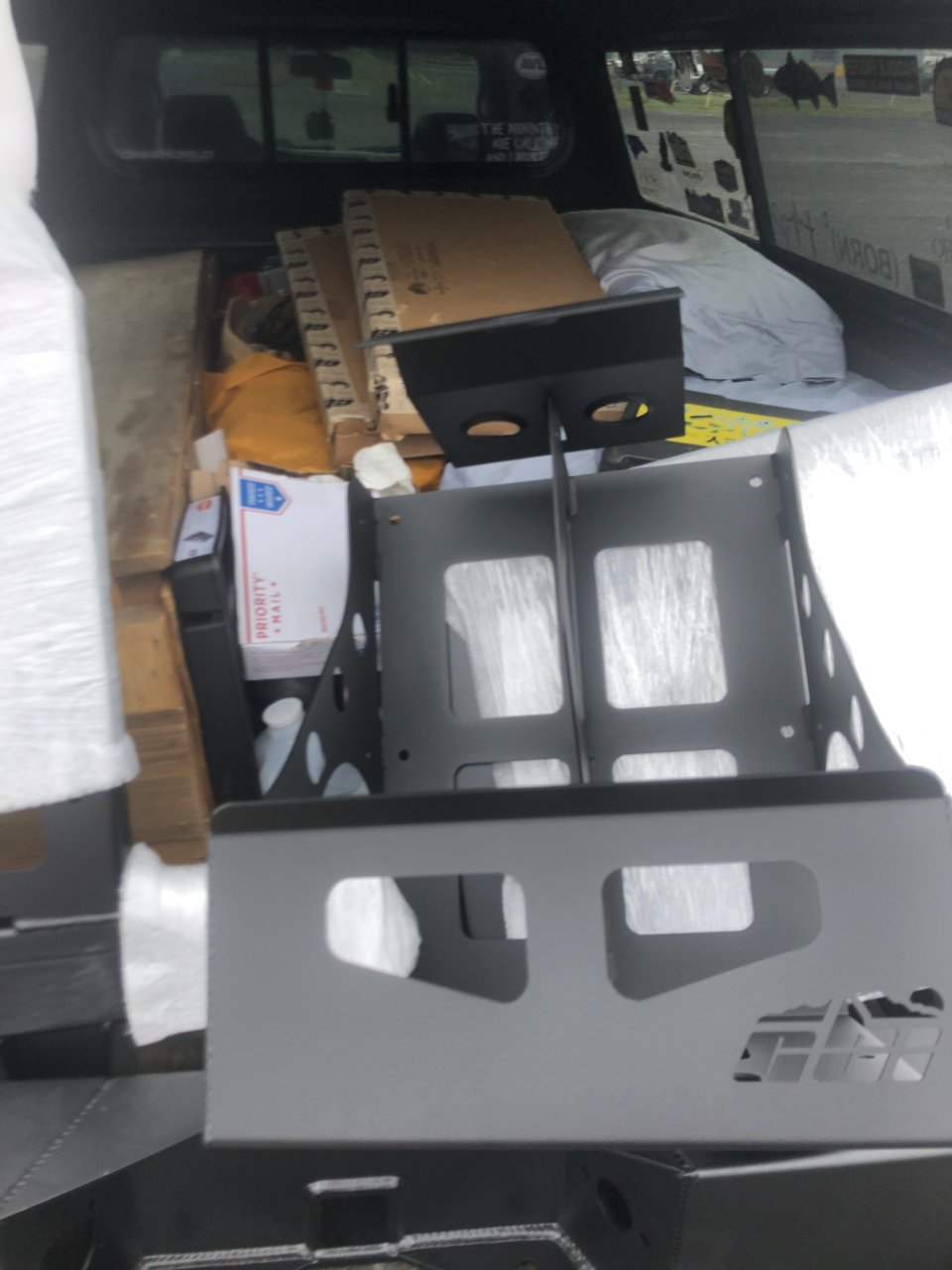

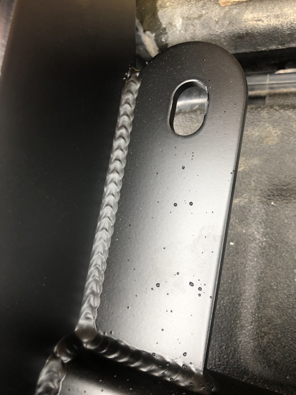

    In the what have I done today... these arrived.
