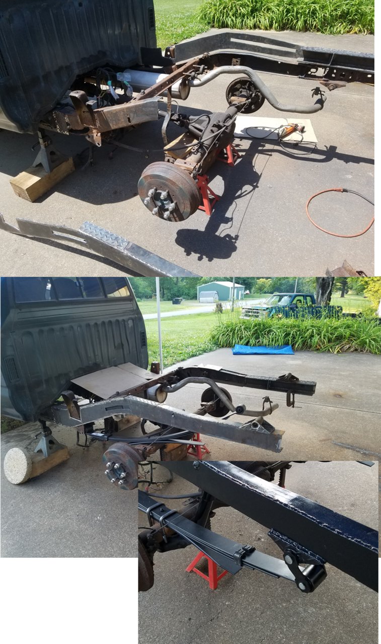

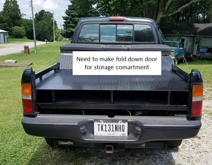

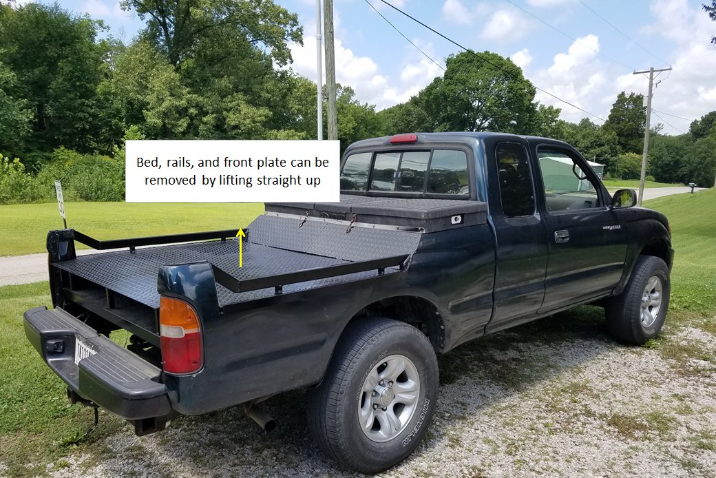

    Took my 95 frame repair/flatbed project for a shakedown cruise today. It's been over a month off the road. Due to rust, I removed the rear portion of the frame, replaced it, and built the flatbed.
    I still need to add a door to the underbed storage, add some marker lights along the side, and build the overhead rack for hauling lumber and other long items on those Sat Home Depot runs. I am going to add tie downs in several locations on the rails.
    I gotta be honest. I am not too happy yet with the symmetry. The tool box looks a bit too much above the rear lamps. But, I think when I add the overhead rack, it will balance it out. Just need to get my tubing ordered.
    Also, today when I lifted the spare, the truck "leveled out". I think the new General Springs stock units might be a little weak if I haul anything much. My fault, not Gen Springs. I will try adding some spring helpers first, then up size if needed. I think they could haul a few hundred more pounds (decent gap to overloads remains), but with "stinkbug" effect.

    Any idea how much weight you had to add?

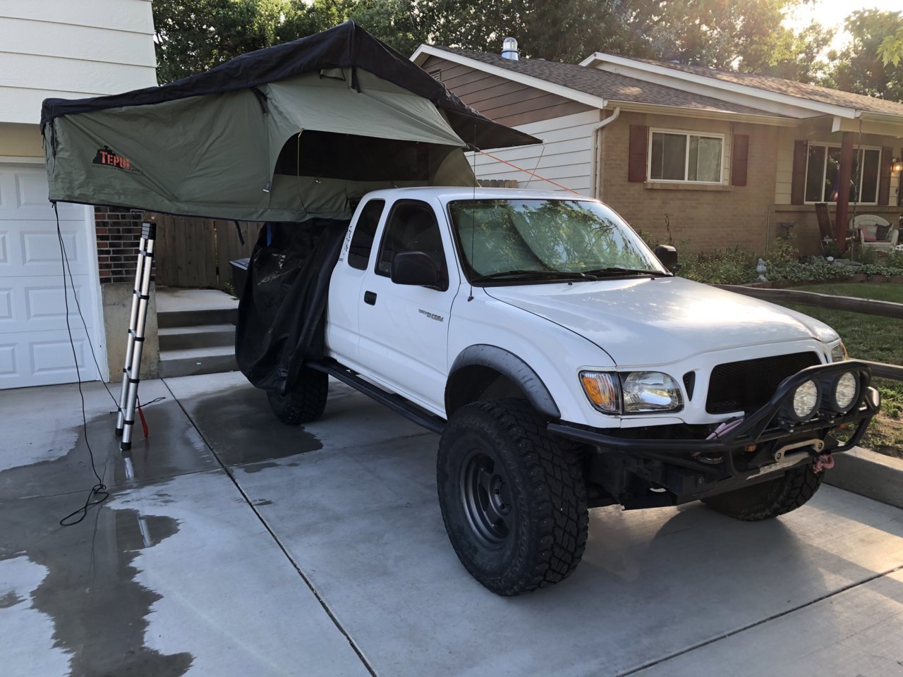

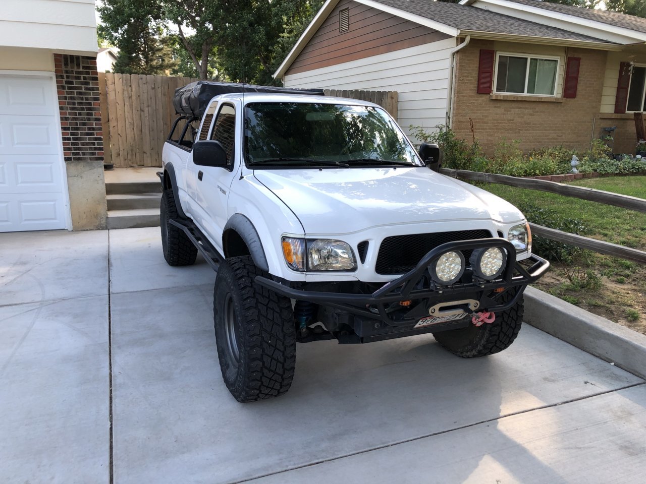

    I cleaned her up and aired out the tent after going camping last weekend.

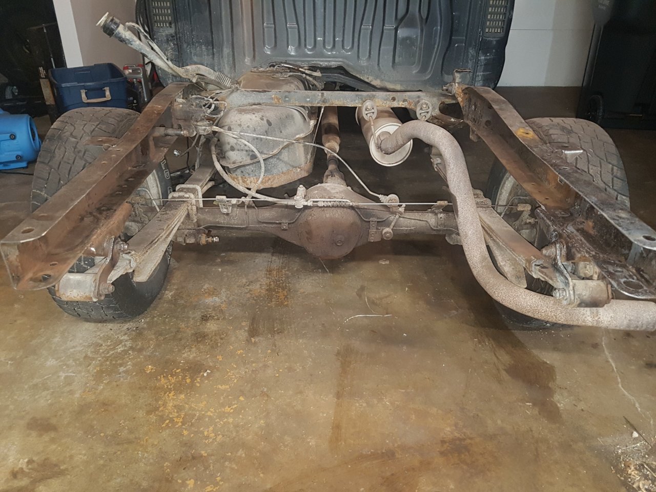

    Got all the stuff cut off that I'm going to behind the axle, and yanked the shocks. Need to drop the gas tank and disconnect all the brake lines next so I can get the rest of it cleaned up.
    In case anyone is looking to clean up some rust in the future, these black hawk stripping things are the _best_. Wire wheels don't cut it, grinding wheels and flap disks take off too much, but these things just tear through the rust and leave the steel alone. https://www.amazon.com/Pack-Black-S...1&sr=1-1-791c2399-d602-4248-afbb-8a79de2d236f
    I ordered some drill-mount ones that I'm going to use for the inside of the rails later.

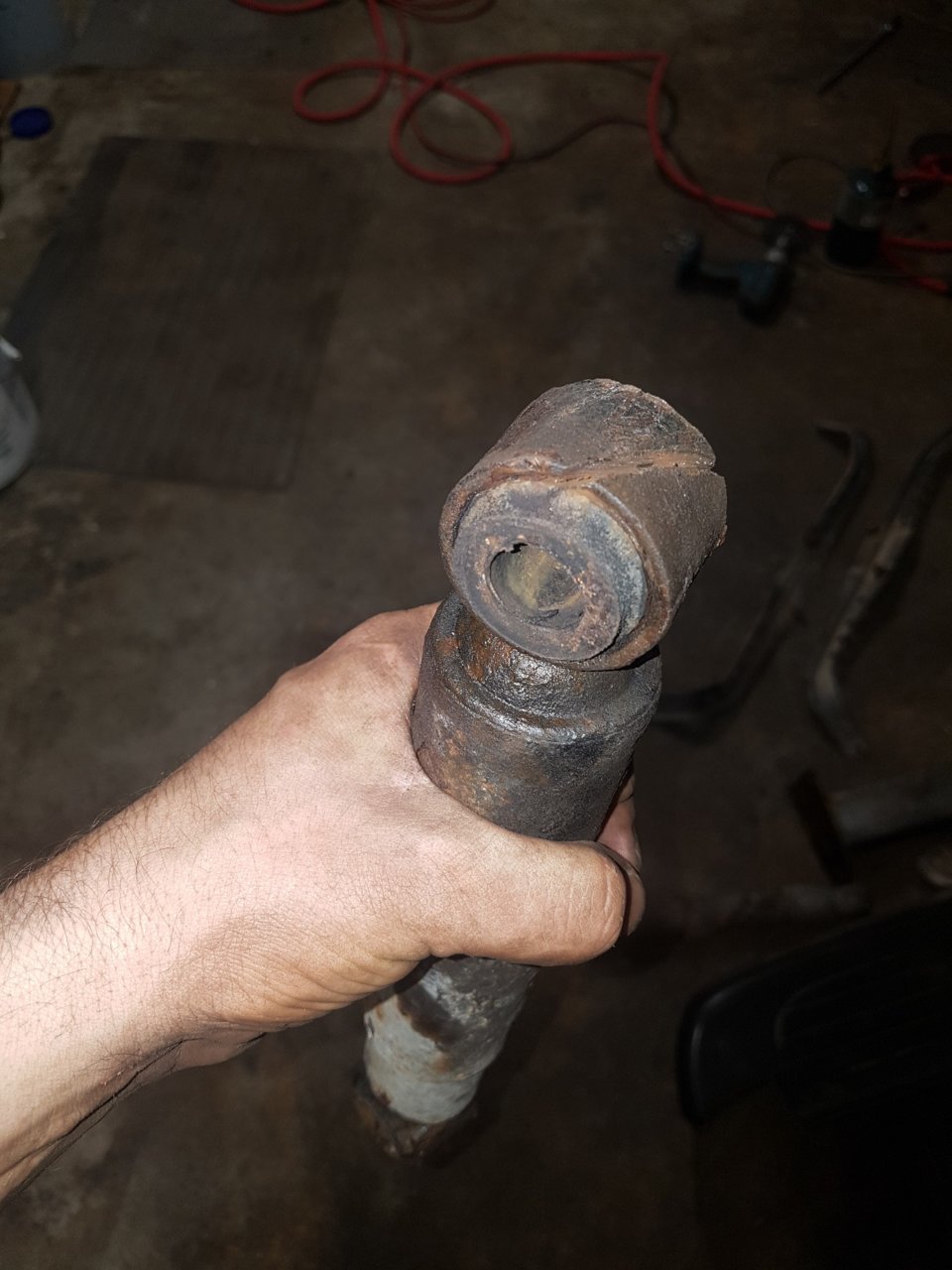

    Bow to the sawzall you silly rusty shock!
