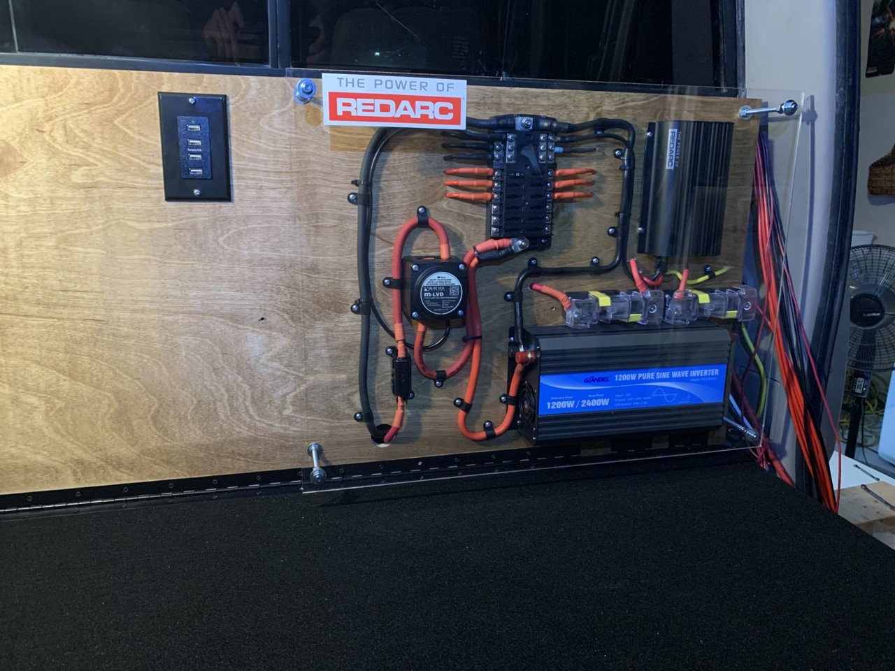

    Regarding storage and charging, battery bank is 200ah mounted under the platform. Charging is handled by a 25 amp DC-DC charger/battery management system. It charges from solar as first choice (200w solar array on roof) and will charge from vehicle power otherwise. It's wired to a smart relay that will allow the solar system to charge the front start battery if the rear bank is full. I also wired this configuration to allow for a momentary switch at the drivers position to allow starting the vehicle off the rear bank or jump starting the front start battery.
    I currently have zero plans to draw 1200w for any length of time. Only thing that will run constantly is the ARB fridge (already DC) Will charge Ryobi and Milwaukee tool batteries (One + tool system & Milwaukee chain saw). Ryobi has all kind of interesting battery powered goodies including things like fluid transfer pumps and stuff. I've found some heated blankets from cold winter camping that don't draw too badly. Oh and one never knows if the GF will want to use a curling iron or hair dryer someday :D:thumbsup: or you know... a travel blender ;)
    Just in case of too much discharge, I have a hard wired adjustable low voltage disconnect. It will automatically disconnect the load if available voltage drops too low and automatically connects it again once charge state is above disconnect voltage.
    Very keen to give this system a go but gotta finish building it first lol. What did you do for your setup (regarding solar)? Always curious to see what other folks are doing. We are planning/building to be touring off-road 4-5 days without the need for other people more or less but I really like the idea of being able to stay out for however long at least with solar. Gonna run out of food, gas and other supplies at some point haha.

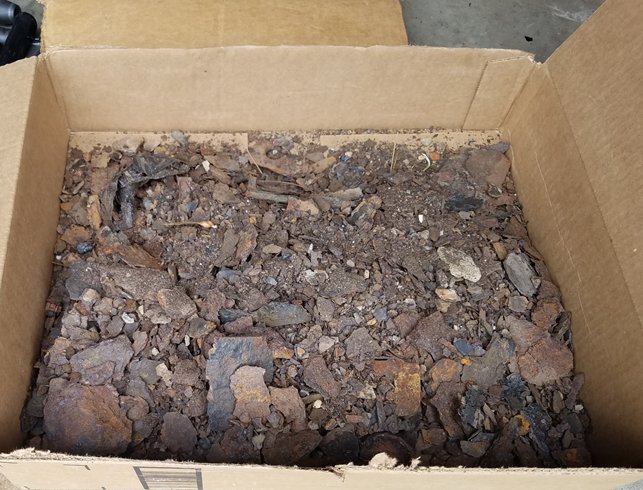

    I think the weight lost by rust falling off the rear of the frame also helped fool me on what the old springs were actually supporting. That's actually not a joke. I'd say at least 25% of the weight of the rear of the frame was gone. Maybe more.
    This is part of what fell off during the tear down (12"x12" box), so you can imagine what had fallen off over the years.

    Ha, I have a similar picture. I've got a box about half that and I've only cleaned from the axle back.

    Sounds like a nice system, probably way overkill! Haha, that's the fun though, isn't it?
    We just did 5 days in a base camp with a single 100 watt panel (so around 65 watts in practice) and had so much power we didn't know what to do with it. Will try to get that set up written up here shortly...

    Thanks! Overkill is what I do for a living, being a Systems Reliability Engineer :D. It may be a bit overkill, but time will tell that tale. I'd rather have it and not need it, that's for sure. I am also a big fan of "buy once, cry once" and future proofing (as much as you ever can anyway). Plus I went with dual 100w panels and am connecting via a Y, so I can opt-out of one if I decide it's indeed overkill.
    Depending on how I decide to go, I may be running some significant amps for radio communications equipment at some points also. Lots of big plans and grand ideas... as always.
    Also hell yes over building is usually quite fun! Though I really wanted the Redarc Manager 30 for all the additional monitoring and shore power hookup, but couldn't justify the cost and space for it.

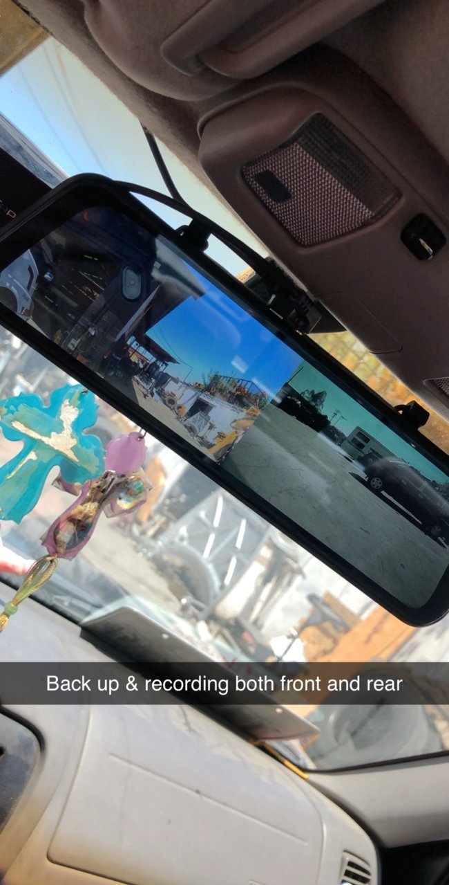

    Picked up the mirror / dash cam @MoneyB86 posted last week. Still gotta tuck the wires and fully mount the rear camera but I’m stoked on it ! Only thing I’m worried about is it coming loose since it just wraps around the stock mirror and with all the bouncing around I do offroad. Time will tell and I’ll update.
    If I like how this one works I might look into something that mounts directly to the windshield. Hopefully she can hold on

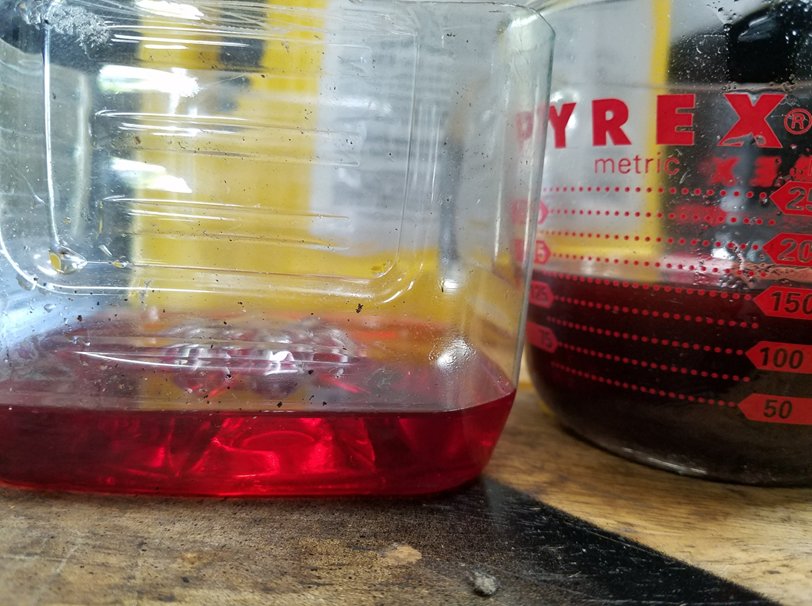

    Oil change and trans drain and fill today. This truck has 256,800 miles. I have only had it a few thousand of those miles. Unknown if changed before.
    Round two on the drain/fill, and it still looks pretty dirty. May do it again before next oil change.
    New vs old samples:

    Interested to see how this setup works for you! I have a very similar plan and want to be able to run an electric blanket for winter camping.

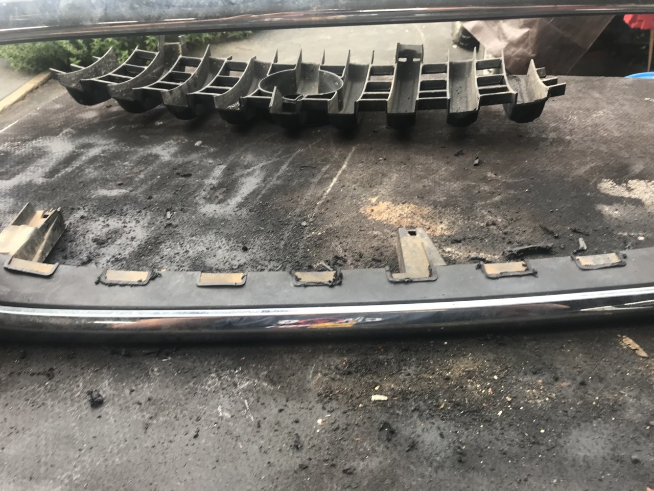

    While I wait for the Raptor on my bumpers to cure, I began my Satochi grill. Got the center hogged out and trimmed down fairly close, using jigsaw and a cutoff wheel in a Dremel, using the flex cable attachment. This helped immensely. Next I'll try to sand those down smooth with palm sander.
    I do intend to fiberglass the edge of the top, so that the grill will sit back in as far as possible, rather than cutting off out closer to the chrome edge, as Customcargrills suggests. I prefer the recessed look. Hope I can pull it off.IMG_1469.jpg
