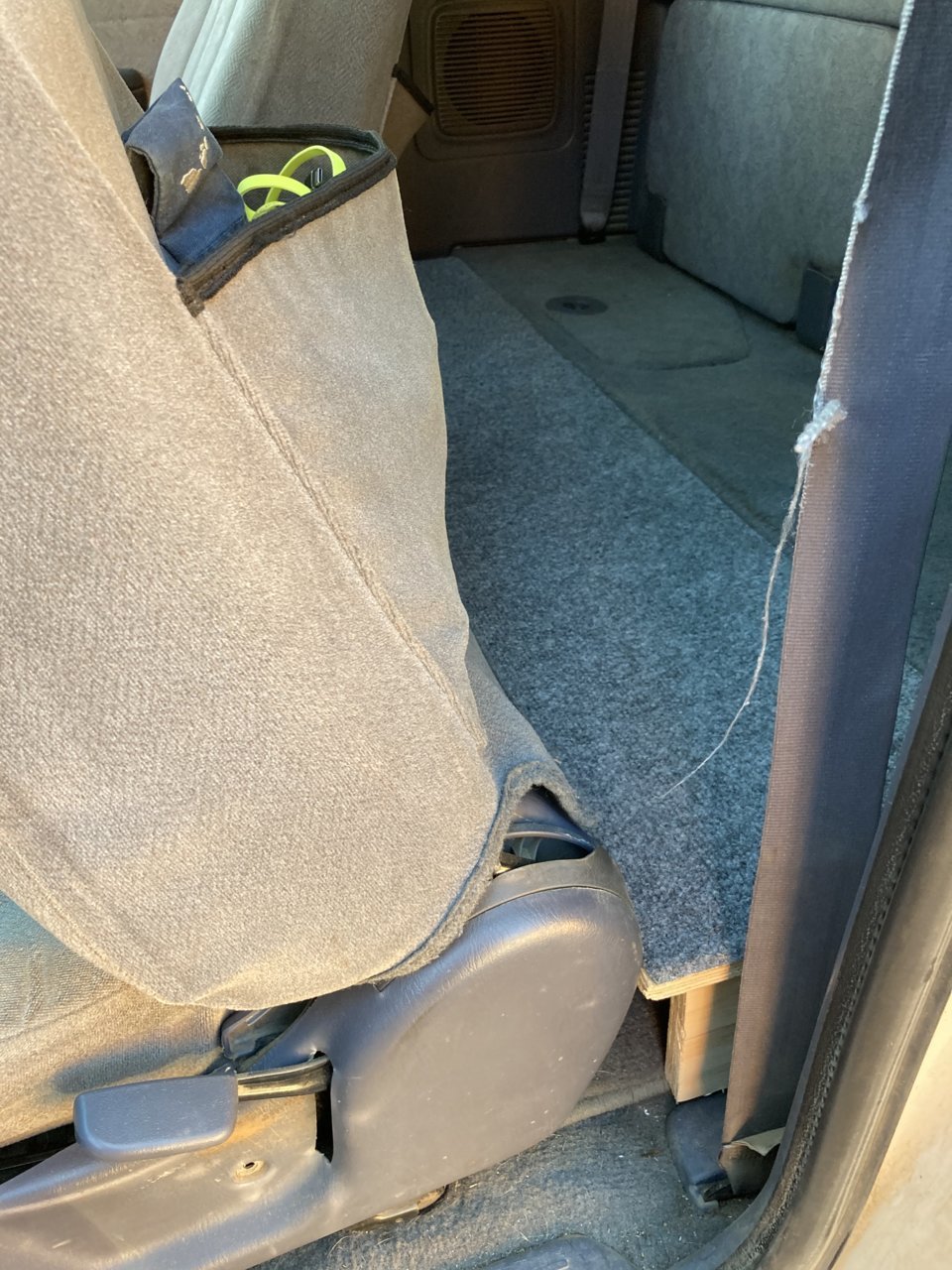

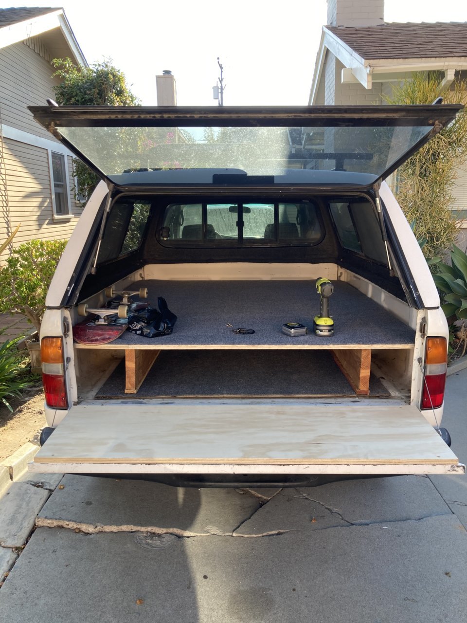

    Couple of diy upgrades today: replaced temporary OSB platform with top shelf ply, covered the tail gate which will now work as cutting board/beer and stove holder/ camp sign-in sheet. Also hopefully won’t tear up my shins climbing in as much.
    Also made behind-the-seat platform to level the floor. Now a cooler can fit without tipping and my dog can sleep on it. Clyde approves. — Cass

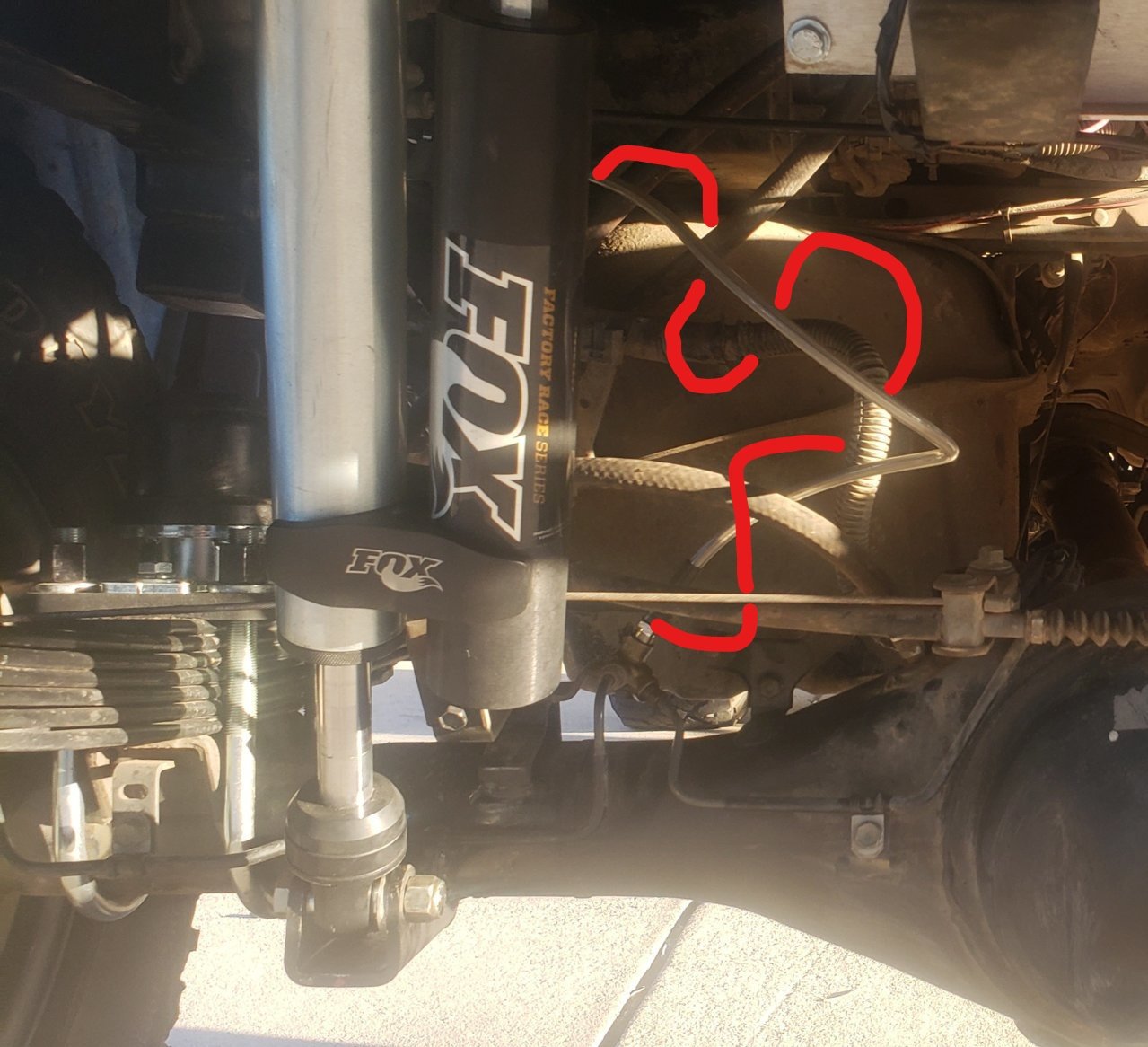

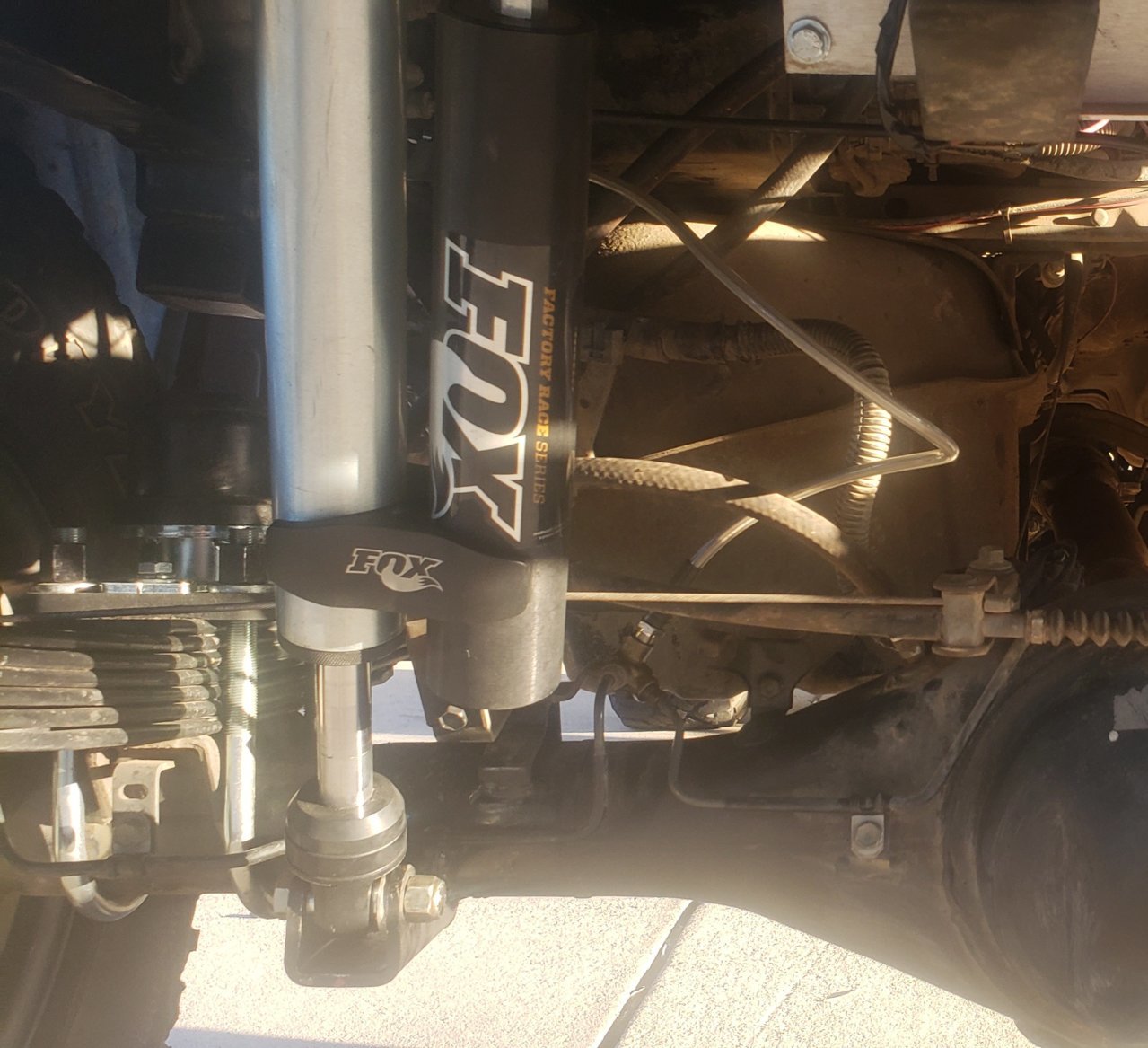

    Rear brake hose arrived today. Quick and simple install. Brings me from +3 to +8 inch hose.
    Wondering what part of that I did wrong...
    I guess someone will tell me something here pretty quick... I'll wait

    Looks like you've used 2/3rds of you available uptravel already.
    Also wondering if you resi will hit your mounting bolt at full compression.
    If you're worried about drooping out enough to need that brake line, you should also take your elocker wiring off that gas tank bracket.
    Is that the kind of response you were waiting for?

    We've already discussed the up travel. My truck is loaded pretty good daily. If I were to give much more uptravel with it loaded as much as it is, I'd have 8 and a half inches of shock shaft exposed when I'm not loaded.
    Resi will not hit anything on full compression.
    The brake line was the only thing that go tight at full droop. It wasn't all the way tight that I needed 5 more inches of brake line (only needed maybe one or two more inches)... but it was either +3(.5) or +8 that I could find.
    Yes... those are some of the responses I was looking for :thumbsup:

    This is how you where supposed to route it!
    Madjik_Man and chrslefty like this.

    Well fuck... lemme go out there and change it.
    Phessor[QUOTED] likes this.
