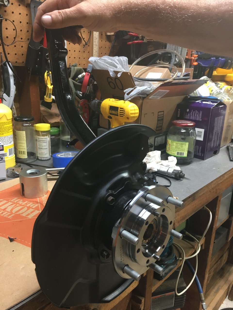

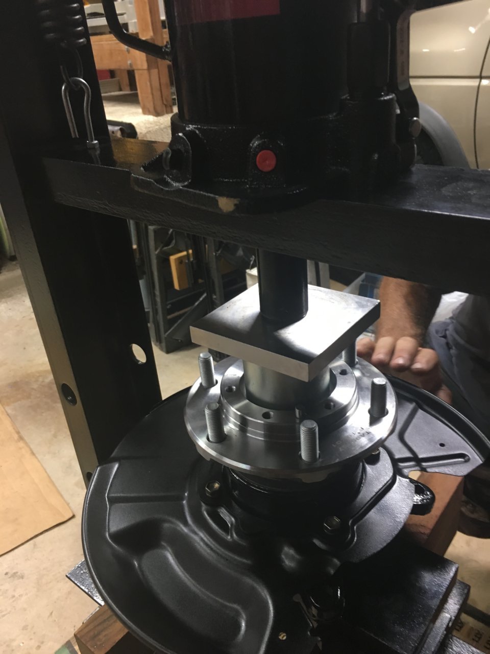

    Yeah I used a 20 ton press to press it out and back in. Have to press the hub out first to gain access to bearing. You need a press, press plates, 2 4x6's, and a bearing press/sleeve kit

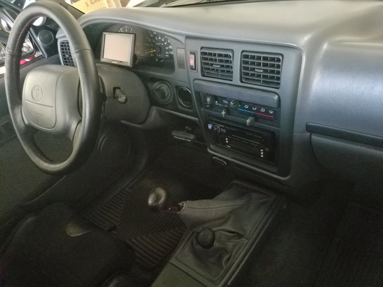

    97 reg cab, v6 5sp 300hp supercharged, Methonal Injection, 800,001 plus miles, Original Owner

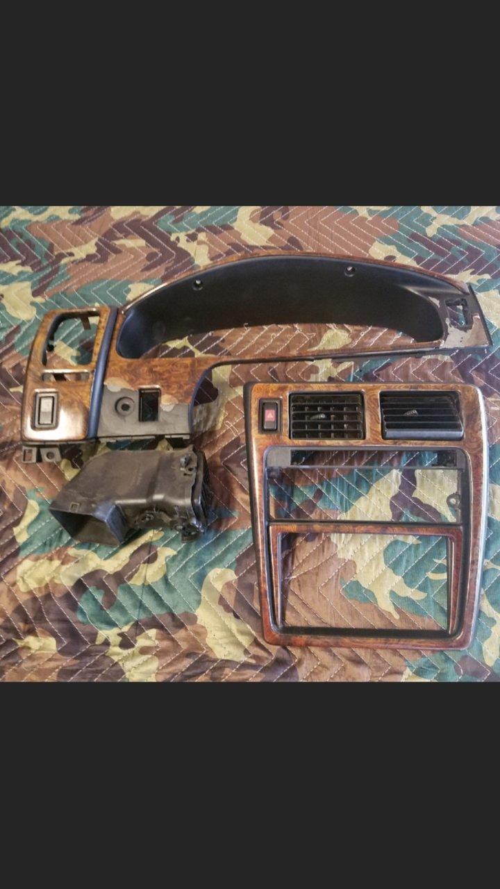

    V6 5sp,RegCab,TVS1320 Supercharger, 56mm pulley, methanol injected Haltech ECU, AC Tvs1320 supercharger,(MUST DO) every 125,000- 150,000 needs rebuild Projector headlights HID 5 speed manual Amsoil for all drive train Smaller 56mm custom pulley, (MUST DO) 2004 DESNO fuel injectors, zero ping ping, 2004 side door mirrors Dick Cepek Rims, Michelin tires LTX, ATM Pathfinders Dynopro ATM ( that last 100,000 miles) Now running Dynopro ATM mud and snow tires KN cold air intake Cat back dual exhaust with ss exhaust tip, Raised exhaust tail pipe to 2" below body line Optima*dry cell battery,red top Alpine sirius radio, 200 watt amp, focal is165 split door pod speakers Focal door speakers Subwoffer behind seat Viper alarm, Electric Locks Dark tinted windows, bucket seats corbeau lg1 Tacoma Rubber floor mats TRD fender extenders, Bilstien shocks, King shocks JBA UCA trailer iv hitch, electric brake control, Drilled slotted brakes, High carbon steel (MUST DO) EBS green stuff 7000 series pads(MUST DO) TRD engine oil cap TRD stick shift, Marlin crawl shift kit. Rear sliding window 2002 4Runner functional hood scoop cut into Tacoma hood, 4Runner dual overhead map light Gentex Auto dim + Compass + Temp, garage,rearview mirror Snow Methonal kit stage 2 Custom 3 core aluminum radiator Linex bed liner Haltech stand alone ECU, Intake supercharger gauge. Stainless steel brake lines, Custom leather wrapped steering wheel, Haltech stand-alone ECU,
    Lol,
    My truck has been down waiting months for the supercharger to be rebuilt, backed up because of the virus issues,
    So Ive been doing little things here and there
    because I haven't been able to drive it,
    My list of things I did Including a deep engine bay area includes
    New bumper
    New grill
    New blinkers
    New marker lights
    Blinker mod
    Antenna power new
    Antenna cutoff switch
    Hood painted to remove hail dents
    Hood liner sprayed with black sealer
    Wipers painted
    Windshield cowling painted
    Leather wrapped steering wheel
    New dash parts
    Wood trim removed
    Cluster screen polished
    Brake light bulb replaced
    LEDs in the rear
    Orange blinker bulbs Up front
    New garman gps
    New alpine blue tooth radio
    New brained stainless fuel lines
    Heat wrapped fuel line
    New front engine timing cover
    New dual temperature supercharger gauge
    Gauge installed in clock location
    Fuel injectors cleaned and serviced
    Cleaned up all wires along fire wall and battery
    Powder painted valve covers
    Valve cover gaskets replaced
    New PCV valve
    Rebuilt supercharger
    New dash heater AC vents
    New seat belt clips
    New arm rest
    New front drive shaft
    New brake and clutch rubber pedals
    Deep cleaning of the engine bay
    Deep cleaning under the hood
    Trimmed the lower radio pocket for a snug fit for the scanguage.
    Now time to just drive her ;)

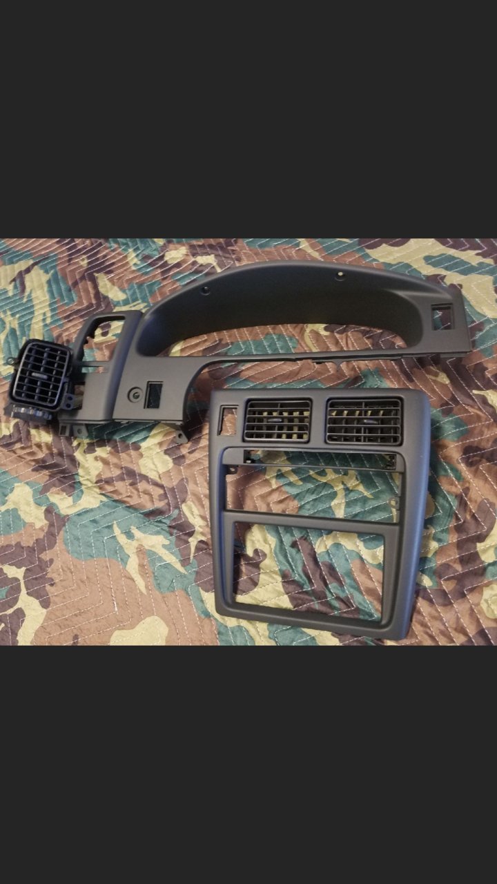

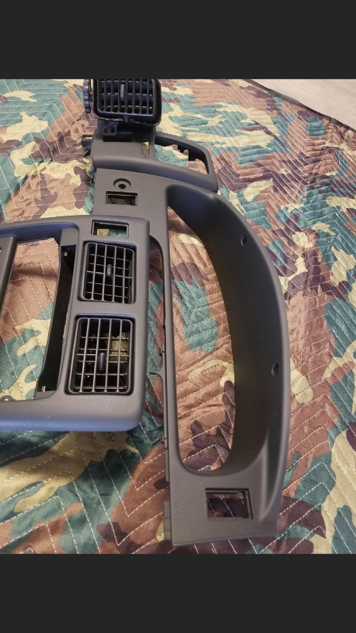

    Did you but OEM dash vents?
  8. Jul 31, 2020 at 8:38 PM
    1997tacomav6
    1997tacomav6 V6 5sp,RegCab,TVS1320 Supercharger,Haltech, 800k
    Oct 5, 2013
    #113940
    10,391
    John
    Denver
    Yup,
    The drives side was one part number,
    The center vents come with the complete face trim section

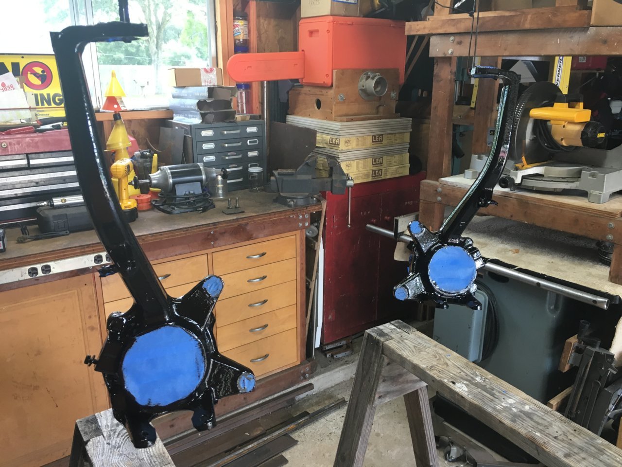

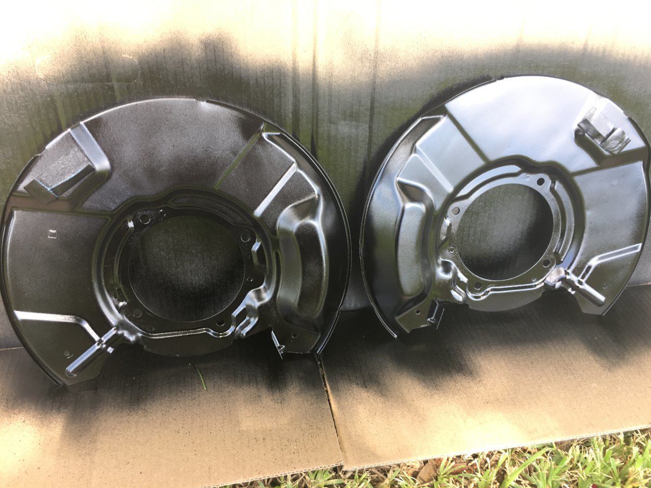

    Started off the day finishing painting spindles and brake dust plates

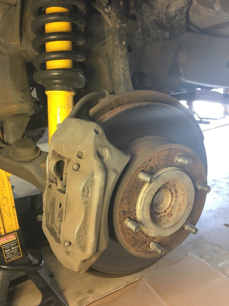

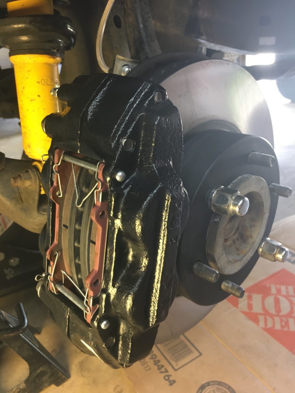

    While I waited for paint to cure I went ahead and did the Tundra Brake upgrade. Used OEM Rotors, Pads, and shims and then bought remanufactured Calipers. I also used @turbodb brake line kit. It worked pretty well overall but the clips that came with the kit were too thick so I had to file them down quite a bit to get them to work.
    Before and After photos

    Finished up the day with the last of the press work! Manual hubs are looking good!

    2000 reg cab 4x4 flatbed MT
    So what kind of paint did you go with? There's so many options out there.

    POR 15
    Its worked really well for me in the past and held up
    0xDEADBEEF[QUOTED] likes this.

    That sure seems to be a solid choice. Thanks! Looks like you did it with an HVLP?
