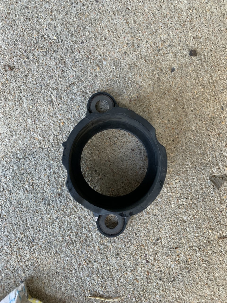

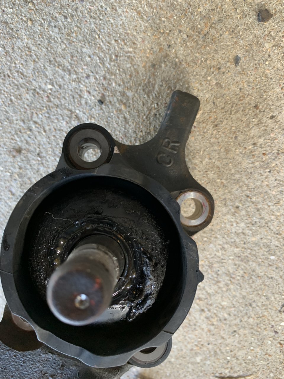

    Replaced my lower ball joints on the 2004 I bought last year. Not knowing the full service history of this vehicle I wanted to do this as soon as possible. Of course that means 12 months later.
    The boots must have been leaking grease for a long time. Tons of fresh grease and gunk on the lower control arms. Ugh.
    First side took me 1.25 hours because I had to make two separate trips to the same parts store :anonymous:. Second side took me 15 mins.
    Questions:
    1. Has anyone ever seen this rubber cover (thingamagiggy) over the ball joint boots? It's not on my 1998 and in all my years on TW I've never seen it. Clearly it does nothing.
    2. I don't have a bench vise but I figured I'd check out the old LBJ versus the new. The old one had a megashitton of movement to it within the ball joint. Laterally, up and down and it spun so easily... without any force whatsoever. For shits and giggles... were the old LBJs shot?
    https://www.youtube.com/watch?v=wQtZJ13DErw
    3. After I lowered the truck I noticed that the camber looked off and maybe even toe. I drove it around and it seemed to have gotten better but it still looks off. I always thought that an alignment is unnecessary after changing the LBJs... they only go back on one way. Do I need to get an alignment or am I imagining things because I'm super dehydrated?
    @Blackdawg @Squeaky Penguin (interested in your thoughts on #3, thanks fellas).

    The dust boot came on later model 1st gens...2000 or 2001+ I'm not sure. But the early models didn't have them covering the LBJ boots. They can break off easily.

    I have them on my 04 but didn’t on my 02.

    I'm fairly certain they were on the 02s but maybe not all. But they do break off easily especially if they're old, one of my original ones broke off last time I changed out my LBJs. They can still be bought new, I prefer to have them on so rocks/road debris doesn't puncture the LBJ boot resulting in needed to change it

    I also appreciate that it contained all the LBJ grease within the dust boot and not sling it all over the rest of the truck :)

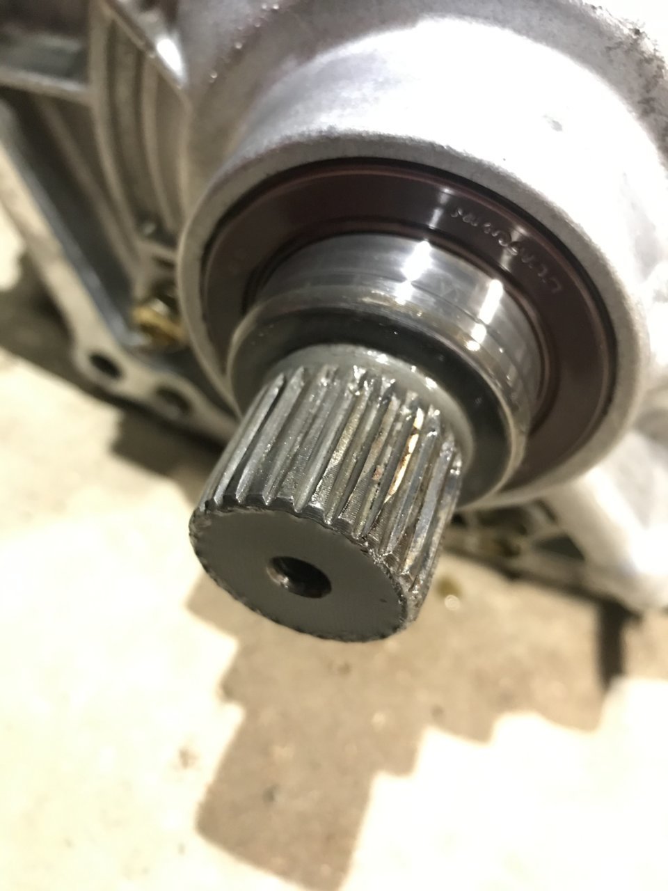

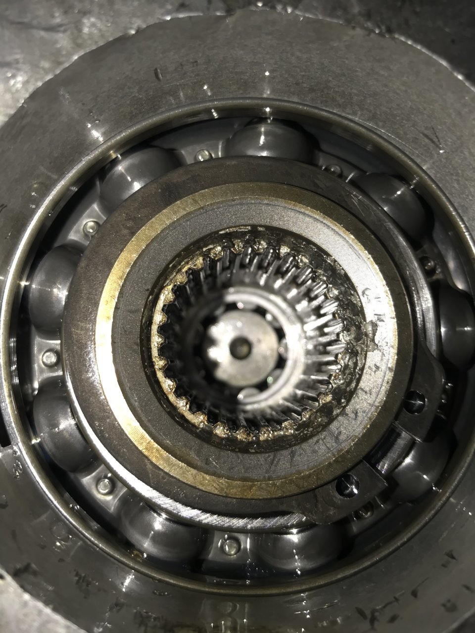

    I stripped out the factory chain drive input shaft and from that point on I didnt trust it, hence why I built the lefty. The gear drive cases have a much longer input shaft that reduces the ammount the coupler and input shaft wobbles and starts fretting corrosion. The chain drive case itself is strong as hell, I just never could trust that input shaft again. I know a lot of people run them in front of the chain drive case with no issues. I think the claims that running the 4.7s in front of the chain drive case can break the chain drive case internals is mostly unfounded at this point.

    Nope that’s what I run and is definitely the only way left hand drop dual Toyota cases make sense. I actually don’t think you can get a lefty anymore. If one is solid axle swapping and wants a right hand drop, just drop a 4.7 rear case in behind a 2.28 stock 23 spline case

    I think that was pretty short lived and I haven’t seen them for sale in a while. I think they didn’t make enough sense money wise.
    @Squeaky Penguin this was my chain drive transfer case input after 6 years and 30k+ miles behind a crawl box with TG adapter plates. No problems with fretting at all with anti-seize on the splines at assembly.
